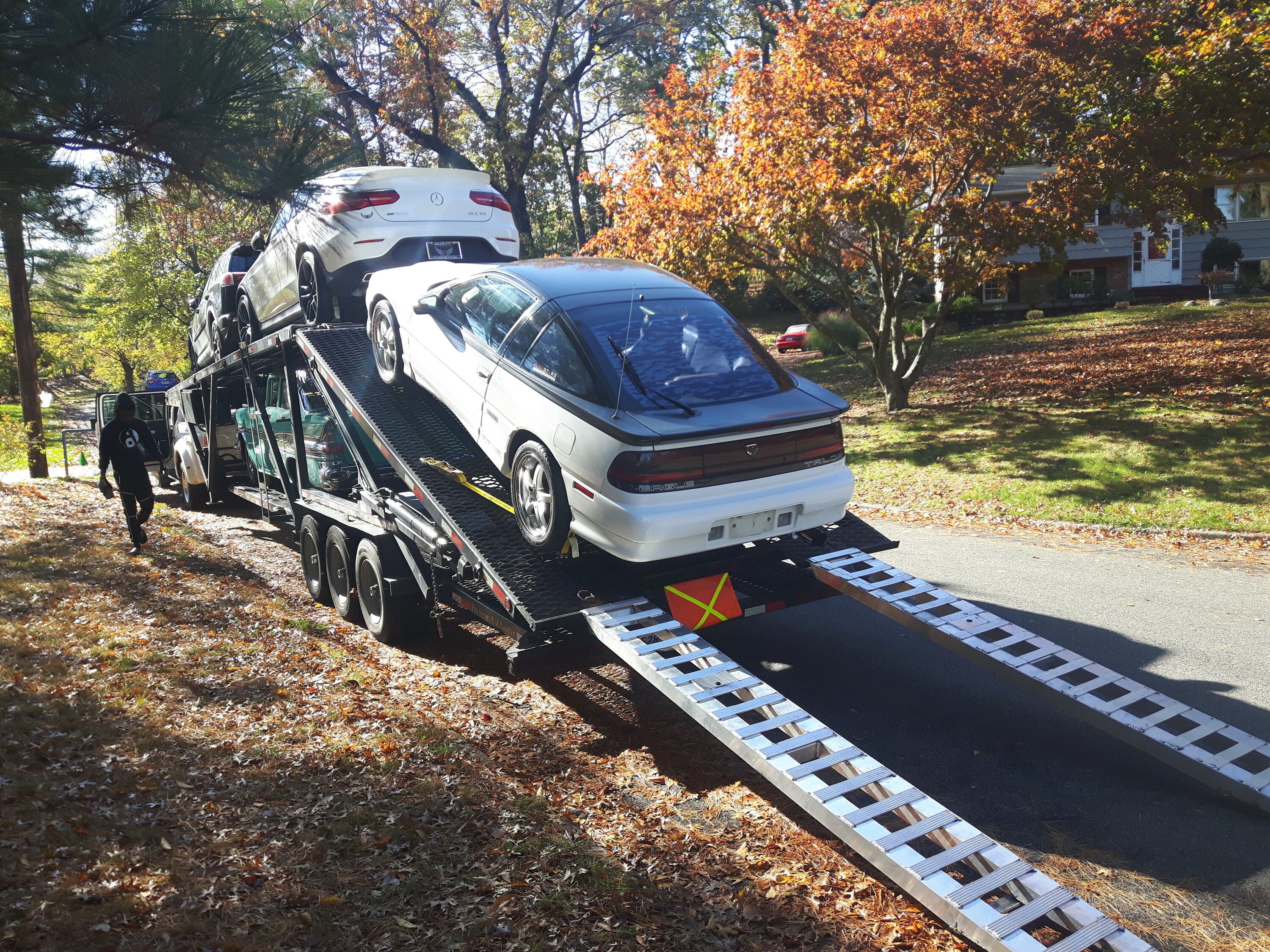

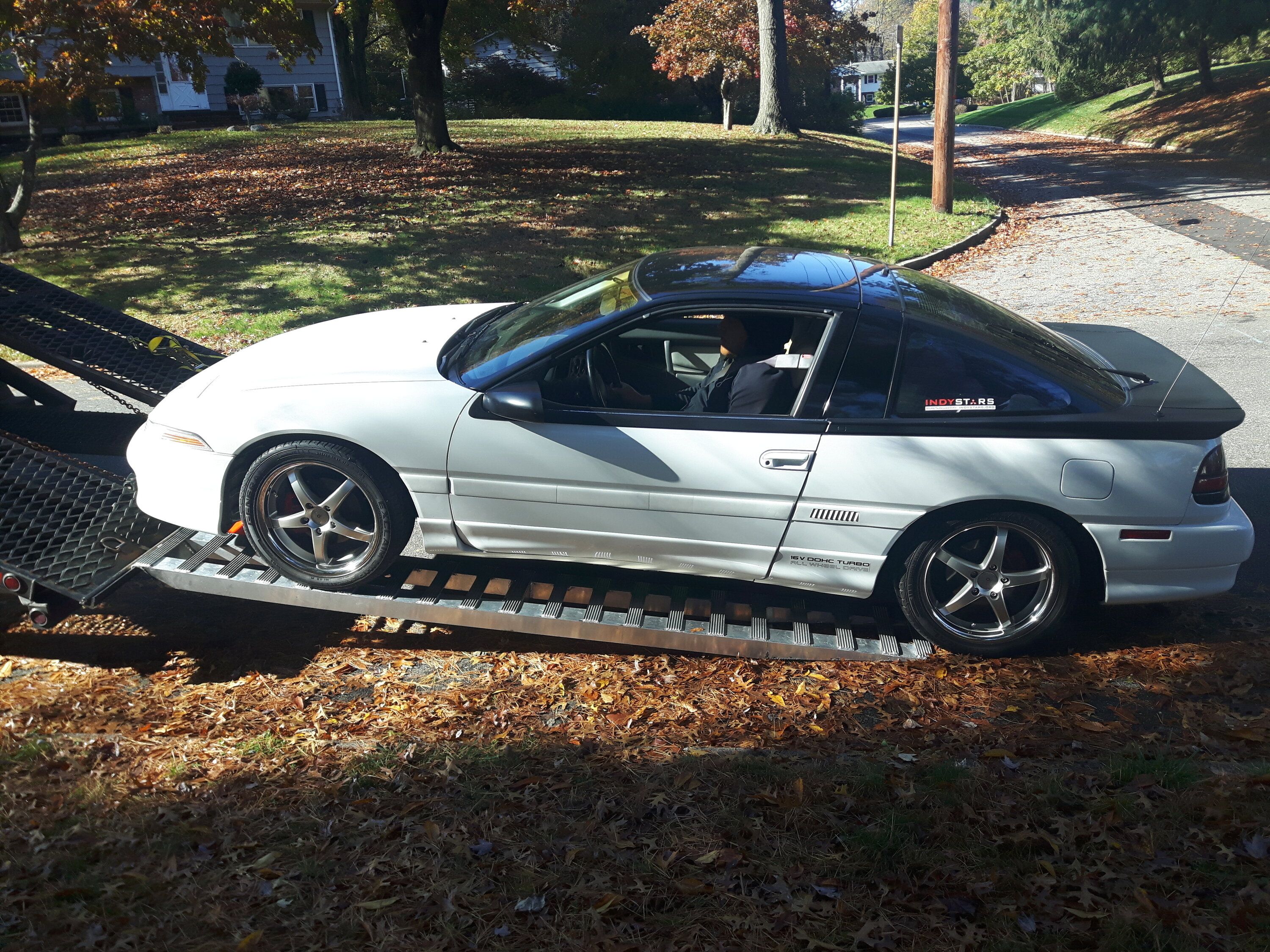

1991 Eagle Talon TSi AWDnin relatively stock condition. The car has over 144,000 miles. The car and runs and drives.
Hey Everyone,
Little background about me real quick. I live in NY and just turned 40 and have been experiencing nostalgia. You see, when I was in my teens I owned multiple DSM's, and absolutely loved them, but had little experience fixing them, and little money to mod them correctly. I always promised my self one day I would do it right. Eventually, that day has come. I'm not a mechanic by no means, but I do have some experience that would put me above the novice level. Basically, what I'm trying to say is please be patient with me, and please point out anything you think I'm about to screw up....Ha.

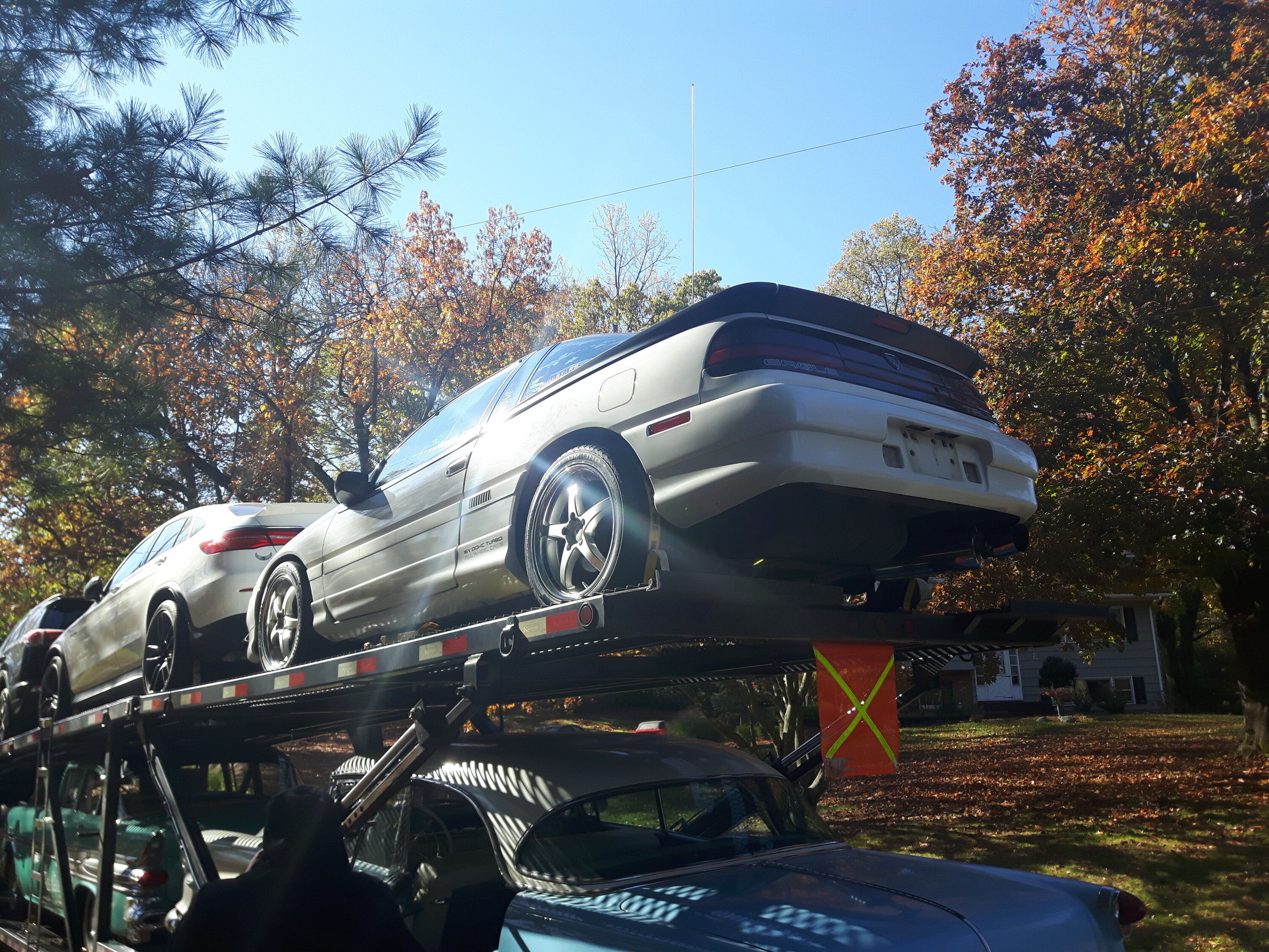

On to the car...It's a1991 Eagle Talon TSi. The car was a weekend driver (hardly) that sat in the previous owners garage for over 14 years. He had grandiose plans like we all do when starting a project, but he never followed through. The owner lived in Indianapolis which made seeing it in person and testing it out almost impossible because of work and other obligations. I really had to trust this guy. Long story short, it worked out almost perfectly. There are little things here and there I'm noticing about the car, but overall I'm extremely happy to have pulled the trigger on this one.
If I can offer any perspective/advice to anyone looking to purchase one of these cars. They are becoming harder and harder to find which means tampering down you expectations a bit. While tampering down your expectations don't settle for shit and there is a lot of shit out there. Trust me. I went to see at least 7 or 8 of these cars with high expectations from the seller that the car is perfect...Total BS. They all "Need a Tune" , or Body has a gazillion miles, but the engine was just put in yesterday. Stay away from all that crap. If you find a original with high miles with little modification and genuinely want one of these cars. Just fork it up and buy it like I did. You won't regret it. At least I have not up to this point.

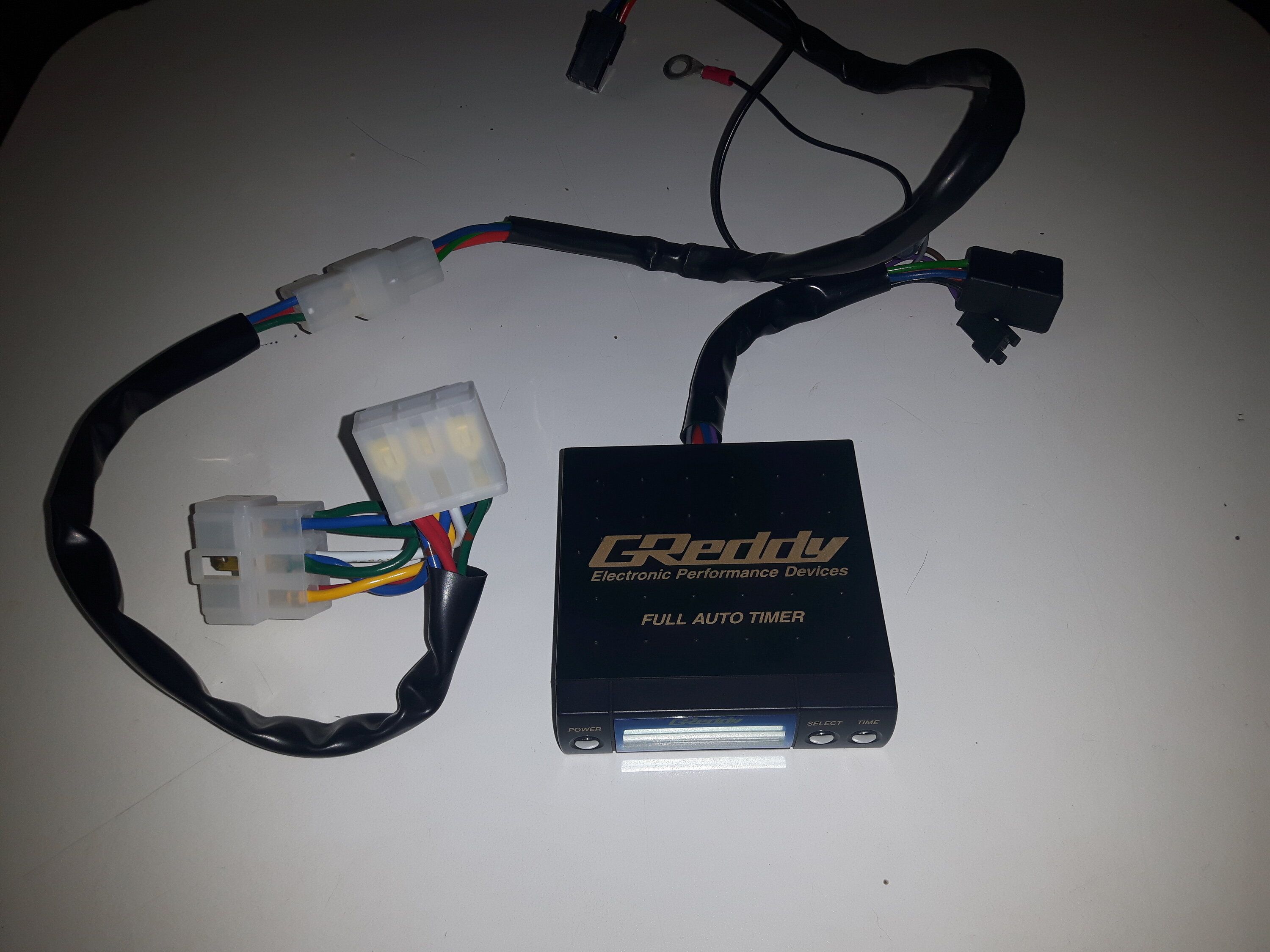

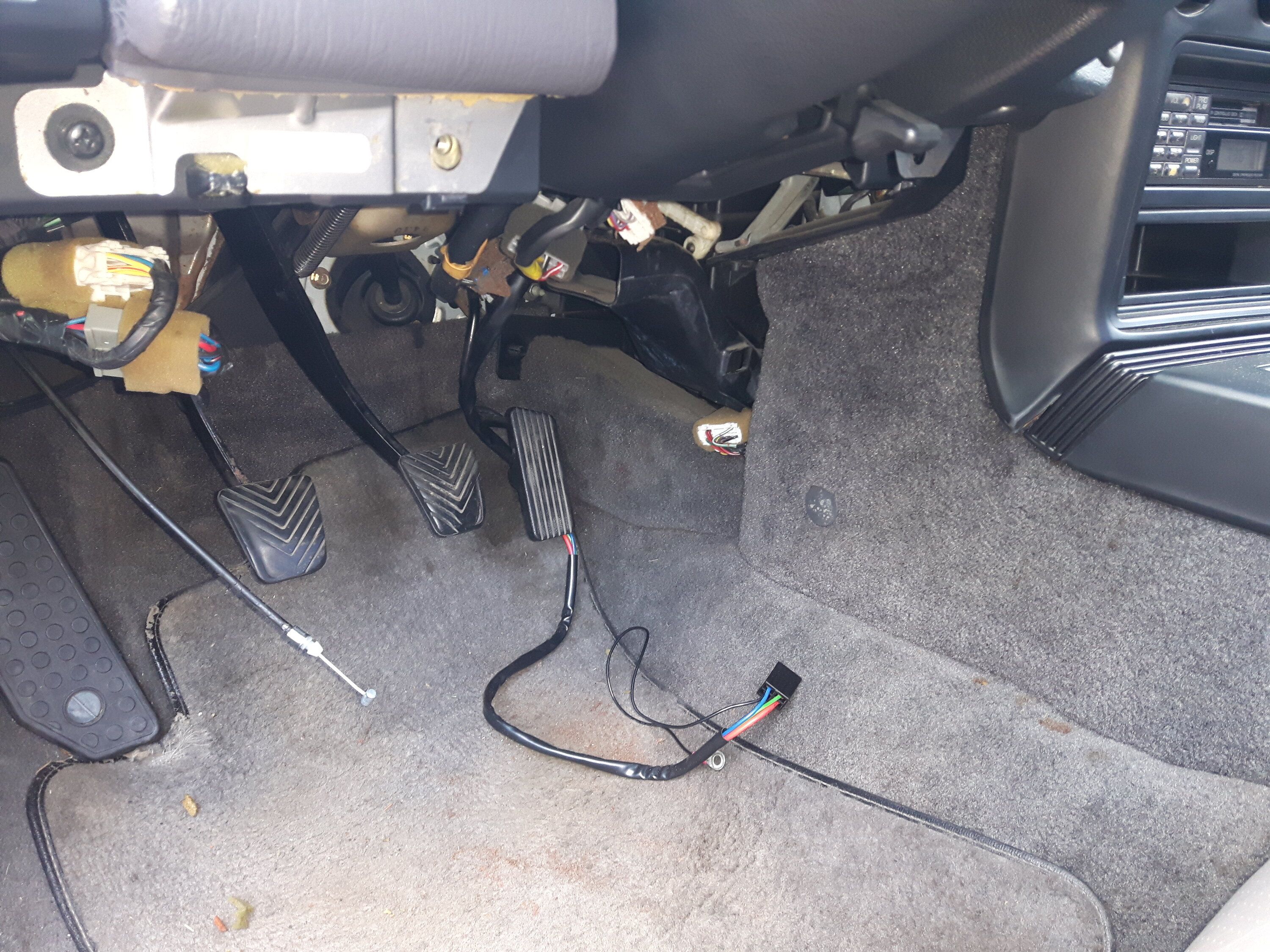

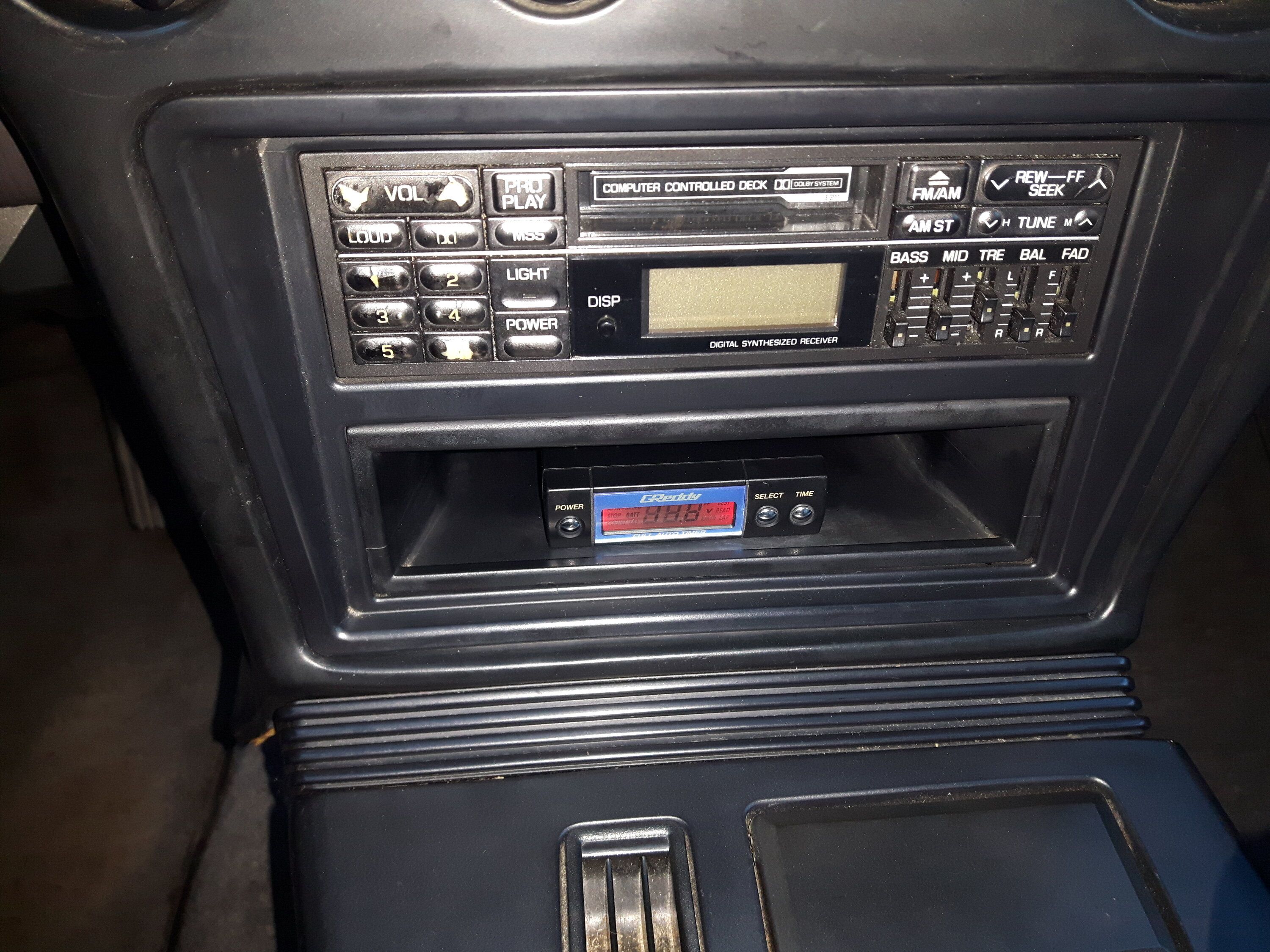

This weekend I spent time installing a Greddy Turbo Timer. I had this Turbo Timer back in the day and wanted the same setup as before. I understand these are kind of pointless, but just thought it would be cool to have it. I even got the harness adapter to avoid chopping into the factory harness.
I followed this thread to assist with my install. HKS Type 1 U.S Spec Turbo Timer Install | DSMtuners
I removed the lower piece under the steering wheel and connected the harness and ground. That lower interior piece has some peeling issues that will address going forward.

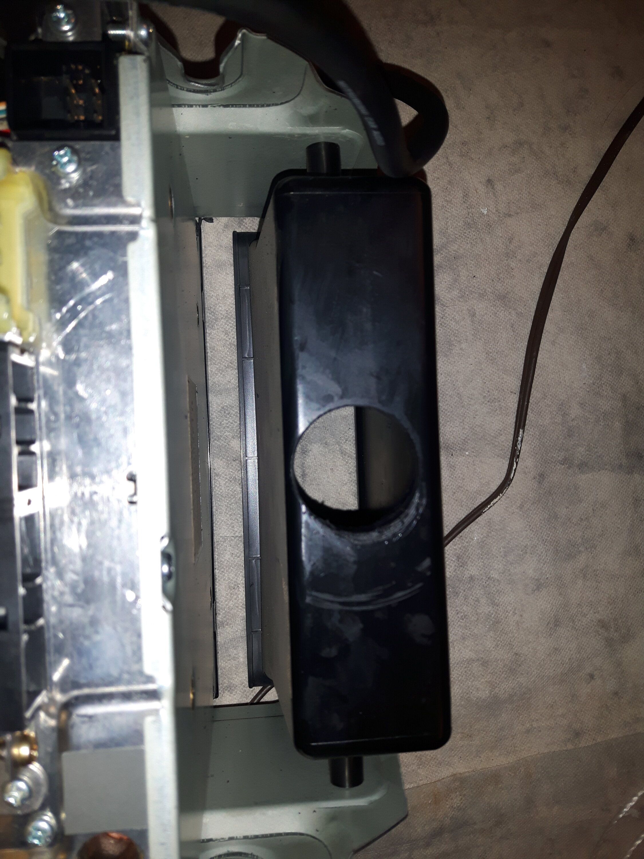

I installed the Turbo Timer in the extra radio din. I had to cut out a hole in the back with the drill.
I did not take a picture of it, but I also connected the supplied wire to the emergency brake. The instructions are provided in the link above. The final product.

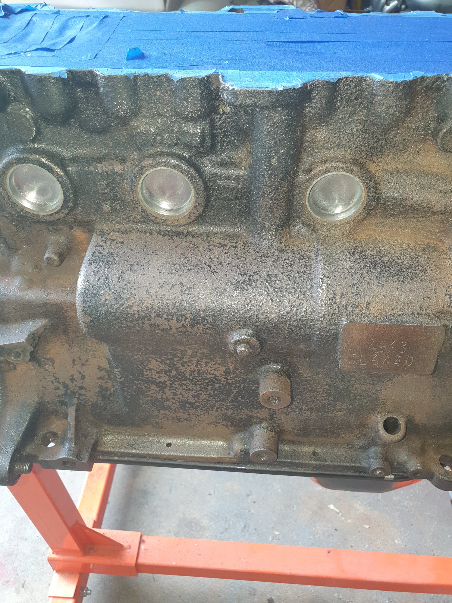

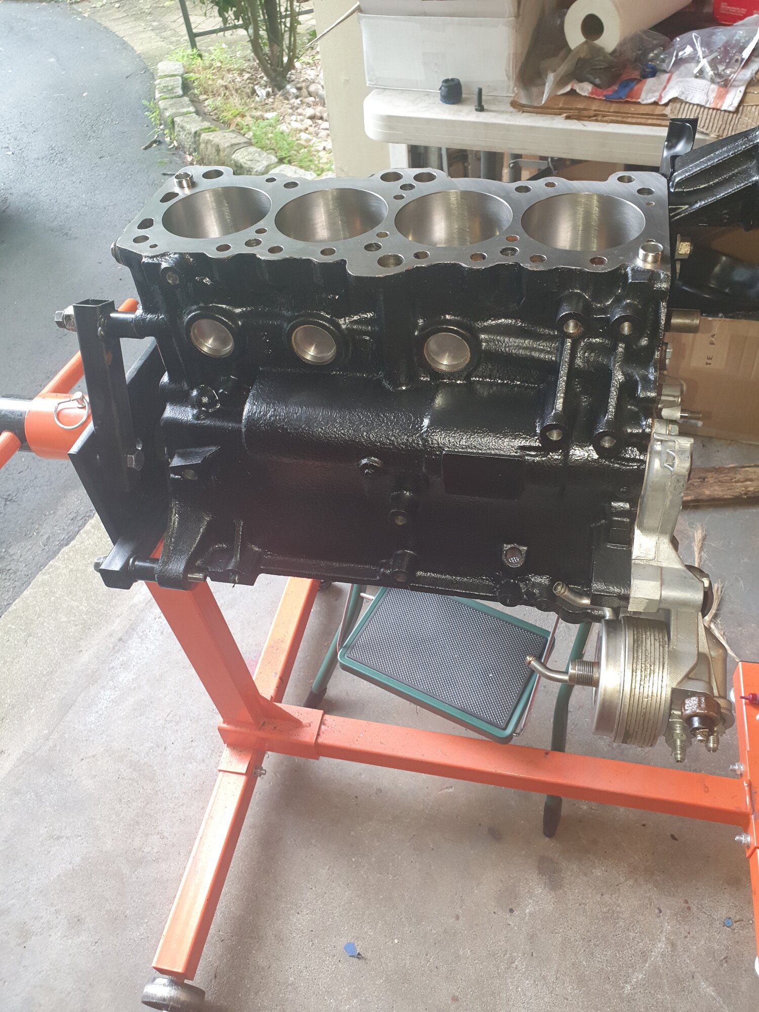

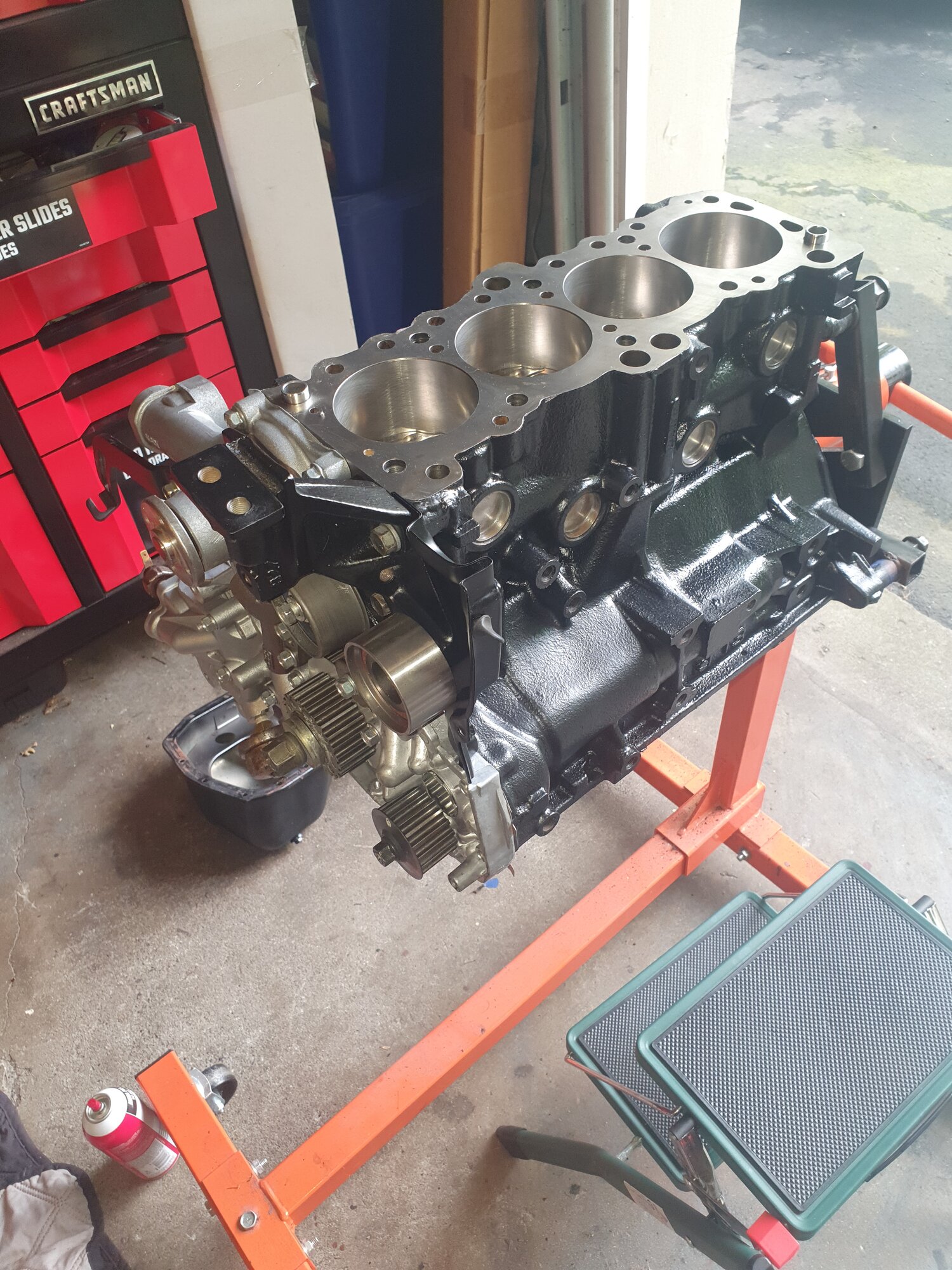

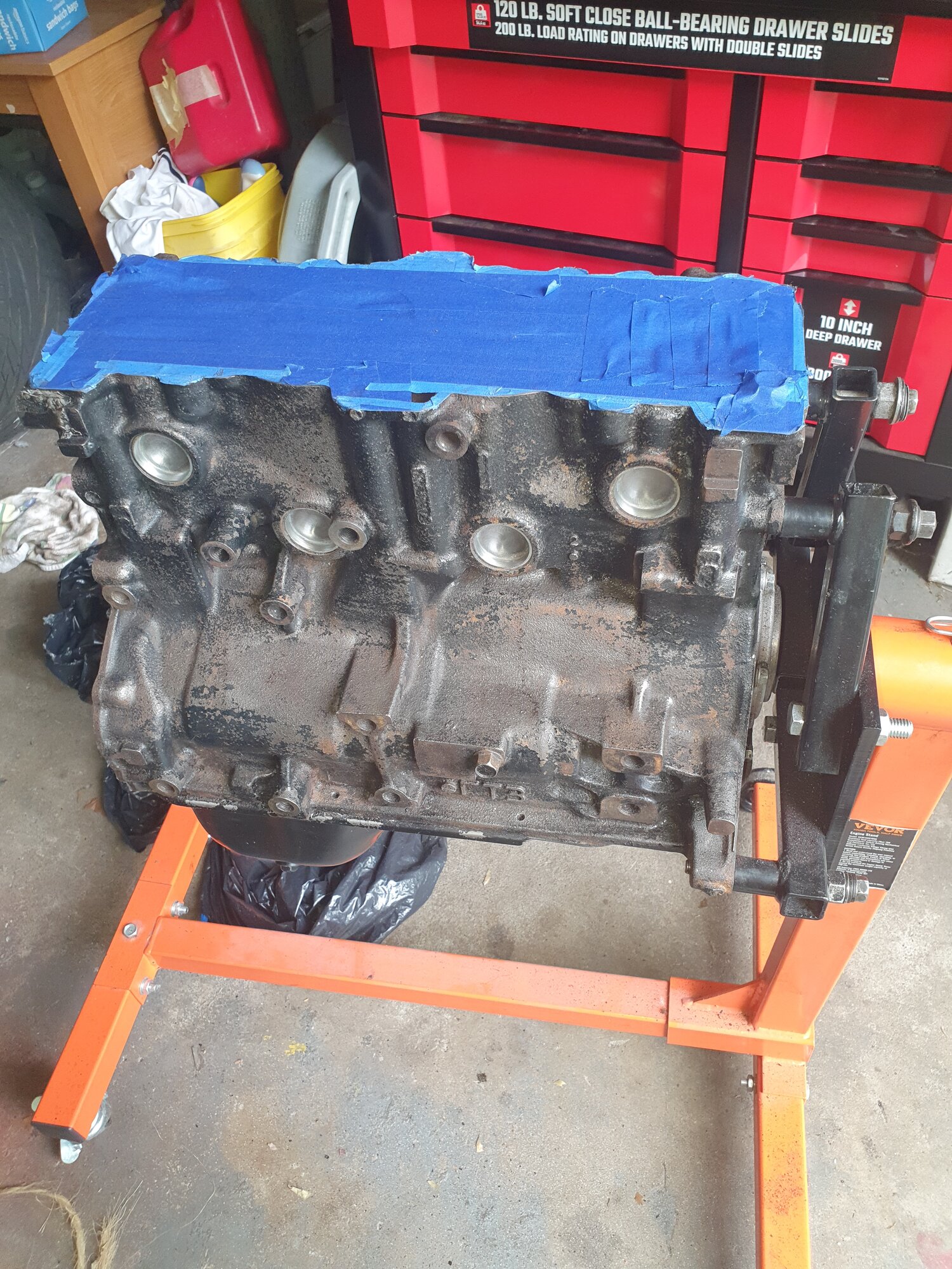

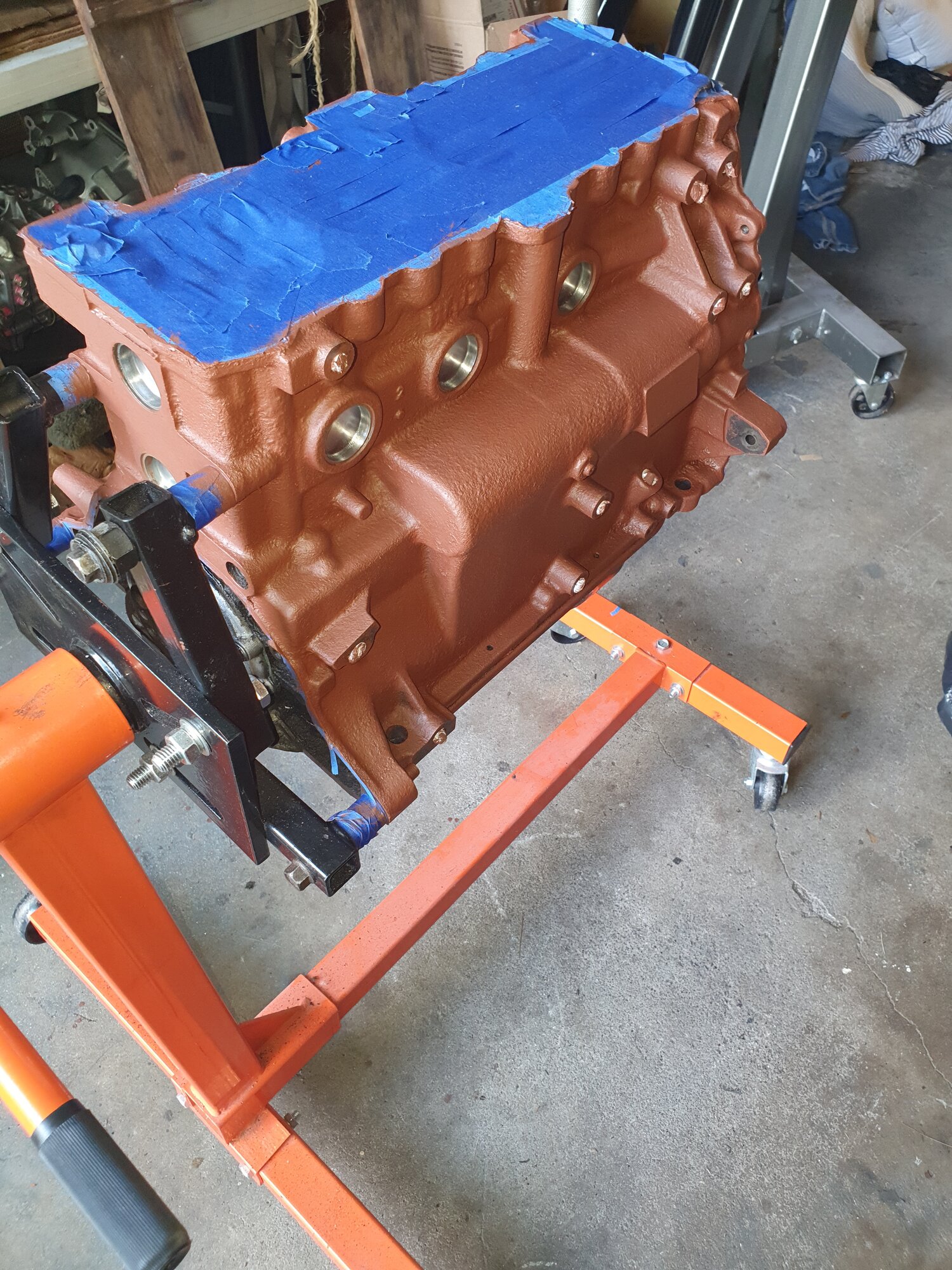

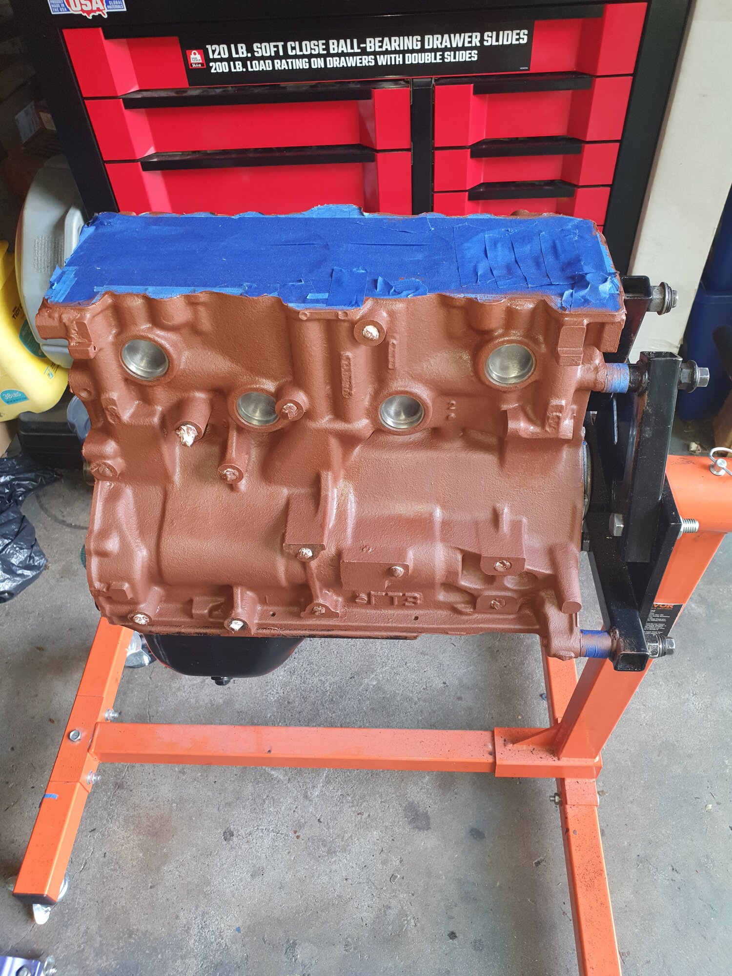

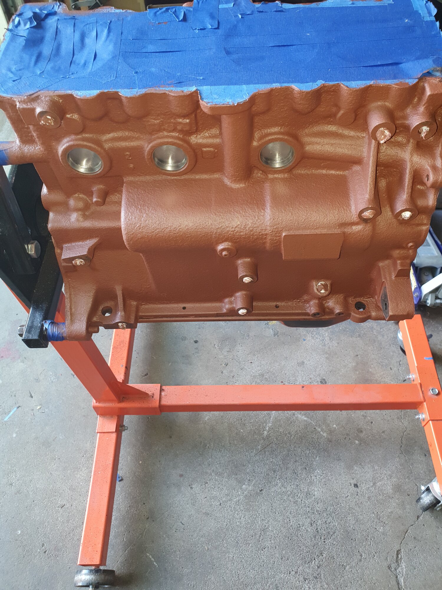

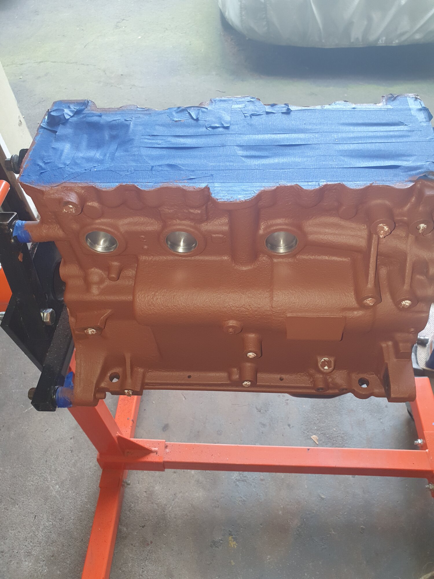

Purchased a brand new built block. Machine work and assembly look good 👍. The main issue was whoever installed the water pump, OFH, and Front case went overboard with the RTV. Also, the block was spray bombed and was starting to flake.

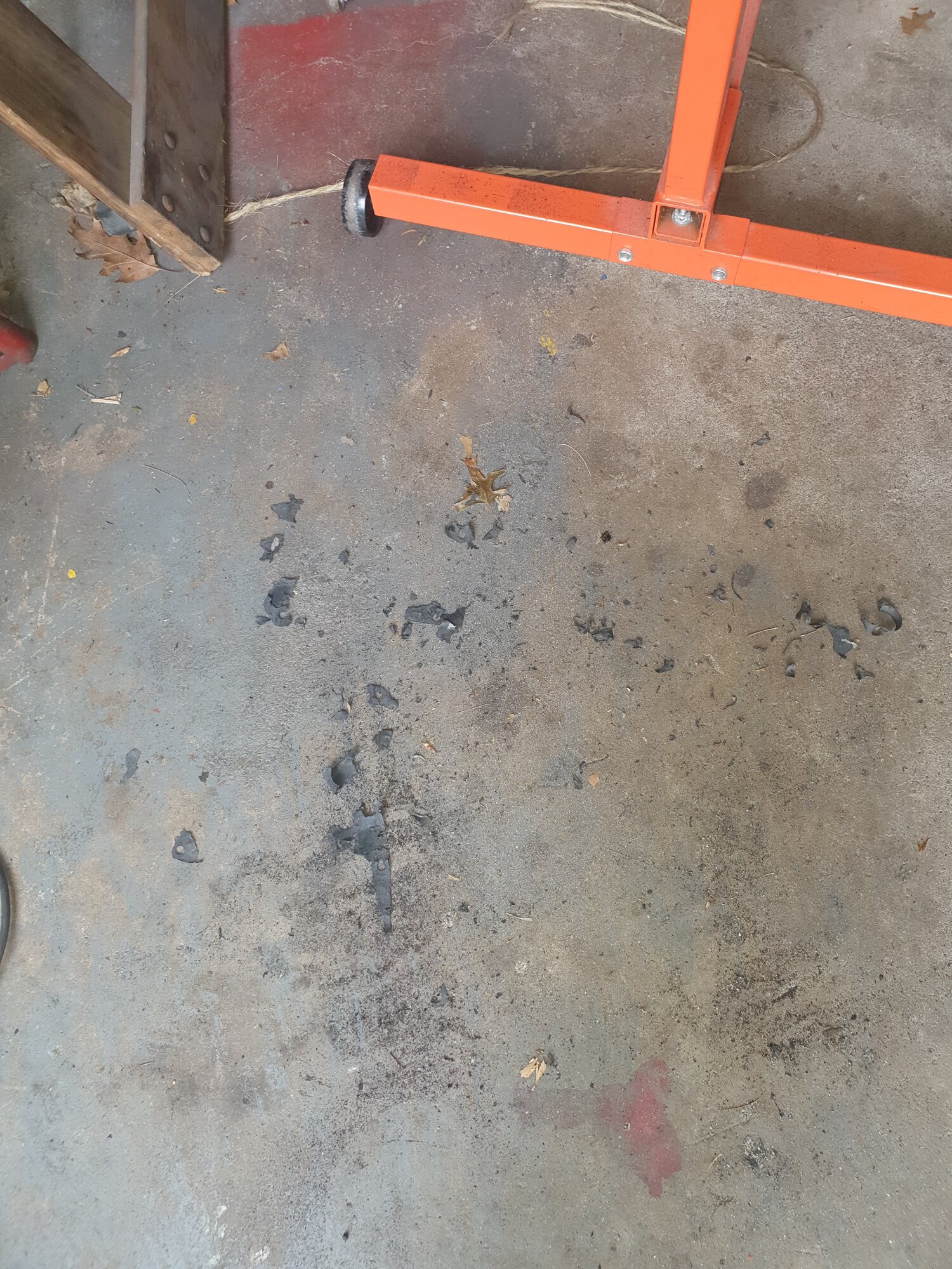

I ripped everything thing apart and starting brand new.

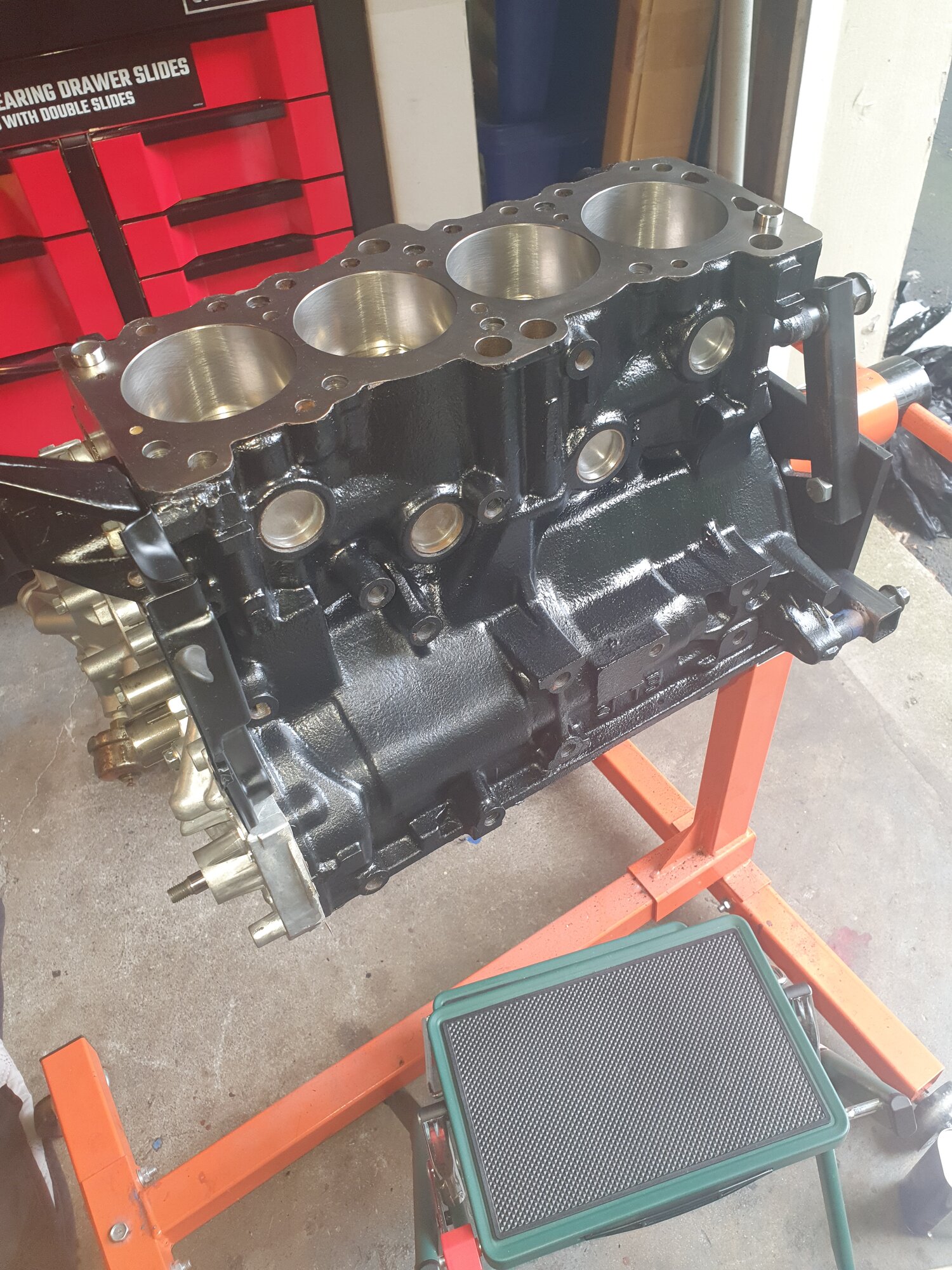

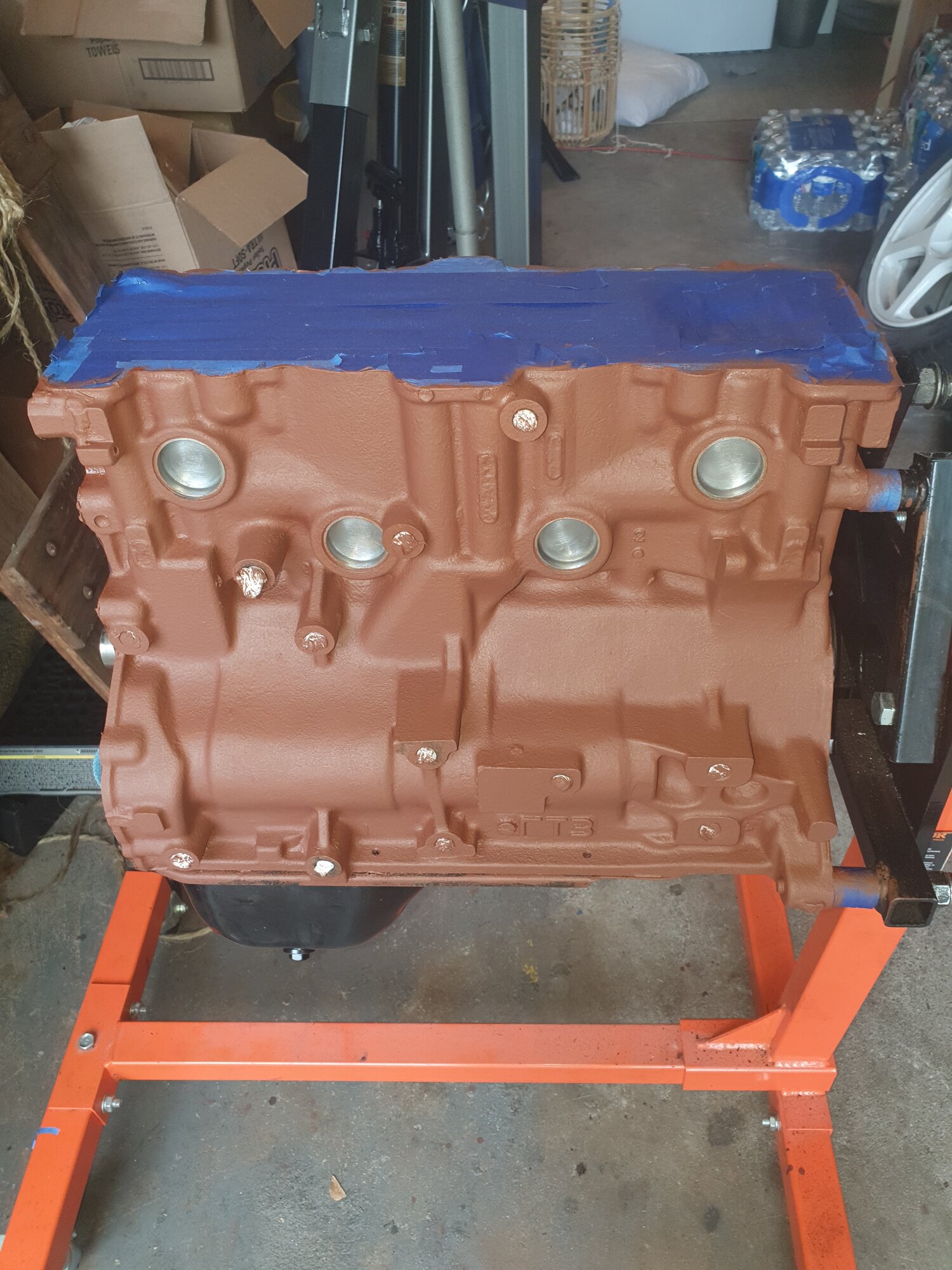

I just finished priming the block today. Here is pictures of the block prepped,the products I used, and how it turned out.

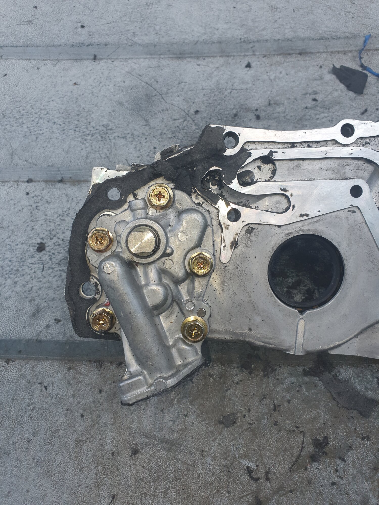

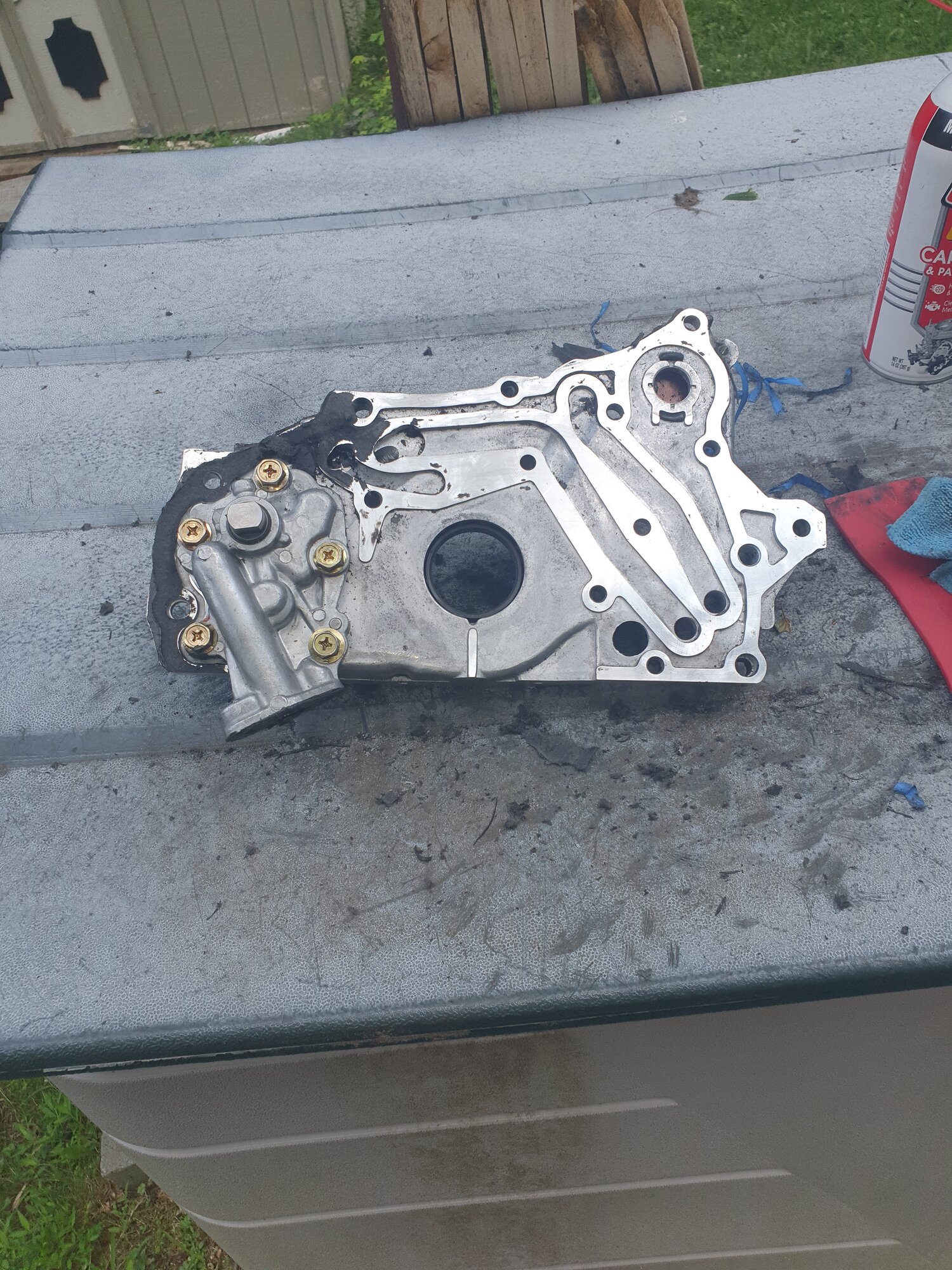

Here is the front case completely solidified in RTV. A big freaking mess. Also, I noticed that the oil pick up tube was RTV'd to the pump, jnstead of using a gasket. For some reason RTV was used on the side engine mount...It was the craziest thing I have seen done.
I used a nylon tool and brake clean to clean it up, but it's going to need a thorough going through before install.
