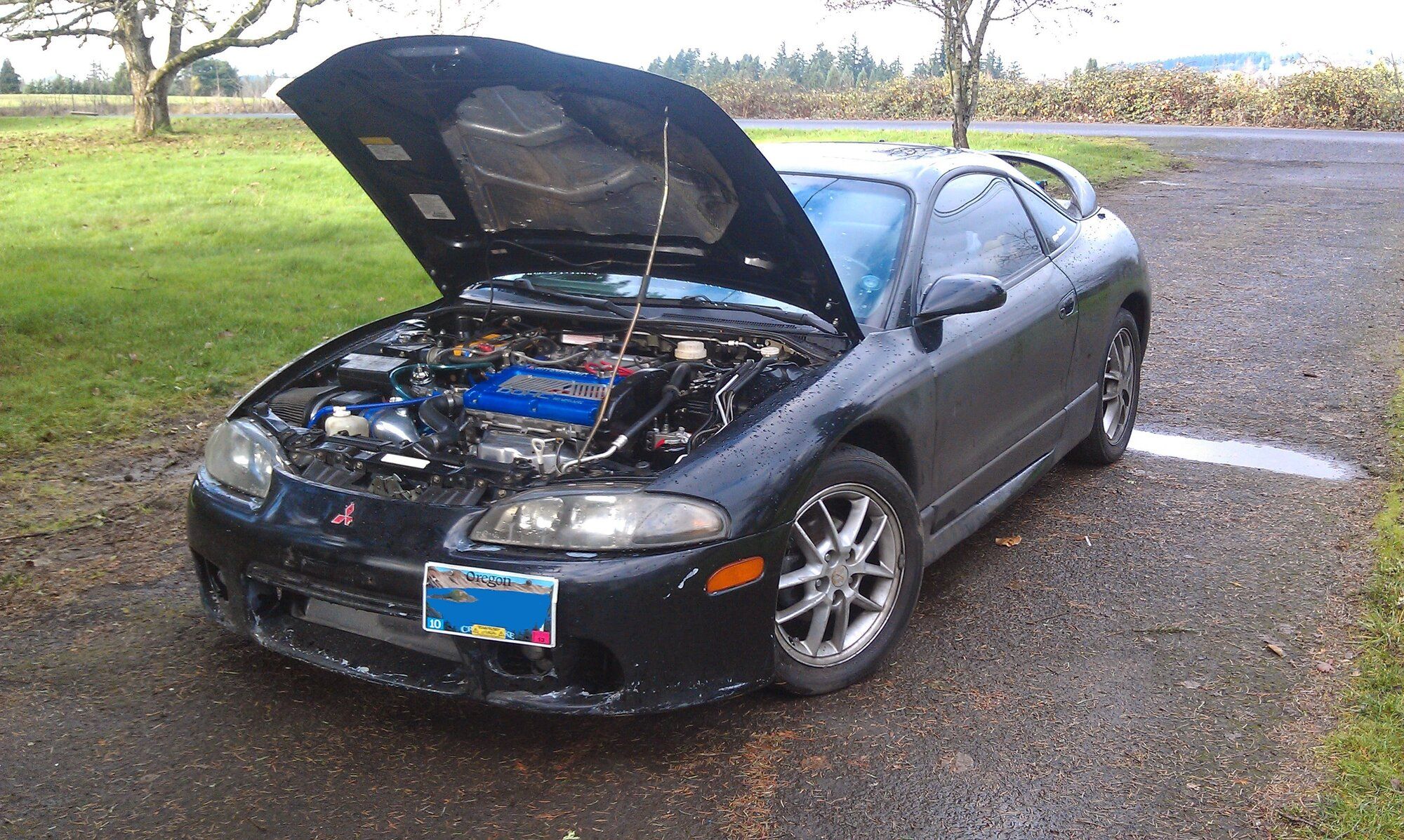

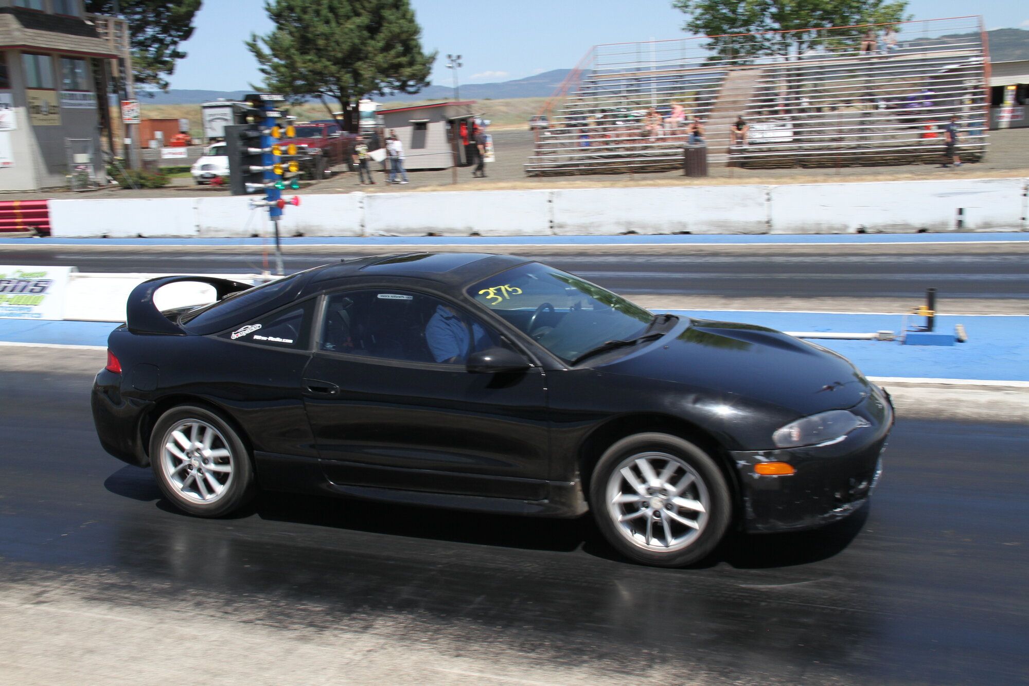

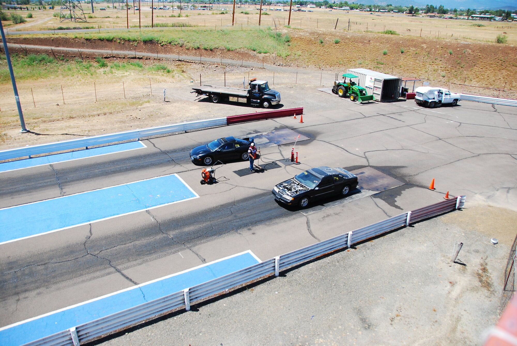

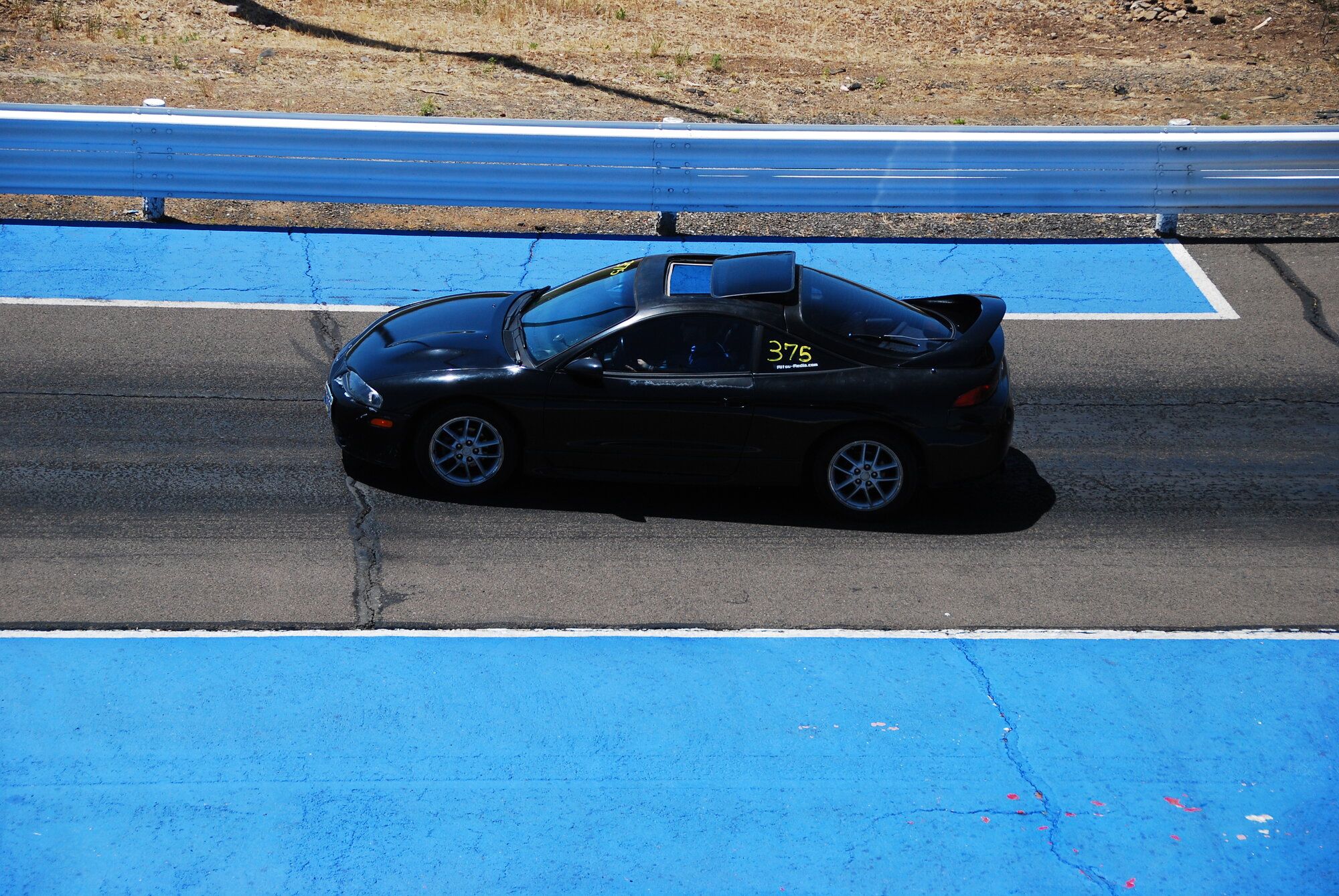

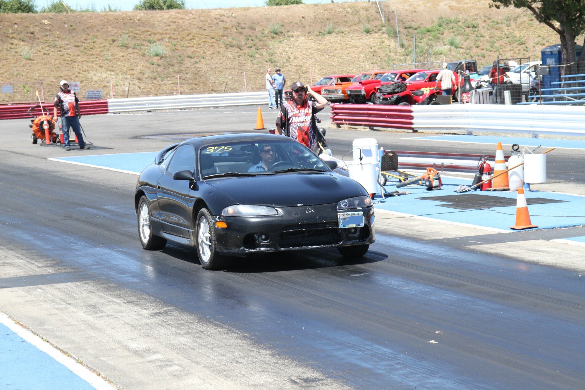

My car is still basically stock. I have a 14B or maybe my Small 16G at this point and a manual boost controller but no other supporting mods, stock injectors, SMIC, stock tune. My car can only handle like 12 psi of boost. Stock for me was 8-9 psi. But I wanted to see what my car would run and I'd never been to a dragstrip. Well, I tried three runs and each time I launched pretty good and could feel the pull of the boost, but then by the time I shifted to third gear I would lose power. It was like I had let off the gas and my car started slowing down even though I was still at WOT.
I couldn't figure out what was wrong at first and I was sad because this girl in this old Camaro was basically neck and neck with me for my last two tries and I was curious to see who would win (not the car with no hood in the picture below, that was just my first run). It was a hot day and we determined I had heat soaked my intercooler. The stock SMIC just could not cool down the air and the ECU pulled a significant amount of timing. For my last try I sprayed water on the front of the intercooler hoping the extra convection would help but it didn't really. Once I started driving normally everything was fine again. After I left I even did some hard pulls on the road since there were no cars and in the shade. It pulled hard just fine. I need to install my VRSF FMIC I bought...

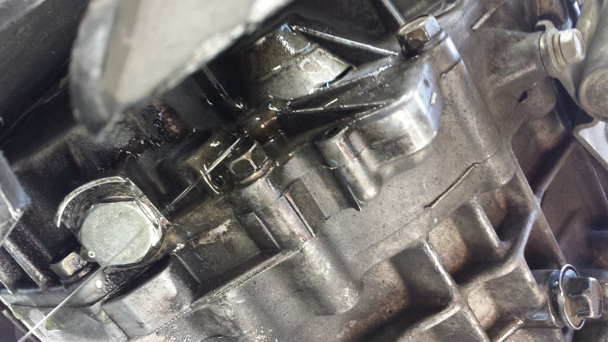

I thought it was coming from the drain plug. But when I took a rag to it and tried wiping it away, I found that it was leaking in a spot that was much higher up. When I wiped the fluid away, it started pouring out faster! There was a hairline crack where the casing was super thin and it opened up from my finger pressure against it wiping the fluid away. In the picture, you can see the stream of fluid and at the top middle of the picture is the crack.

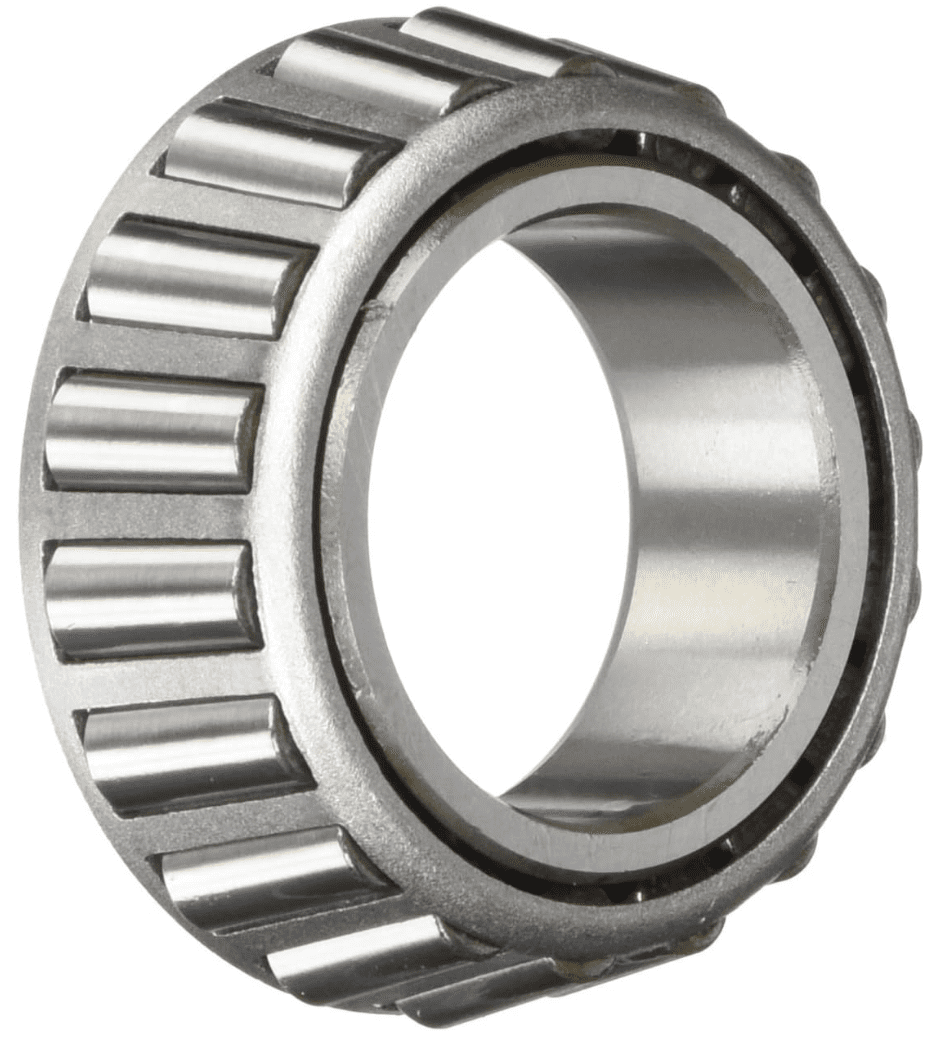

I work as an engineer so I brought it into my work and I had the technicians disassemble it so I could see inside what was wrong, and I had never seen the inside of a transmission before. Well, apparently one of the bearings failed and pieces of it were strewn all over the transmission. When the bearing failed, it caused one of the gears to flop around everywhere and as it turned, it machined through the aluminum housing.
This is the kind of bearing that failed. About half of those little cylinders were all over the transmission. The others were still mostly inside the bearing.

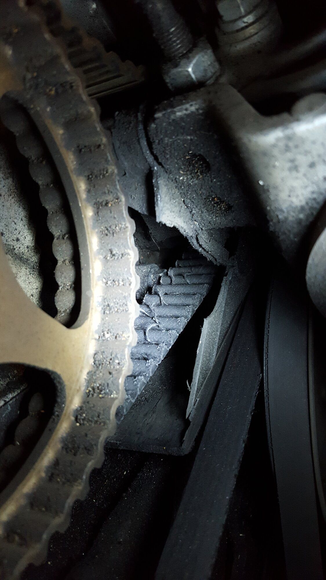

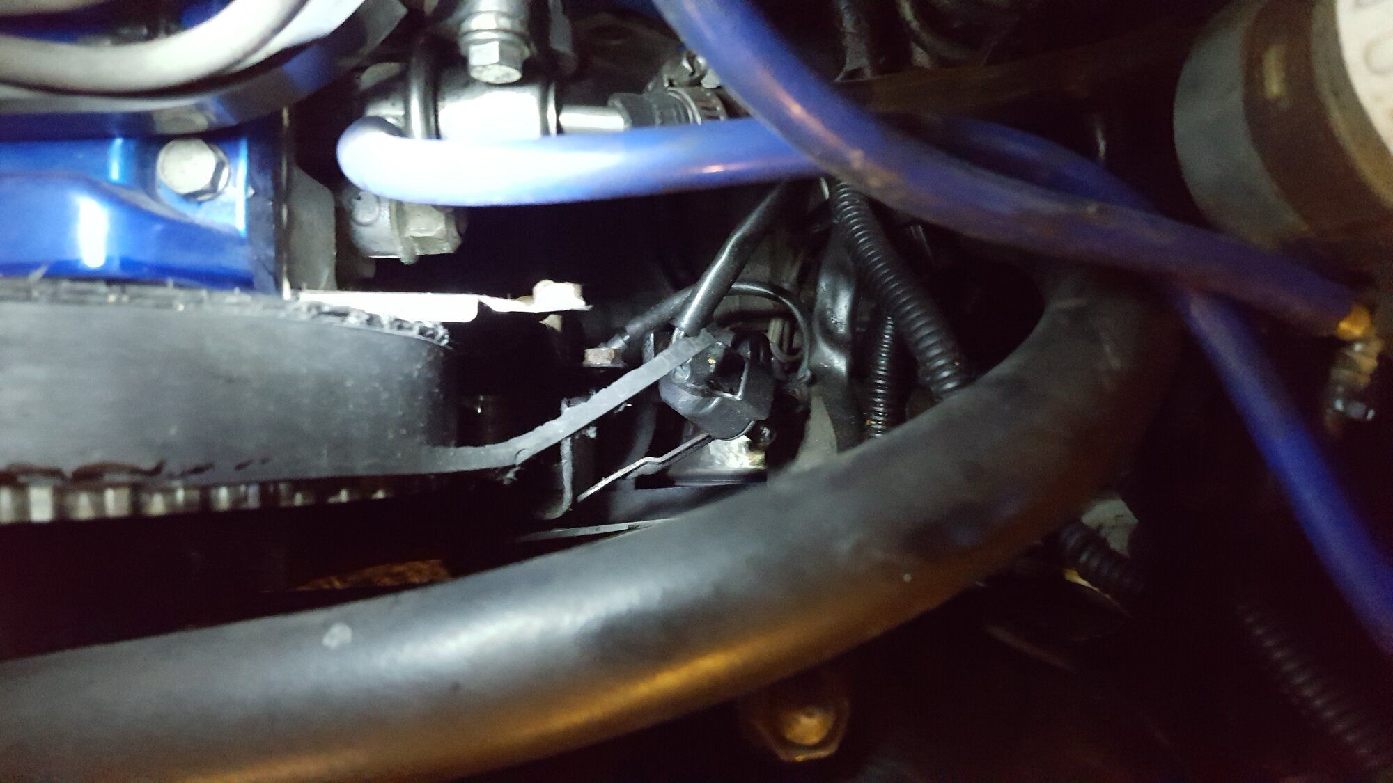

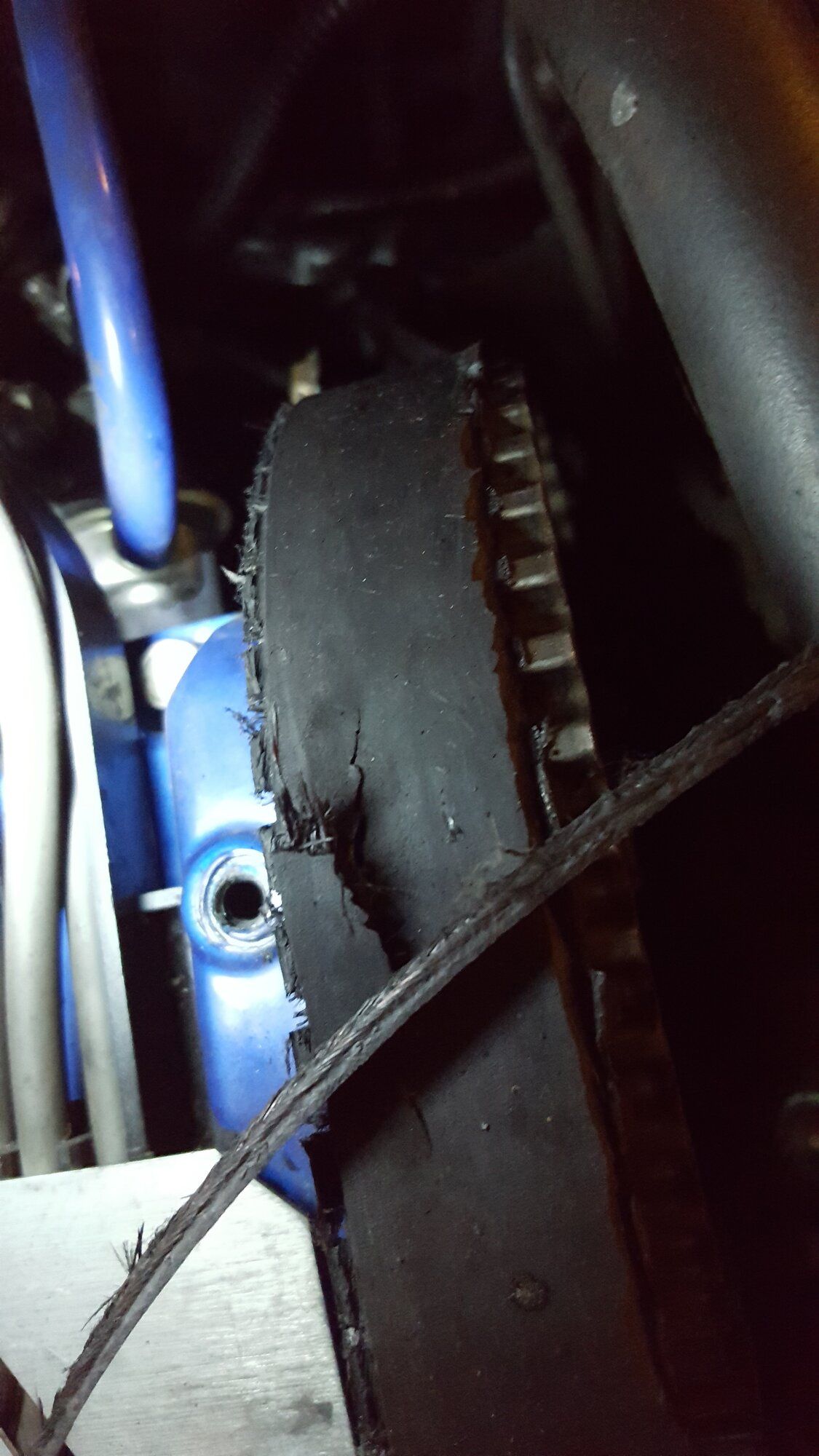

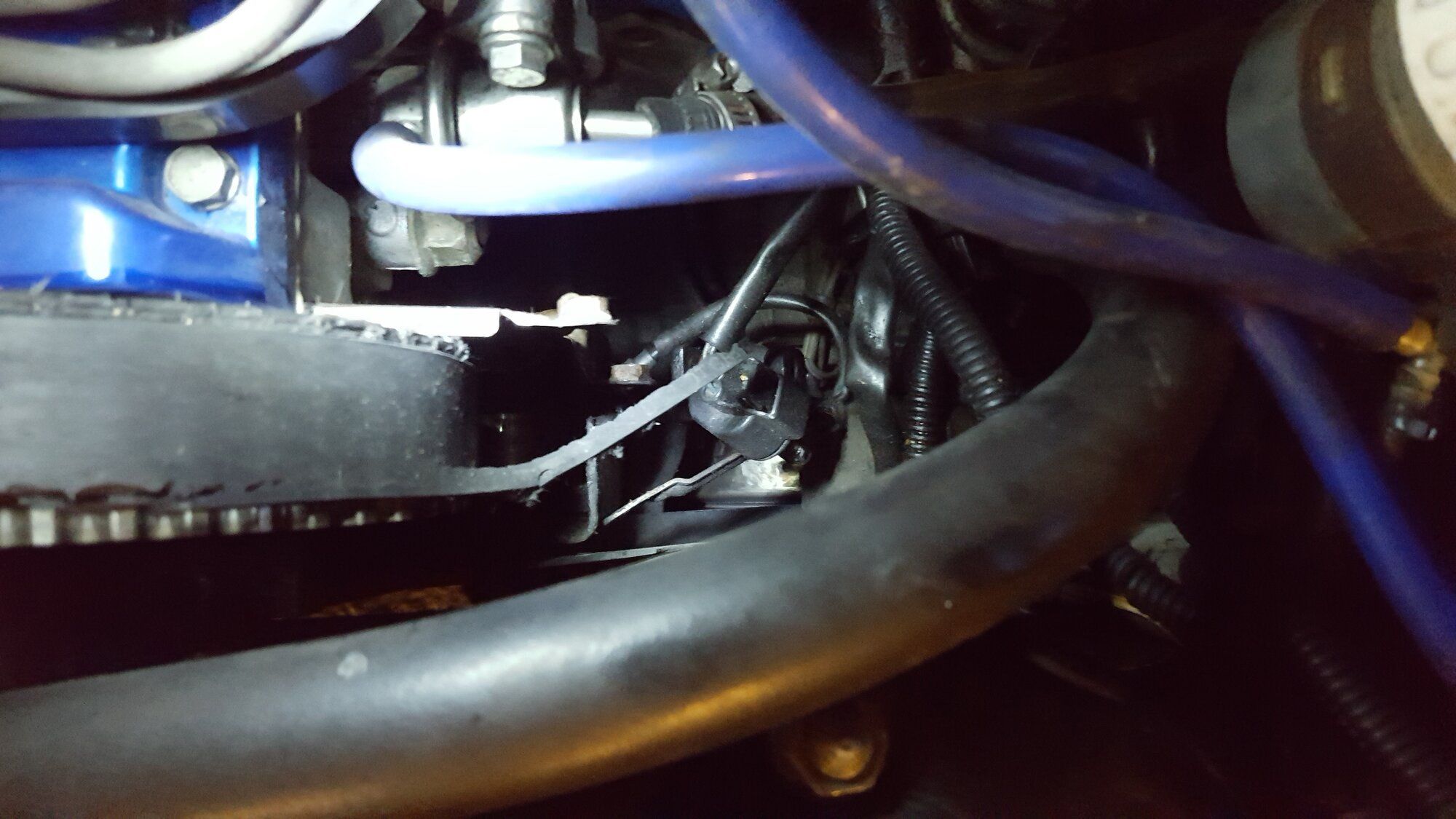

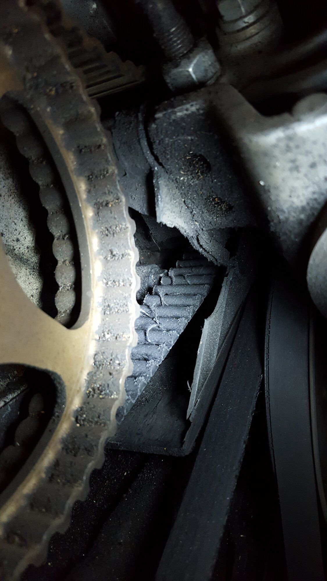

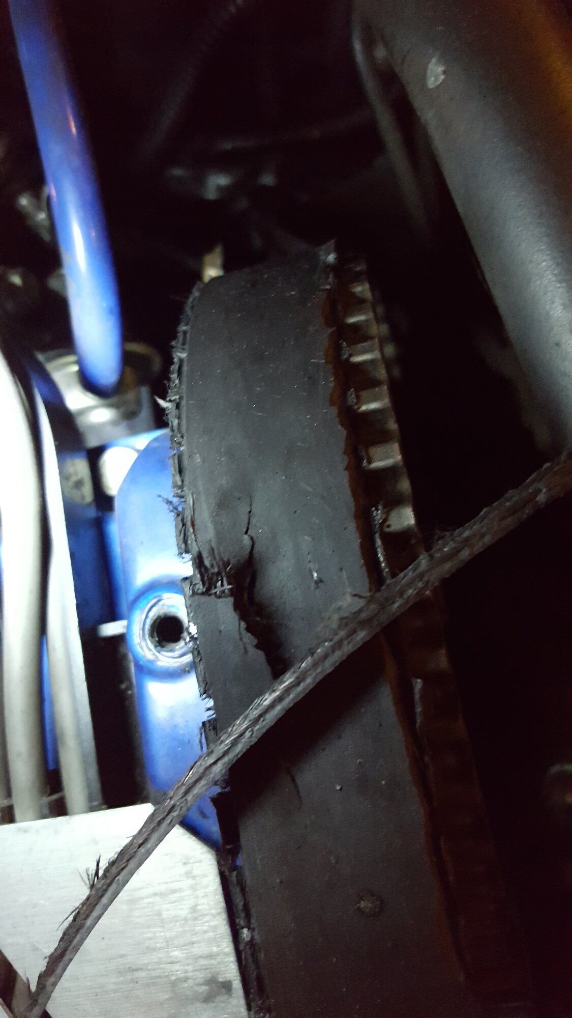

I was sitting at a stop light and the car just dies for no reason. It was just before the turn into the apartment complex I was living at the time and a slight hill. I tried starting again and couldn't so I put her in Neutral and when the light turned green, no cars were coming so I just coasted forward, turned left into the complex, and right into my carport parking spot. I popped the hood and removed the top timing belt cover. What I find is a broken timing belt. It was still under tension but there were chunks broken off, long strings of it I could pull out, and looks like it may have skipped at least one tooth. 😢

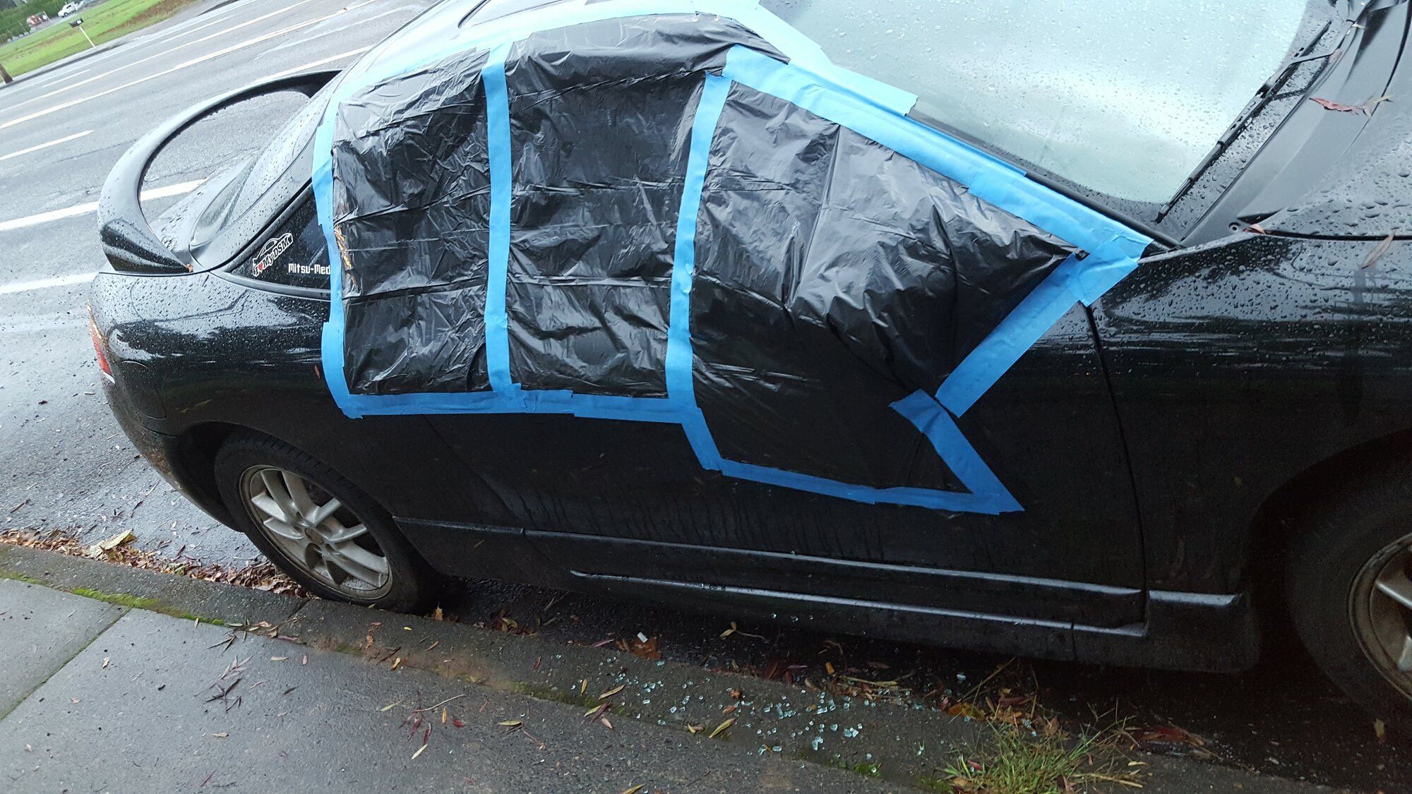

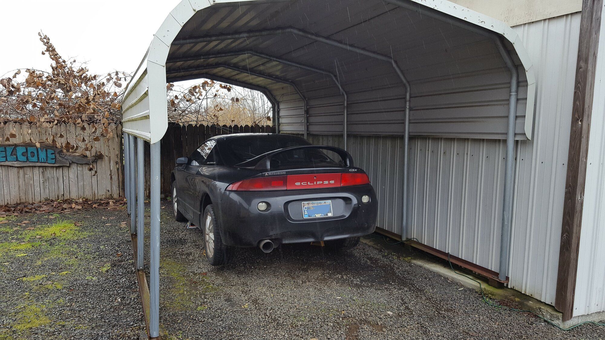

A few days later, it looked like the passenger side glass had ice on it but it was quite warm out. I touched it and the window just shattered to the ground in a million pieces. I think some passerby just hit it and it didn't break all the way. I had to call one of those mobile glass repair shops to come out and fix it but until then I taped some plastic bags around it to close it off and protect against rain. I had the glass fixed but I still had no solution for fixing her so I had to move her to a storage unit. In town they are EXPENSIVE and very few actually let you store a car. I found a cheap one a little over an hour drive away and towed her there. He didn't have any units available but he did have an open car port that he let me rent.
I put her partially up on jack stands so all her weight wasn't on the tires that were sure to go flat over time and there she sat until I could rent a house or something where I would have a garage to fix her. It was even raining that day...
That's a bummer! when your rebuilt the engine, did you use new machine head bolts from the hardware store on the oil pan? IIRC, one of them has to ground down a little to avoid interference or your risk shaving the timing belt ever so slightly until catastrophic failure. Kinda like whats going on with the pic. Just an idea.
Two of them are shorter and need to bolt into the front case where the timing belt is. I think they were in the right place.
I actually found what I think is the issue, I have just been running into issues with my rebuild and haven't updated my build thread. I will do that soon!
