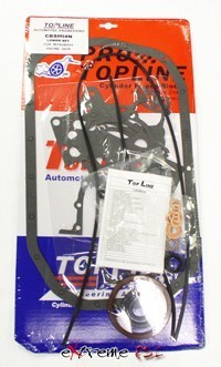

Here are some 2G 7 bolt bottom end gasket kits. Not OEM, you'd likely have to piece that together yourself. RTM carries a lot of OEM gaskets. I used a Fel-Pro kit myself with some OEM gaskets here and there for areas I thought were important, but don't remember which ones I used anymore.
1g 7bolt bottom end gasket kit fit the 2g 7 bolt motor?
Front case, OFH gaskets are the same as 2g. Water pump. thermostat housing gasket etc are different.
I recommend to use OEM gaskets at least for front case, OFH, main seal case, water pump if the budget would allow you. You won't regret.
