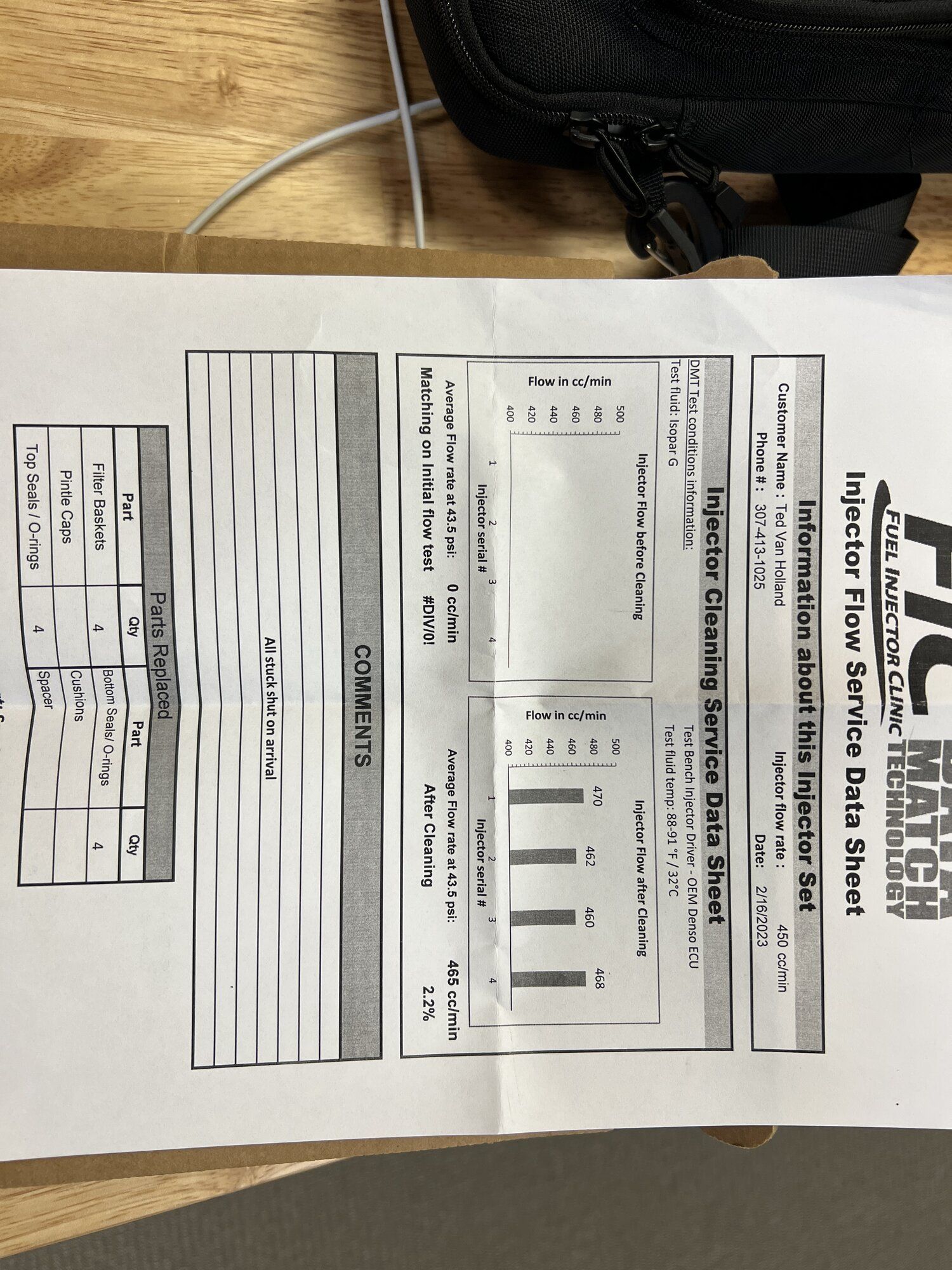

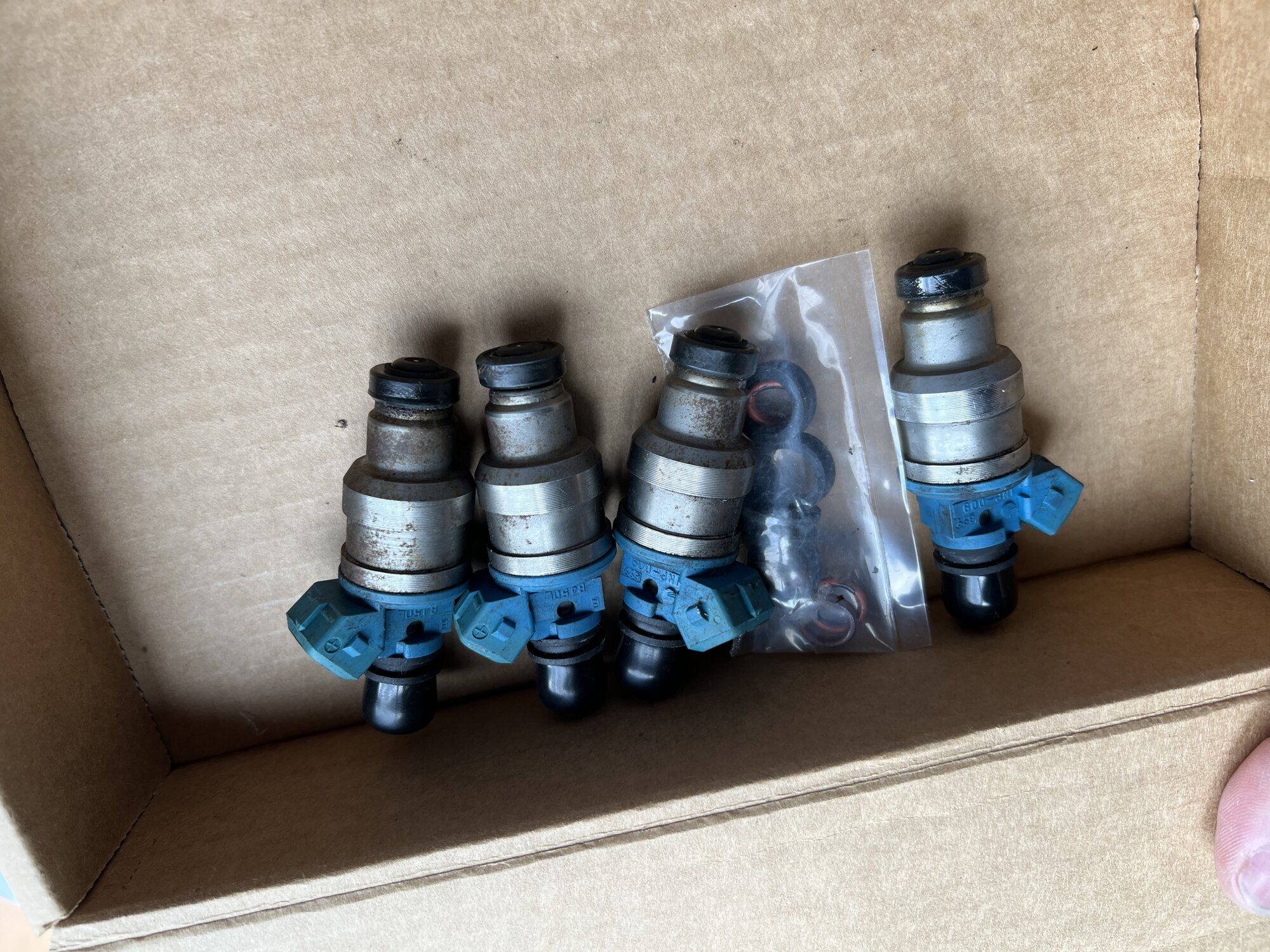

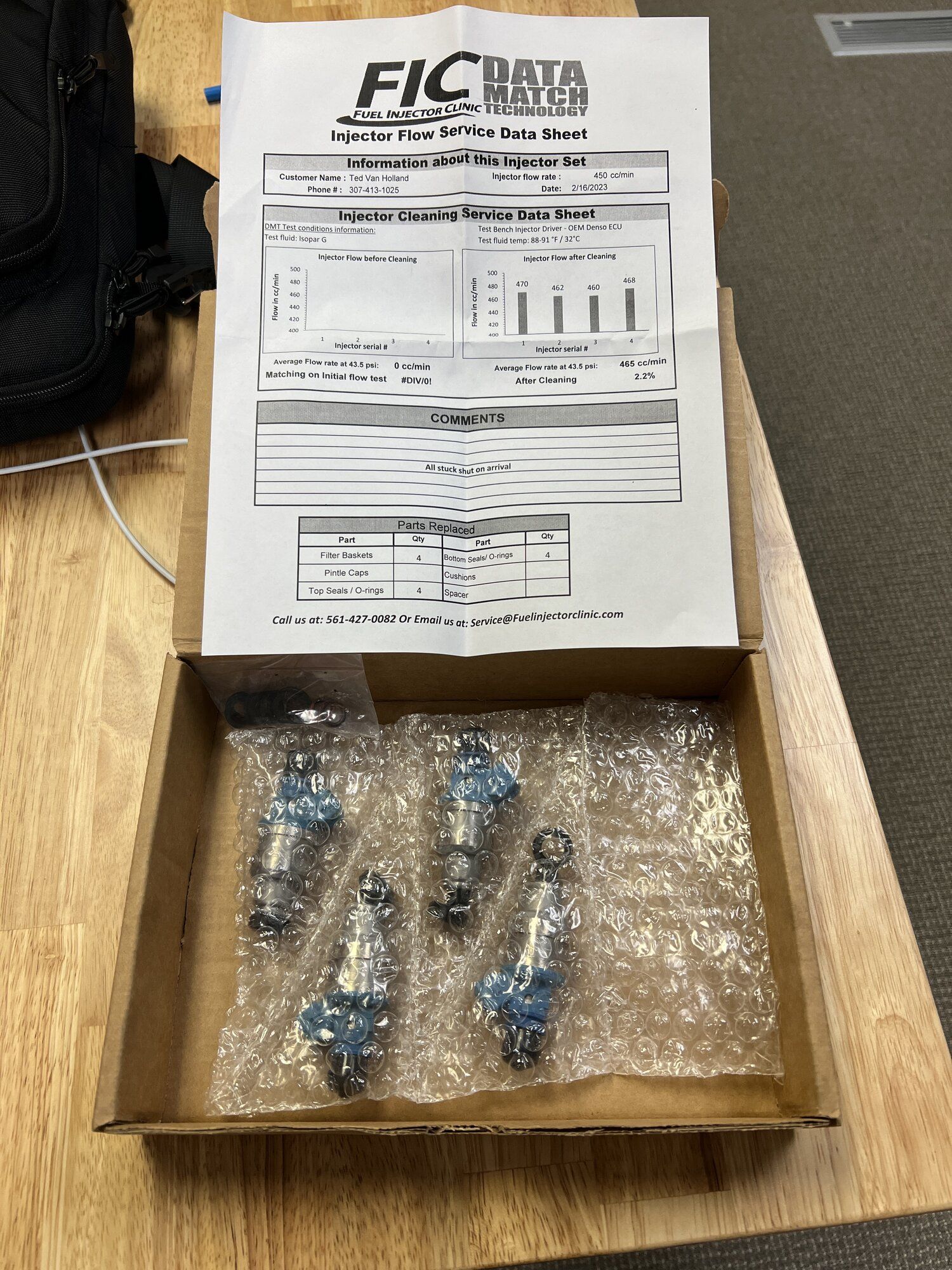

Bought these a while back from another member. OEM blue top injectors. Finally got around to sending them to the pros for service. Good thing because they were all stuck. All better now.
Trying to decide when to swap them out for the originals in my car, and see what difference it makes. When I do, I’ll send those ones in for the same service, and see how they flow on arrival.
Thought folks might be interested in seeing their flow numbers: not bad for 450’s.

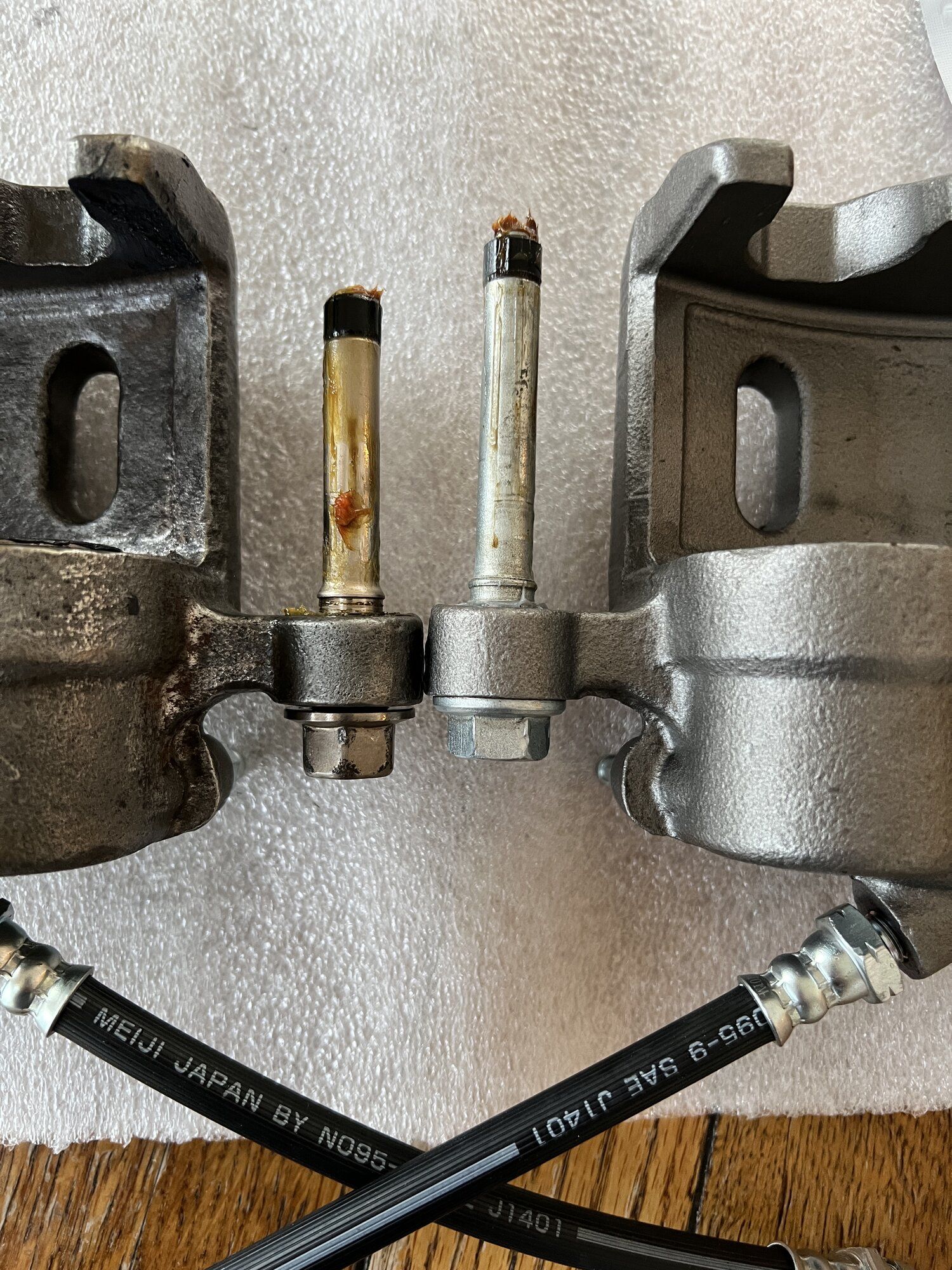

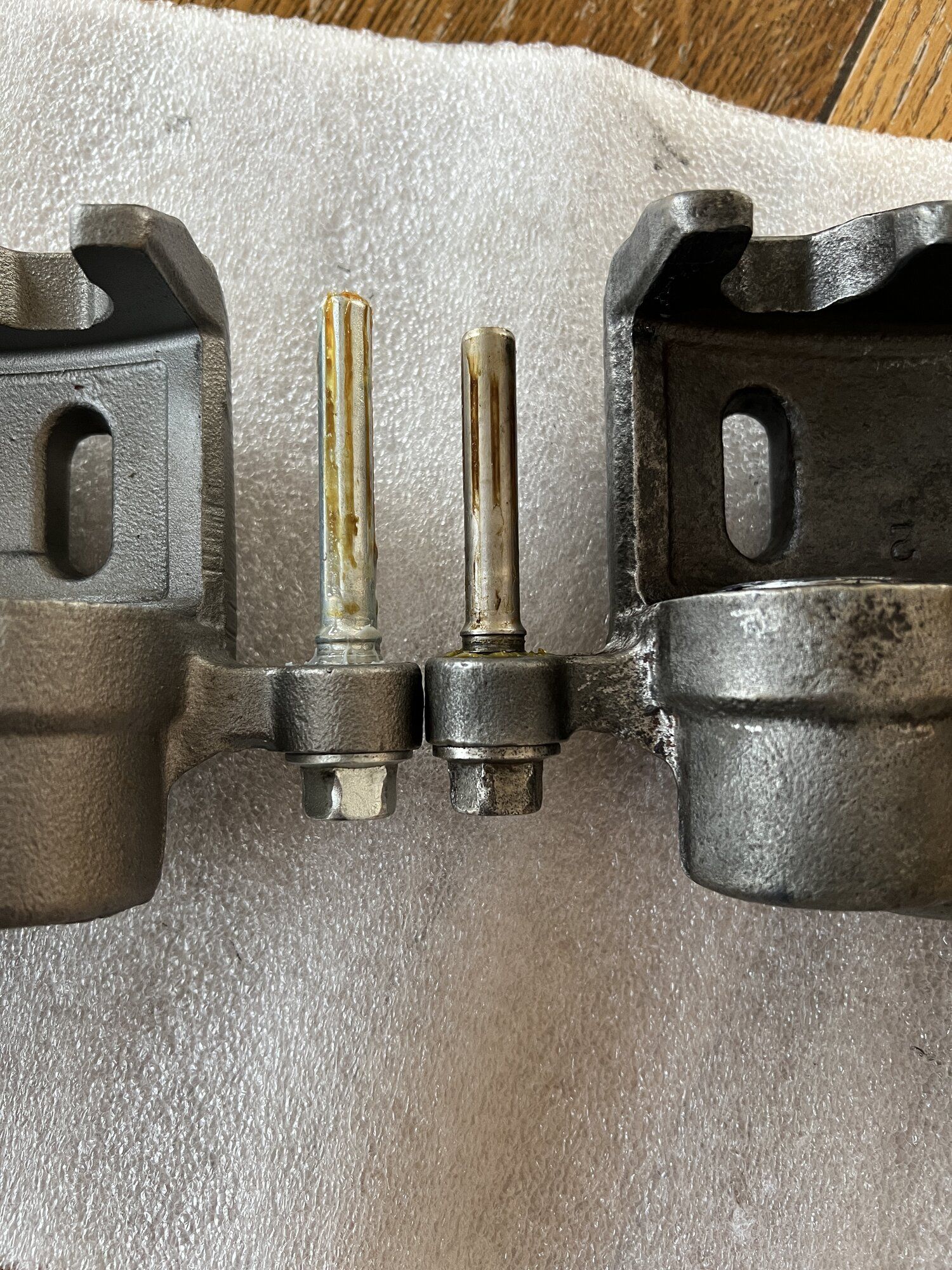

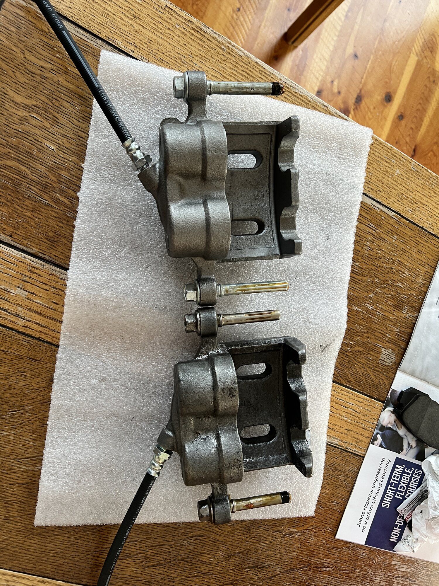

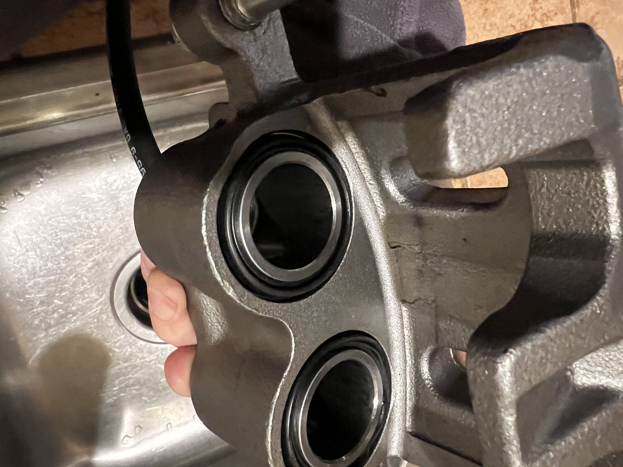

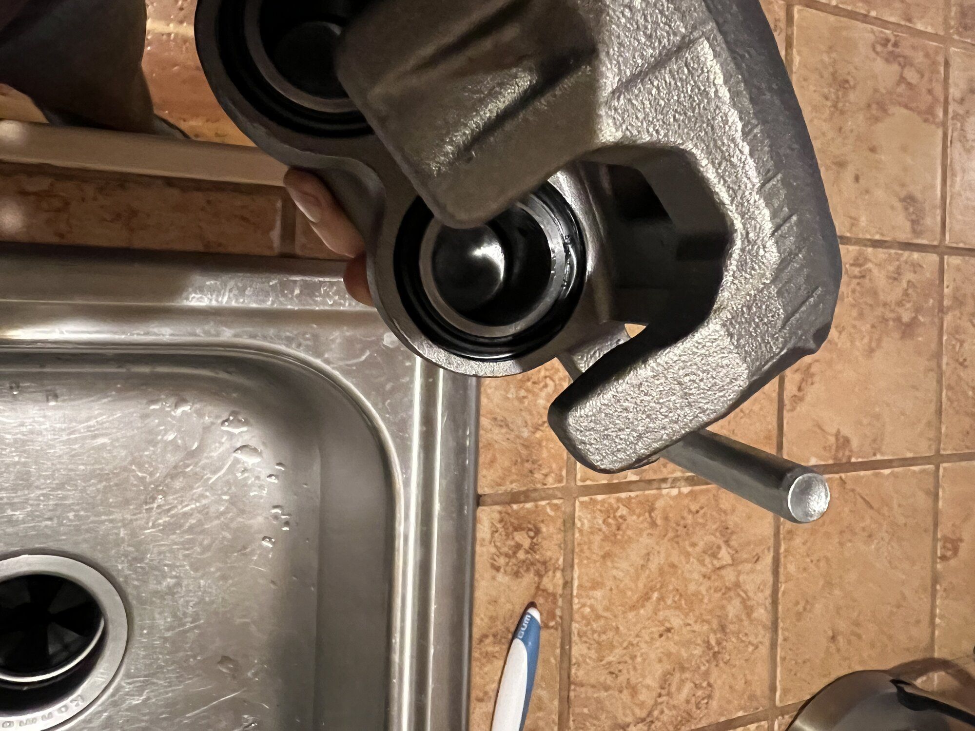

I should be removing the old front case gasket crud from the block so that I can start reassembling that, but it seemed more fun to go ahead with my 92.5+ twin piston brake upgrade. Got the driver’s side together in a jiffy. The the pass side wouldn’t quite slide over the rotor. Seemed like I couldn’t move the bracket far enough. Took them both back off, disassembled and found why. Guide pins on the factory rebuilt ones are longer than oem. The other one I rebuilt with just a rubber parts kit, and it came whole from another member. Fortunately I can rob the pins from the single piston calipers I removed. Those are the same.
But I started looking more at the Nugeon-brand rebuild, and one of the piston boots looks a little off. I’m tempted to strip it all the way down now for a thorough inspection.
New Parts!?!? Dang.
After further comparison it turns out the slide pins from my 90 single piston calipers are slight smaller diameter than the twin piston caliper uses. Looks like later 91+ pins would work. Now on hold as I get some proper replacements.

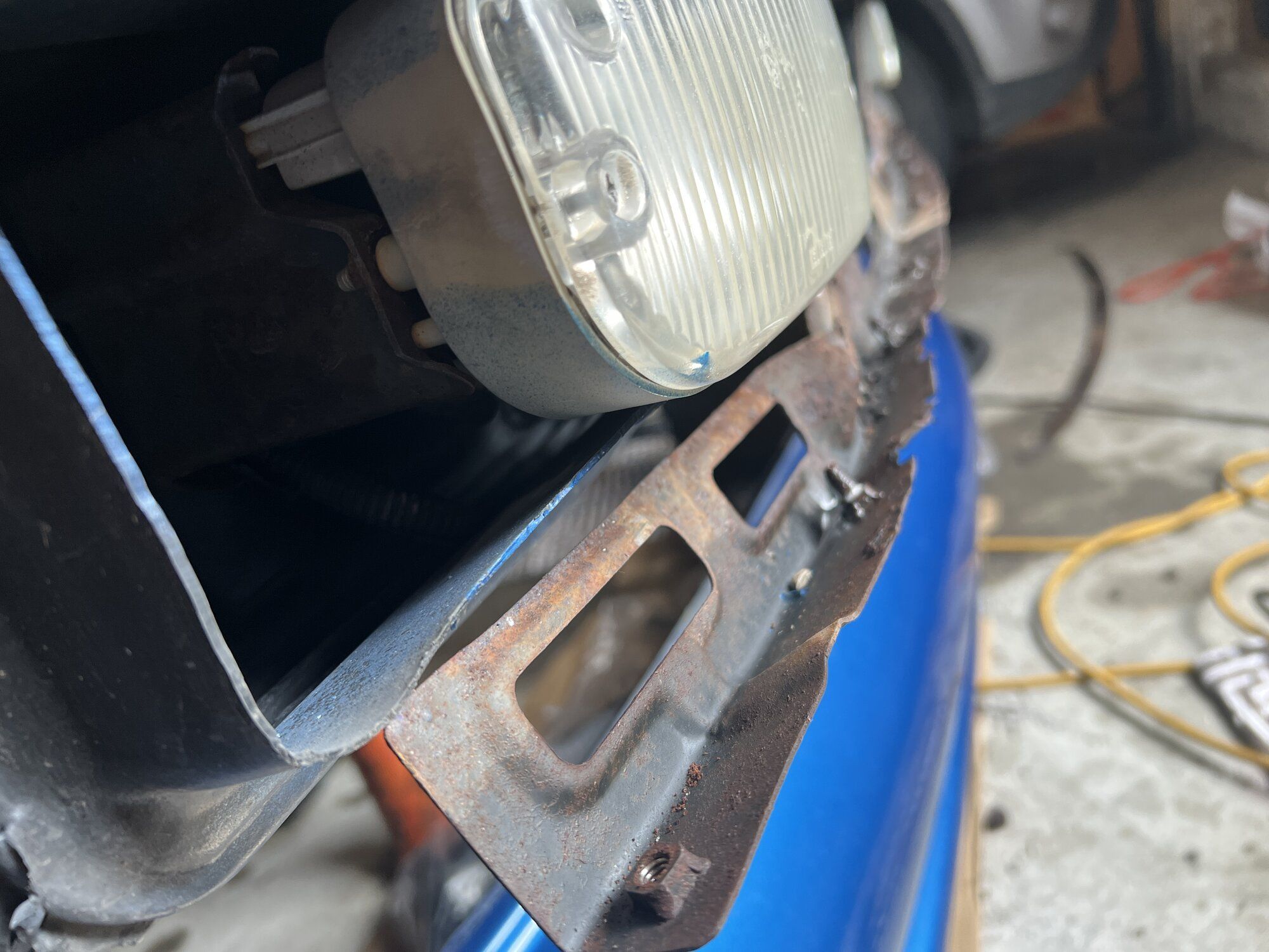

For some reason I decided to take iff the corner lights. Then the bumper cover. Didn’t really have a good reason, but waiting on parts now for front case, etc., so have to do something, right?

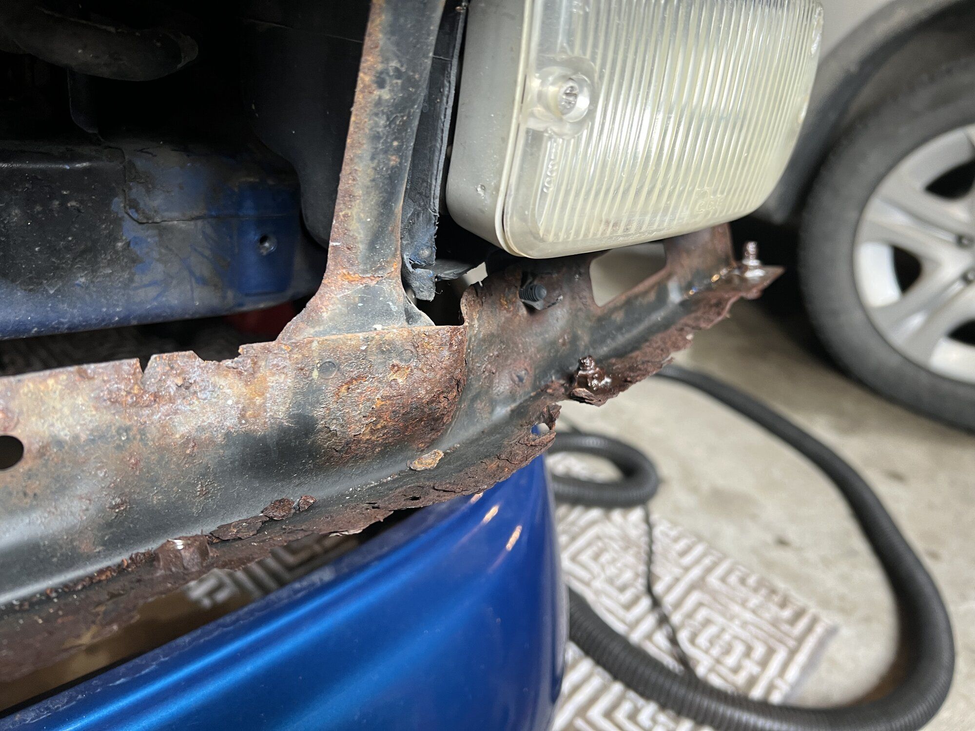

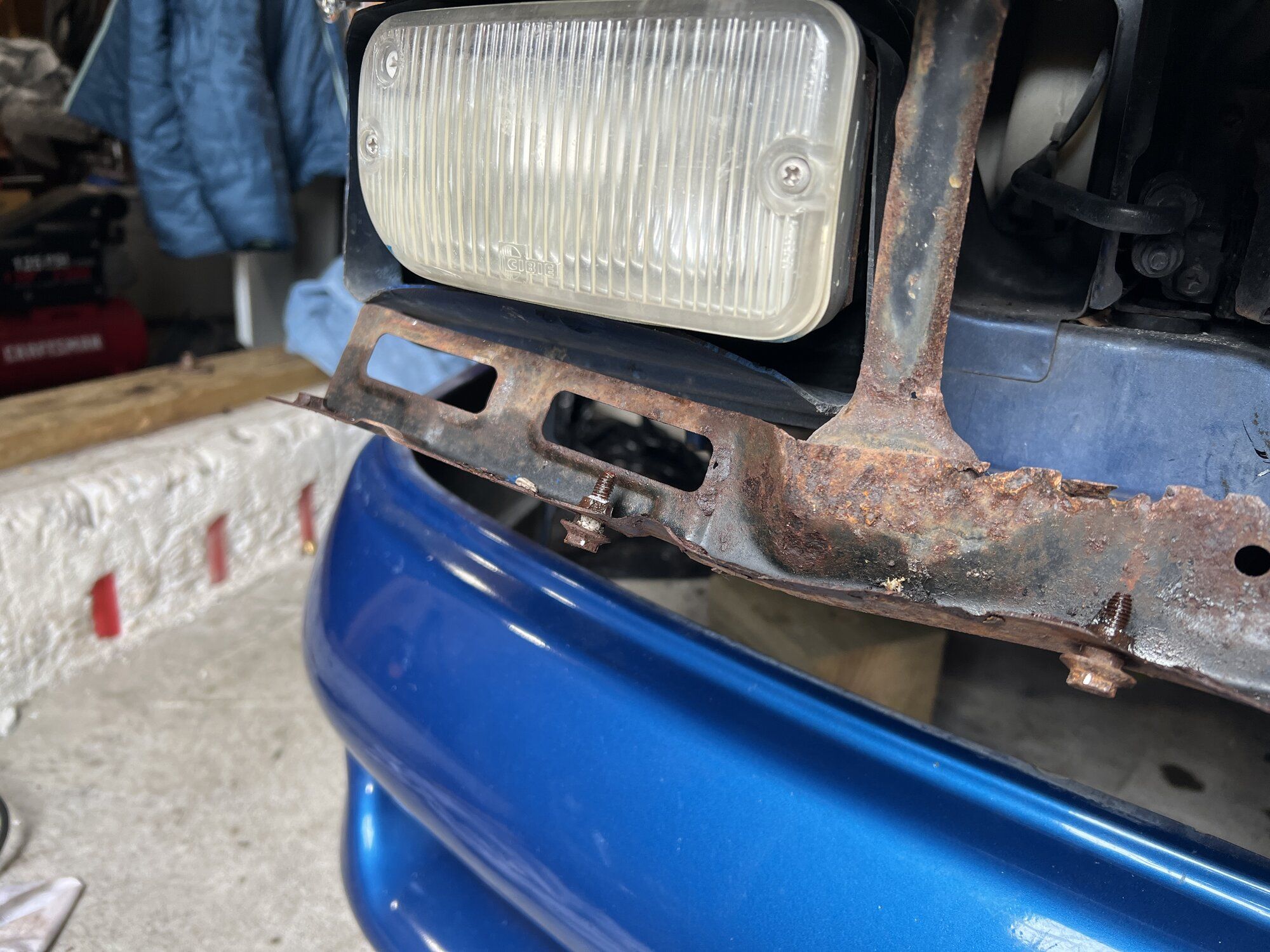

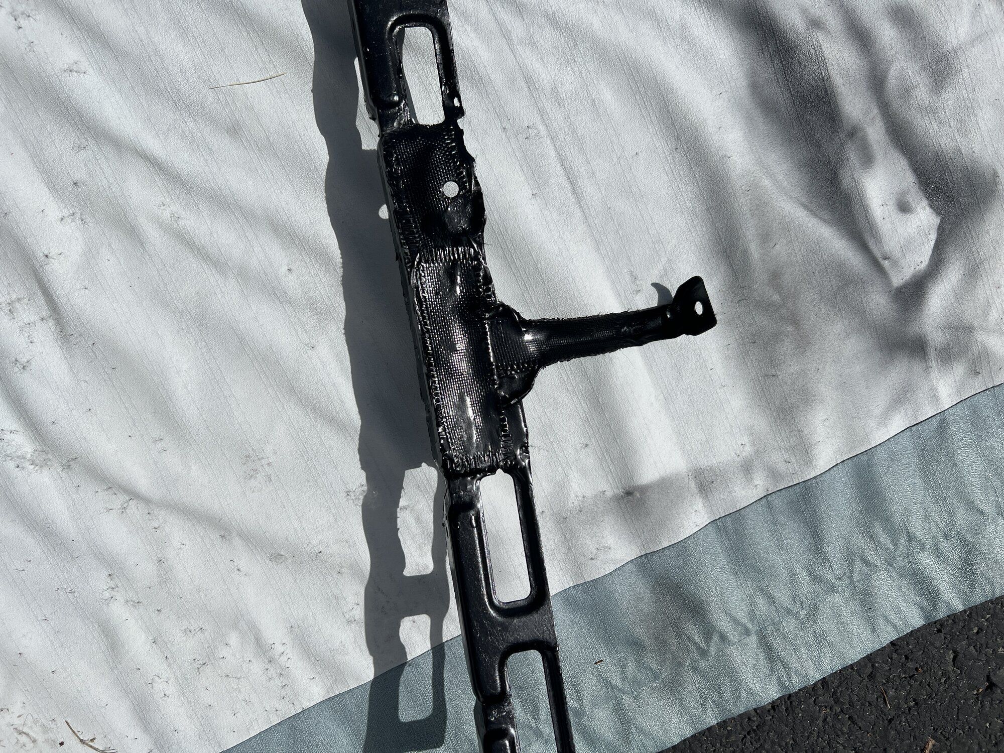

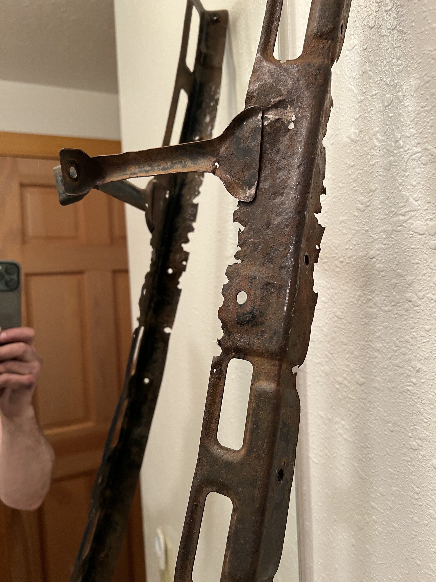

Ended up drilling out a bunch of corroded special shouldered screws. Have to figure out replacements for those. Most concerning is how rusty and bent the lower bumper frame extension is. Need to reinforce that somehow.

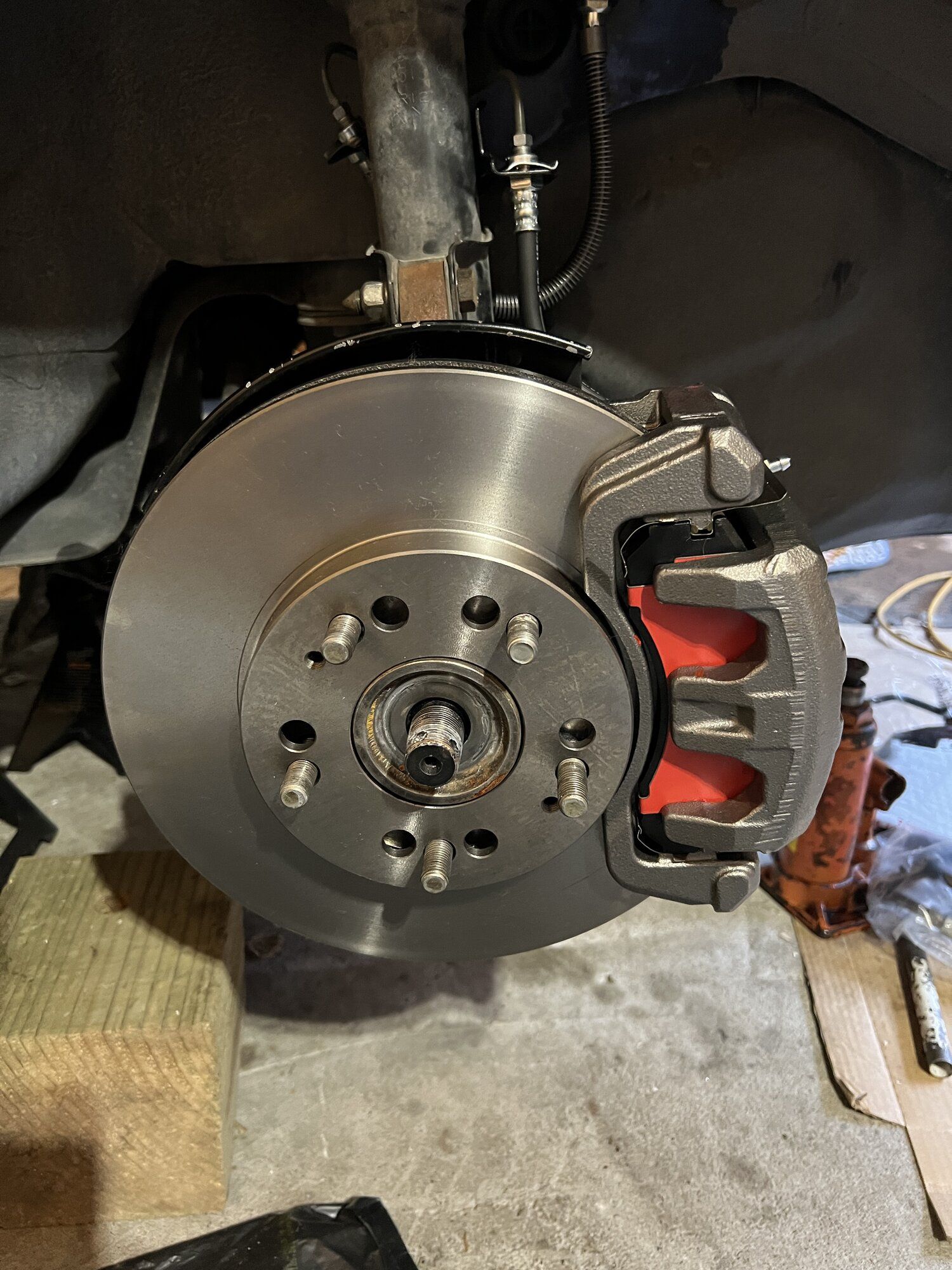

Car bas been down since November. Finally started it yesterday. Buttoned it up and drove around the block. Two issues withthe new brakes became apparent:
1. Don’t bleed your brakes with the parking brake engaged. No, of course not…
Doh!
2. Need to pry my single-piston-sized dust plates a bit more from the 92.5+ rotors. Not liking that sound.

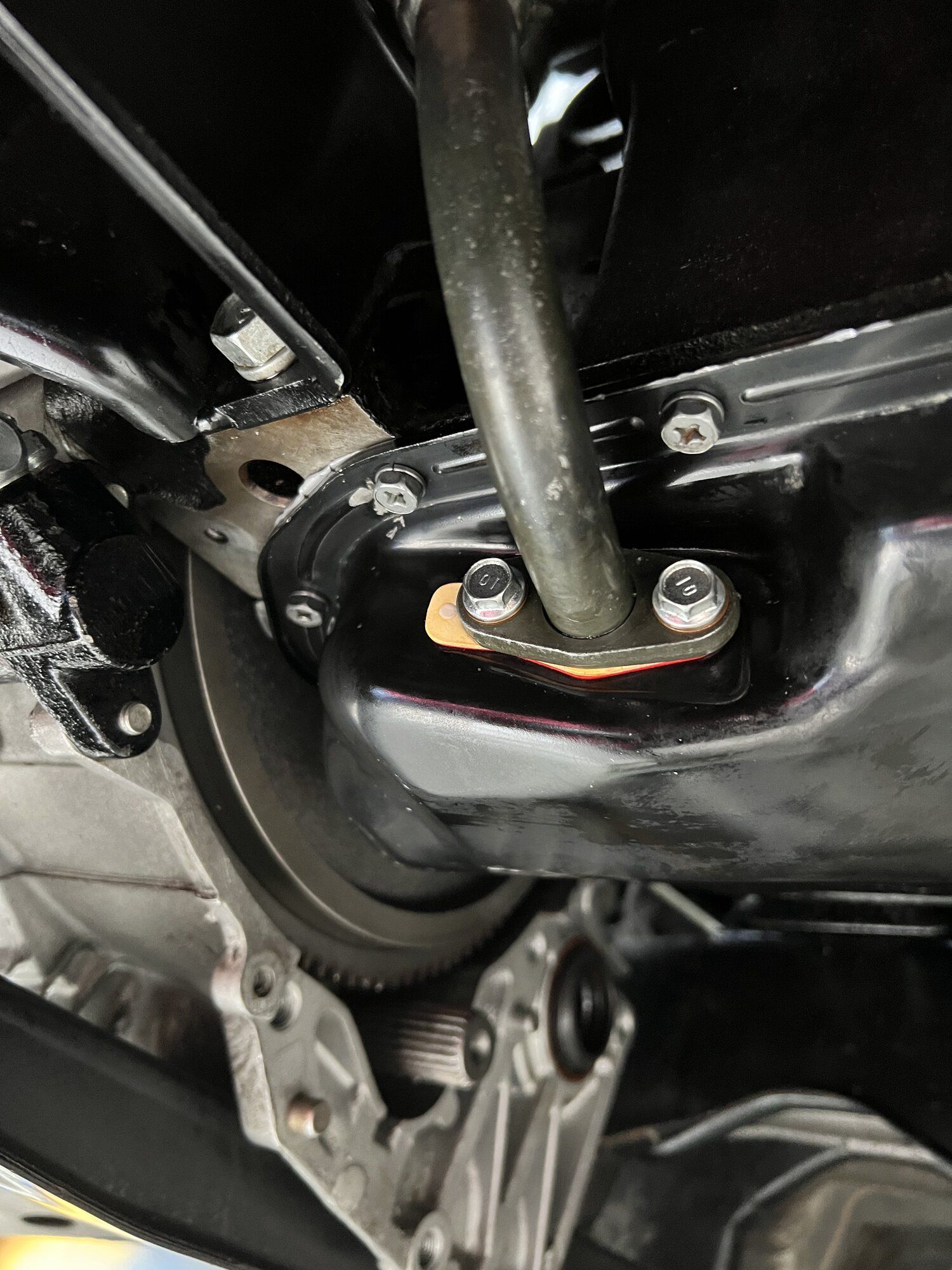

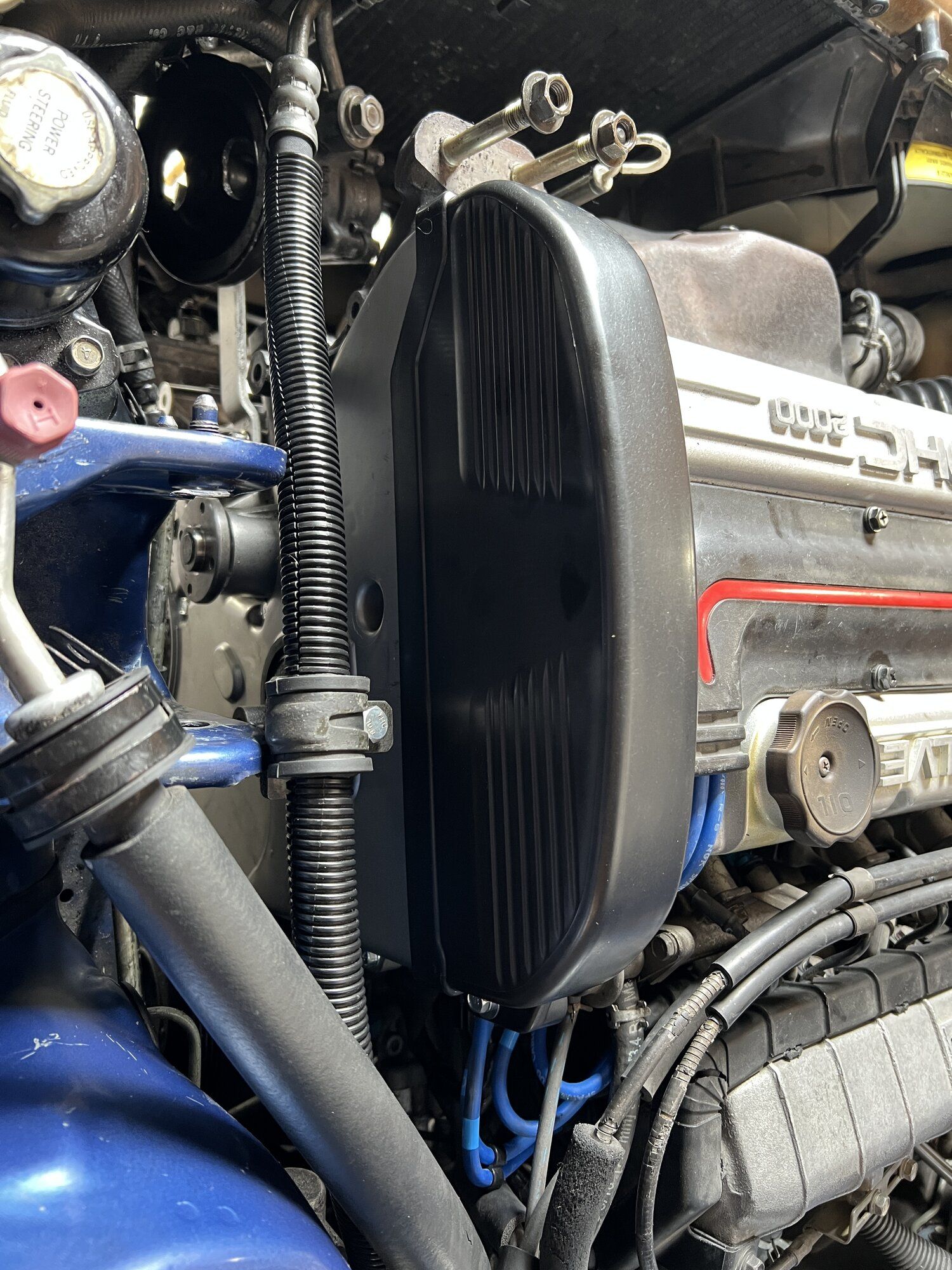

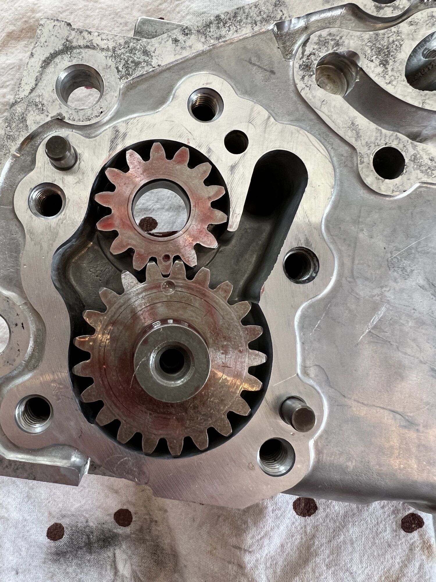

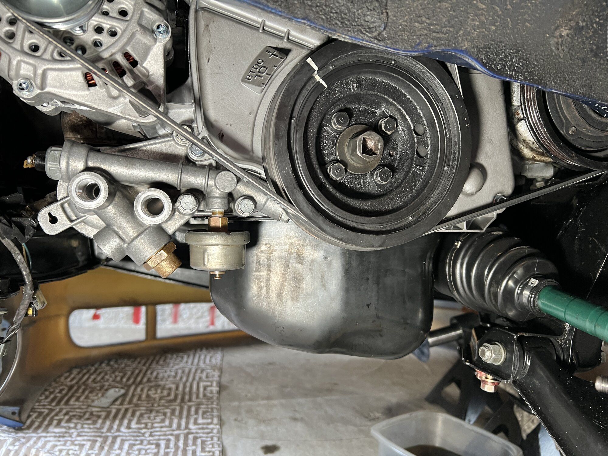

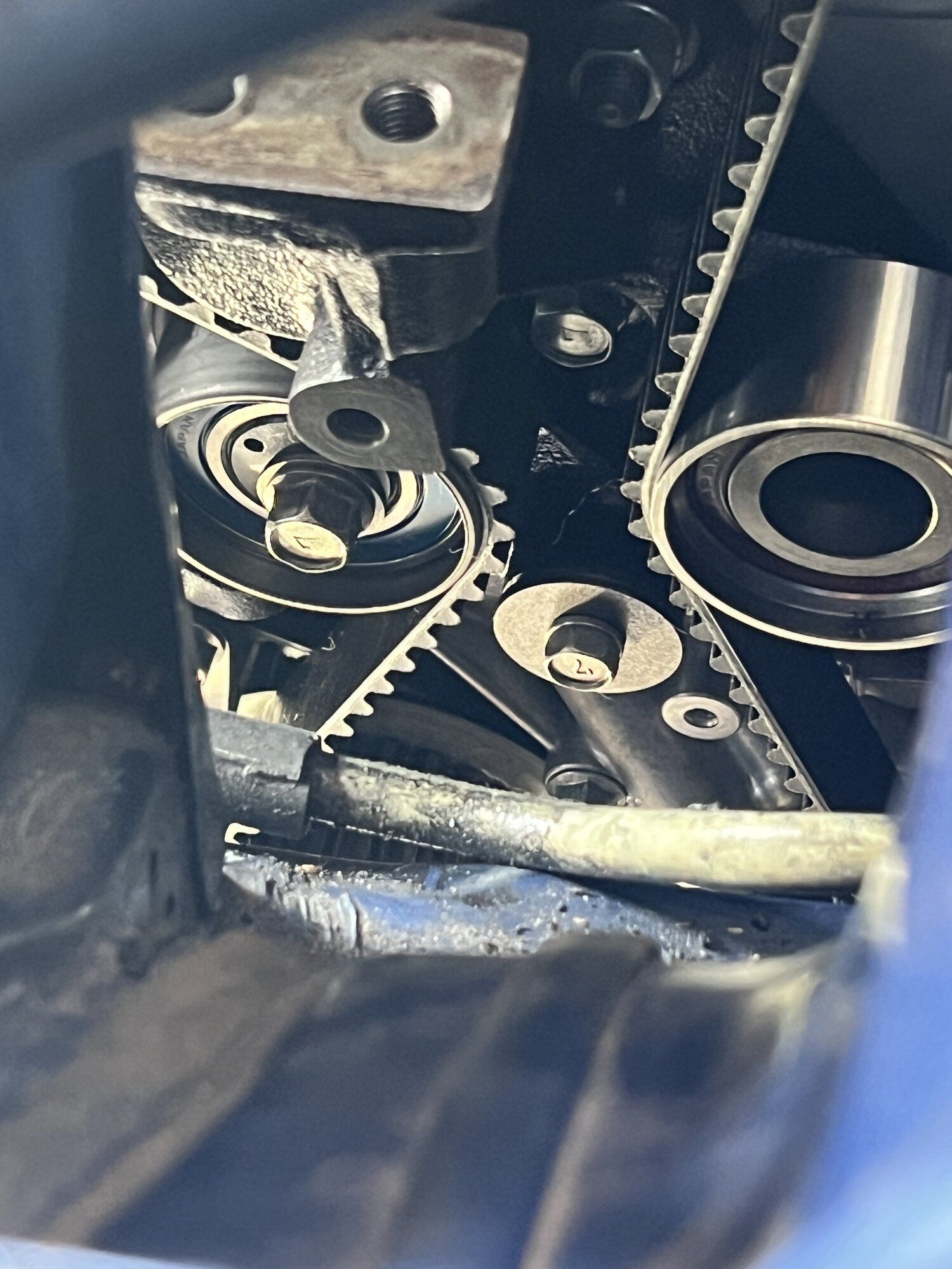

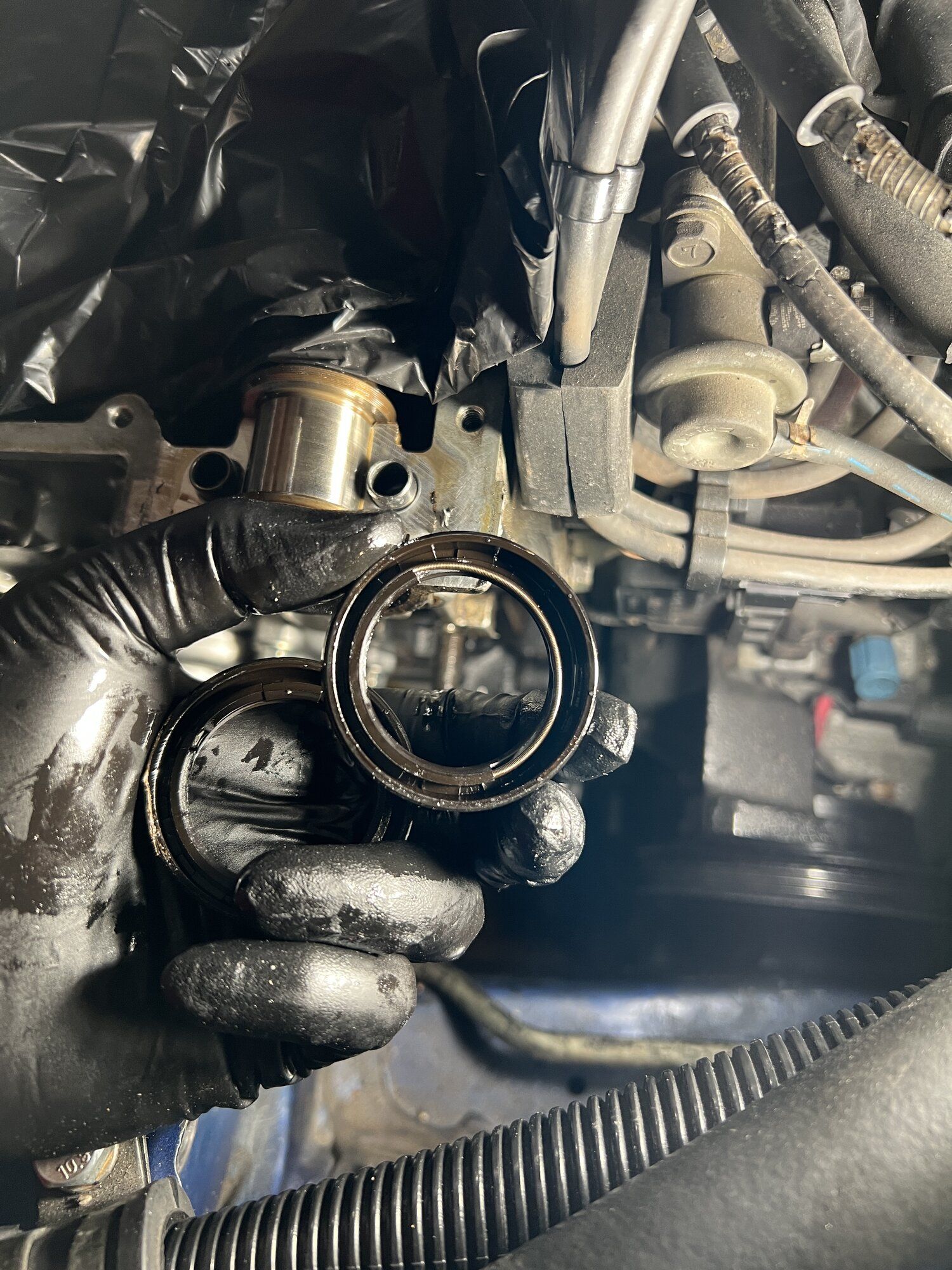

Along the way I did plug wires, front case gaskets & seals, cam seals (this may have been the worst leak, see photo), vc gasket, pcv valve, repaired the damage and corrosion to the front bumper cover supports and fasteners, front ball joints.
Basically about 1/4 of all the stuff you’re supposed to do maintenance wise when you become a new dsm owner. I’ve probably already had 1/4 of that list checked in previous periods of garage sculpture; tbelt, fuel pump, water pump, clutch, prop shaft.

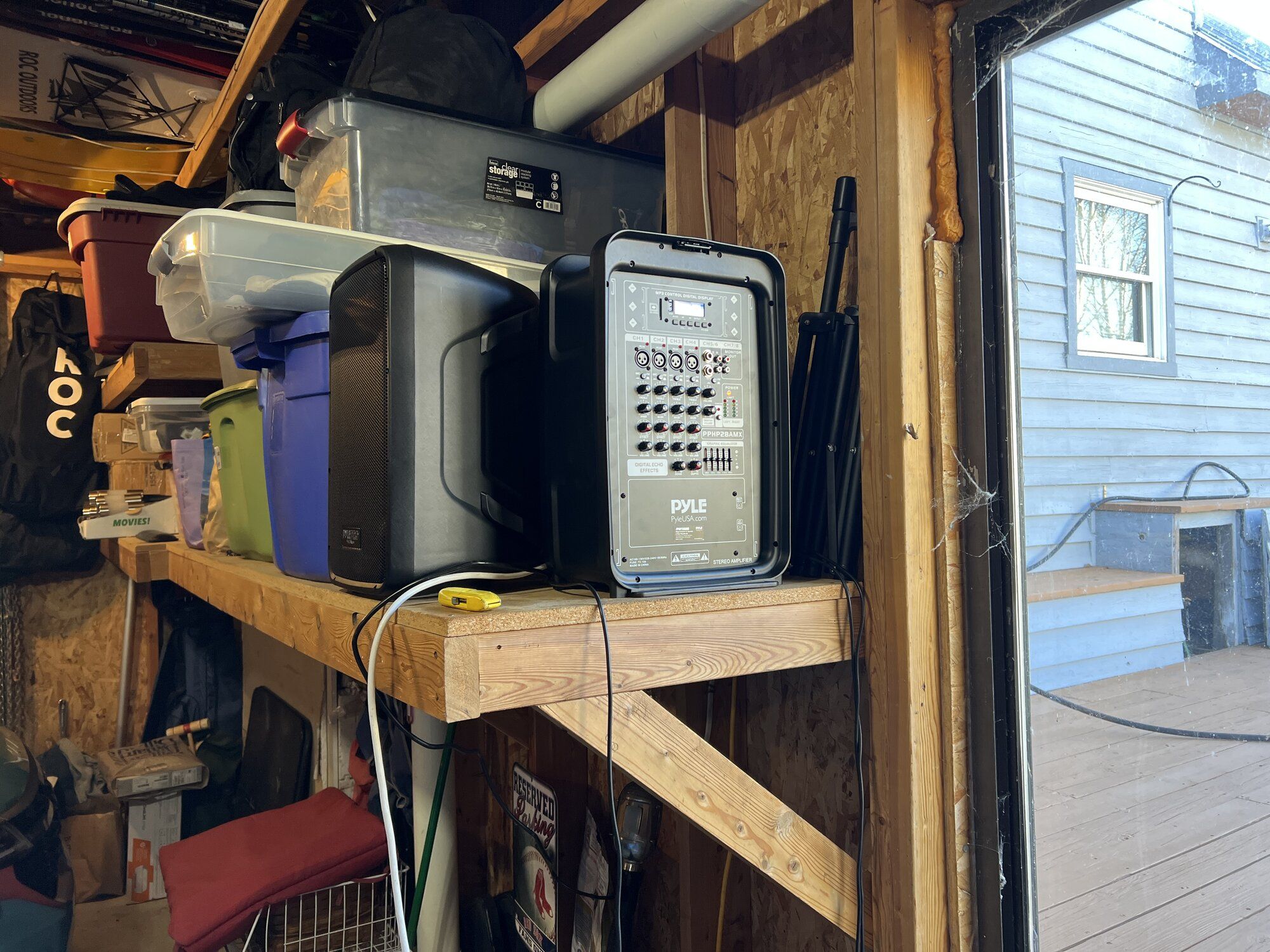

I set up a sound system in the garage that I bought for my Son’s backyard wedding in June, and rocked out.

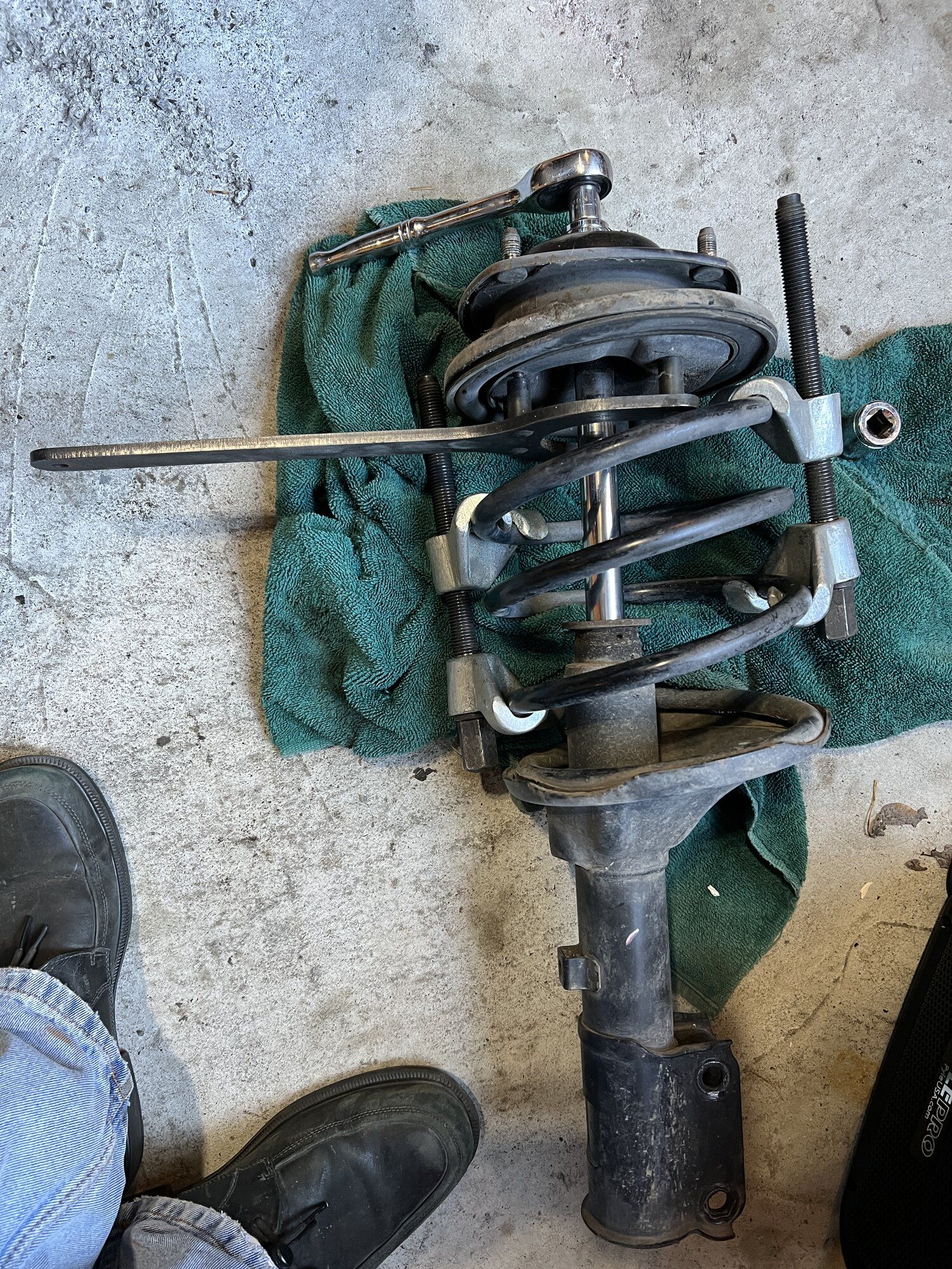

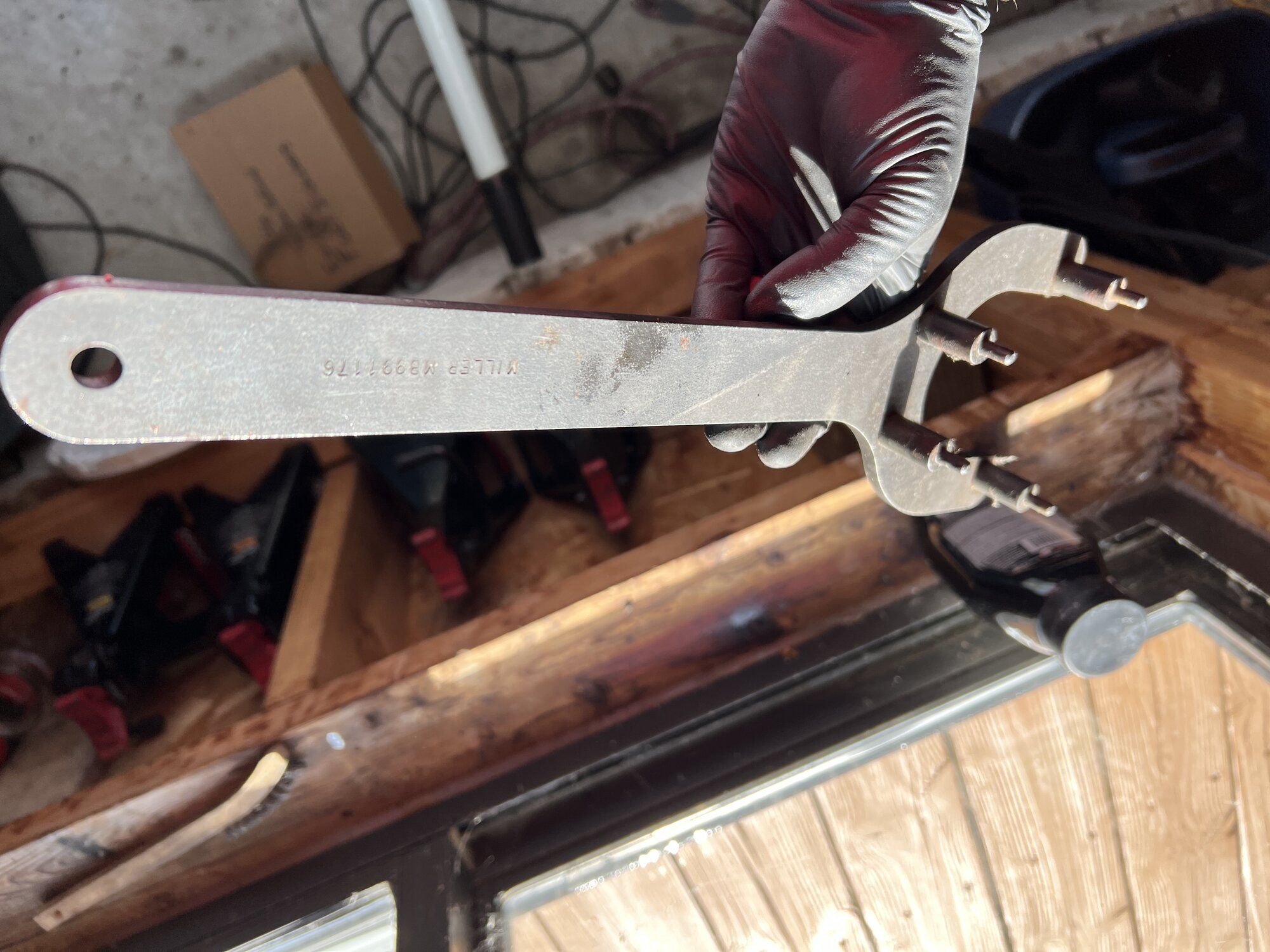

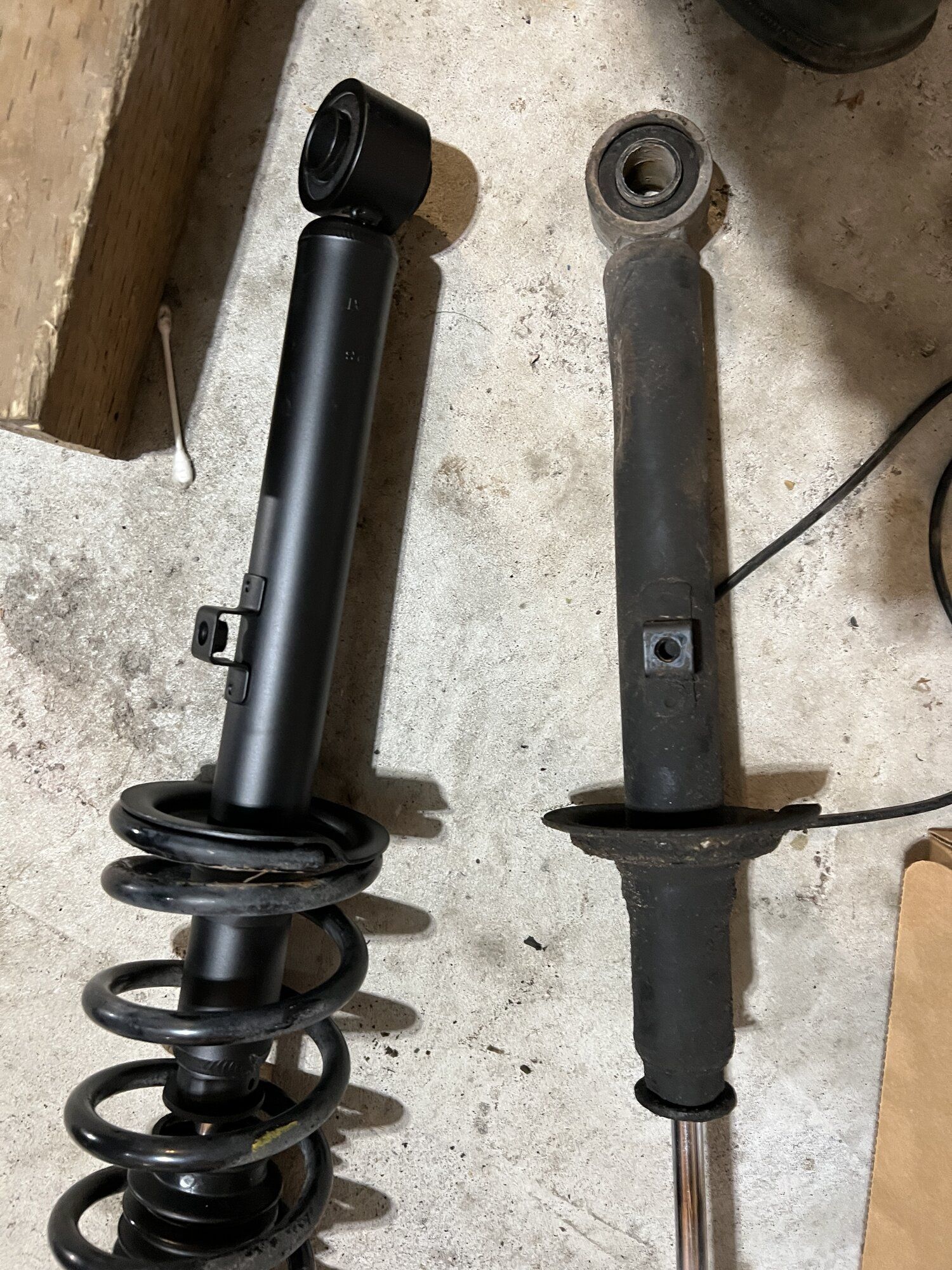

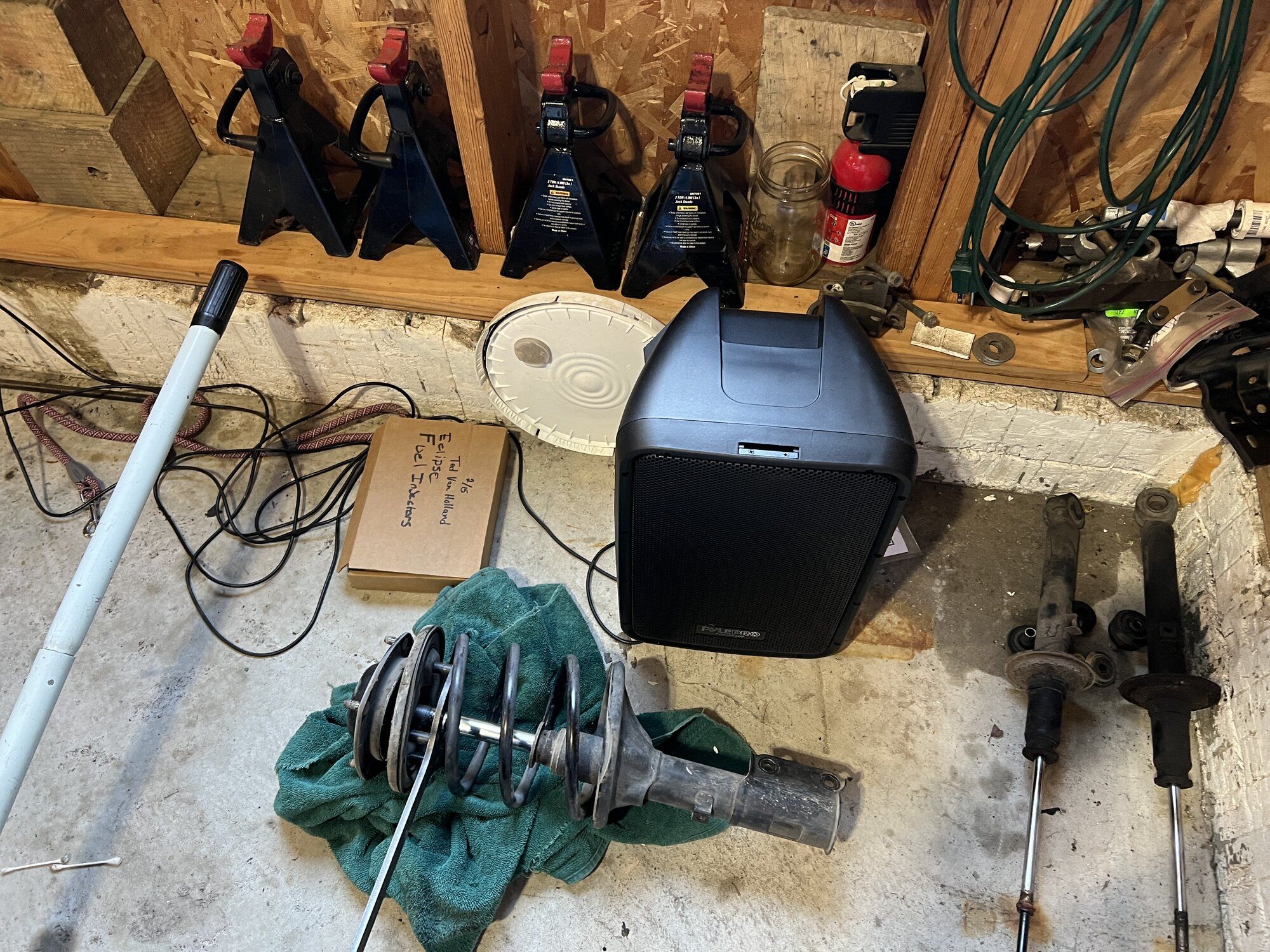

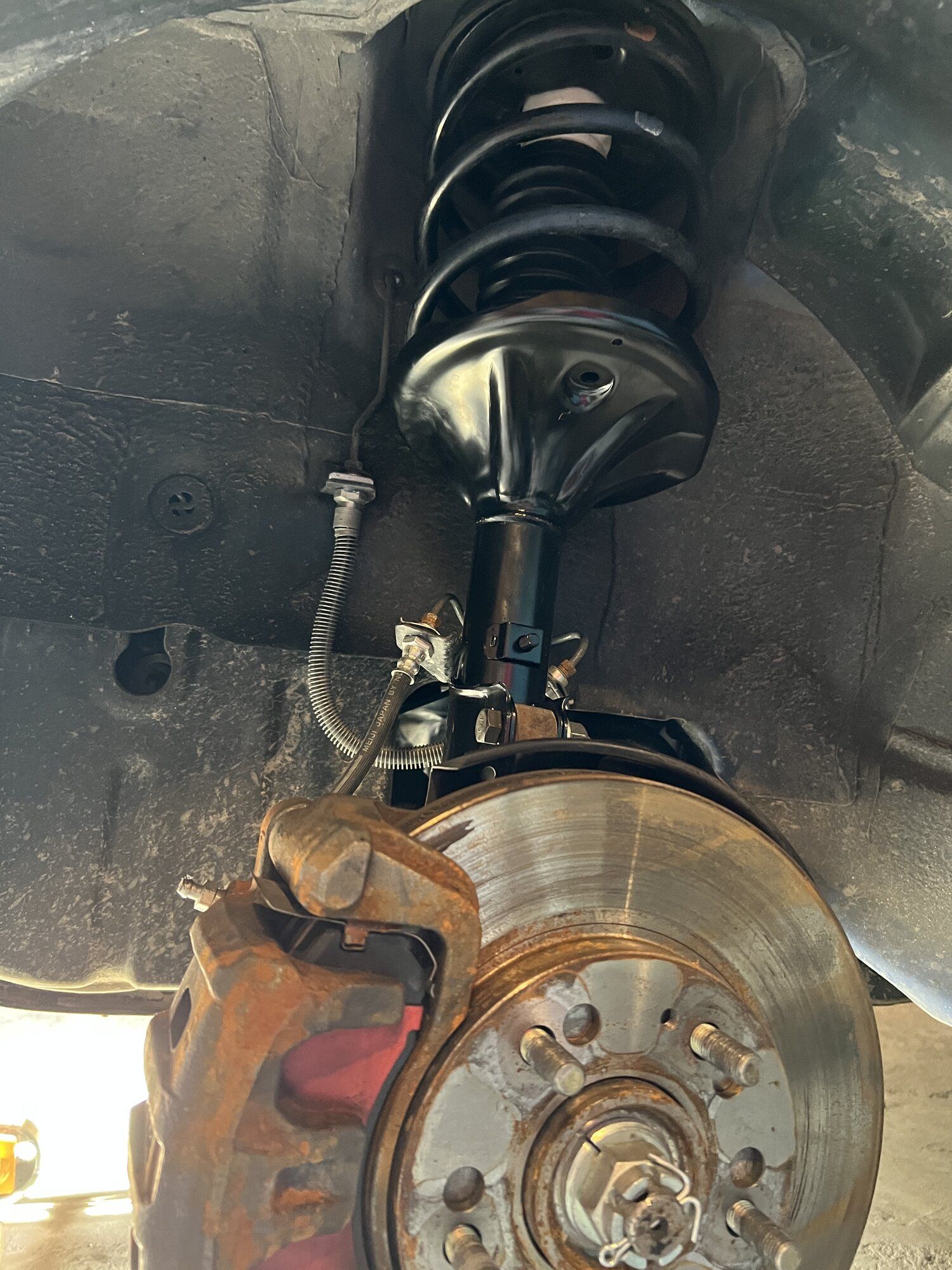

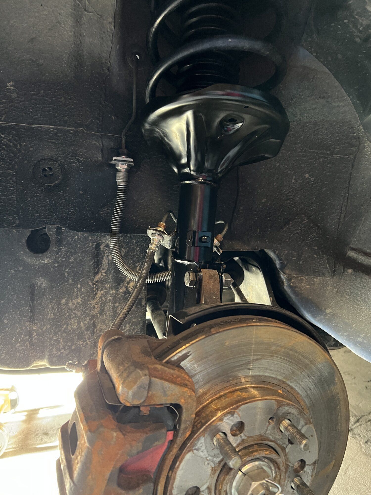

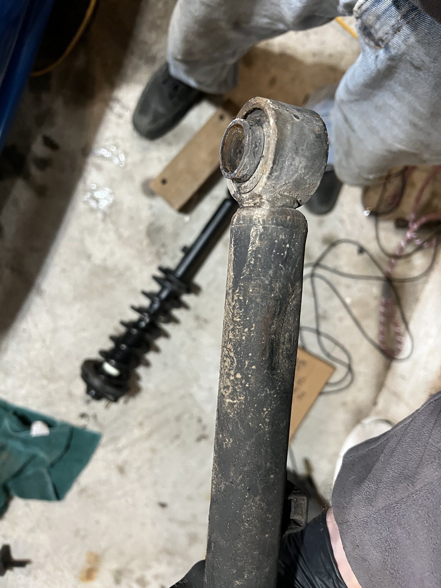

It’s running well despite that the crumbling f.i. Plugs. Then I changed struts, shocks, and mounts all around with stock kyb parts. Not hard at all. I was finally able to use the oddball four-pin wrench I bought years ago just for this day. The old (original 1990) shocks were so worn out, and one even had a good-sized dent.

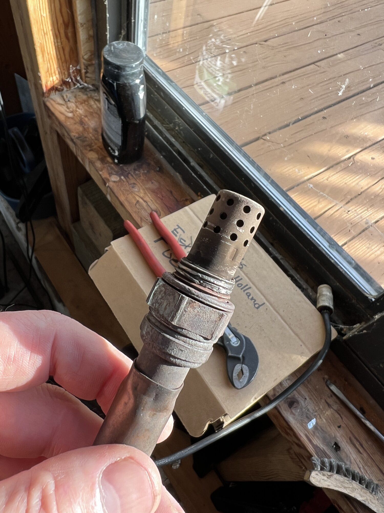

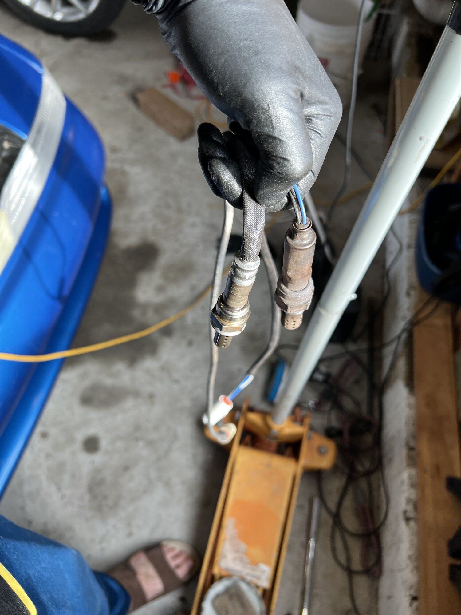

Lastly, I attempted to change the old O2 sensor. Got the special socket. Old one comes out ok, but I believe it buggerred the threads in the housing. Couldn’t get the new one to grab right, but screwed it in, and just when it started to torque, it went loose again. I got it to sort of tighten in there, but not great.
So classic three steps forward, one back. I have a 2g manifold and O2 housing, but I’m dreading that repair. Hoping it will drive fine for a bit, like until next summer, before I tackle that.
