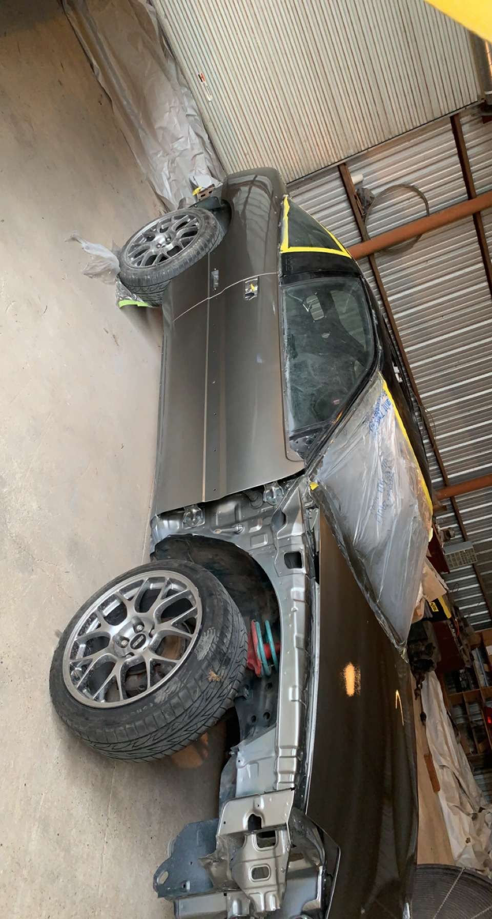

Beginning build of my GSX
Roller
Here’s my build. Ready to put it all together and get in on the road. Curious on how much power it’ll be.
Any tips or problems on the build?
