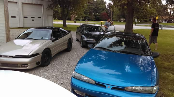

So I’ve never exactly started a “build thread” per say so I figure no better time than now to maybe help gain back a little momentum. I’ll start with a little background on the car, this isn’t my first DSM and I’ve had this one going on 9 years this September. The car started life as a bone stock non turbo 1992 Eclipse GS, and has since been repainted (a Toyota blue close to the original color but a bit deeper) in a Laser color scheme and with a 1gb Talon front bumper cover.

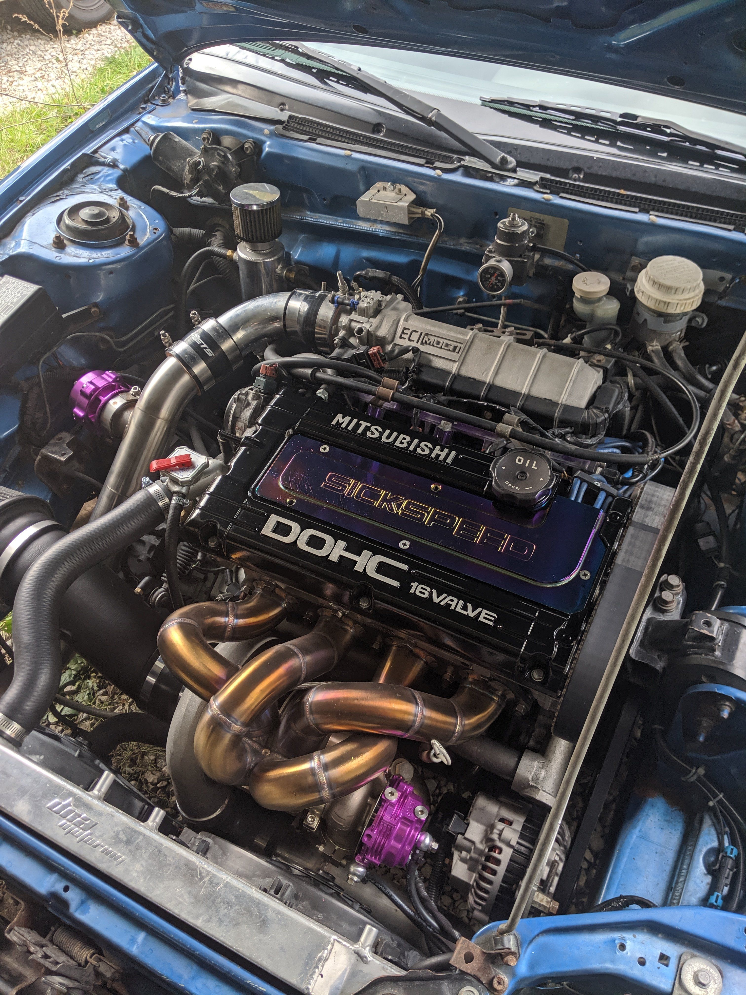

Over the years the car has seen various different set ups and has hit various personal achievements. I played with it naturally aspirated, added a China 16g, then added a real MHI evo 3 16g (from none other than Justin Whitesell) and bc 272 cams and was able to squeeze out 420 horsepower at the wheels and 430 wheel torque with it turned all the way out on the corn squeeze. Then following that I did a (short lived) low budget 8 blade hx35 in a .70ar bep T3 housing, once that went I went crazy with a Borg Warner s363sxe in an AGP .82ar open T3 housing mated to a Morrison Fab large runner manifold. On this set up we were able to squeeze out 454 on the crappiest Sheetz 93 octane pump gas I could find, had every intention of seeing if it would hit 600 on Slowmotion’s dyno on e85 but unfortunately didn’t make it back before the great k&n oil filter incident of 2020. Won’t go into great detail but let’s just say dragstrips weren’t opening on account of the Covid-19 so me and my buddy decided to go to Mike Dewine’s free public drag strip with his wife’s 3 valve 4.6 Mustang on nitrous, seal split on the k&n oil filter I was using, Rotella conventional blew all over the side of the car, oil pressure gauge pegged zero, blew oil all over an M&H race master at 130mph, straight did NOT have a good time that night. Might I add all these variations were on the untouched stock 6 bolt non turbo bottom end that had never been out of the car.

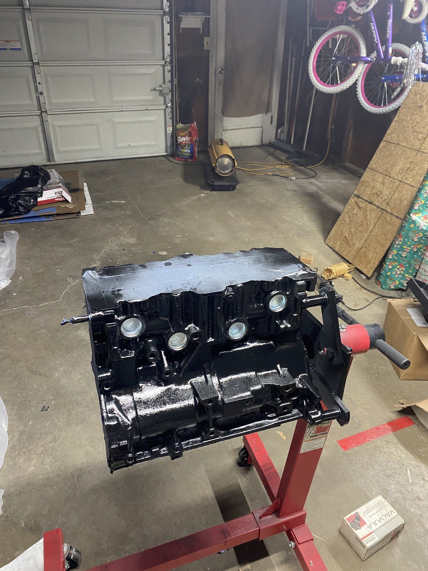

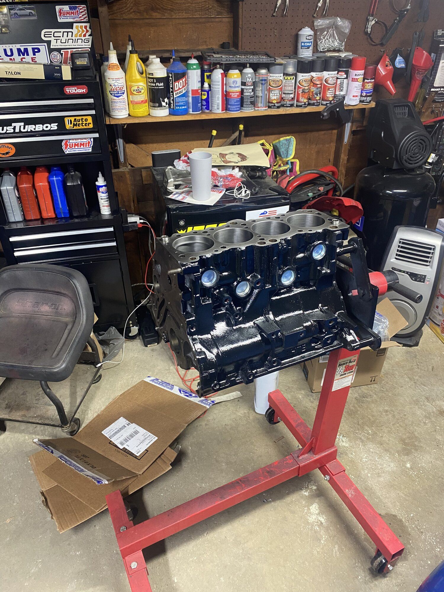

Fast forward to 2022, after that failure I had determined it had spun a balance shaft bearing and tore up the oil pump all in one shot. I obtained a spare 6 bolt bottom end with a crank from another local dsm buddy to work with as I didn’t know the extent of damage. I had every intention of throwing my head and parts on the new bottom end and running it as is, but unfortunately upon further inspection found deep vertical scratches in 3 out of 4 cylinders, with that I discovered it was another non turbo block someone honed and slammed whatever used stock 1g turbo pistons in. No biggie and not my buddy’s fault, it was legitimately running fine when he drove the parts car on to the trailer 5 years prior, for the price I paid I felt it was my sign a drop in running 6 bolt block is a unicorn these days and no matter what it was destined for the machine shop.
At that point I tore it down, discovered the oil pump was failing as well and a few of the bearings were starting to look real not good. Luckily it escaped without heavy damage to the crank, unfortunately the straight cut gears in the oil pump were toast (I suspect whoever assembled it had the timing belt entirely too tight which resulted in excessive wear to the oil pump). At that point with the damage to the cylinders and pistons brand new pistons were ordered. What pistons might you ask? Stock replacement non turbo pistons in 85.5mm. For years I joked “some call them non turbo pistons, I call them low budget high compression pistons”. I decided after 20k miles of seeing boost and with no damage to the 130k mile non turbo pistons I wasn’t ready to stop pushing that limit, besides with todays technology and such I’ve determined that once you push it that hard they’re just as big of a risk and no more a risk than stock turbo pistons. Once the pistons were ordered the block made its way to Exigent Solutions in Cincinnati Ohio where Glenn Wallace worked his magic and bored the cylinders to size with the new pistons, hot tanked it, surfaced the deck, and polished the crank.

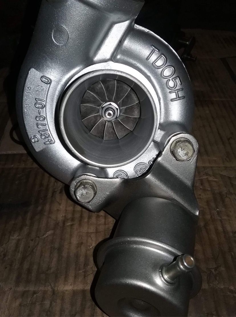

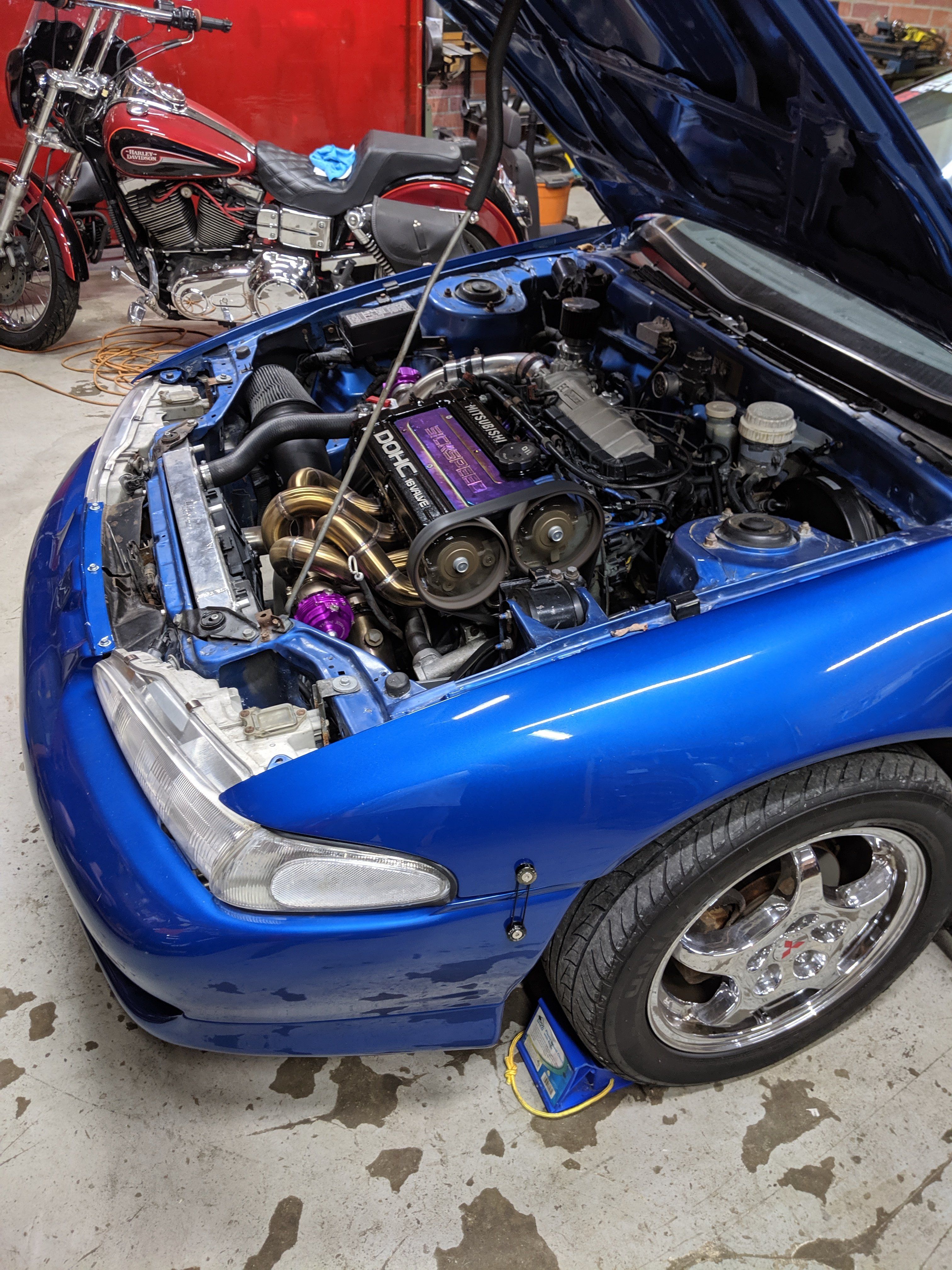

-New turbo is here! The hot parts kit from Matt and Samantha was hands down one of the nicest things I’ve ever owned, however the big turbo life just isn’t for me right now. I reflected back on the last 16g set up the car was on and how that to me was indeed the most fun the car had ever been, after a lot of thinking and a lot of throwing ideas around with Justin I decided on a 14b. Yes, essentially a stock turbo. Why? For one because I’ve actually never used one, second off I like doing more with less and just want to see how much I can push it and just how fast I can go with it. I’m not chasing a record, just self gratification combined with no desire to try to be the fastest guy anymore as that’s just not enjoyable to me anymore. New set up is a 14b in a 7cm turbine housing with a Holset wastegate actuator that Justin Whitesell conjured up in the lab one day. This will be mated to a ported 2g manifold and likely a ported evo 3 o2 housing.

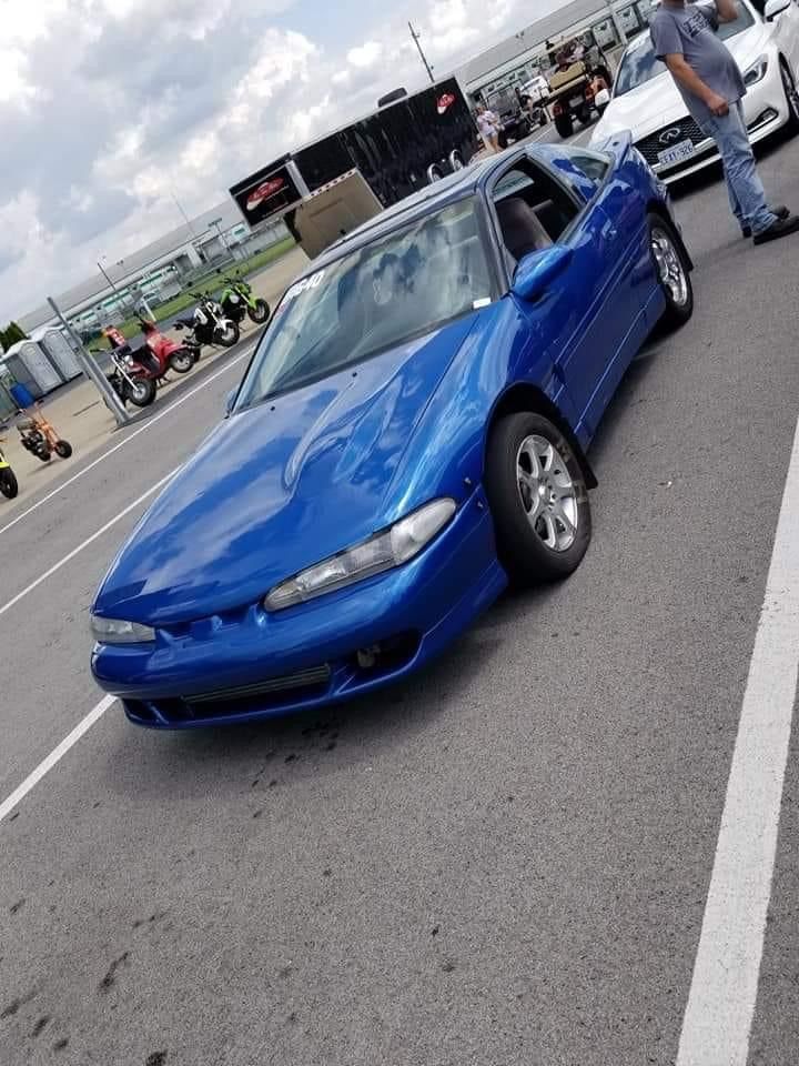

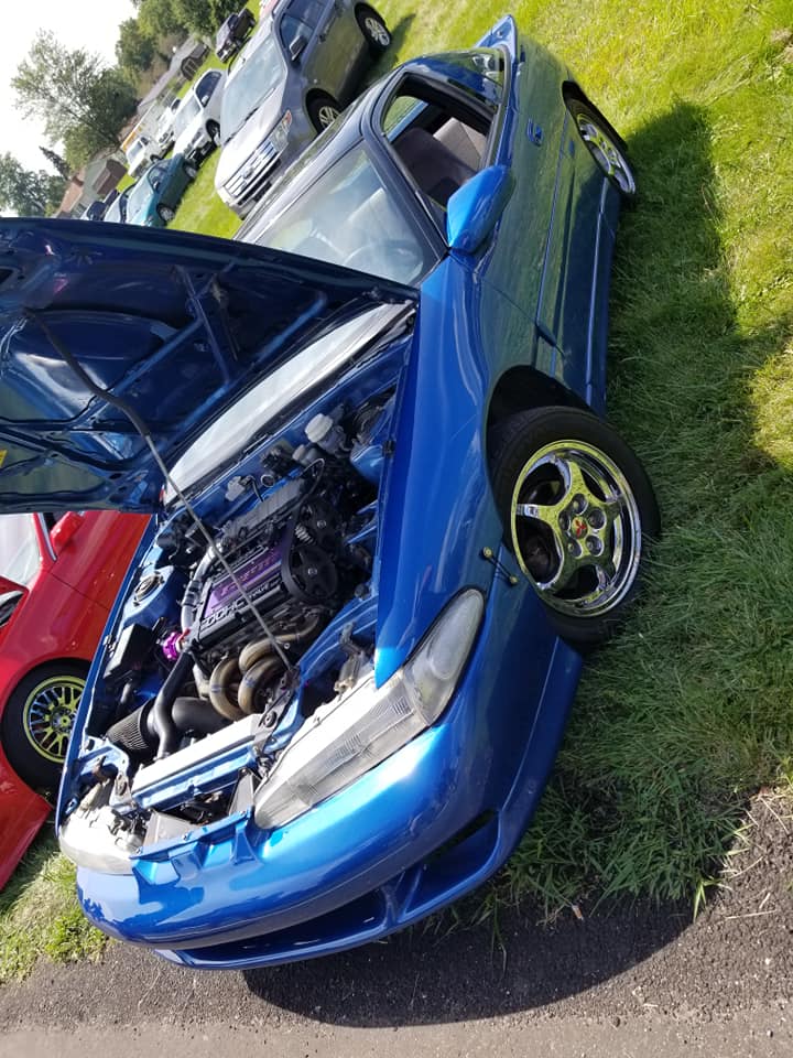

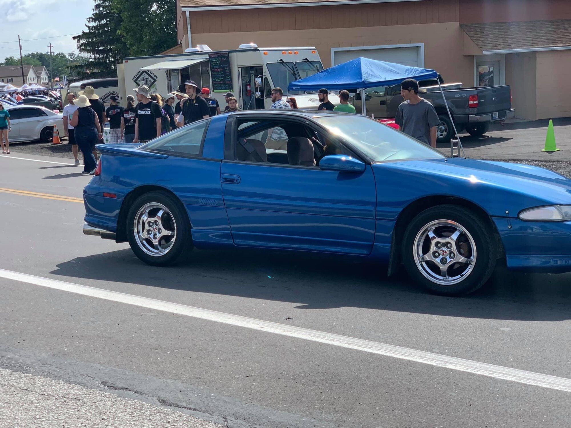

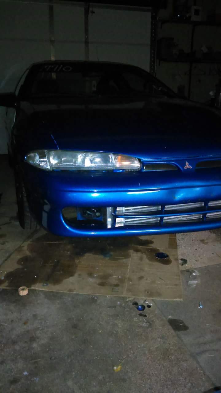

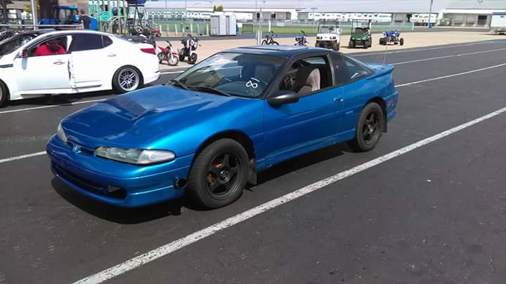

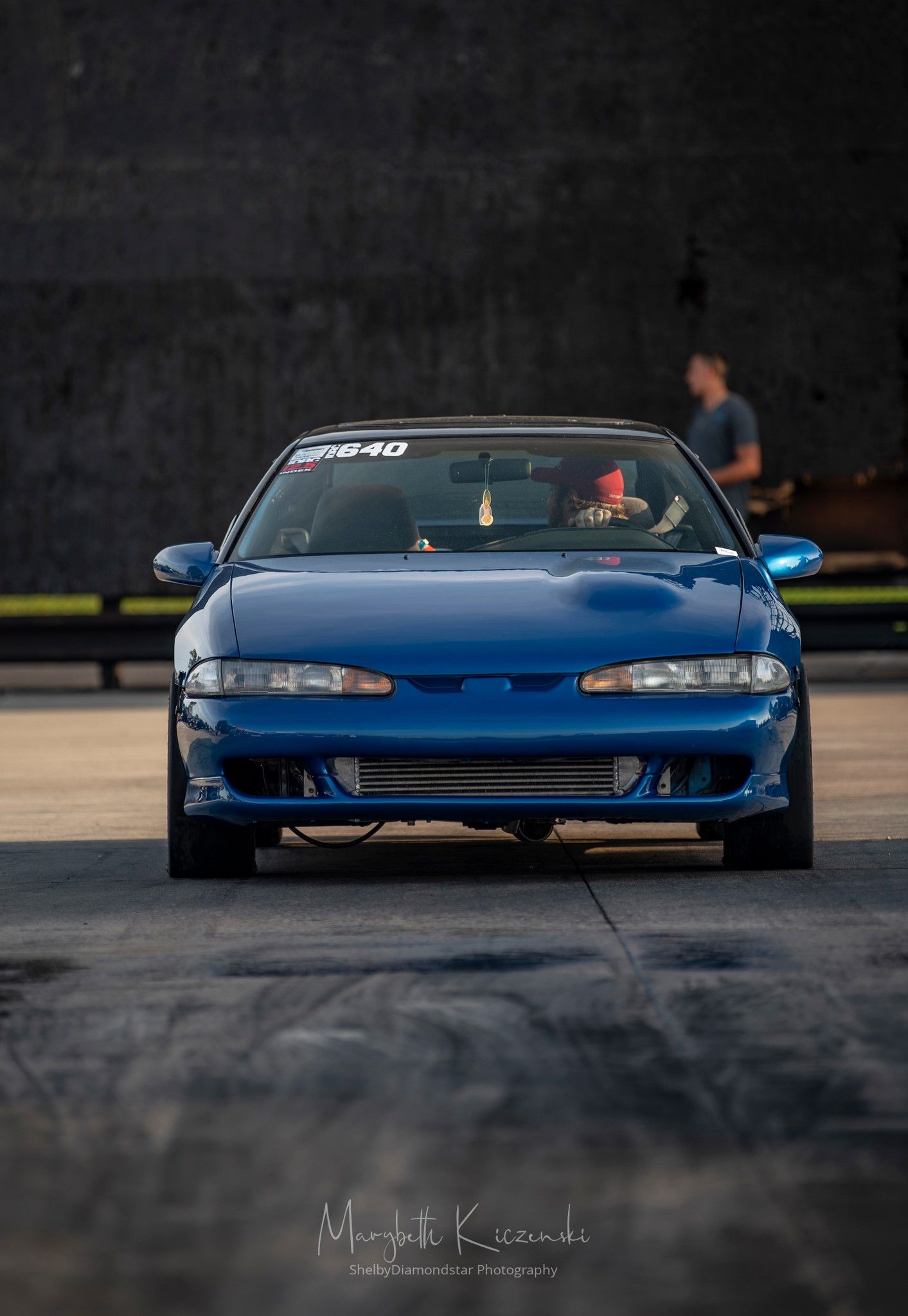

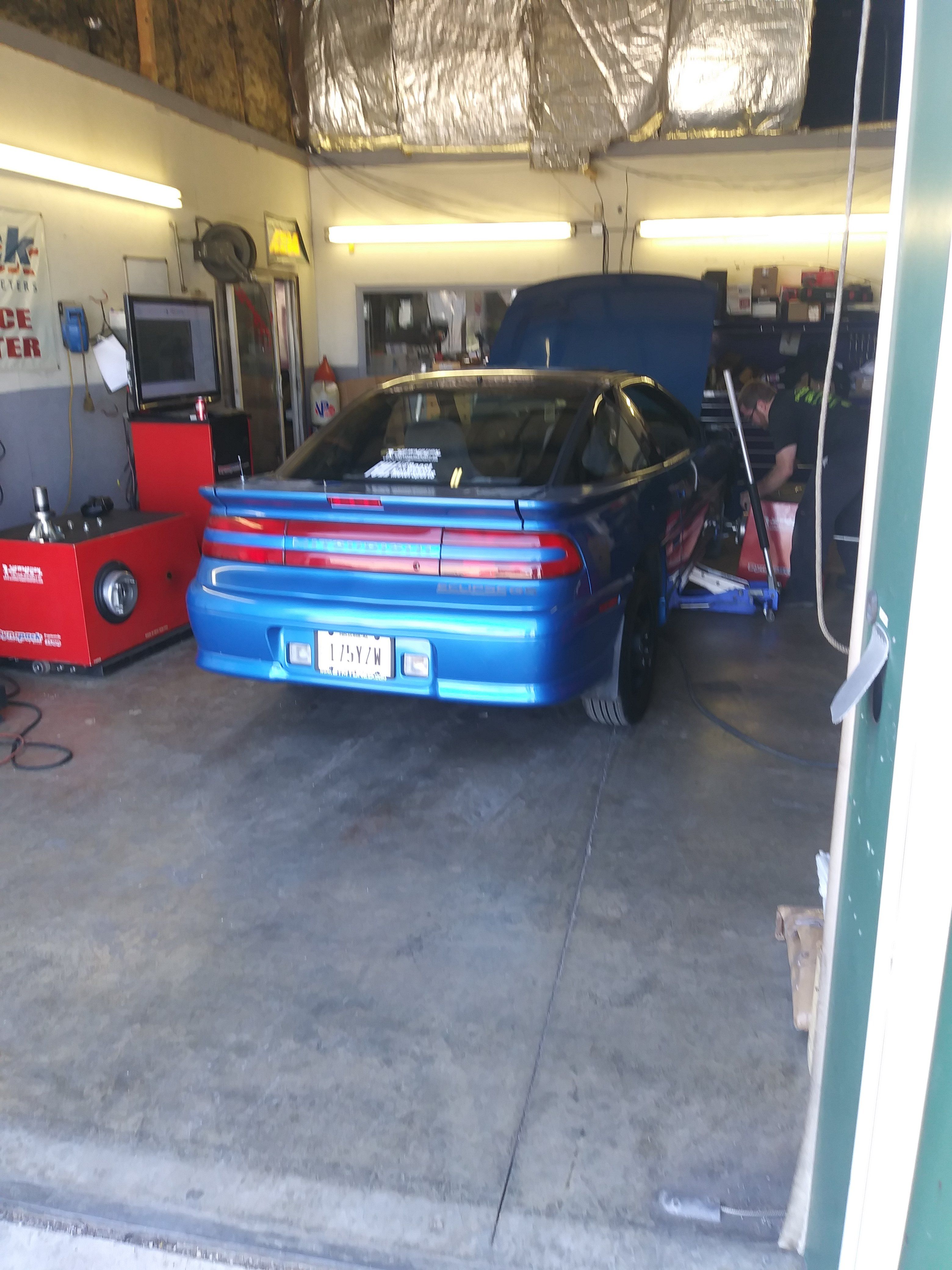

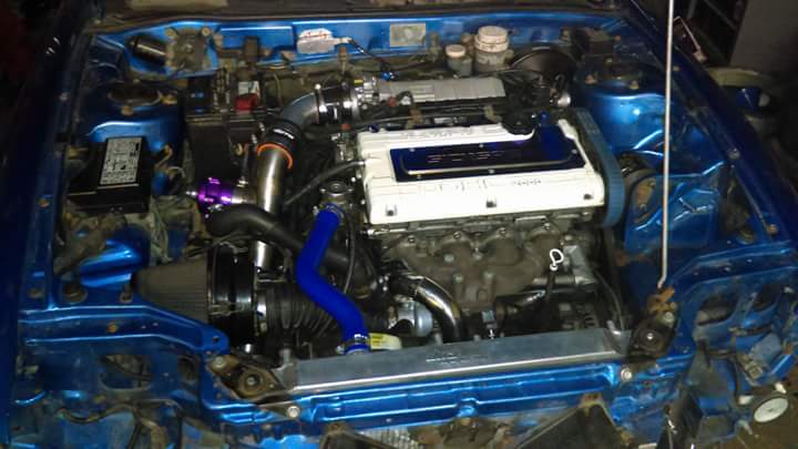

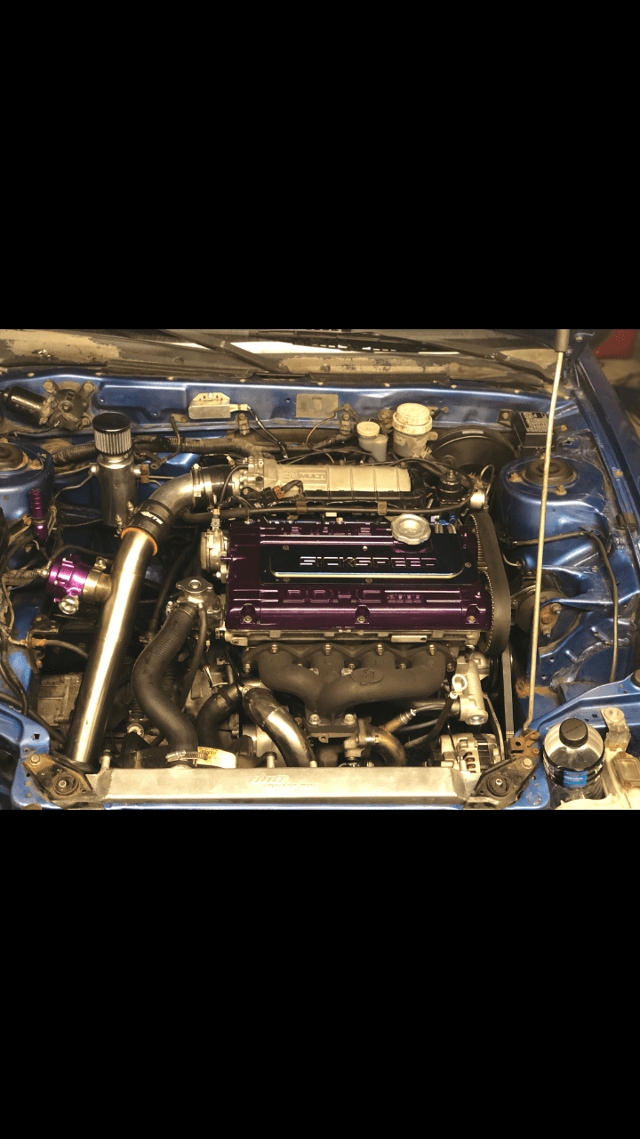

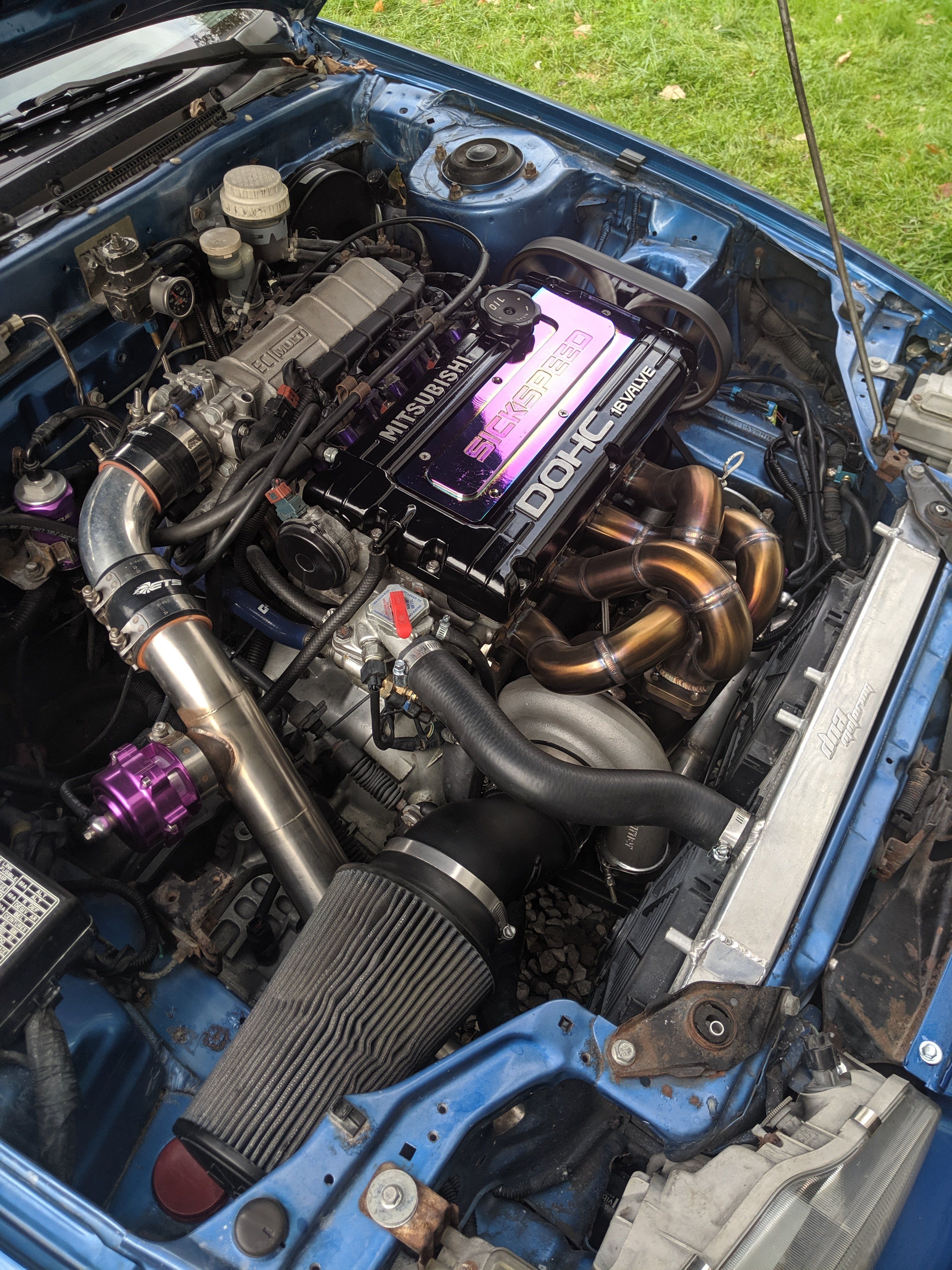

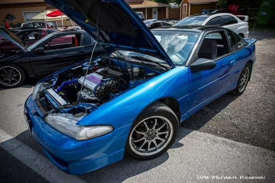

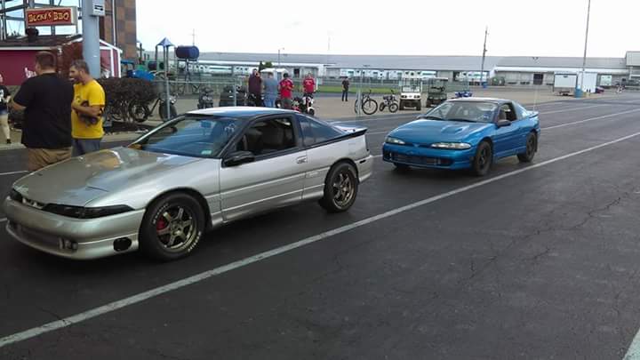

As far as goals go, my first order of business is to hit my previous personal best but with the 14b. On the s363 with pump gas I managed 12.4 at 117 at the 2019 shootout. Not all that great really for a mid 400 horsepower DSM even being front wheel drive, and not by any means making excuses, but that was indeed my only track outing on that set up as I had been chasing constant gremlins (that were my own fault at that) but is what it is, I’m not out to impress anyone. After hitting my previous personal best I plan to keep going to see just how fast I can go with the little stock turbo and what I have. Perhaps make a few small changes once I get some data on the set up, but once I feel I can’t go any faster that’s when I will be talking to Justin about something along the lines of a billet compressor wheel 18g or maybe even another 16g as I’ve never actually settled that score with myself either. Below are a few pictures of the recent years to just recently to get the party started, and I will be using this platform frequently going forward to update as I’ve exited the realm of social media and have ZERO desire to go back. Mod list as to what I have to date is current in my profile and feel free to ask questions, look forward to getting this going again and sharing the journey with you guys.

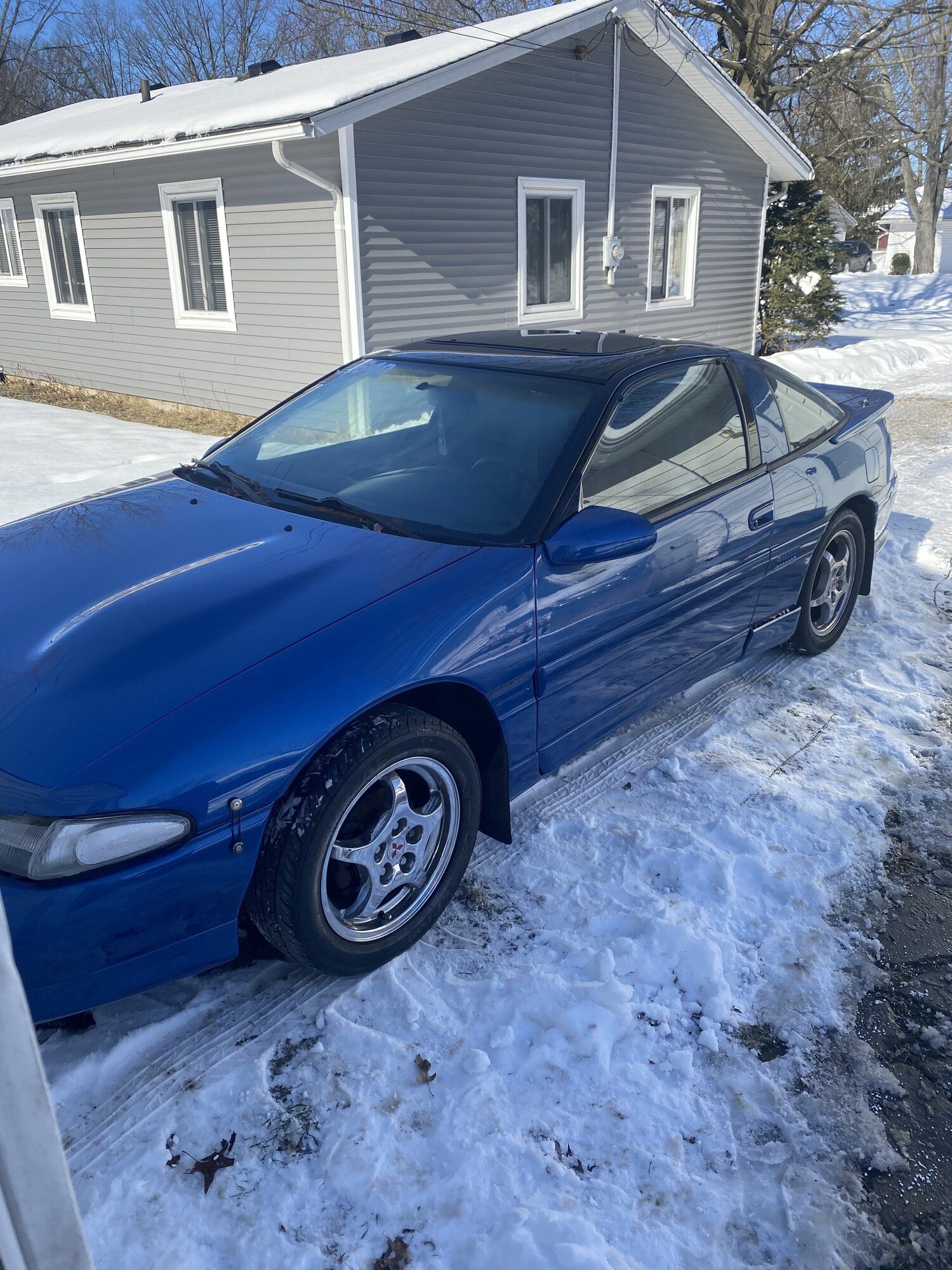

Thank you! I’m ashamed to admit I’ve done nothing with it lately except pick up small odds and ends and watch grass grow up around it. Got pushed on to the back patio so other things could get worked on and it’s been out there like 2 months now, I’m really living up to the broke dsm stereotype. However, I’ve actually decided to change directions a bit. Was out for chasing some numbers for personal gratification but the more time ticks away the more I just want to drive it as I miss driving it let alone a dsm or boosted car in general. My new goal in mind has actually been to daily it to work and such the next salt free season before it gets much older and relive my high school days of dailying a dsm but in my 30s (first mid life crisis? Probably not), all while seeing how far I can go on the 14b before going back to a 16g or perhaps trying one of Justin’s td05 18g’s or a 20g. Once I fix my beater Crown Vic the DSM WILL be going back into the garage where it usually is, and I have no choice but to get my ass in gear and get that done as I don’t drive my Ranger in the salt months either but it has been my daily the past few months so that leaves me with no choice but to get a roll on. Once that’s done and I do some routine maintenance on the family minivan I’ll finally be able to start putting in real time on it.
