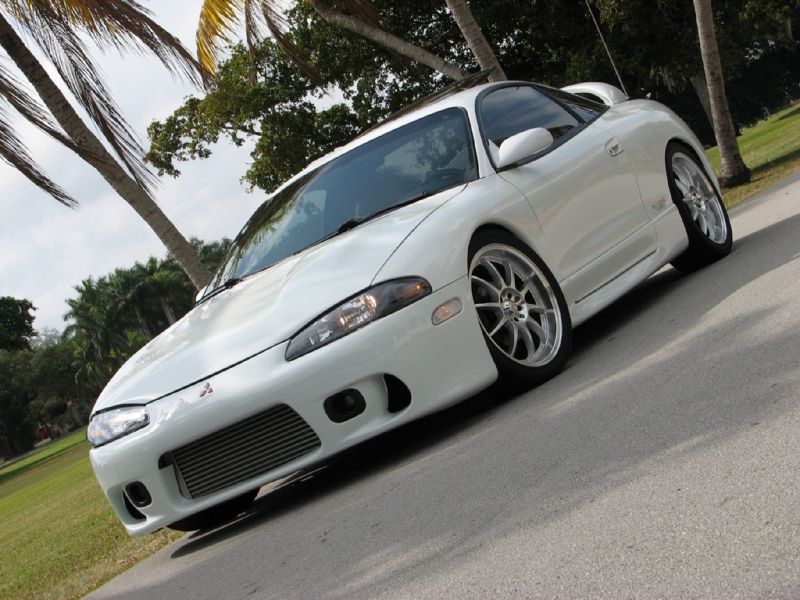

Baby's got back!
Original one owner '98 GST
not a fan of the venting on the bumber, but original owner thats sweet that must felt good to buy that brand new i had a dream like that once... hahah ;)

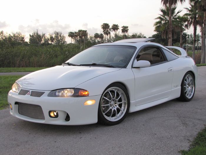

Your Eclipse is absolutely gorgeous, but I have to agree with most people here that the front cut out doesn't look quite right, it needs to flow with the bumper a little better.
I think it would look better like this...
I don't have photoshop, I had to use MSpaint so it's not perfect but you get the idea
BTW I love your rims, what kind are they? They look a lot like mine but with more spokes (and bigger of course)
Man I love that vent it looks super sharp I think. I was actually thinking of doing something like that and that gives me a better idea of what its look like! Nice car!

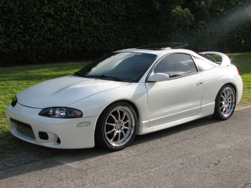

OK, the more I looked at it the more I agree the straight cut across the top doesn't flow well with the bumper. So this afternoon I recut the vents a little more, on the top corner of each vent I went up 1/2" higher so it follows the line of the bottom of the hood a little closer. I thought about cutting it even higher still but then its so close to where the fascia starts to get more horizontal that it might have been a problem with bending and adhering the SST mesh nehind it. Is this better now?
NOW:
BEFORE:
The rims are from a company called Exel and the model is "Fame" in their "Hyper light" silver color, 18". They actually were very inexpensive but I don't think they are made anymore.
An improvement, but the left and right top ends of the cut still need to be going upward a little more so that the distance between the top of the cutout and the hood is the same all the way across.
Also the bottom is straight when it should slightly curve like the top. I think in order to really make it look good, you would have to start over with a new bumper, but I know that's not exactly convenient.
Bottom line is you have a great looking Eclipse (nicer than mine and most other members on this site) and I wouldn't worry about it too much
I happen to love the car. Vent's look good, just not a fan of the mesh. Car looks to be in pristine condition and I'm jealous of it.
Got it. I made the last adjustments yesterday - super easy with painter's tape and my dremel with the small drum sander and 60 grit wheels, finished with a dremel SST brush for really fine work and then hand sanded the inner edges with some 120 grit. Came out pretty much exactly like your MSpaint mock up. The fascia is being repainted today and will post another pic later in the week when its back on.

OK, here is the actual newly trimmed and repainted front fascia from this morning - I think it now flows alot better now with the hood lines. Made the upper outer edges curve more closely with the bottom of the hood line and also added a little more curvature to the outer sides and the bottom. Thanks for the suggestions and constructive criticism!

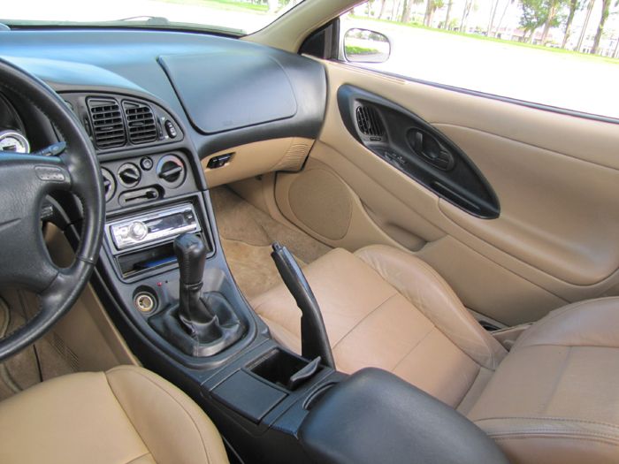

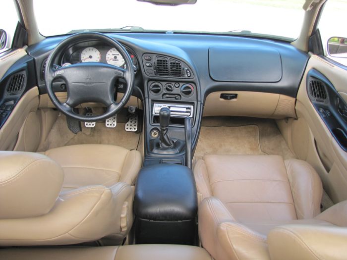

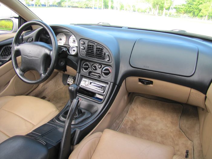

Here are a few interior pictures from this AM too:
Need a straight forward front shot in order to really tell. Nice interior, very clean :thumb:
