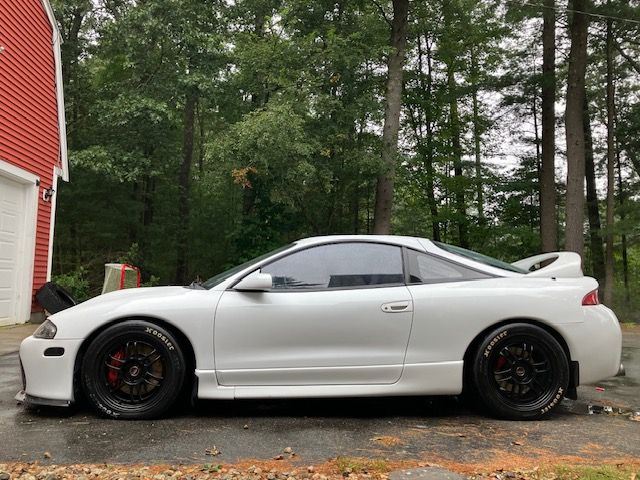

Been laid up for a few weeks following surgery, but it was a nice day out today so got out and moving in the garage for a bit and decided to tackle a simple little project. Added the bumper shutters to the car today and I'm really pleased with how they look. Nice to block off the giant fog light openings since I don't have them anymore. I think it's going to be a real nice touch with the carbonetics front lip / rear diffuser. That's my next present to myself, can't wait to get those ordered. Shoutout to @gofer for the bumper shutters, Thank you!

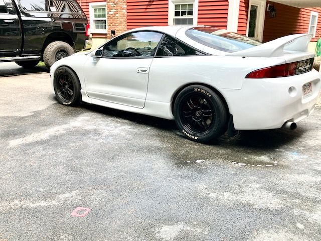

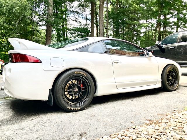

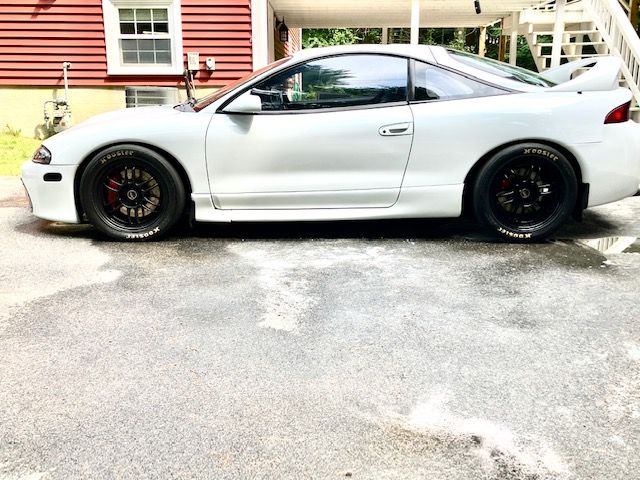

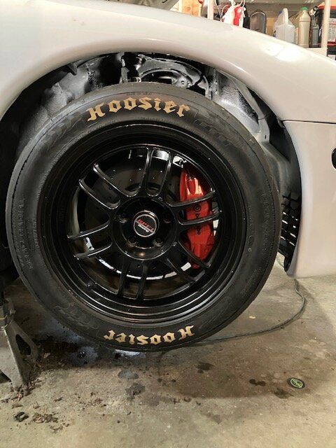

Well it was a good day today. Sold my WRX to free up some cash, and like any good DSM'er I put it straight into parts. Picked up a nice set of RPF 1's 17x8 on brandy new Hoosier slicks and some evo 8 Brembo fronts today from a local guy in the community. I love the current wheel and tire setup on this car, they're wedsport TC005 16x8's, but if I want Brembo's and to track this car, this will be a far superior setup. Also got together all the bits to put the tan interior back together. I placed my order through carbonetics for the CF front splitter and rear diffuser. Really excited about those pieces, but its going to be a long wait. I'm torn between taking the entire interior out of the car caging it and going with just a race set up. Future plans for this car will hopefully include a lot of lap days with this new organization I've partnered up with to get Veterans out on the racetrack in all kinds of cool cars. This GSX will hopefully be one of them if I don't die during the shakedowns... I've never built a car for the track so I'm expecting a very sharp learning curve coming my way. First step is to get the brembo's rebuilt and some new powdercoat, and need to track down a set of rears still as well. Really excited to get working on this setup, stay tuned!
Had a few minutes to myself in the garage and decided to see what these RPF's will look like. Actually love the look with the drag radials on there. With plans for more road track use though I'll be putting a new set of tires on these. Once I compile all the parts for my suspension, wheel, brake set up, I'll be sending most of it out for fresh powdercoat for the wheels and Brembos. My parts wishlist keeps growing though and I was looking into the Volk rear end set up and wow that thing looks impressive. It may have to go low down on the wishlist for now but I really hope I can through that entire setup on this car someday.

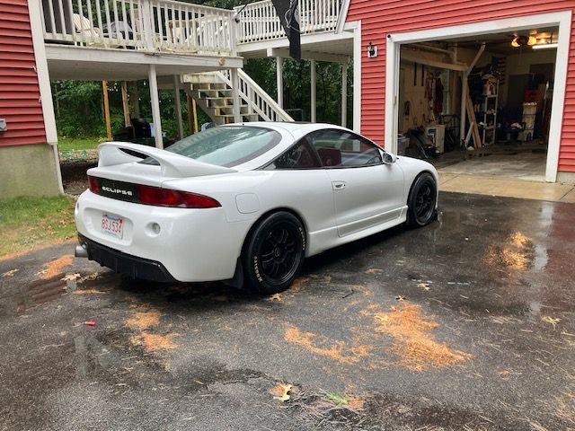

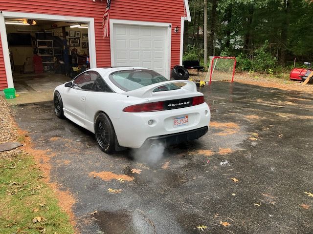

Mounted this little carbon 3rd brake light cover on the car today. I used JB weld plastic epoxy to bind it to the piece. I used a full syringe and about 6 clamps to hold it in place for over 24 hours. Wanted to give it plenty of time to set up and cure. I think it is going to hold up real well on there and last for quite some time, it is pretty solid. Looks great on the car, going to go real nice with the carbonetics pieces whenever they show up. Don't mind my ugly ass reverse lights, I tried to "smoke" them up a bit with nightshades and I butchered it. Going to clean them off and try again. Pulled the trigger on some JDM galant knuckles from Japan. Seems like a pretty legit source and another guy on here has used them as well but really looking forward to getting this Brembo swap going. Going to cost me a small fortune in powdercoat but I'm really excited about this brake setup with the RPF1's, I think it's going to all come together really nice. Ordered new center caps for the RPF1's, going to bring those over to my local tire shop to pull the DR2's off for me so I can put those up for sale. Haven't decided on which tire I'm going to run yet but it will geared more toward racing versus street.

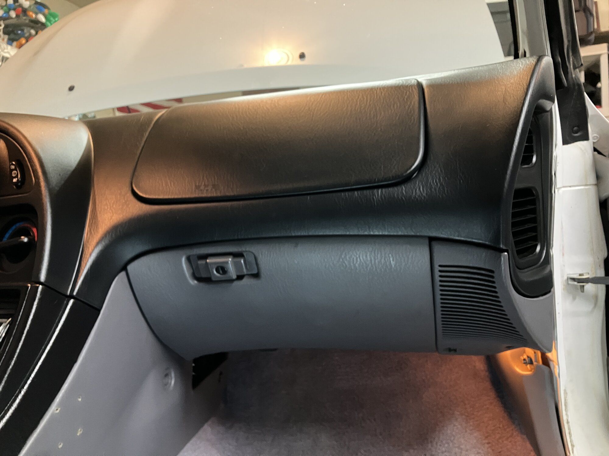

Little more work on the interior today. Real happy With the gray doors and black inlays. They came out great. Only tricky part was getting the 3 screws behind the defroster duct. I drilled out 2 5/8 holes to get to the top corner ones. Plugged the holes up with interior trim caps after the swap. Carpet turned out great after a few washes. Threw a few more panels on as well. Hoping to tackle the headliner and sunroof next. Had my apprentice with me today. Cheers...

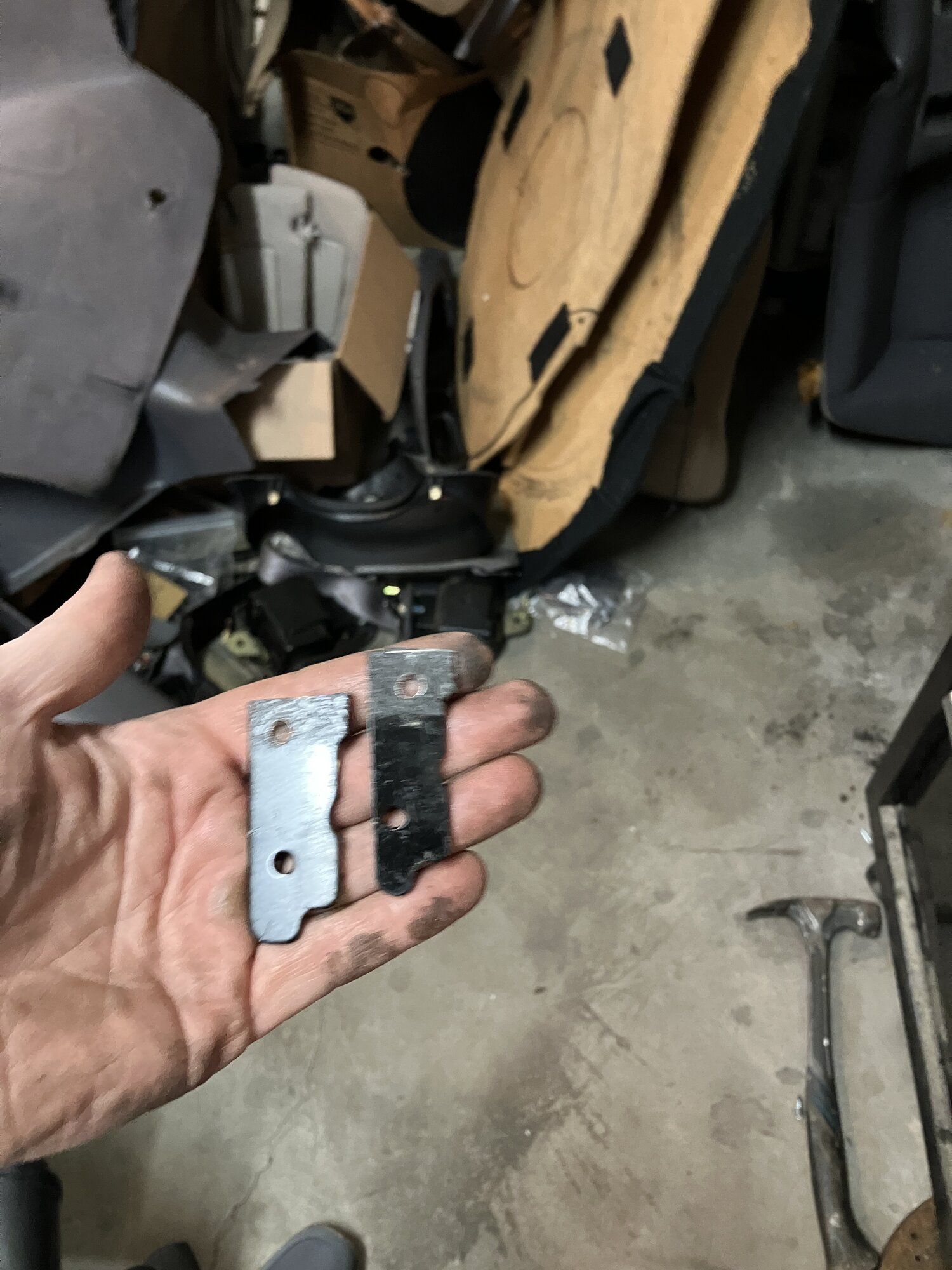

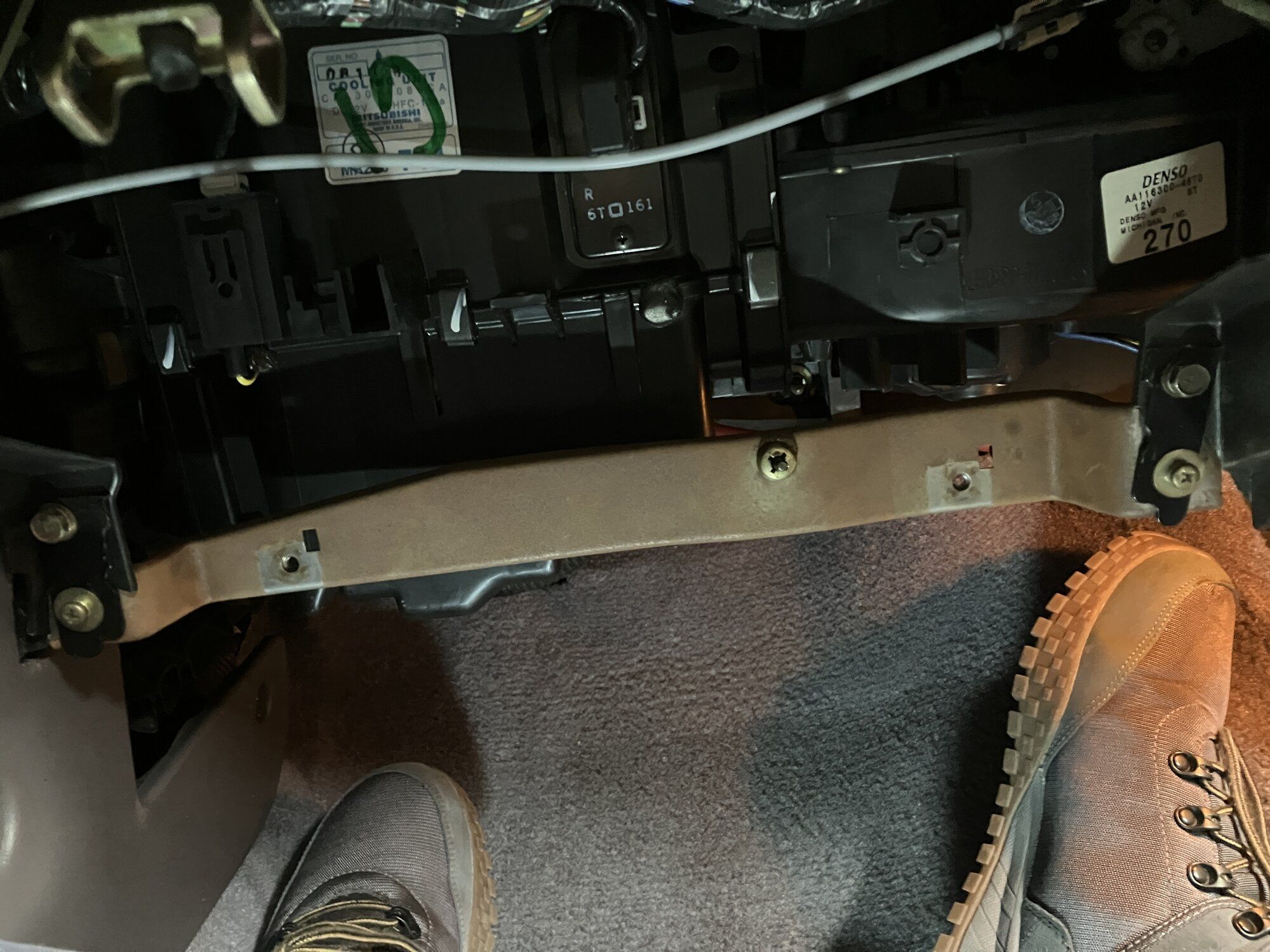

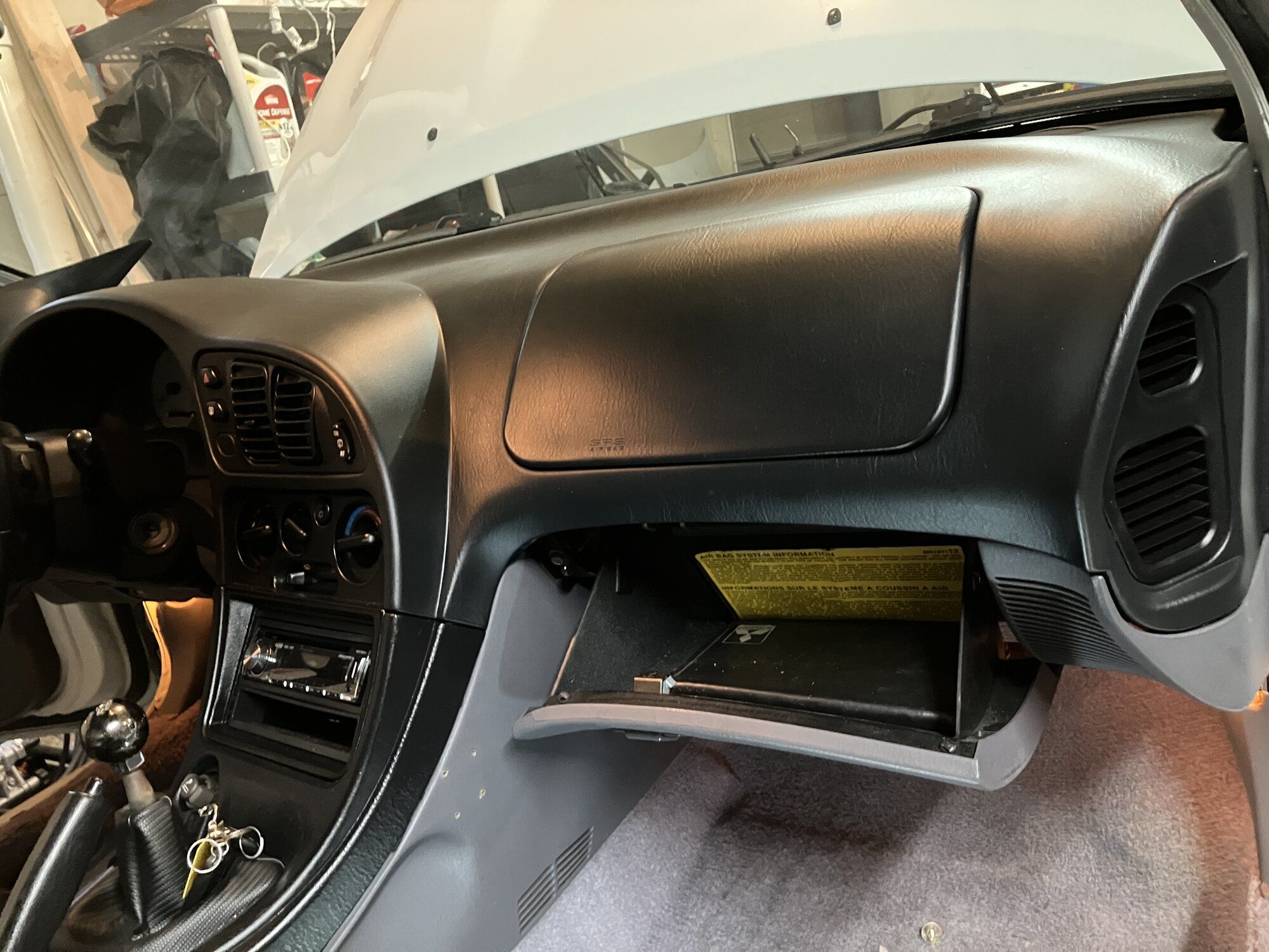

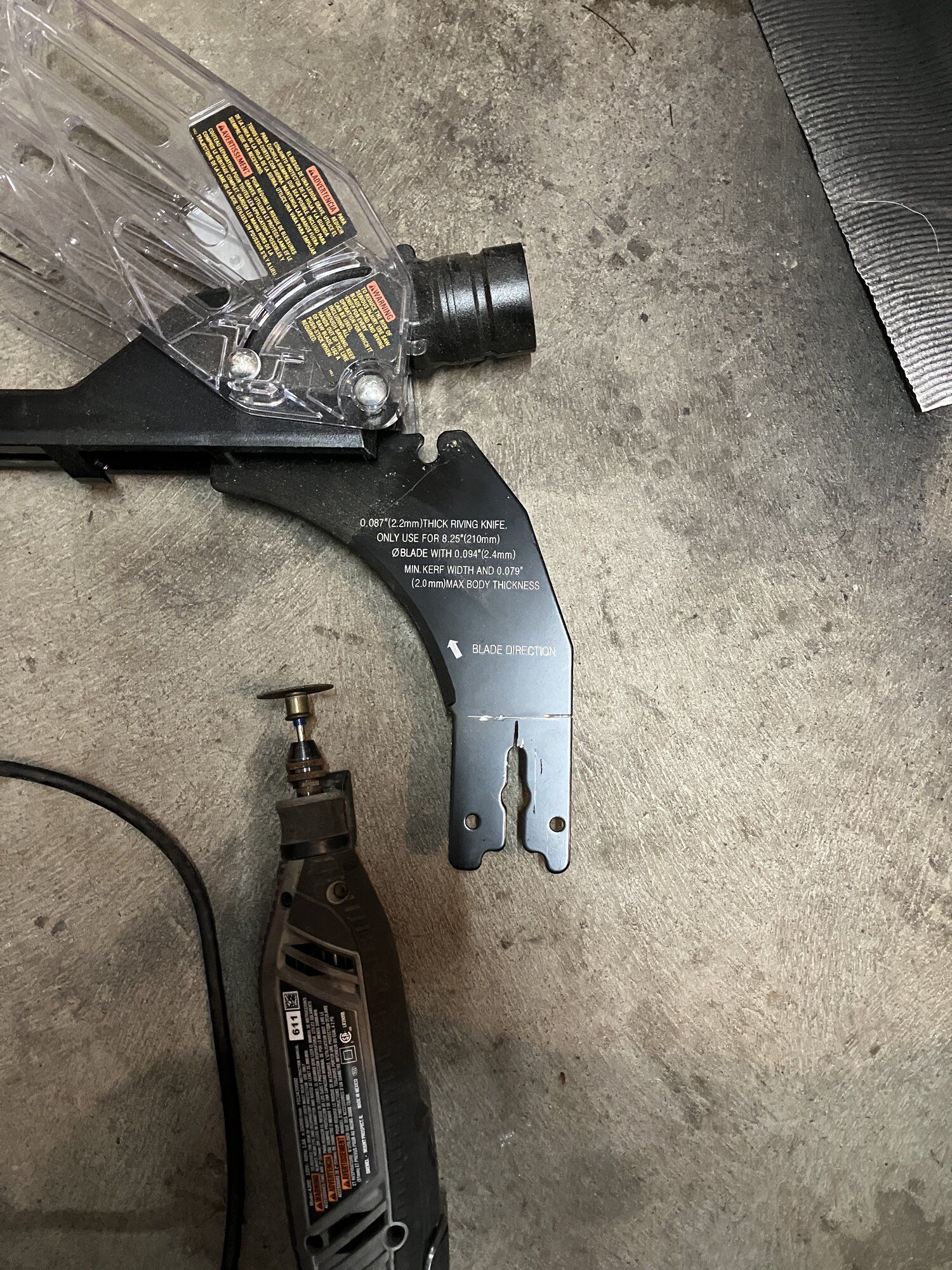

Little more interior bits today. Reinforced the glove box metal frame because the plastic bits of the dash were broken. So cut these pieces off some table saw clamps because who the hell needs those. Worked out real well, no more floppy glovebox. Took the sun roof out to try and get it less rattley. Didn’t make much a difference, I think the tracks just old and has a lot of play. Works fine though. Will hopefully get the new headliner and such back in tomorrow and planning to fix the fuel level sensor before putting the rear back together. Coming along well.

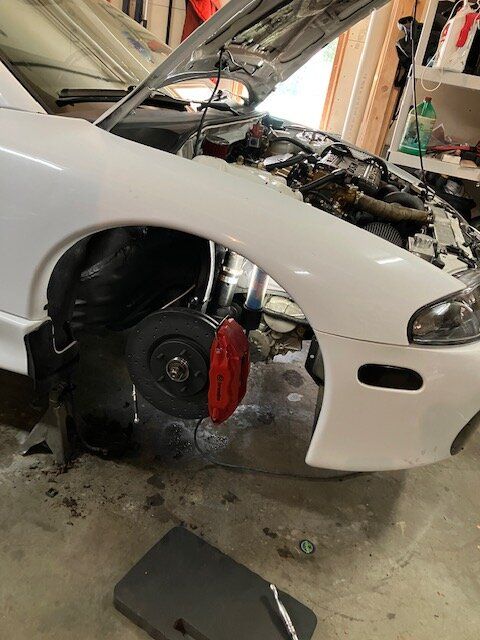

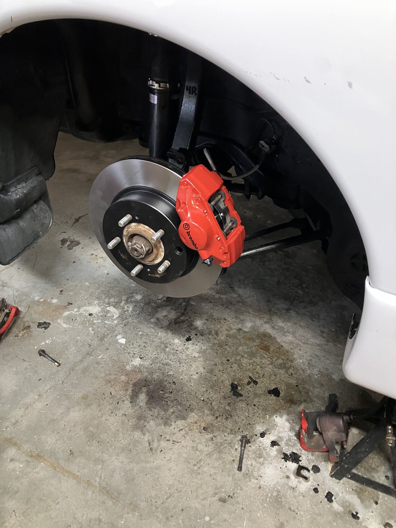

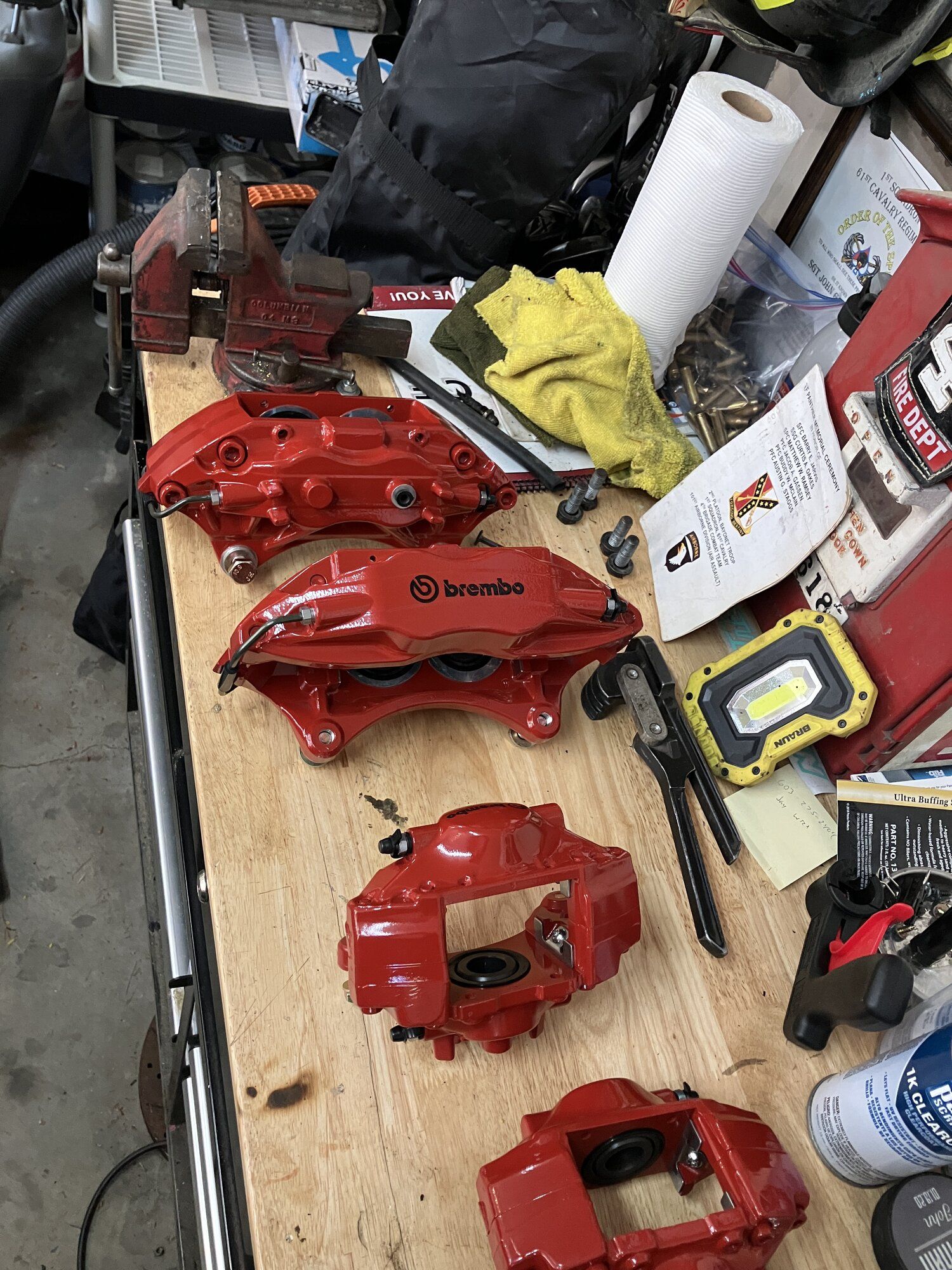

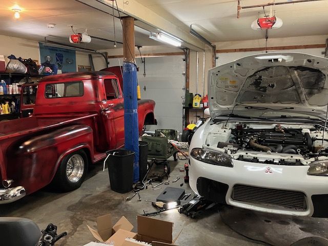

Been dormant for a few due to work and other car projects. But finally got started on the brembo swap today. Can’t tell you how excited I am to get these together. I’m going the jdm galant knuckle route. New bearings, hubs, knuckles, and evo 8 front and tears with the associated goodies. Hawk hps pads and rotors.
Old knuckles are out. Wasn’t too bad, luckily my car is pretty clean so was able to get through it pretty easily. I’ll take some more photos soon, but for now. Feast your eyes on these beautiful evo calipers freshly rebuilt and repainted 😍. Can’t wait to see the finished product.
More progress today. Everything is mocked up / bolted up / fit tested. Proper clearance all around, no issues. Ready for bleeding. Ignore that rotor being on the wrong side, I fixed that. Really impressed with just how good these look, they fill the wheel space incredibly well and these really some of the best brakes available for these cars if not THE best. Overall this swap was incredibly simple when you use the JDM Galant knuckles. Really turns this into a bolt on upgrade. New bearings and hubs went in easy, new knuckles bolted in good. Ordering a set of the Volk Lower control arms to really make this perfect and then I'll be done with suspension and brakes for a while. I have two projects going on and a lot of brake work on both. After bleeding down past the master cylinder like an idiot in my 56' truck, I thought I'd switch over to the gsx so I could collect myself and prepare to take the master cylinder off the truck for a bench bleed. Tried to bleed the gsx brakes in a one man show fashion again. Long story short I'm getting to old for that BS, I had to throw in the towel. I bit the bullet and ordered a bleeding tool from phoenix systems and I'm excited to use that. If I have to crawl around and pump the brakes by hand and then crawl back around to open one more bleeder I think I may just burn all the toys. Bleeding by yourself is just a nightmare, especially when most of the system has emptied out. More to follow when the bleeding tool shows up and I finish this and get the car back on the ground.

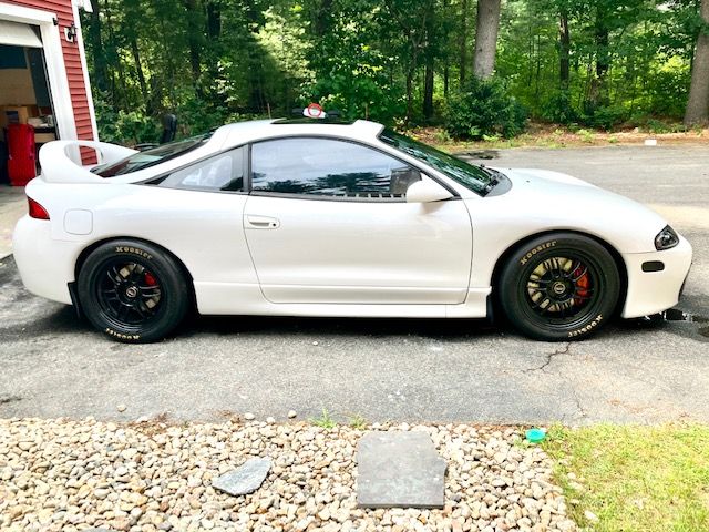

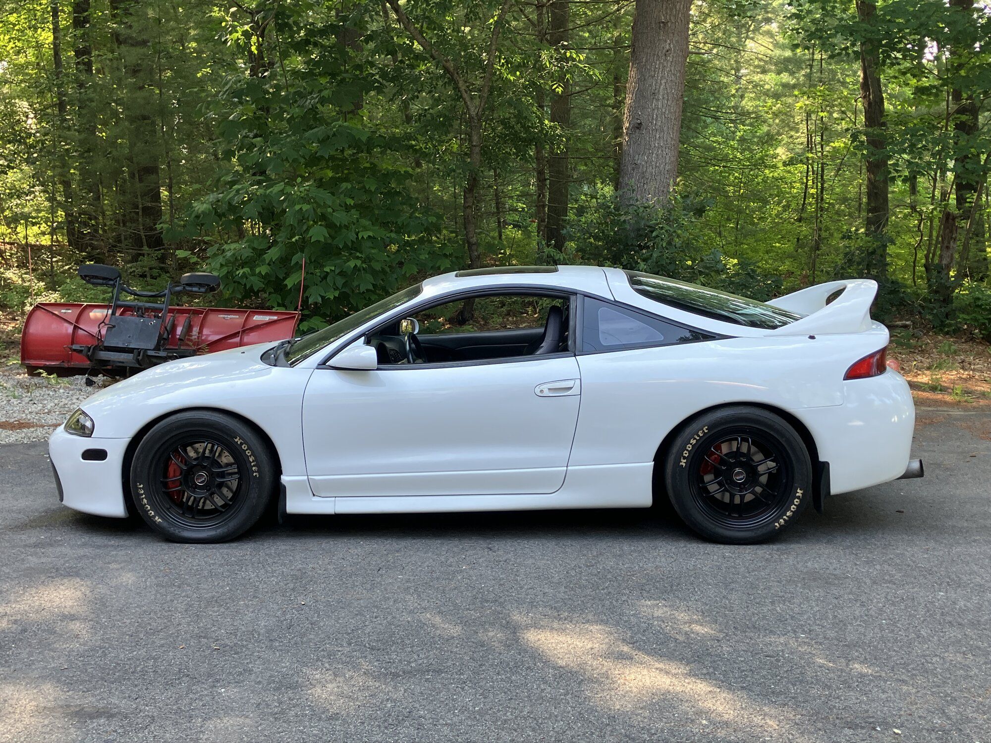

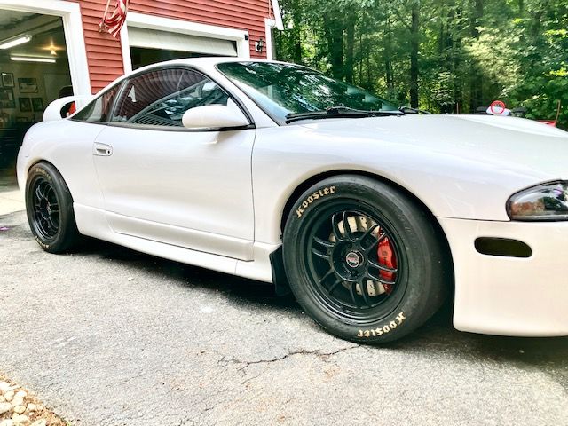

The brembos are officially on, bled and road tested. What a difference these brakes make. These things grab really hard, couldn’t be happier with how it all turned out. Bleeding the brakes was a marathon but after borrowing a buddies snap on vacuum bleeder it made my life much easier. My car has a 3G master cylinder and the pedal feels great with this setup. I’ll post up some more pictures after I get the car all cleaned up and ready. Had too much fun driving today to don the detailing.
Got the car out again today and just cleaned it up. Took it for another ride and everything is functioning great still. Still working to get some air out of the power steering and need to finish putting the interior back together but it's been either miserably hot or pour rain here lately so Haven't wrenched much since finishing the Brembo install. Will be getting rid of the DR2's soon as well and putting on a better street / track tire.

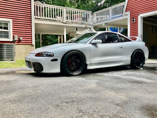

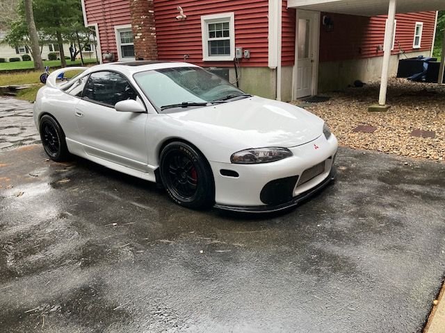

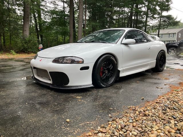

Finally had a minute to mess with the car and install some long awaited parts. Super happy with the carbonetics front lip and rear diffuser. After seeing these parts I think I'm going to add the carbon side skirts next. Love the way these look on the car. Been trying to sort a couple issues with the car, had a no start issue which had been bugging me, ended up finding the fuel pump relay died. Swapped that out and all is well. Still trying to get my power steering to work but can't quite figure out why it's not working. I'm assuming the pump or the rack is junk, so will start there next. Enjoy some pictures.

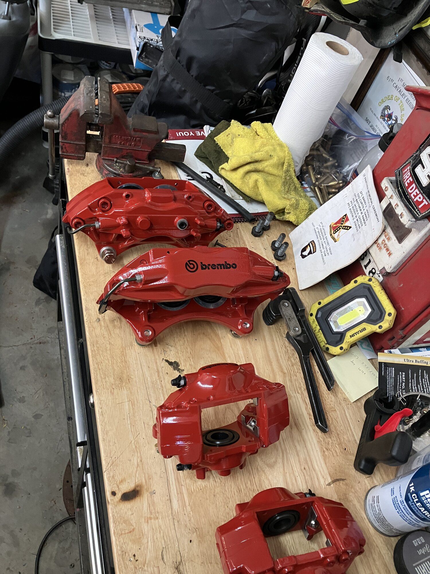

Is that direct bolt on with the JDM knucks or do you still need an adapter? Looking great man!
the purpose of the knuckle change is so that you dont need the adapters. if i remember correctly the stock 2g caliper bolt hole distance is 140mm and the evo brembo/jdm knuckle is 160mm
For the 3g master cylinder.. are they all the same? Which model of the 3g eclipse? Anyone have a part number?
