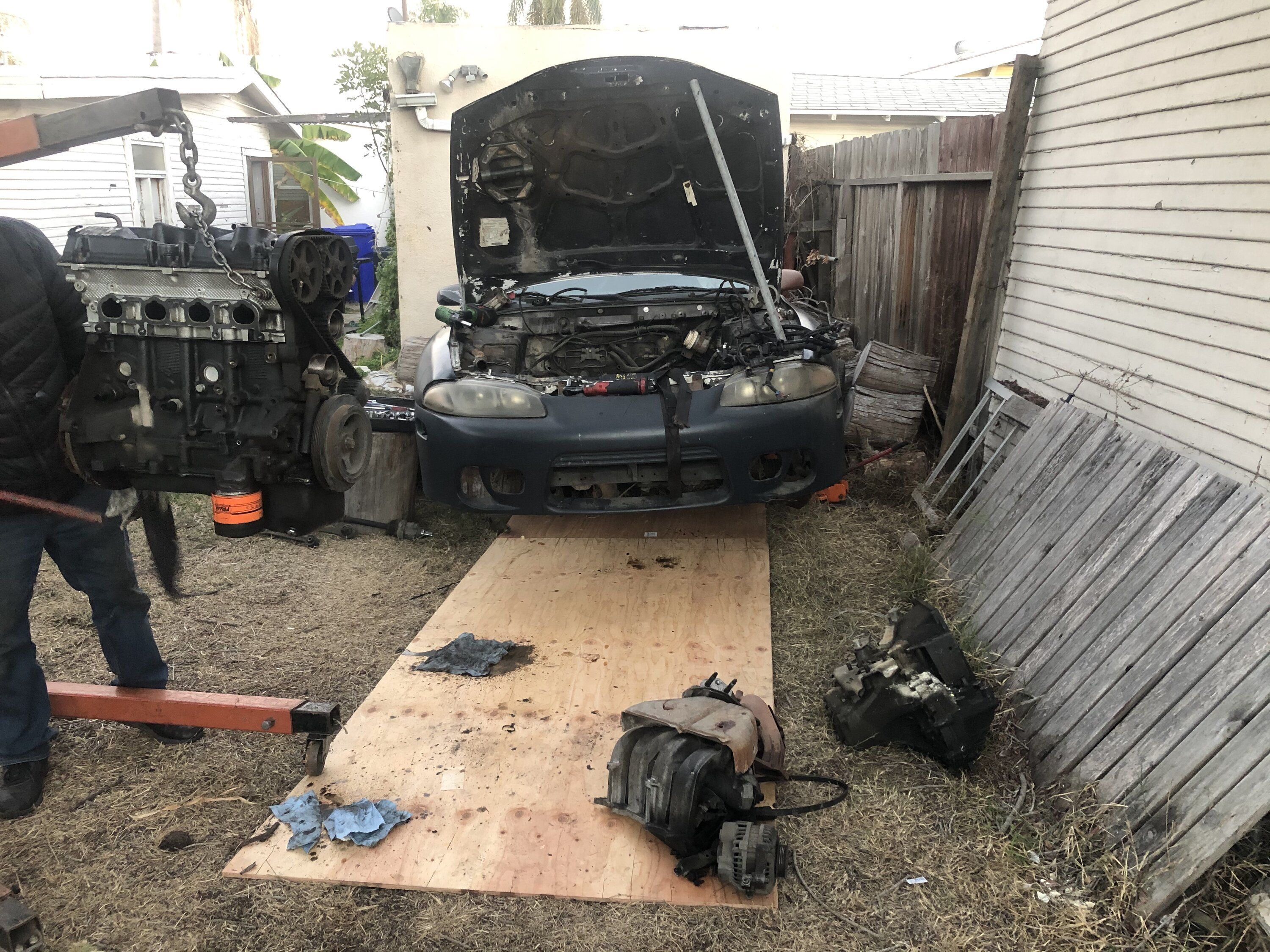

after a few weeks of looking for a 420a engine online or anywhere for that matter, I found someone 150 miles away willing to sell me their spare engine, it was abandoned in a shed with the oil pan out and and the bottom exposed and the top as well due to a pair of missing spark plugs, once I opened it i realize the cylinders and block had some rust, but the crankshaft is salvageable, I think I have enought parts on the purchased engine to rebuild my own engine.
Now with my engine out and taken apart, I am taking it to a machine shop to get everything straight and clean, I will update once I get my things bad to see how much they scraped off.

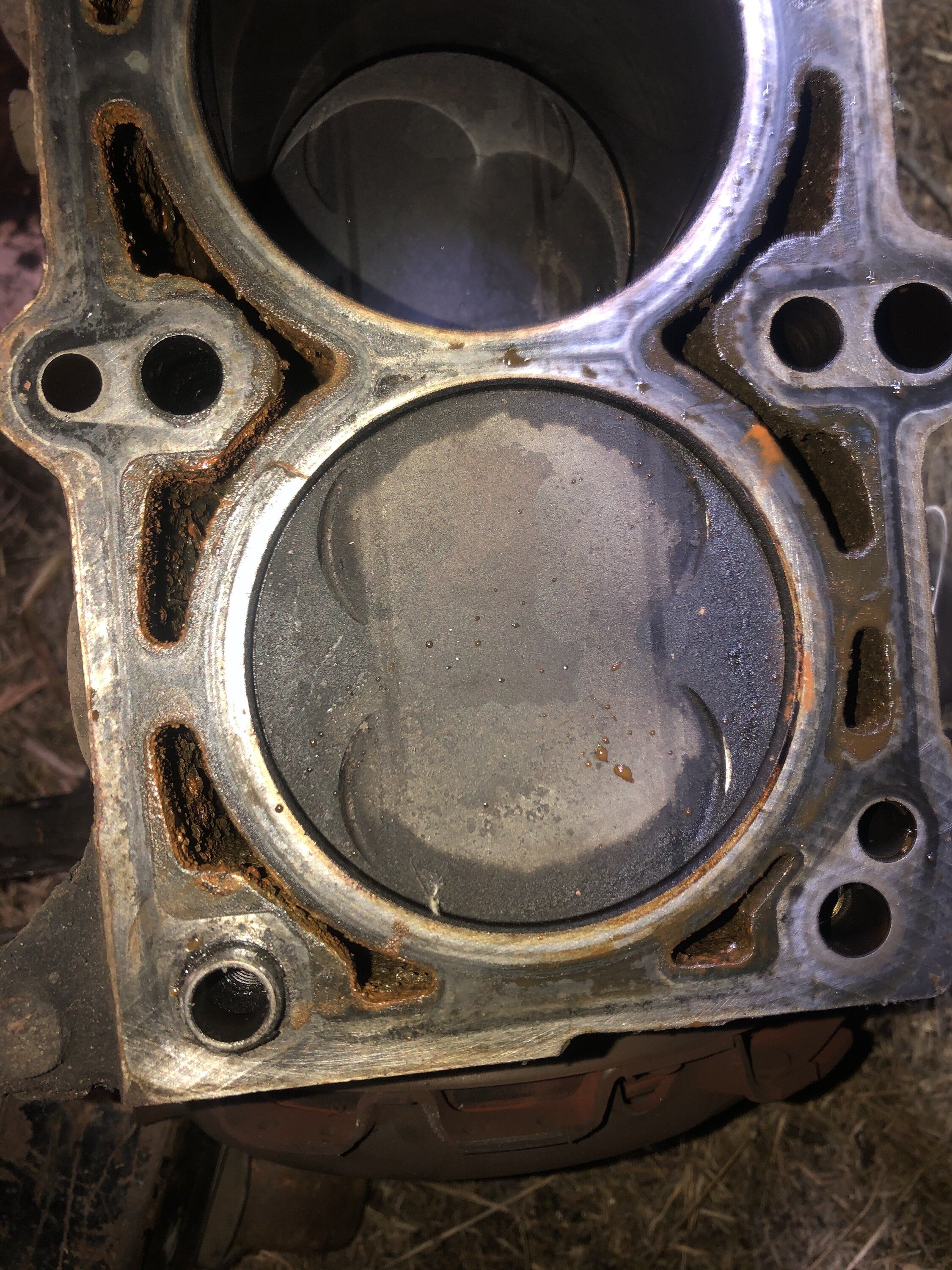

with my engine out of the car and taken apart, I can finally know the extend of the damage:
- 1 valve was hitting cyl 4
-that cyl rod bearing was loose
- cyl head has scrapes
-oil pan was so sunk in that it prevented the oil pickup to pull the oil properly, which I am guessing is where my issues started.
you can see the scratch in this pic, of the valve smacking the piston.

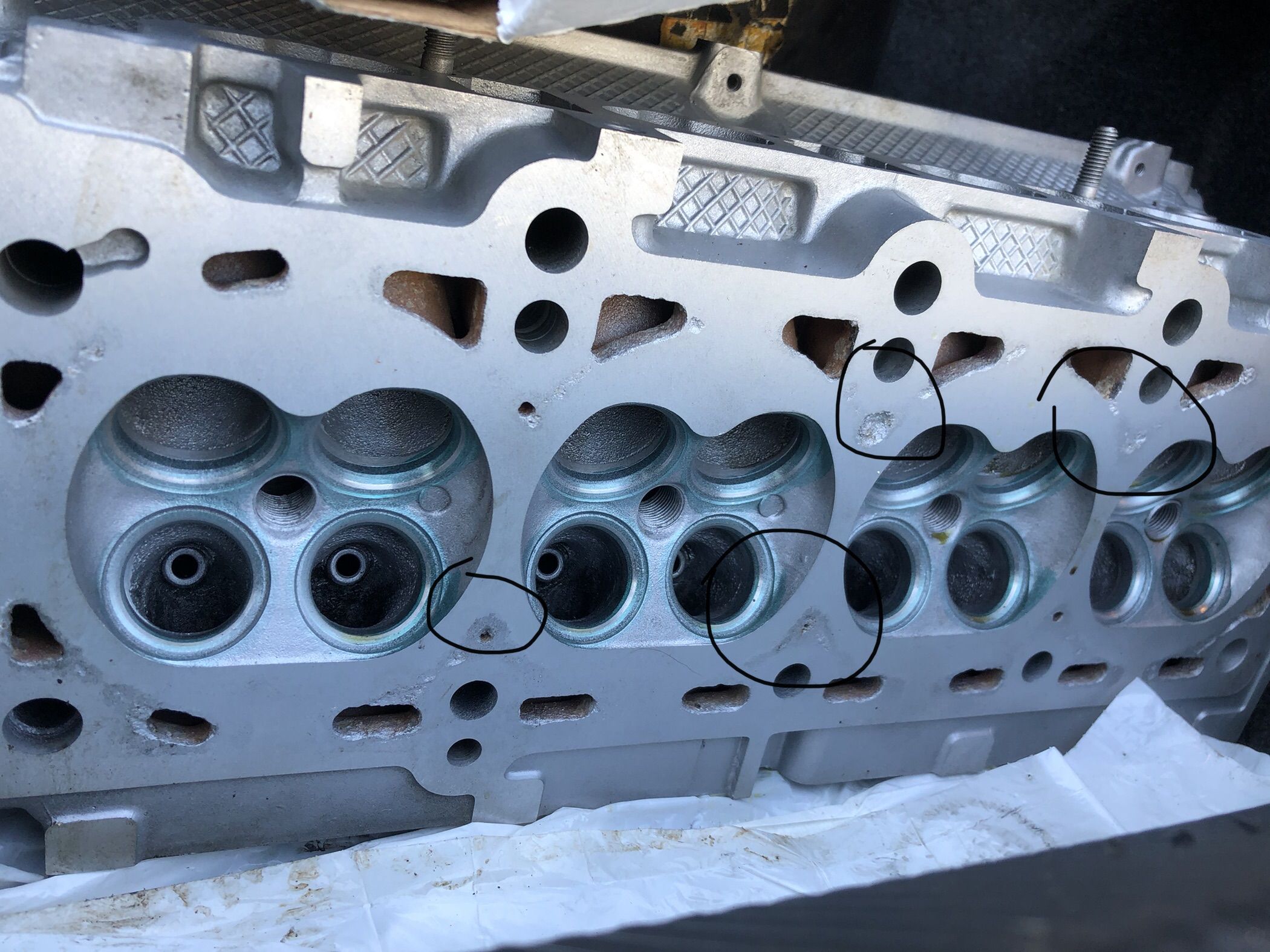

Hey guys, so I've made some progress on the engine rebuild, after a few setbacks, the head from me original engine (og eng) was destroyed by the machine shop, so I moved on to the head of engine I bough for spare parts (eng 2), and took it to a new machine shop, they did a good job, but turns out the head had some damage (see pic), the shop helped me locate a third head and I got that flat and clean. Trying to get the engine together, but I am having a difficult time finding the head dowel pins, one of the perks of rebuilding a 23 year old not so popular engine, dealers found 1 out in the east coast, but they don't know if it is actually in stock until the order is processed and they can have someone look and find it or not, and update the system, so that would put me 1/2 for pins I need, I ordered a pair from Mitsubishi Parts Warehouse (does any one have any feedback on them?), so fingers crossed they have it, and hopefully I wont get an email back from them in a few days stating they are cancelling my order since they are out of stock.
This shows the damage on spare head (eng 2), most of that wasn't completly visible until we shaved it. But luckly 2nd spare head was in great condition.
