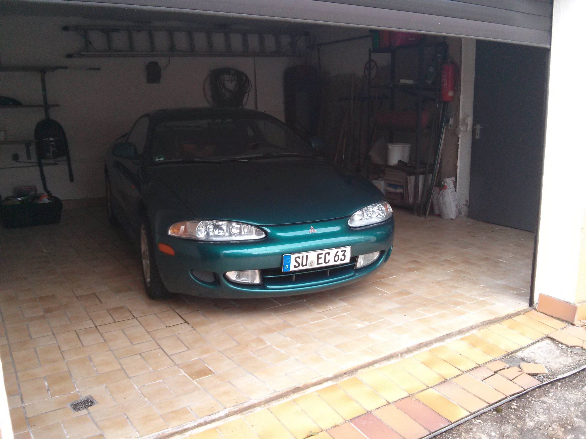

'97 Euro-Spec (#Germany)
My very first car and first project car
Black interior came first with the facelift '98.
The 97 model is a bit of a mixture of 2Ga and 2Gb.
Technically a 2Gb but with 2Ga exterior & all grey interior except the panels around the radio, etc.

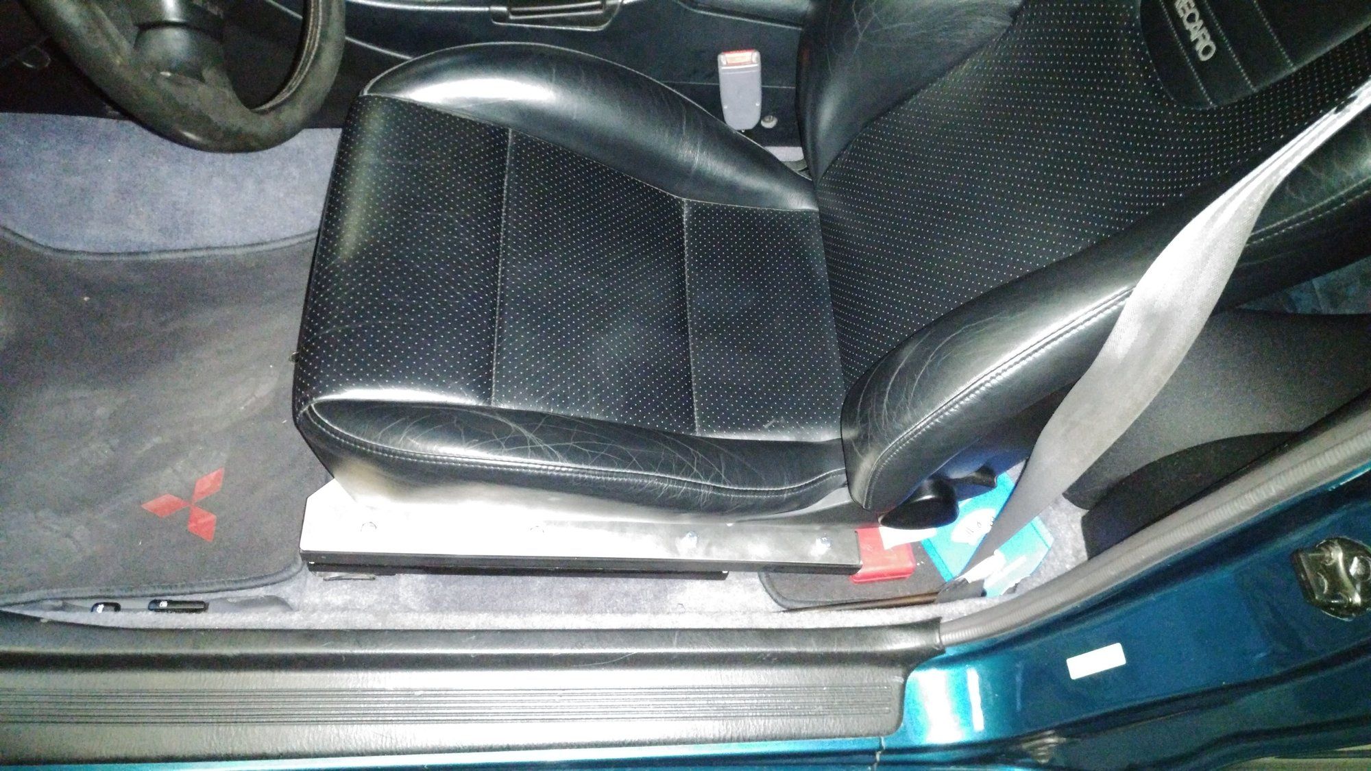

And one day later, I have registered the seats from the Evo in my registration certificate. 15 minutes and 90 € left at the TÜV :hmm:, but the car is now 100% street legal again.:hellyeah:

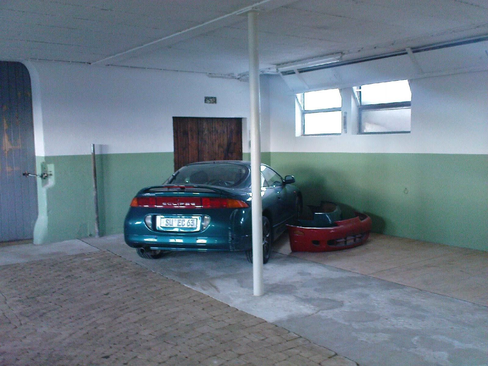

2013-06 I was able to park the car with an older lady in her garage. Only 2 villages further on, but thanks to traffic a good 25 minutes if you don't drive there on weekends. Therefore I spent most of my Saturday at the car.
Roughly speaking: Approx. 1.5 places in the garage and a small additional room (dirt room).
I didn't have to pay much. But unfortunately no running water.

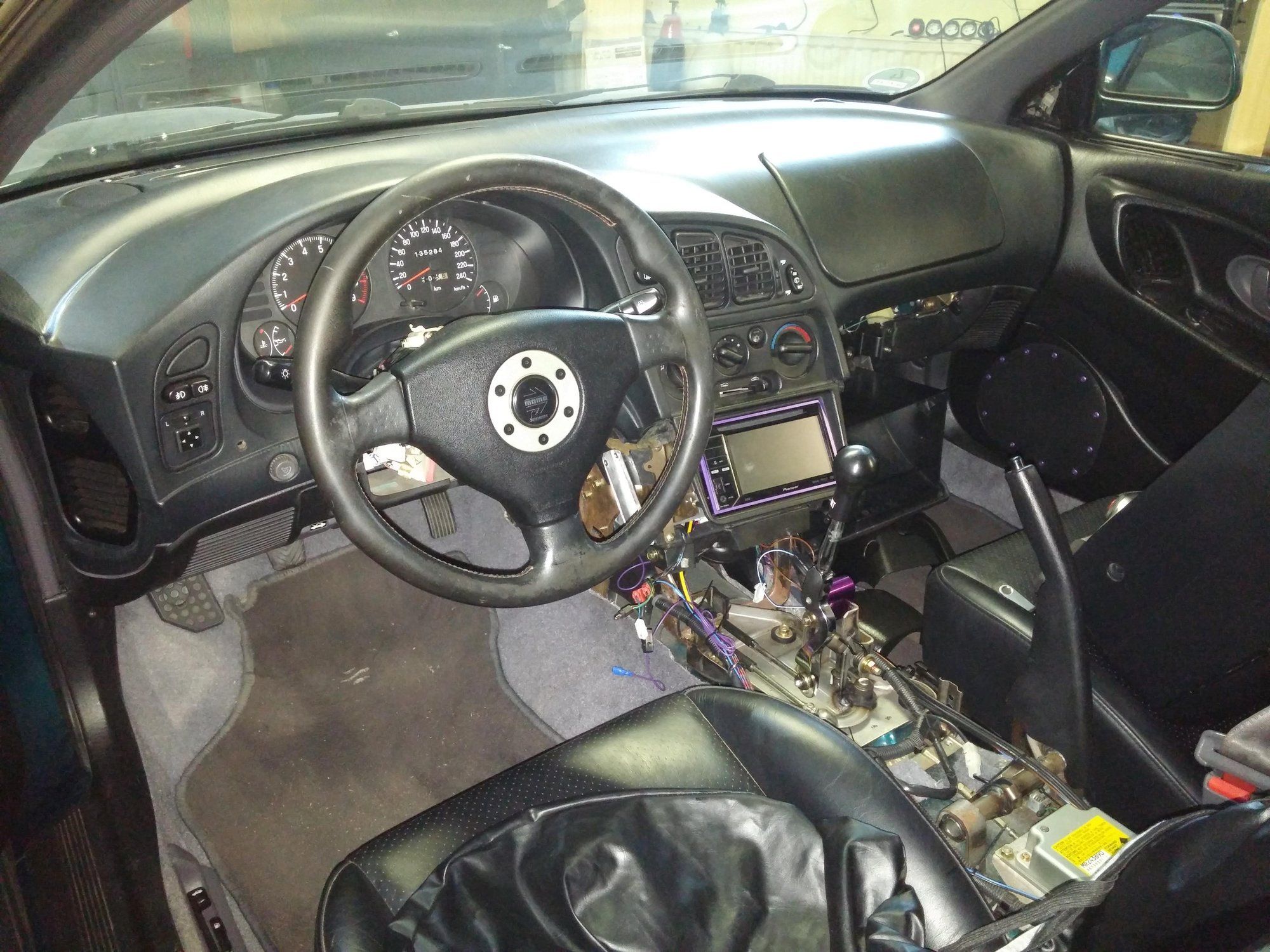

The grey interior was removed, cables for Hi-Fi were laid and a black interior was built in.

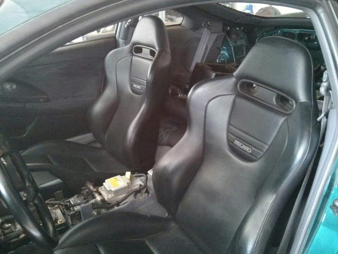

Purchase of 2 Evo 8 leather Recaro seats with Evo sliders.
Conversion of the rails to the feet of Eclipse rails and subsequent disposal of the entire rails, as the heat from welding has distorted everything.

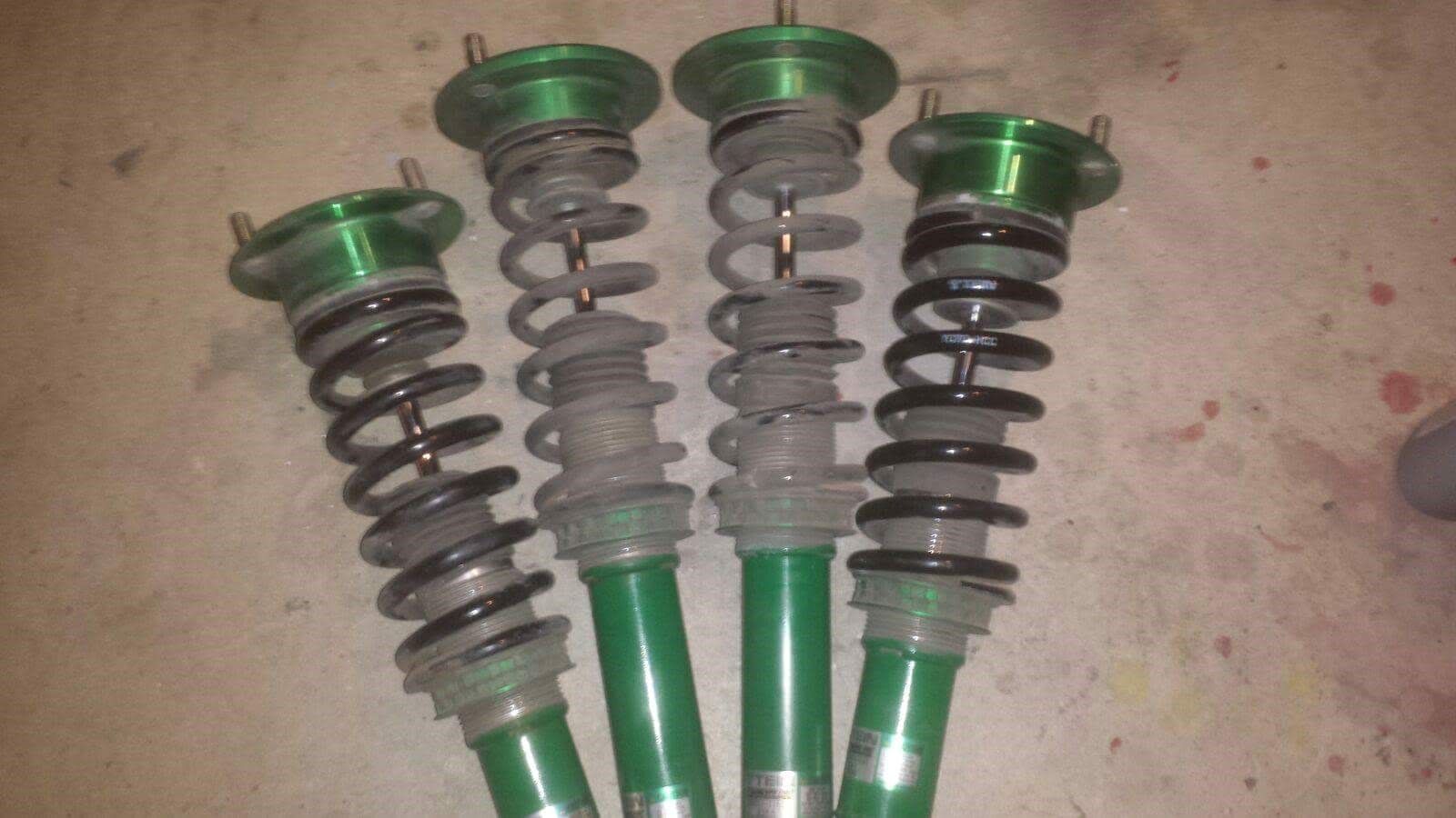

Purchased a used Tein coilover. Unfortunately 400km far away, but thanks to friends from the eclipse scene no problem. 4 weeks later the coilovers were brought home to me.

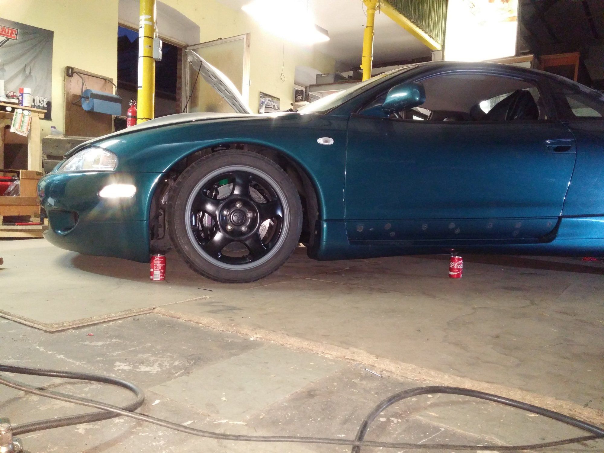

2016-06: Tein coilovers built-in. Still on the borrowed Enkeis from 3000GT.

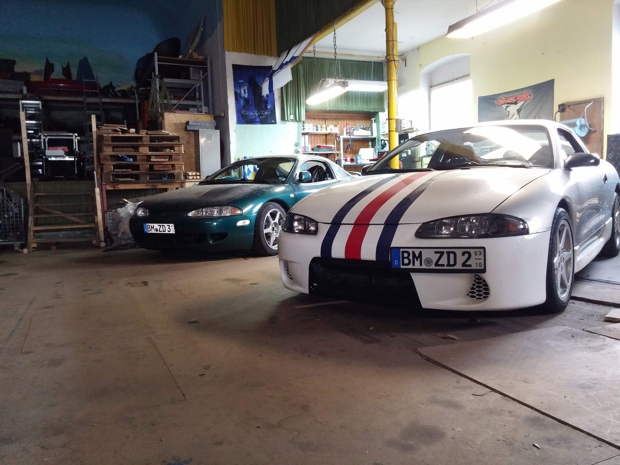

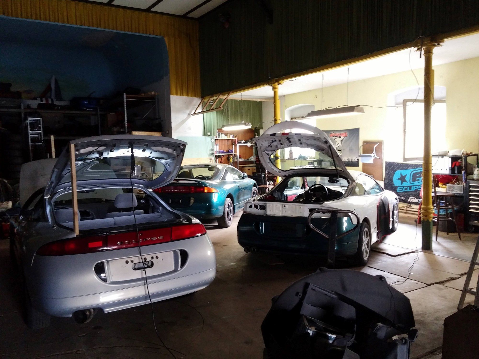

With little light and space to screw we continued. We were subtenants. Until the main tenant said he would quit the hall at the end of 2016. Our time has beaten!
2016-07: My buddy bought another Eclipse, because the old body was completely rusted out.
2016-09: After 2 years break the car registered again. Also the new Eclipse from my buddy is registered again.

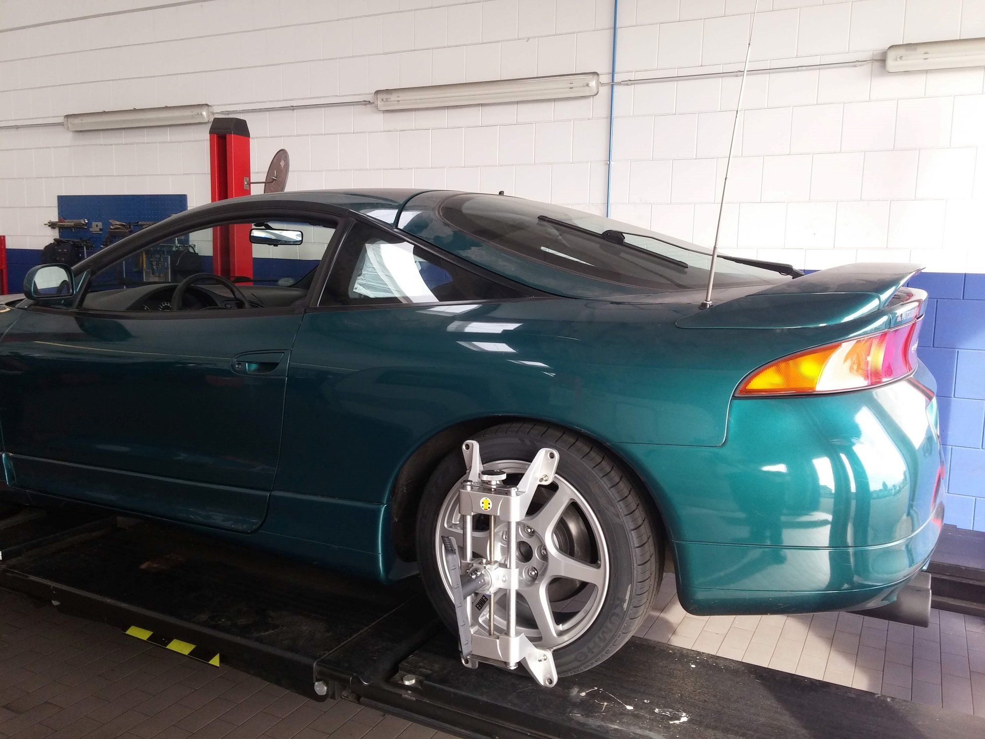

The first test drive with chassis and tyres went directly to the wheel alignment.

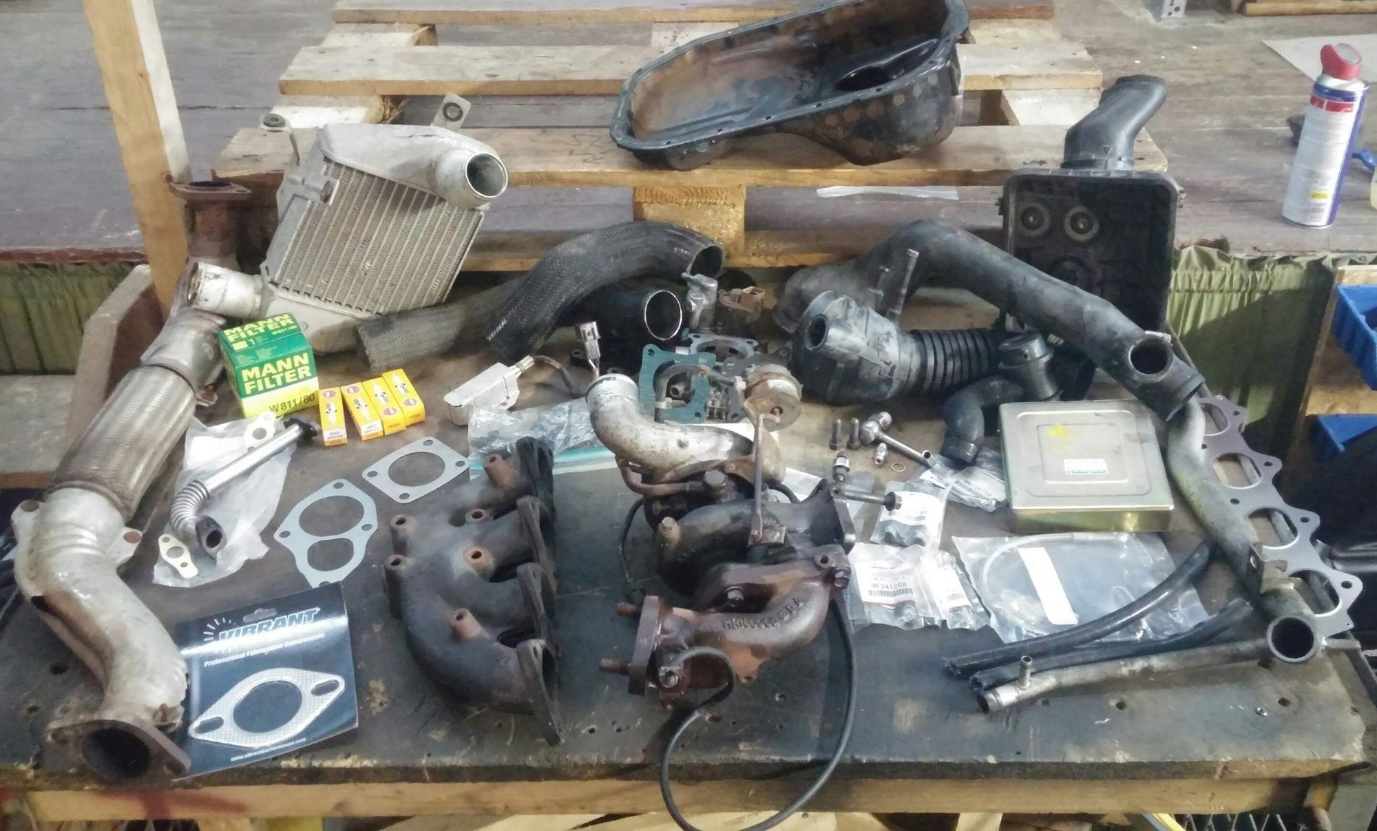

2016-12: I finally bought a turbo conversion kit. Stock T25 turbo conversion. Should do it for now. Will unfortunately still take some time until I start the conversion. (Yepp, I was damn right.)

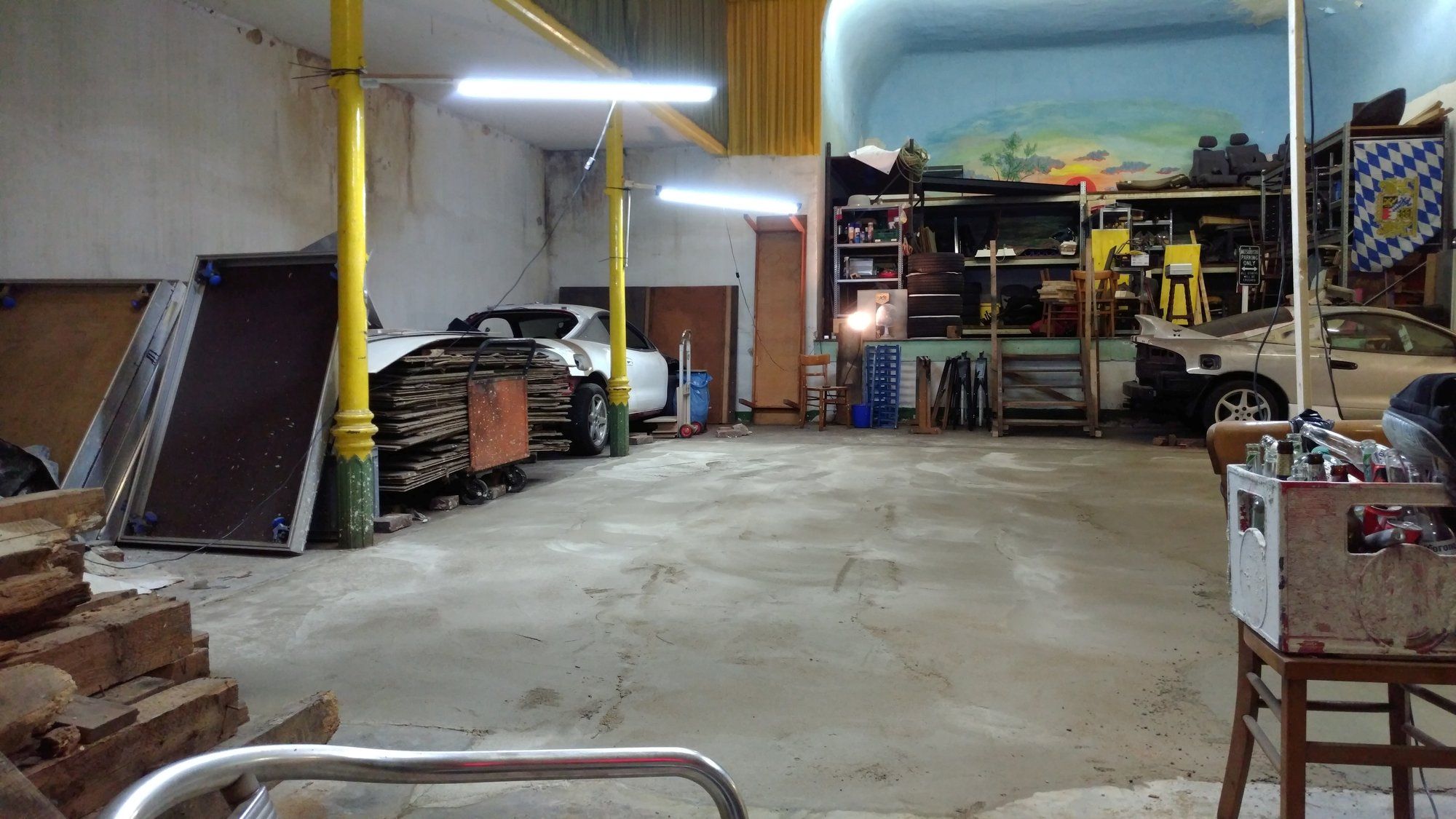

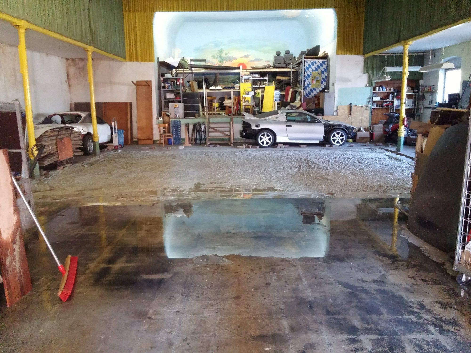

I'm renting the workshop with my best buddy. We are 2 tenants and have again 2 subtenants.

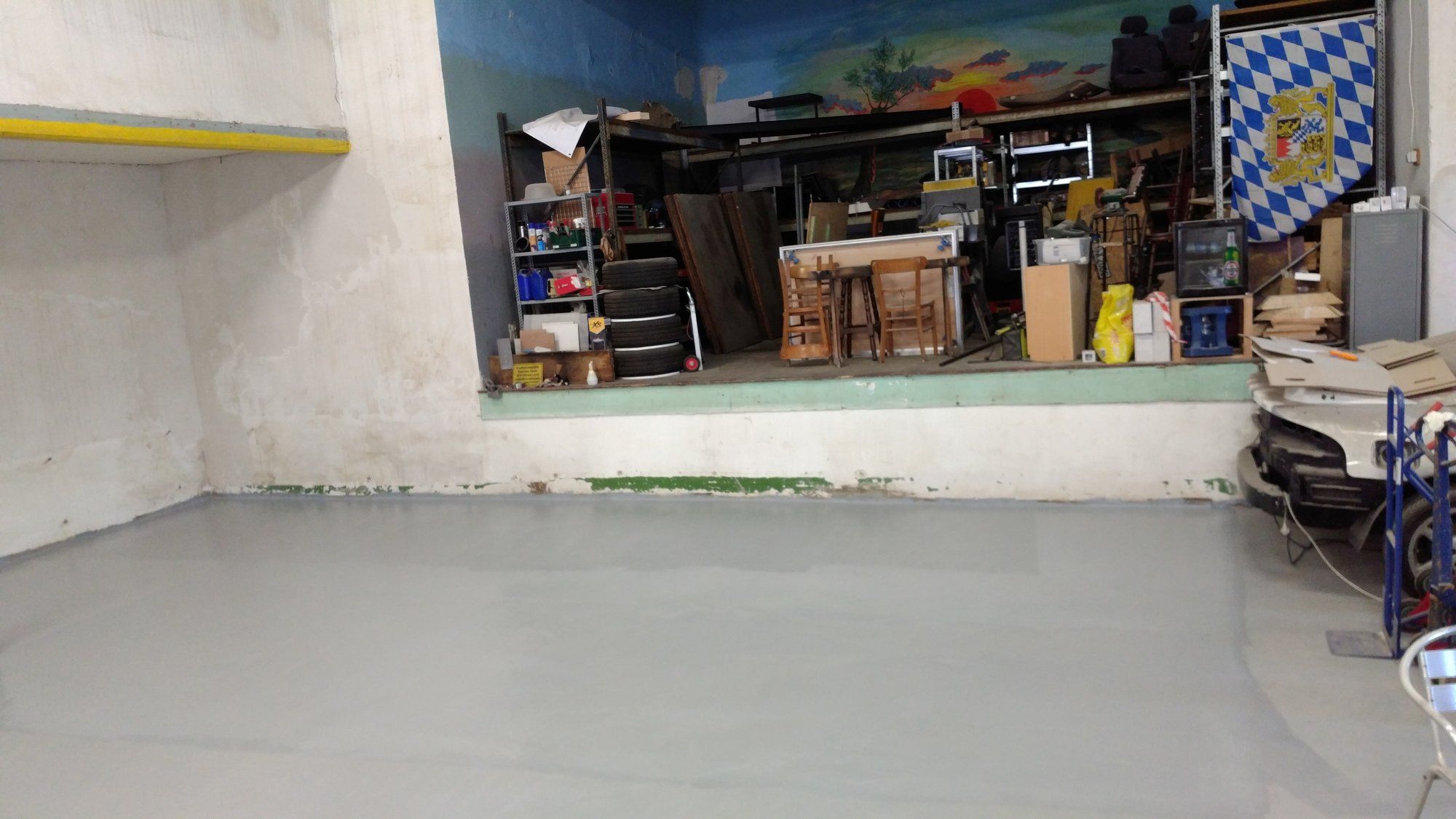

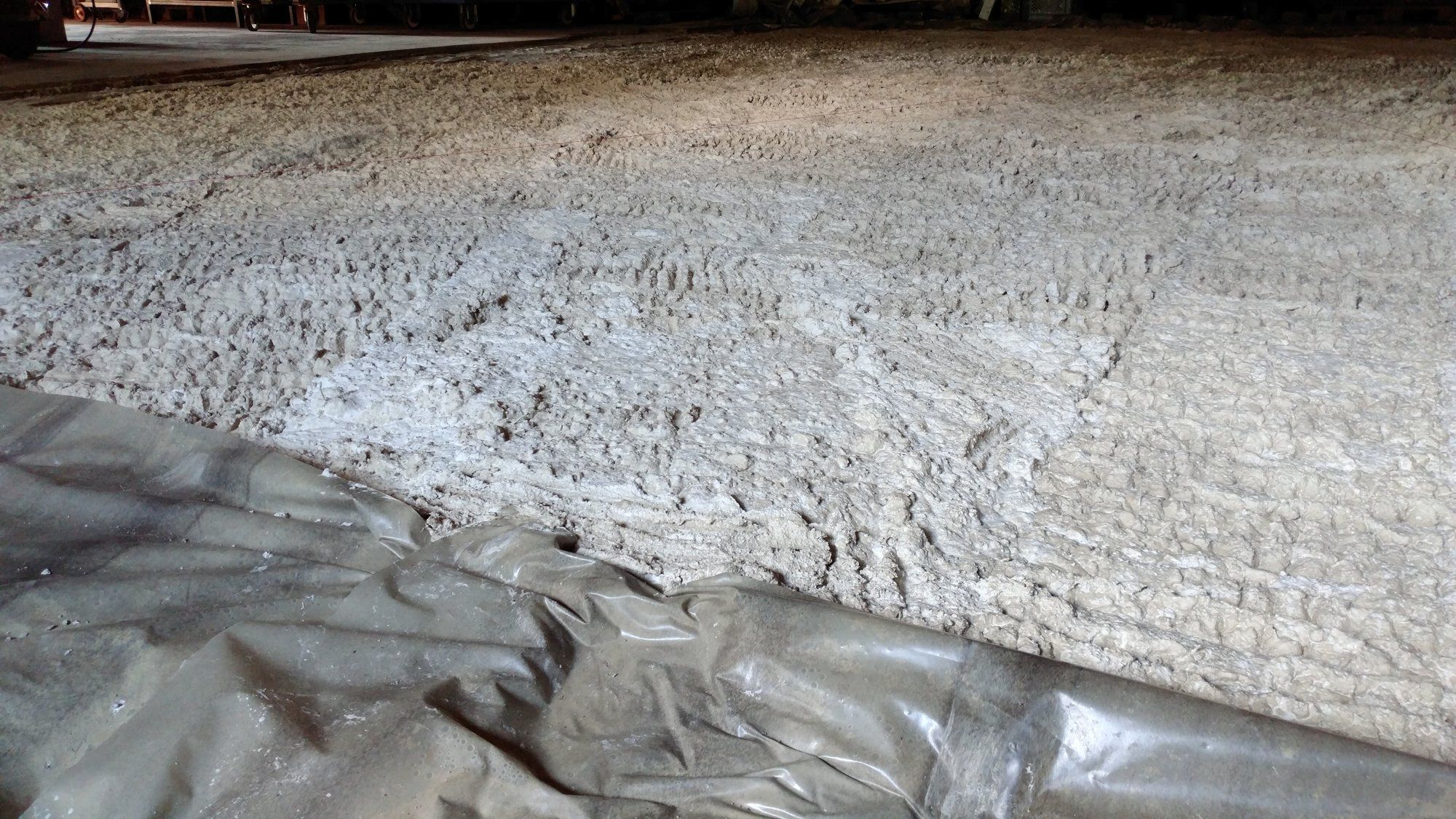

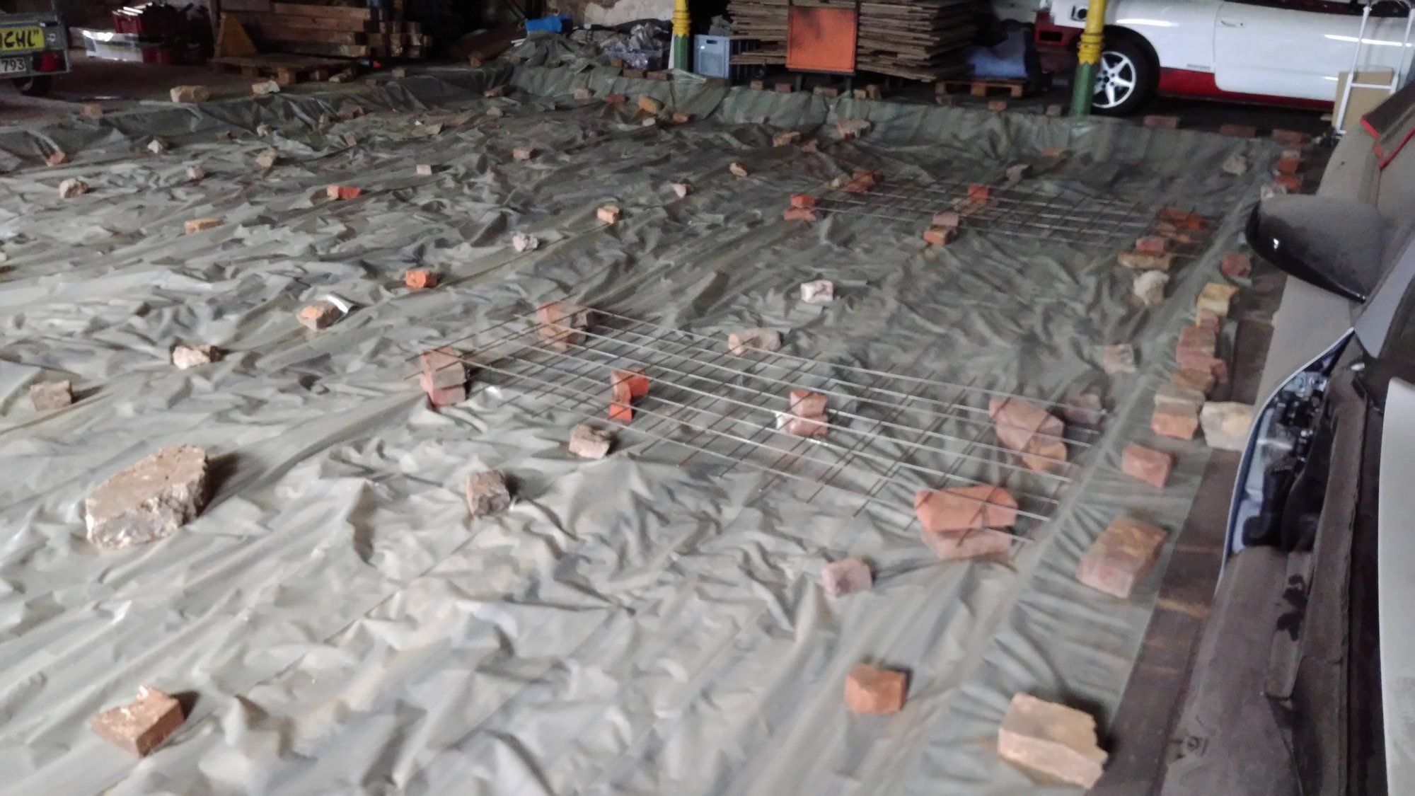

The year 2017 we have a lot of renovated and rebuilt. Among them was a floor slab made of reinforced concrete. 30cm thick. Reinforced steel frame and reinforcement mats in the area where we want to install a lifting platform.

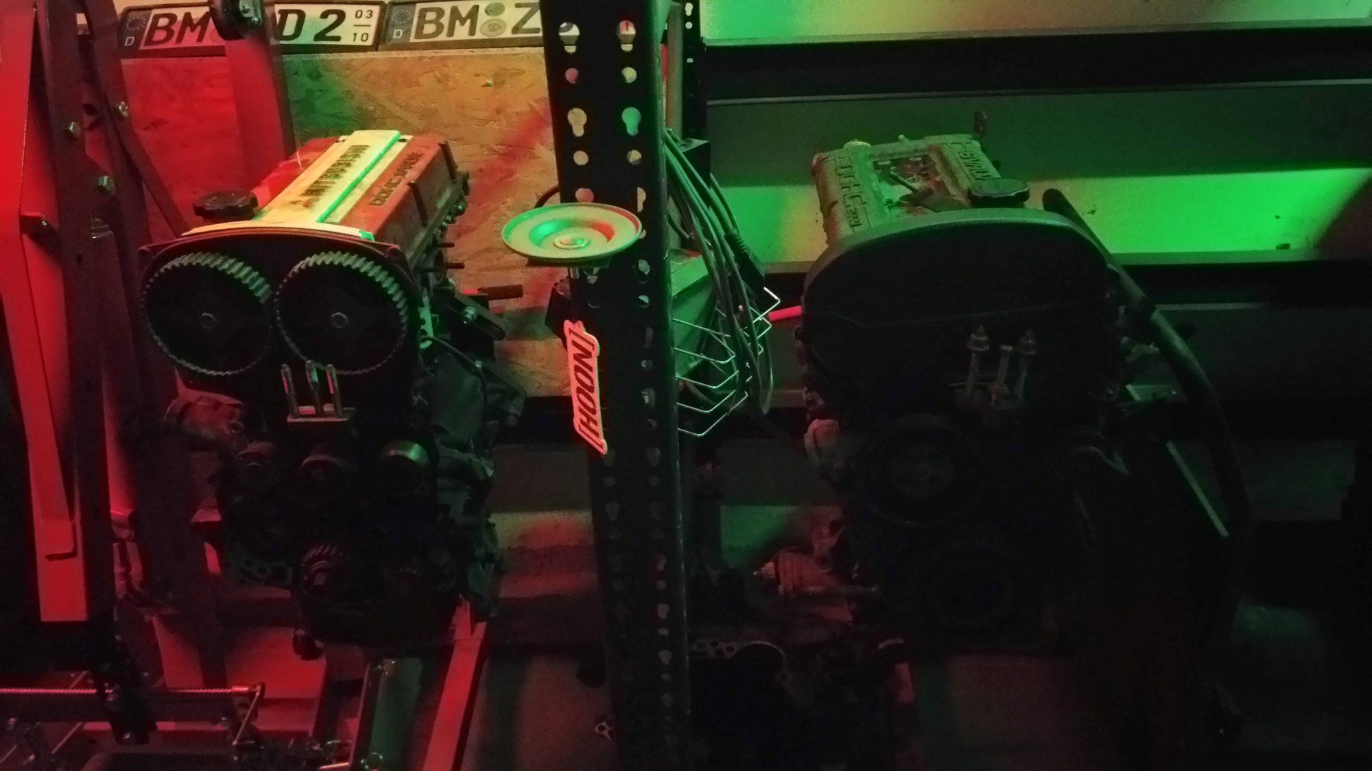

On the same day my buddy bought an Evo 4 engine. Only 50km further. He wanted to swap it into the RS car.
From his first Eclipse I removed the engine. 4G63 N/A like all European Eclipse. Is now my replacement engine. But it needs new bearings!

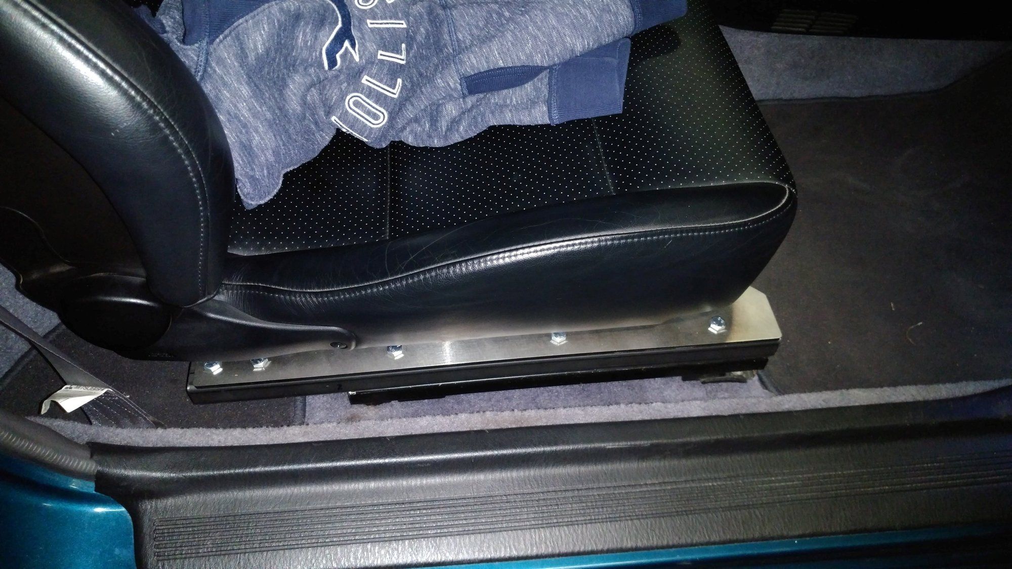

For the main inspection I had installed the OEM seats. 2 days later I used my own consoles again and drove it to my local TÜV branch and registered this structural change.
Completely self-designed and built. Consisting of original listening rails, square steel tube to compensate for the offset in height. On it 2 adapter plates from 5mm stainless steel.

  • Double slot sized radio has replaced the original radio and watch compartment. But I'd like to retrofit something different, like an single slot sized DAB radio with a good integrated amp.

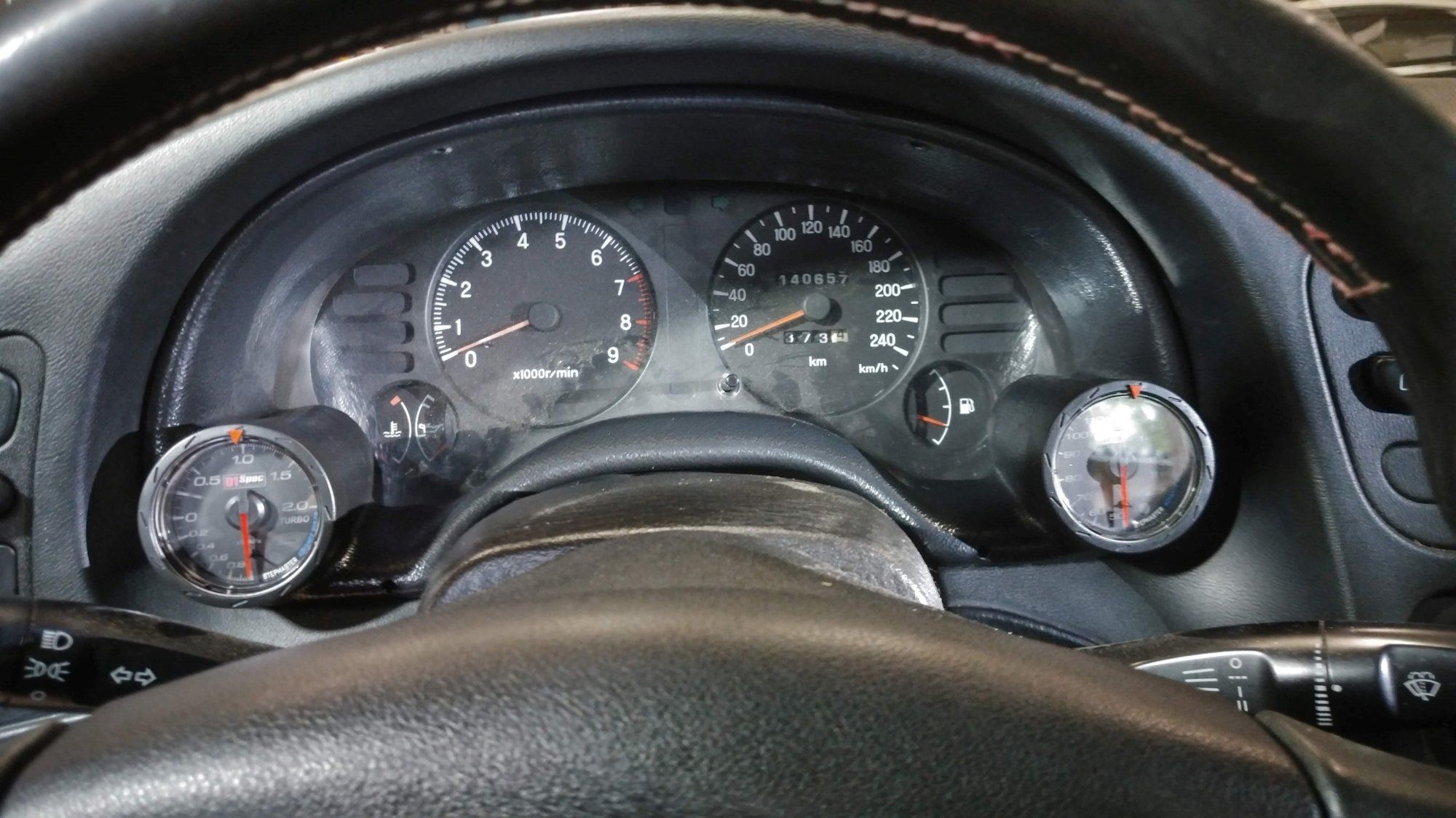

  • I already have two additional D1 indicators for oil temperature and boost pressure. Mounted in a holder from ExtremePSI (Glow Shift). But I'm very unhappy with the fitment!
    Half an inch of air between speedometer and frame ☹
    Planning is to use a display for all additional sensors. This then below the radio.
    Additional gauges have already been removed and sold.

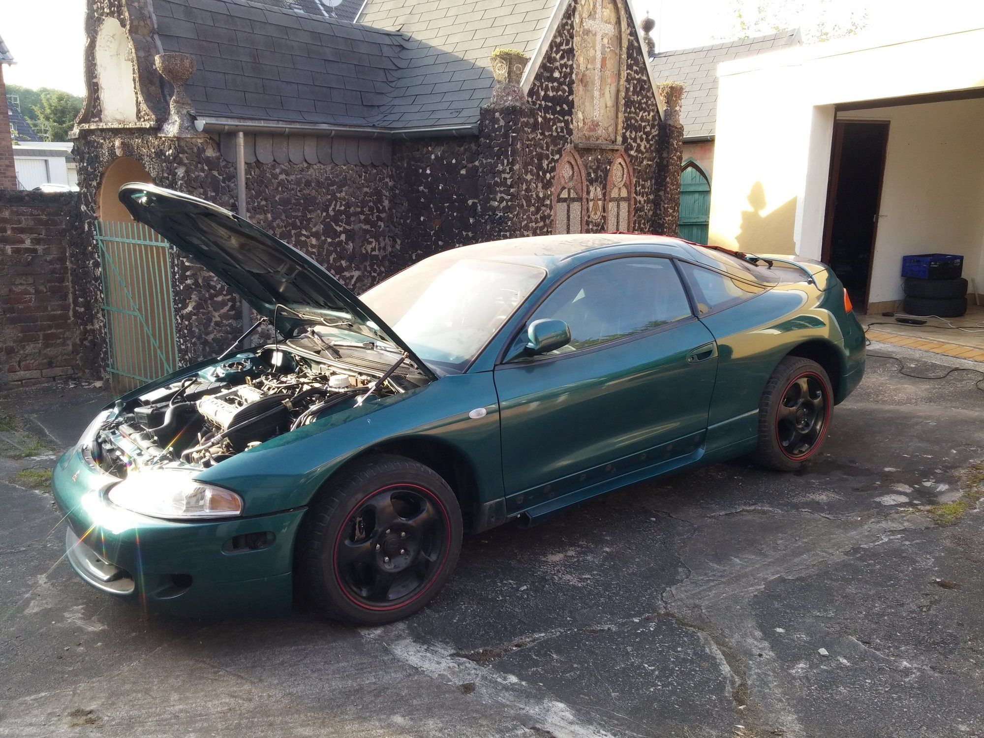

The season is over and I want to start the build.

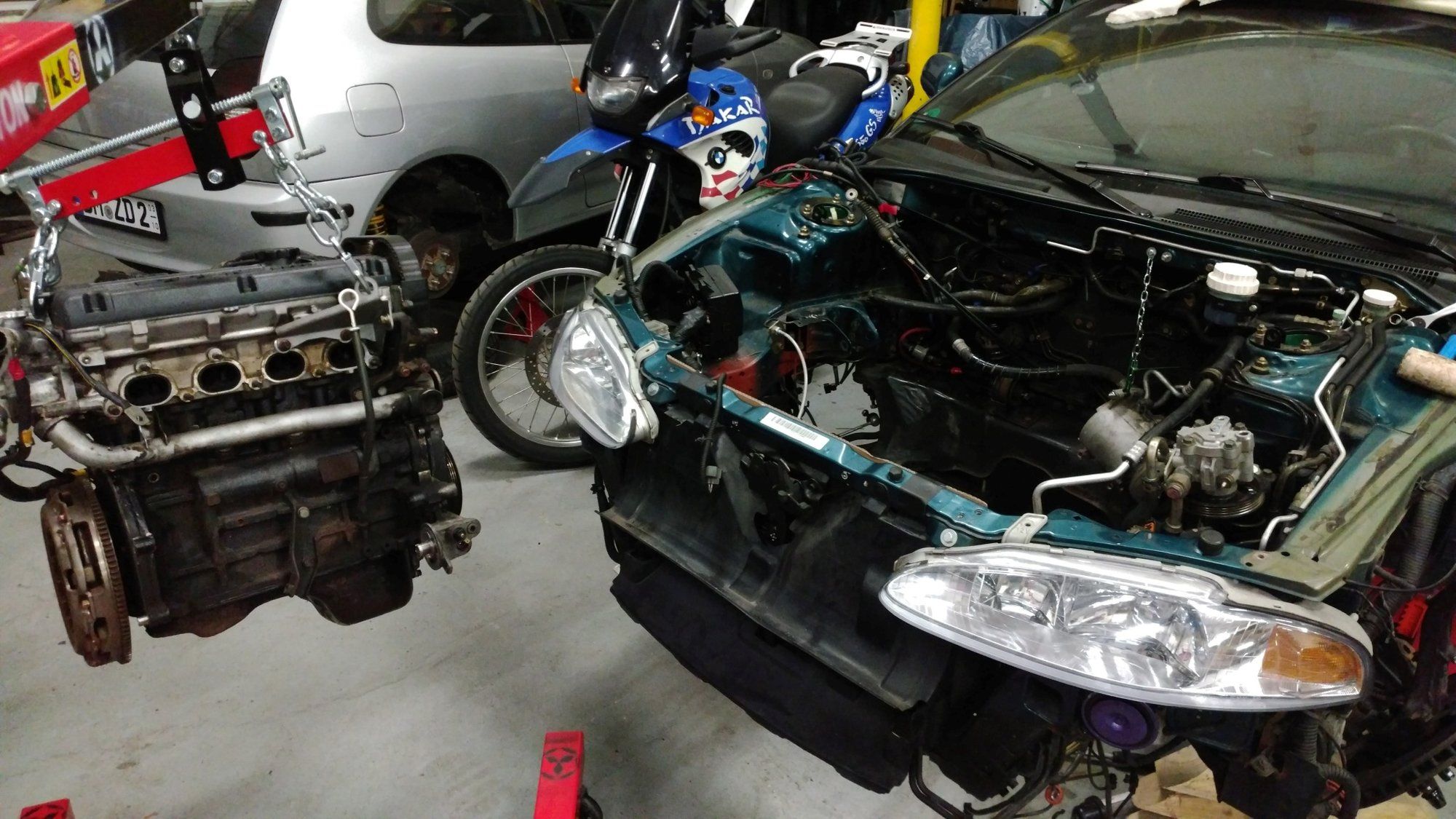

At the moment I have removed the gearbox and engine.
I left the air-conditioning compressor and servo pump in the car. I don't want to mess with it.
I will clean the engine compartment thoroughly and fight rust. Afterwards I will repaint where there are so many scratches.
The domes are still surprisingly good, but I will watch!

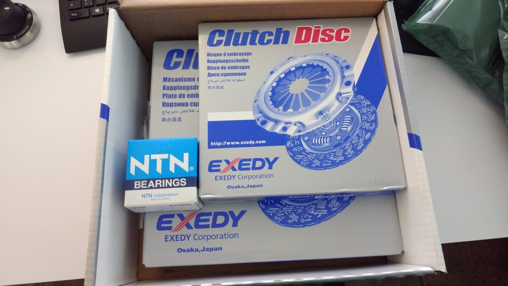

The clutch will be replaced by a stronger one from an Mitsubishi Galant. Not OEM, but not much better. Exedy Kit MBK2052 (Found and bought in England).
The bearing will be from Mitsubishi, of course.

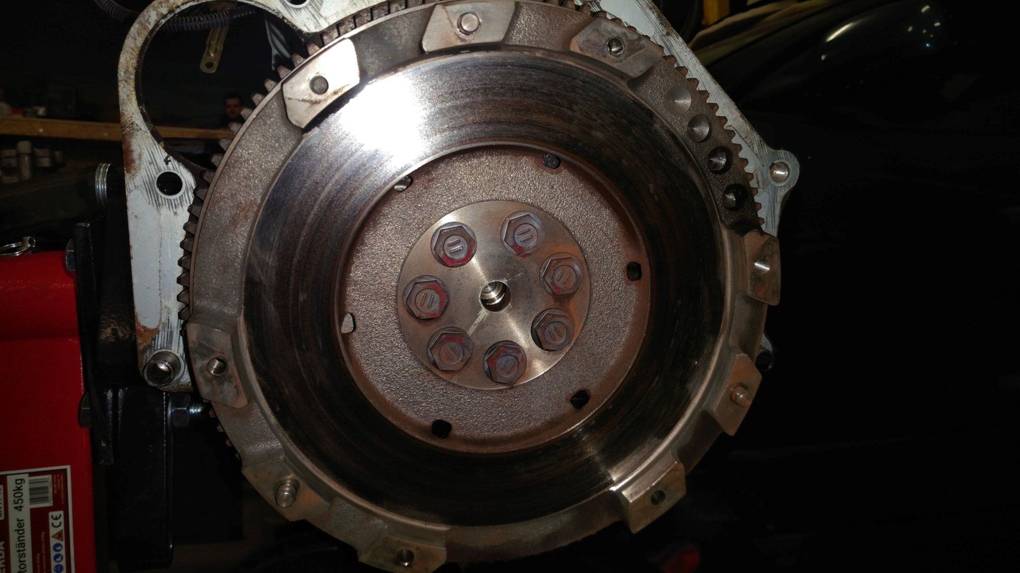

I’m still thinking about der fly wheel. Looks okay except for the discolorations. Smooth, even and without grooves.

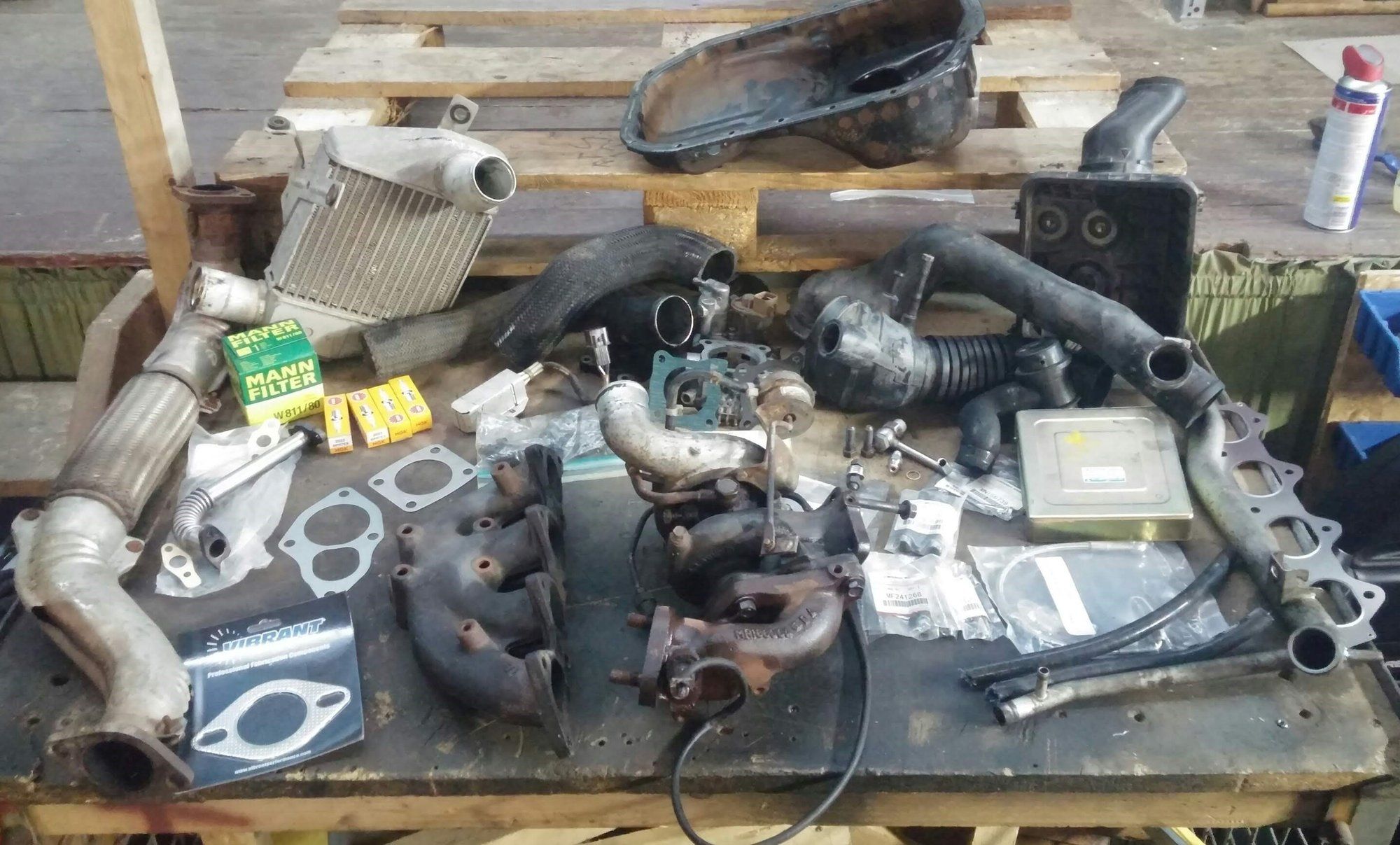

The entire turbo conversion package is available in the scene in Germany. Main parts used, and almost everything OEM what is necessary.
But I won't use intake manifold, MDP sensor, GST-ECU etc..

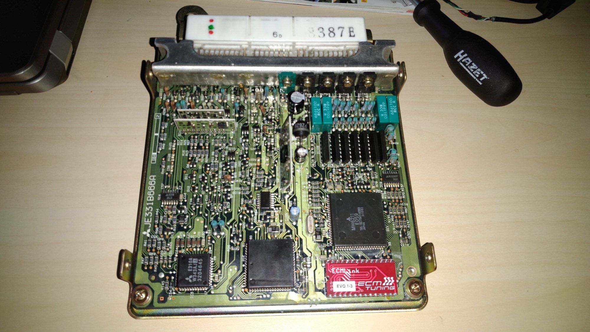

Meanwhile I have an EVO2-ECU with ECMlink. Here the MDP sensor doesn't connect anyway, and the bracket for this sensor is the only difference to the European intake manifold.
I ordered many new small parts, gaskets and screws.
Getting an adapter harness between 4 plugs on car and 3 plug ECU.

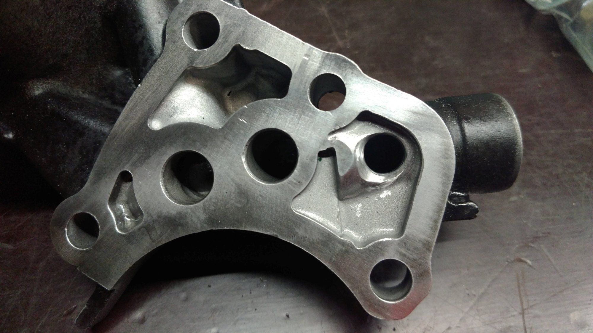

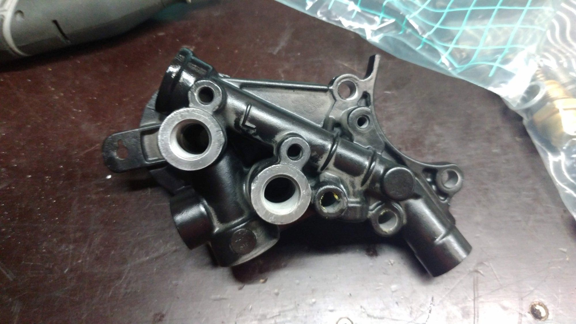

On the engine side I dismantled the front case and sent it to Matthias, owner of the famous 1000PS AWD Colt in Germany. The bearing of the oil pump will be revised.
Unfortunately it has not come back to me yet.
As soon as the front case is back, I will rebuild the complete belt drive including the tensioner. Also the shaft seals in the front case will be replaced.
I will keep the balancer shaft. The quiet run is more important to me. I have to check the timing belts regularly anyway and always change the small belt with them.

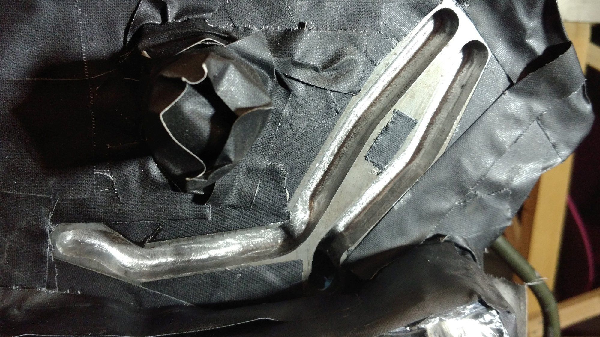

To use the time I did the Oil-Gallery-Mod on the block. Just like Jafro I used Silly Putty to protect the block from chips.

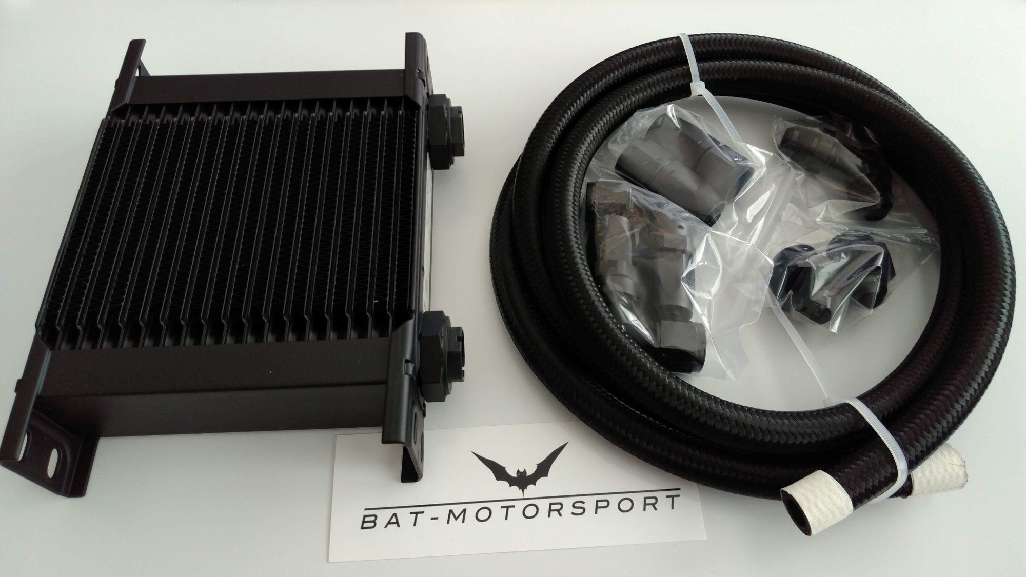

Oil cooler is a Setrab Pro Line Series 1 with 19 rows.
Bought together with some Dash-08 fittings from BAT-Motorsport.

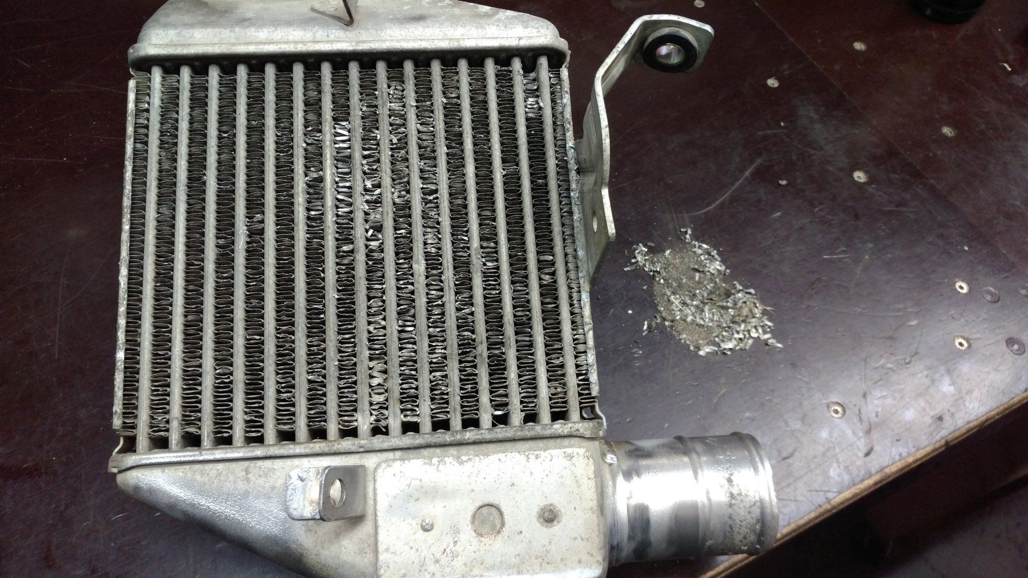

I also used the meantime to fix the SMIC again. Some of the bridges were bent or broken off.
