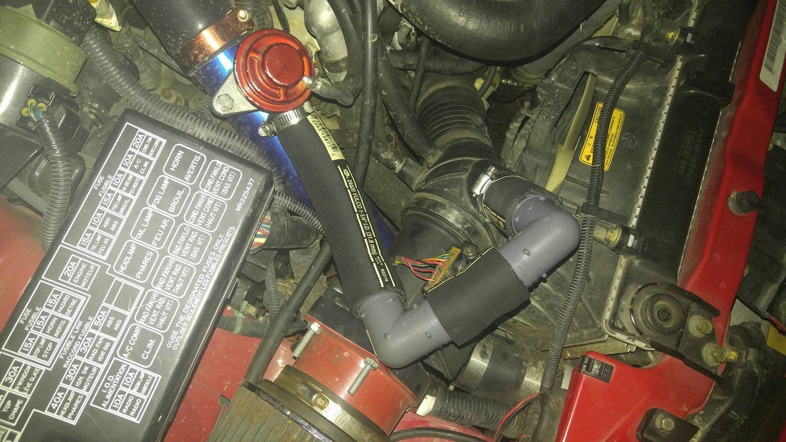

Alright. So I know an update has been a long time coming now, but I have been very busy lately with everything. Just finished my finals for my classes last week though, so I have a little bit of time now. Got the dash lights fixed(sort of). Just have it connector on the harness jumped with a paper clip for now wrapped in electrical tape, until I can get some time to make an actual jumper. Then there's the BOV issue. That's also kinda rigged for now too, but I wanna go with a 3" GM MAF so I can vent it anyways, so that's fine for now. I found some 1 1/4 " Coolant hose and some High temp PVC 90° bends, and kinda made my own recirc tube. Doesn't stall anymore. So that's one issue solved. Now only a million more to go. Trans is the next thing I wanna get tackled, but I gotta find out what I'm gonna do about my DD situation first. Car is up for the winter now, as we've been getting snow here for the last few weeks. Trying to save money for a trans now, but we'll see how that goes.
