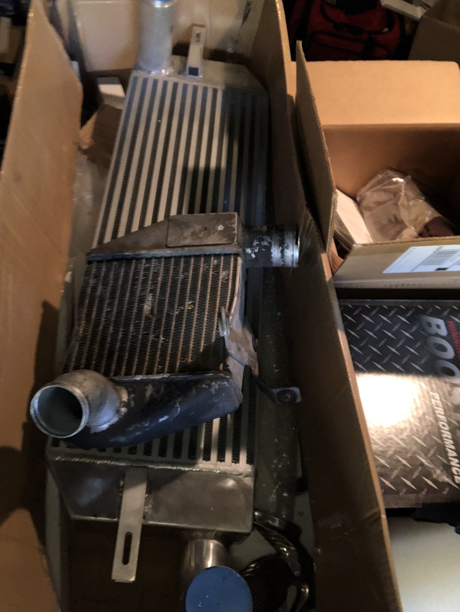

Next on deck is the Injen intake, VRSF Intercooler, JMFab Street Intake Manifold, S90 70mm TB, Synapse Eng DV, MAP Exhaust Manifold with a Precision 5858 Turbo, 1000cc Fuel Injectors, Walbro 255lb Fuel Pump, Fuel Pressure Reg kit, and most importantly ECM Link v3. Then I'm thinking about working with IPT to make the tranny strong. Am I on the right track so far?

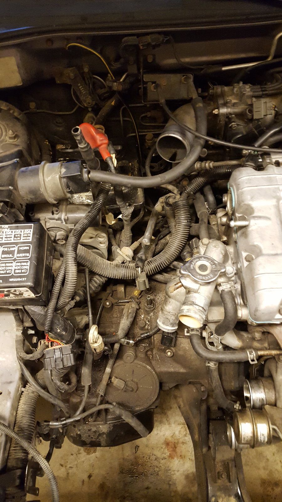

Sounds good PlanZero I do not plan on swapping to an eclipse, but I will be changing to Viper red over the next few weeks. I will also hopefully have my engine back from the shop after being machined. Ended up going with some nice internals to get ready for the boost in power. eagle h-beams, eagle 88mm crank, wiseco pistons, gsc s2 cams, gsc balance shaft, fluidampr, and now I'm considering the gsc beehive spring set. Then i went ahead and got the vrsf intercooler kit, too bad ETS stopped selling their piping. Next up is the new manifolds and turbo. I'll throw up pictures once the new paint is on.

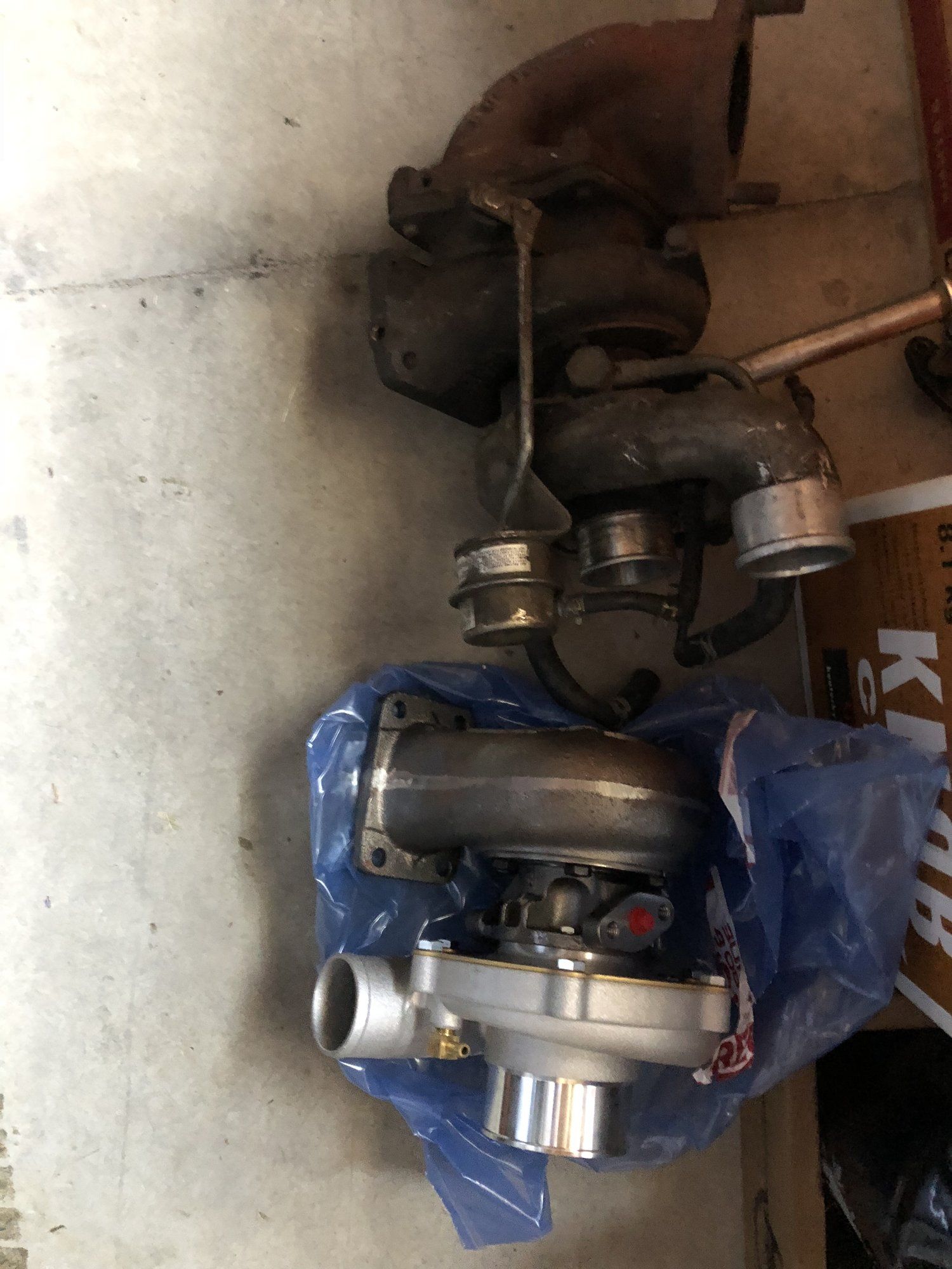

Went ahead and jumped on the MAP manifold with a precision 5858 turbo and comp 40 wastegate. Things are really starting to come together. Now to strip the car and get some paint on before the snow starts falling... and wait for the parts to show up.

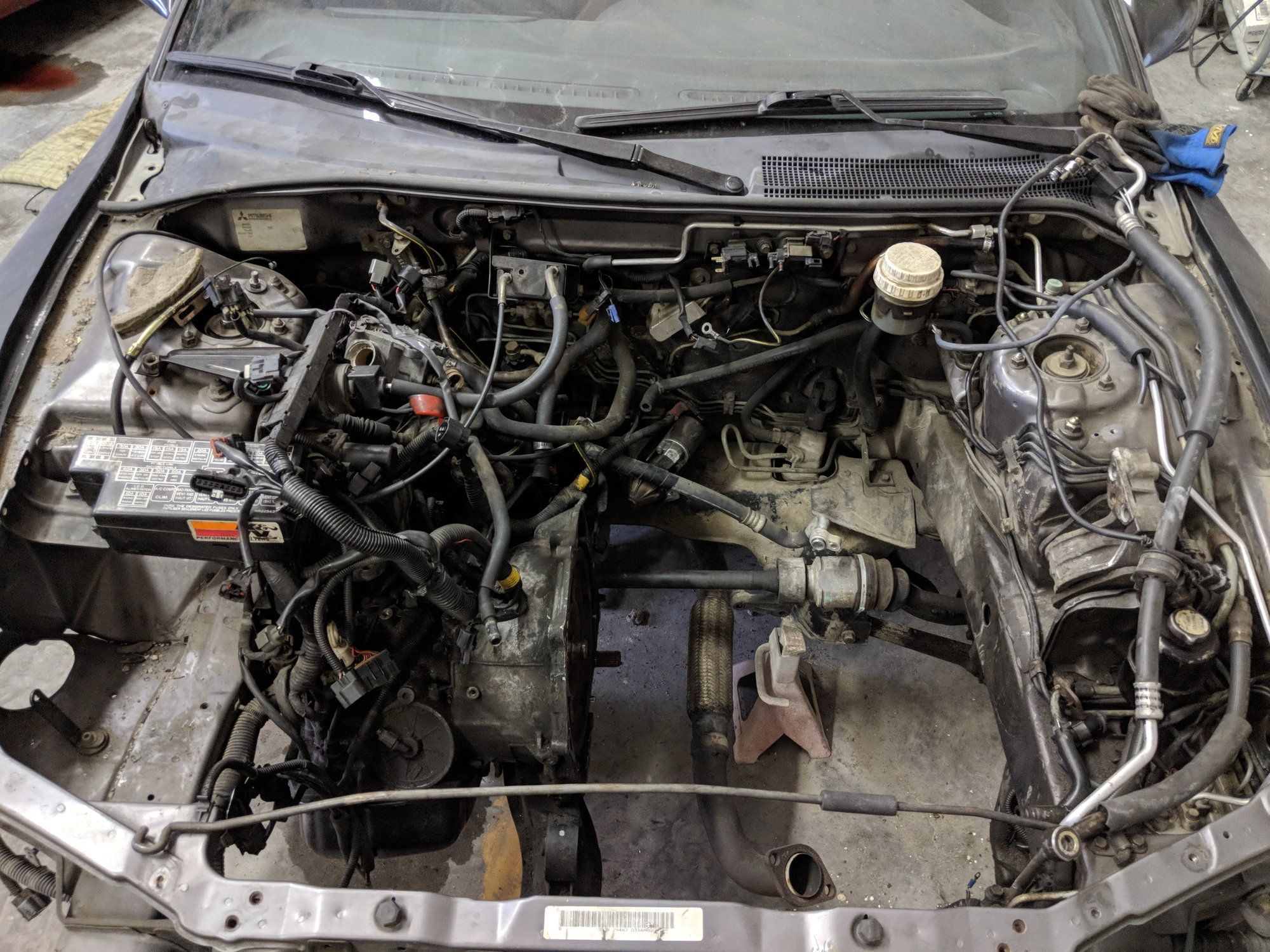

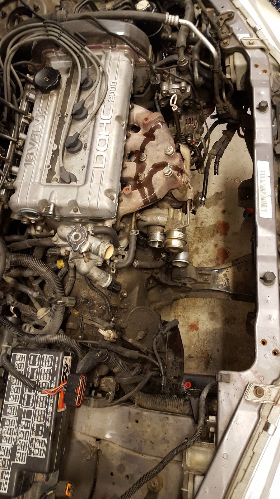

Parts are showing up and for the most part it appears I made good decisions. However I went with a Duraflex Drifter Body Kit which is very aggressive looking and should fit the new VRSF intercooler well. My only complaint is the rear bumper was designed for an eclipse so I think I'll just keep the stock rear bumper for now. Still trying to find somebody to help me get the engine and tranny out since this is my first rodeo. Managed to get the intercooler, radiator, intake, TB, both manifolds, turbo and engine harness removed. Hopefully my organization of the bolts etc. was good enough to get all the new hardware in correctly. Engine has been machined and bored .020 over; dropped of the new wiseco pistons, eagle rods and crankshaft, and fluidampr to the shop. Next up is the GSC S2 camshafts and GSC springs.

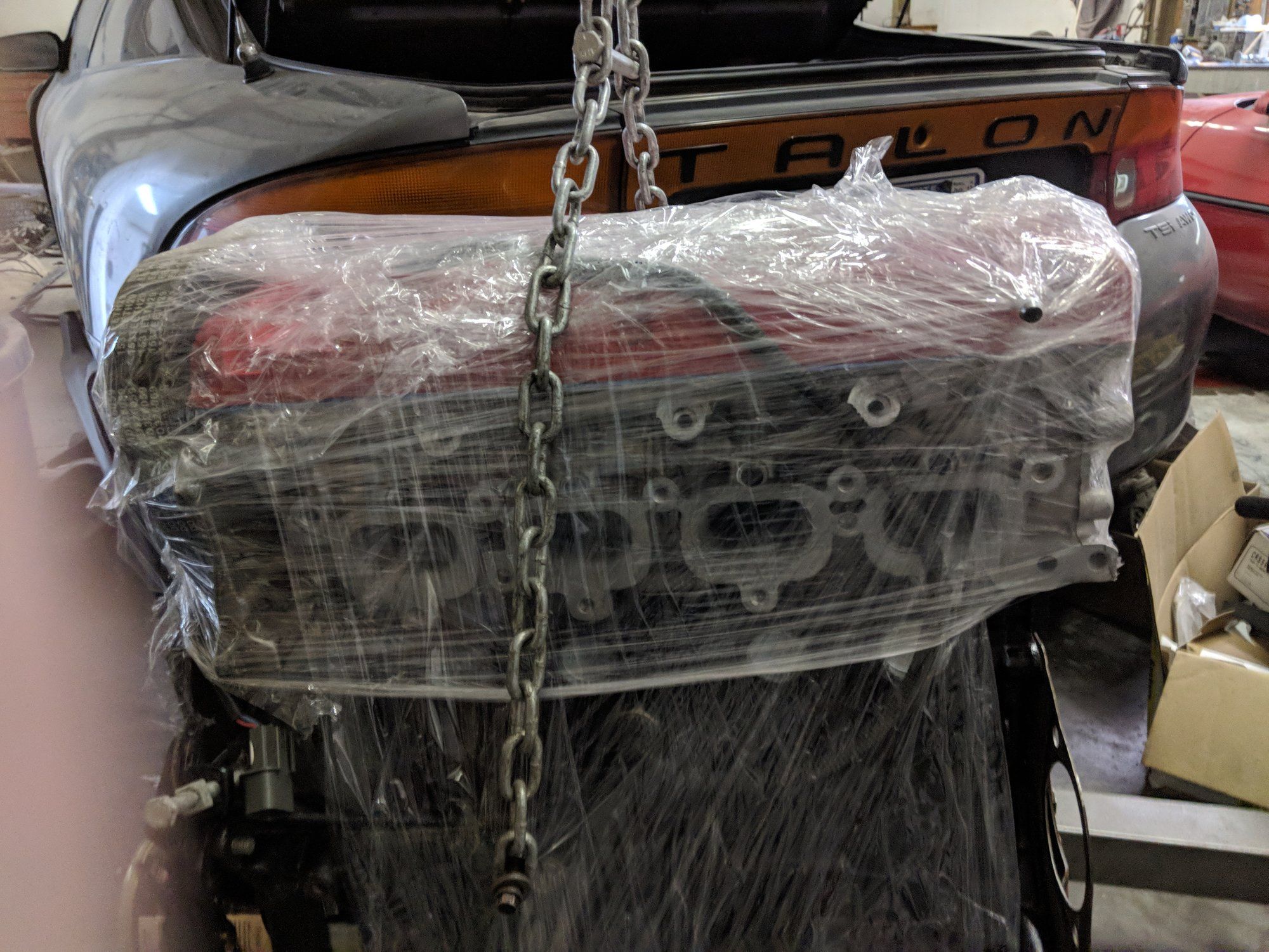

With some luck I managed to get the head off my engine and dropped it off at the shop with some good stuff. Those 12mm 12 star bolts caught me by surprise. The shop is installing the ARP studs, ACL bearings, GSC S2 Crankshafts, GSC balance shaft, Eagle forged rods and crank, along with wiseco .020 over pistons. I also went for it and dropped of my valve cover to be powder coated red. Do you guys have any more advice for me at the moment? Just want to make sure I'm heading the right direction to hit around 500hp.

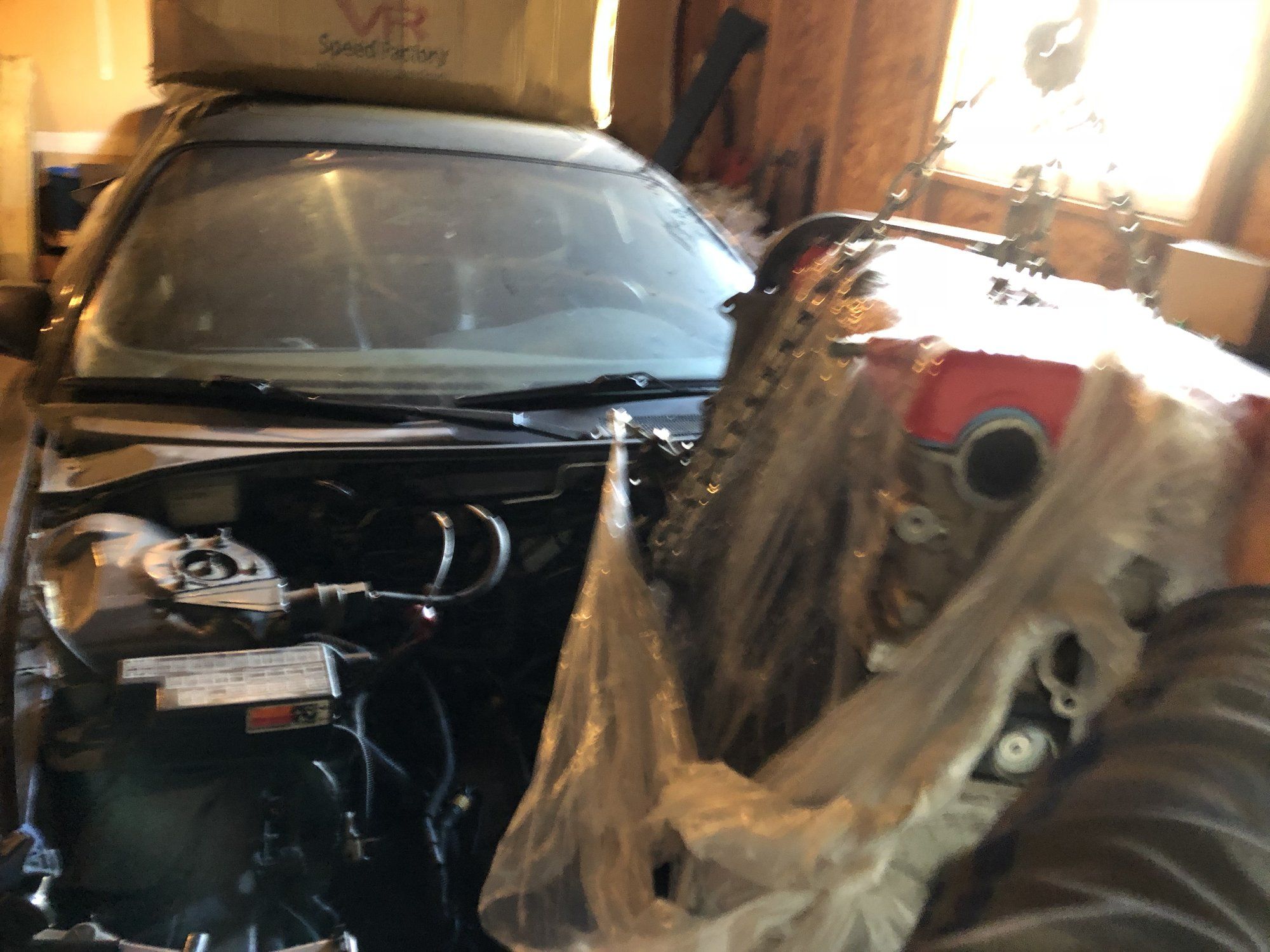

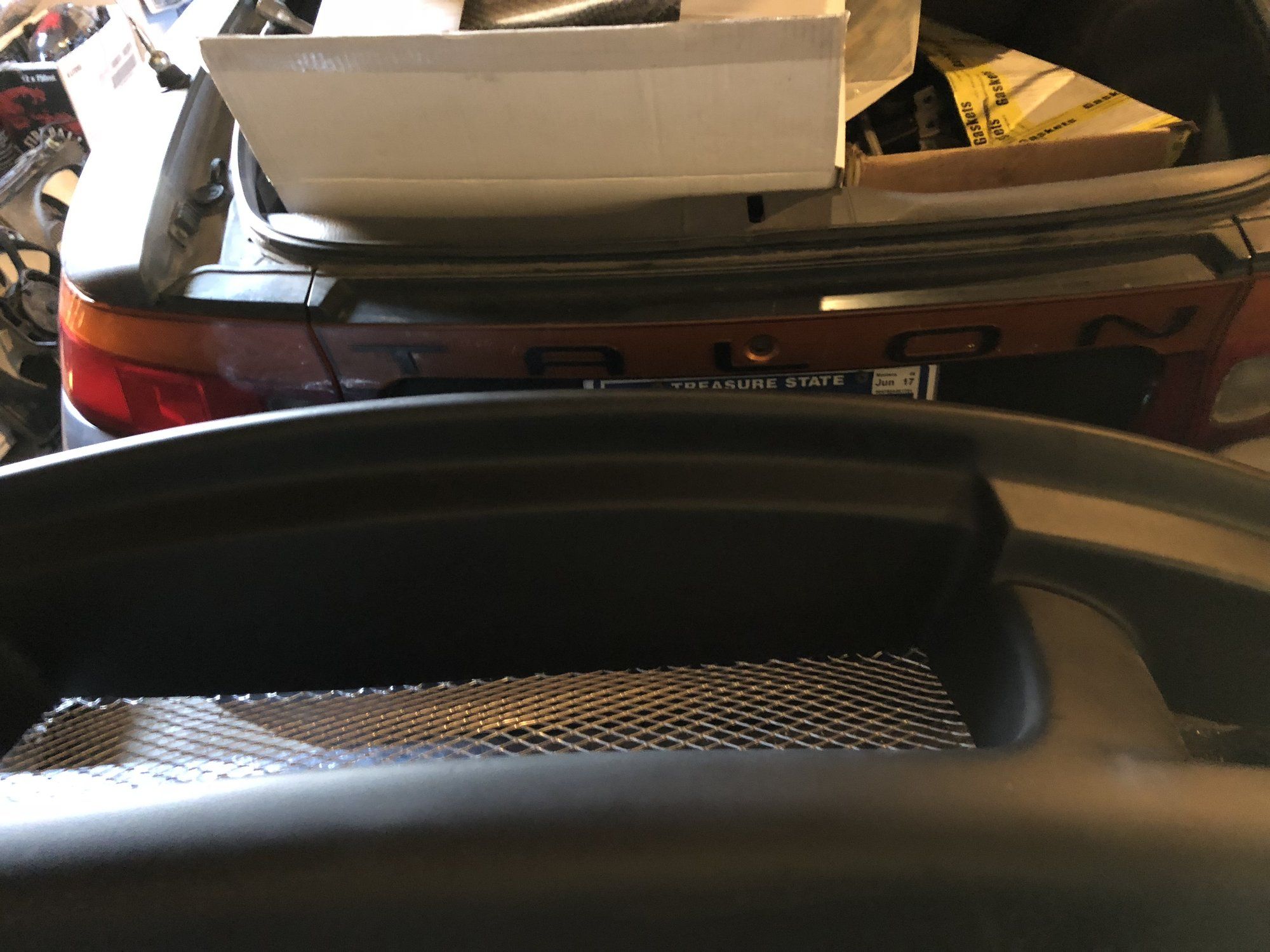

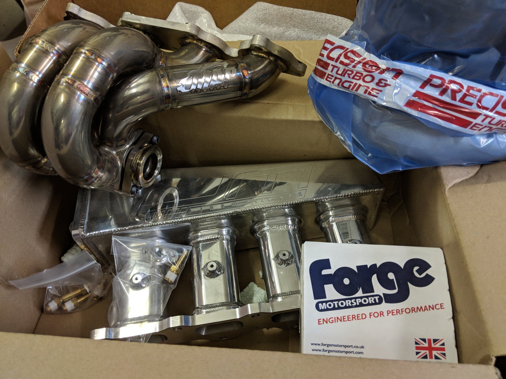

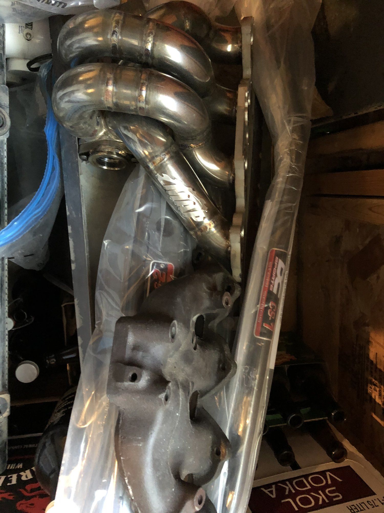

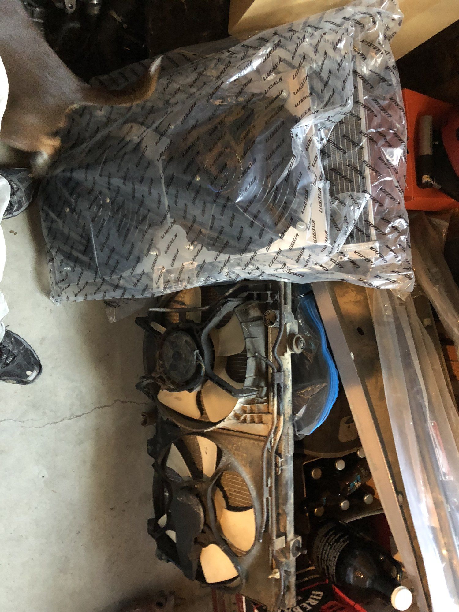

Well yesterday and today were long days but I got the talon and all the parts into my garage... moving is never fun but now I’m excited to get her running.
Just for fun I’ve attached photos for the first time in a while... I got a kick out of the difference between some of the stock parts and the new ones. A long way to go, so if you are in Missoula or close send me a message!
