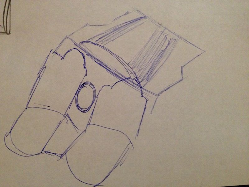

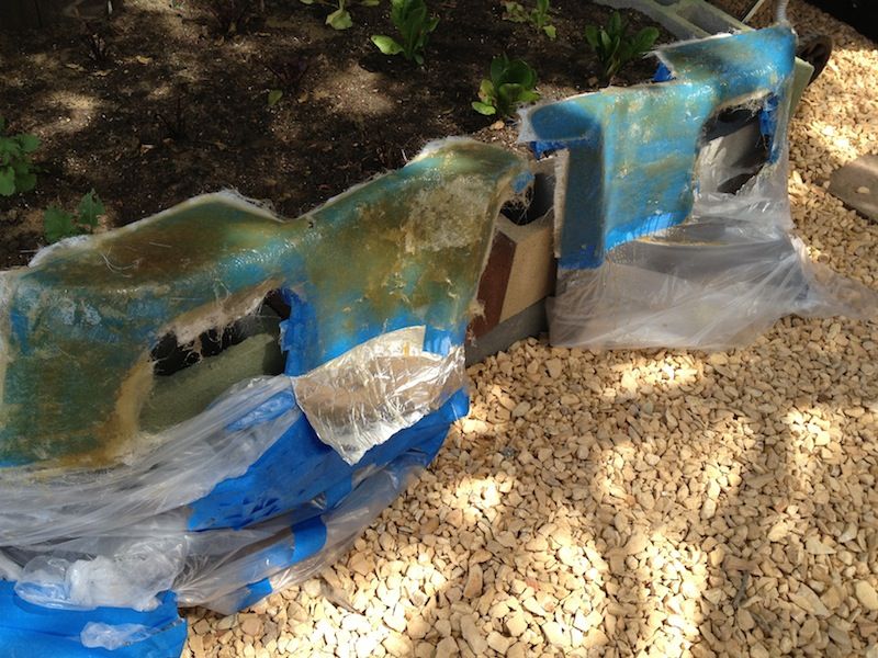

So yesterday I started on the tonneau cover for my spyder. To get things moving along I wanted to make molds of the rear panels so that I would have something more solid to make the fiberglass mold/shape out of.
Here's what I'm trying to make...
1. Buy all your supplies
Fiberglass mat
Fiberglass resin
Fiberglass hardener
Gloves...get good ones
Mixing cups
Stirring stick
Tape
Wax, preferably PVA, but regular carnuba turtle wax works well
Aluminum foil
Paint brushes...lots 3" is good.

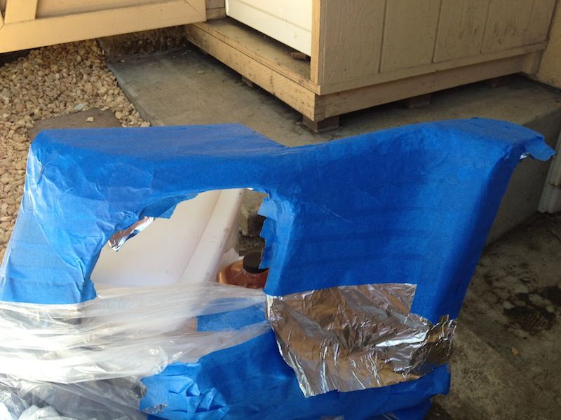

2. Wrap areas of the panels you want to mold off of - 1 layer of tape, 1 layer of foil, 1 layer of tape (blue tape is awesome)
3. Apply one layer of wax - let dry. This is so the mold will release from the tape.
4. Apply 1-3 more layers of wax depending on how anal you are. Two were more than enough for me in the end, popped right off.

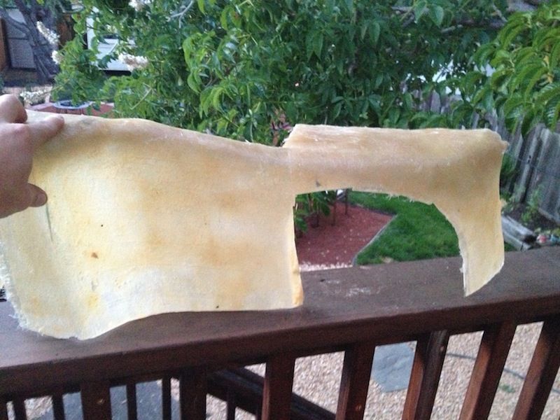

5. Cut up your mat into small workable pieces. Mine were like 6x8"
6. Make your mix. I worked with 5 oz of resin + hardener at a time. Let me get big chunks done before the resin started chunking up.
7. Apply a layer of resin down on the tape, work in small areas.
8. Take some of the matt you cut up and press it onto the resin, just a little past the edge of what you want covered.
9. Dip the brush lightly into the resin mixture and then dab/press into the matt. I like to put all my mat down and then press more resin into it. Press it until you see that it's saturated.
10. Rinse, repeat until you get 3-5 solid layers done on your mold. Let it dry.
11. Do the other panel or areas
12. Once they're hard you can release them. Mine can apart easily by just pushing my fingers under the laters.
13. Cut/Sand/Smoothing is up to your individual project. I just needed the mold so I cleaned up the edges and got a piece like this
More to come!

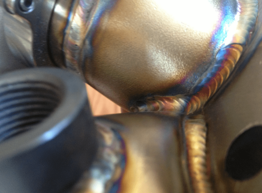

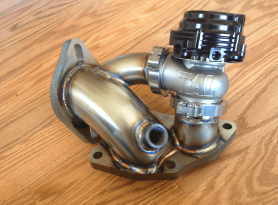

New Punishment Racing o2 sensor housing with black Tial 38mm MVS wastegate
ROFL LOL :D is how I feel
Look how pretty those welds are!
