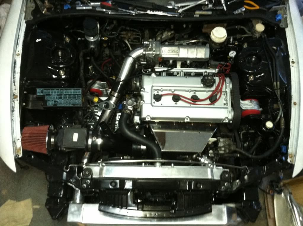

Well gentlemen it's the update we've all been waiting for... the engine is in its home! Really wasn't as bad as i had expected wrestling it in there but it probably helped that my dad can man handle things like a grizzly bear :thumb: Anyway, I still have all the little things to do such as install the driveshaft, transfer case, axles, and exhaust along with various little things. But I'm hoping to have it started by next week :hellyeah: And now pics of the engine!
Aint she puuurdy

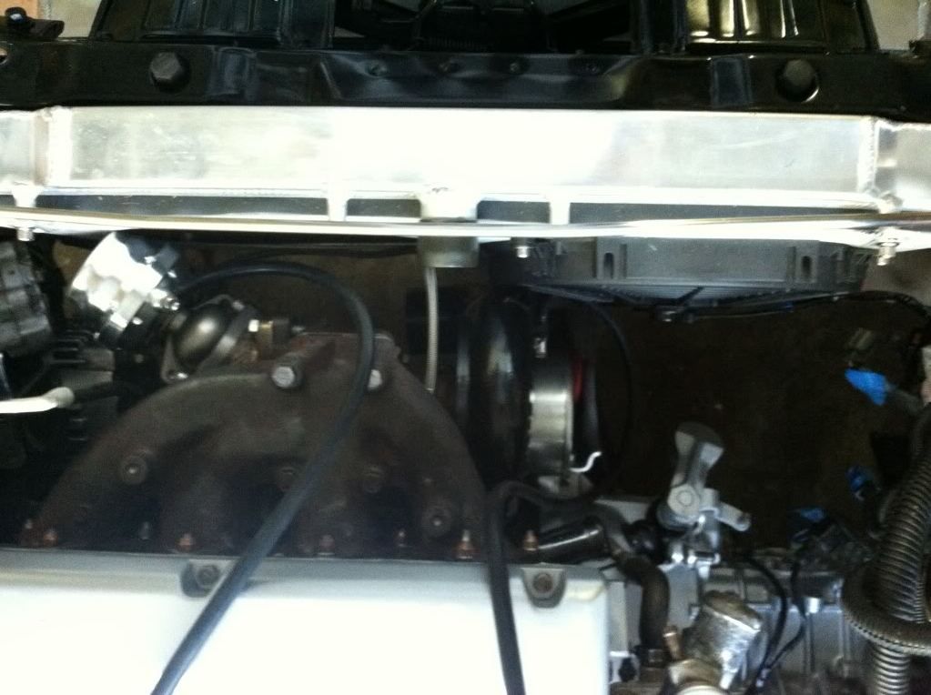

I did run into clearance issues however with the external wastegate and my drivers side radiator fan, not sure what I'm going to do about that but I will post a thread on that soon.
As you can see there's literally zero space for a fan in there xD
Next update will hopefully be a video of it running with all the little details finished!

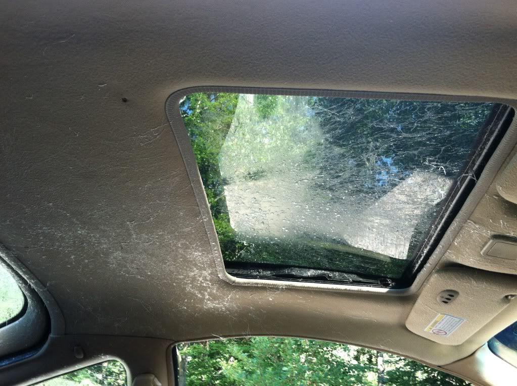

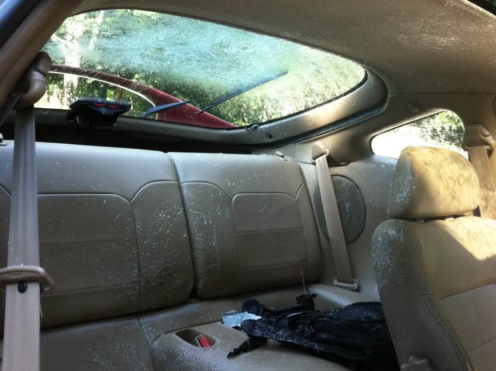

Well I havent updated since I got the engine in but I've been pretty busy this week. On Monday, while I work I found out that a can of spray adhesive (which I forgot was in my car) exploded. Literally the worst thing I can imagine. So instead of spending Monday working on the talon, I spent the night removing the glue from my entire interior. Here are some pics of the carnage.

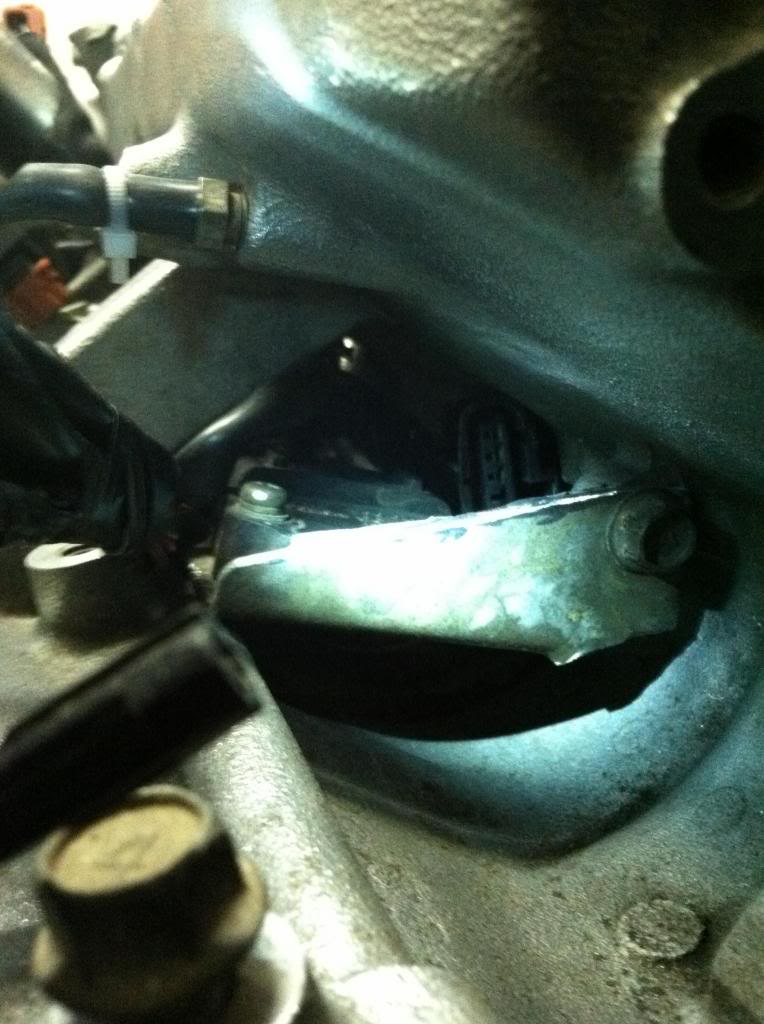

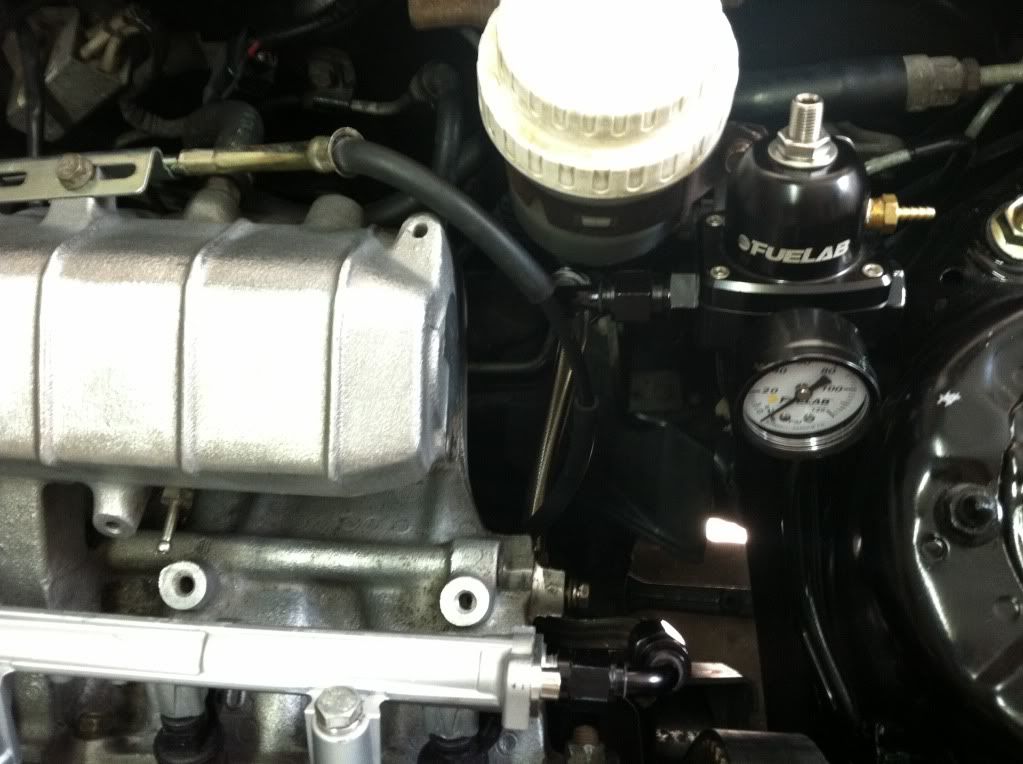

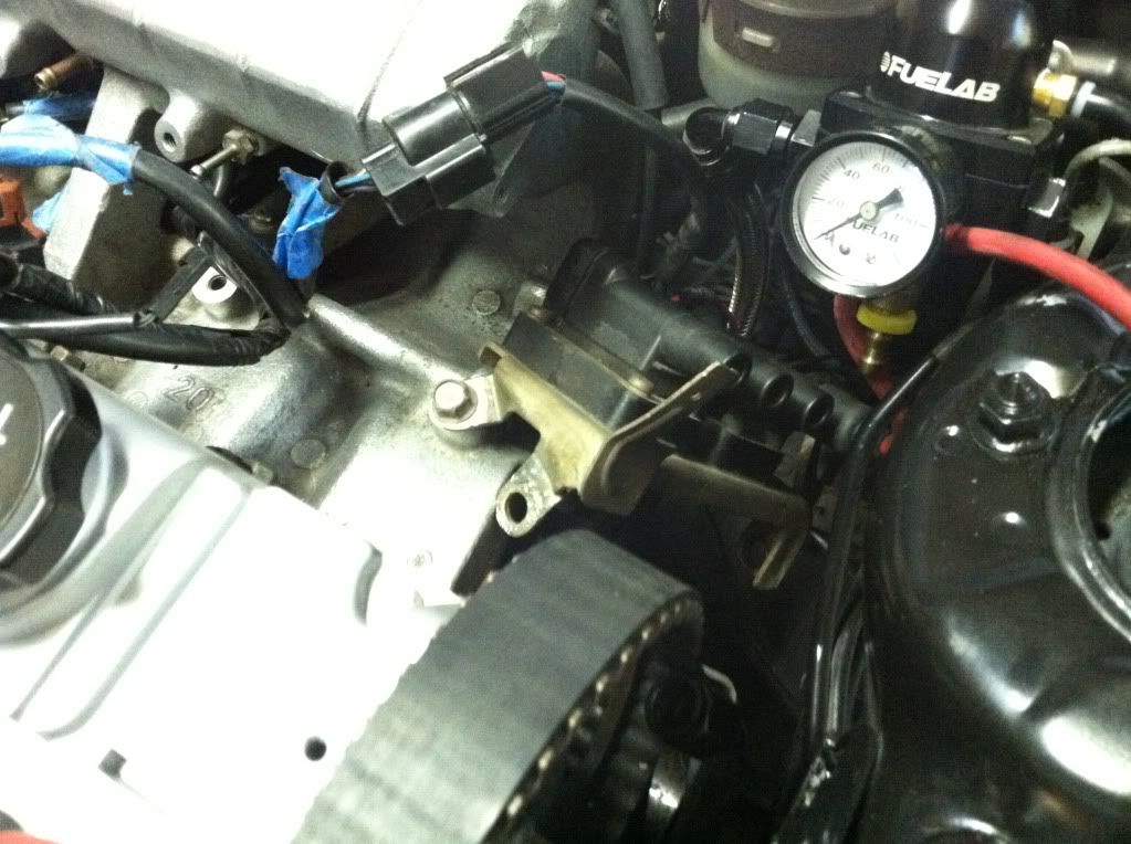

But on the talon I kept trying to progress with whatever I could in the engine bay. I wanted to keep as many wires hidden as I could so I tucked most of them within the intake manifold. Worked out pretty well, I even tucked the power transistor inside there xD I mounted the coil pack to the right of the intake manifold after a bit of banging on the bracket with a sledgehammer. Seems like it should work. Anyways pictures will show the progress easier than I can type, so just look at those :thumb:
AFPR attached to the brake fluid reservoir's bracket.
Coil pack mounted to IM
Power transistor inside of IM

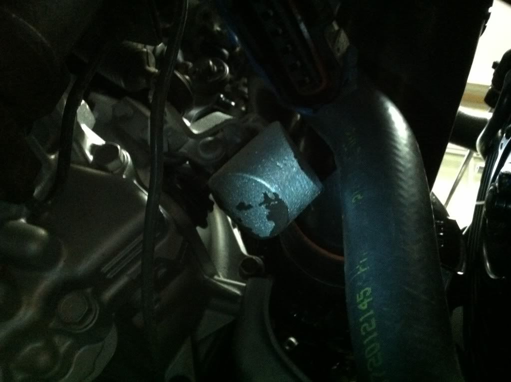

Clearance of radiator hose to transmission counterweight. This is with it in gear, plenty of clearance. The radiator hose is however touching the intake.
This pic pretty much sums it up.

Lookin' good man,
I had the same problem with my radiator fan & wastegate. All I did was mount the fan on the other side to push and swapped the leads. As far s mounting, I just used the plastic radiator clips which worked great.

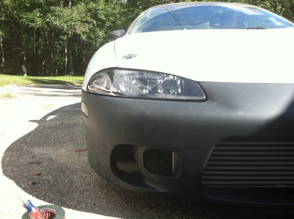

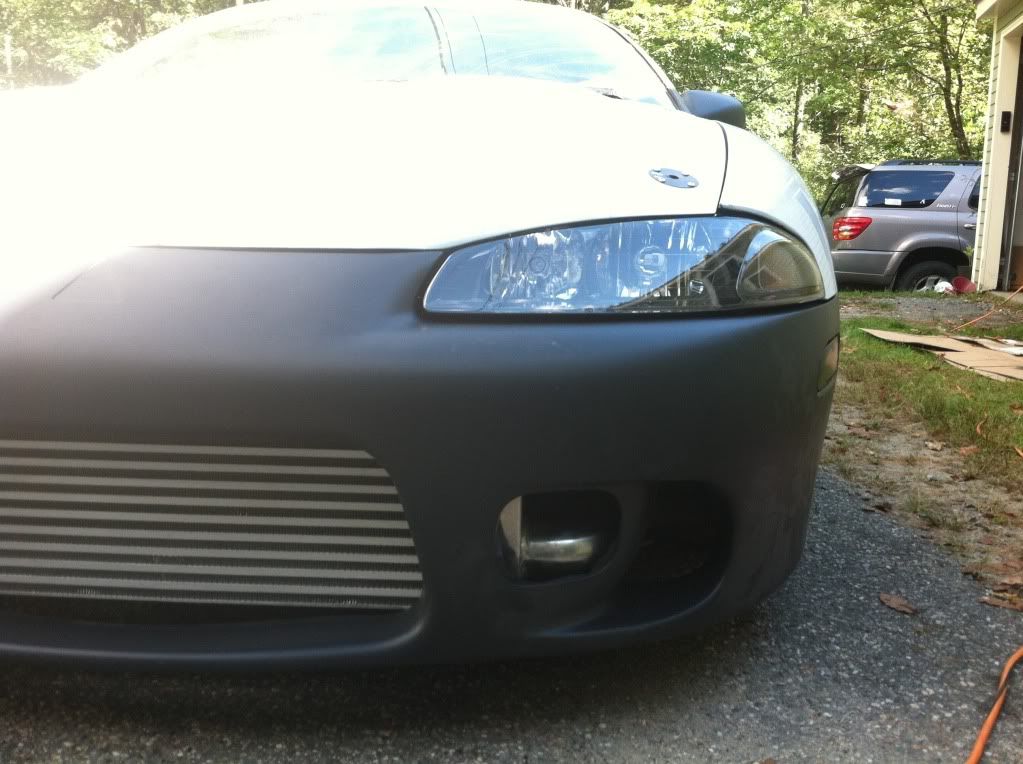

Little update today.

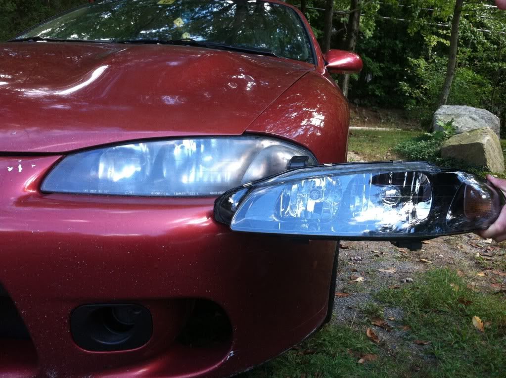

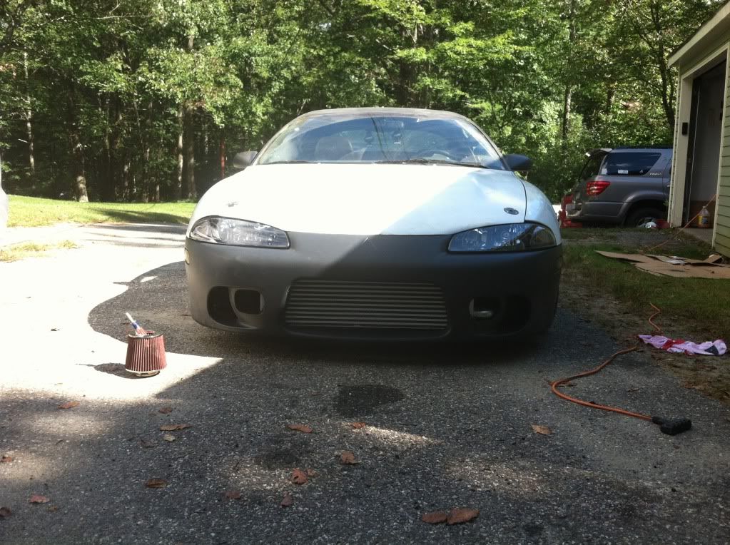

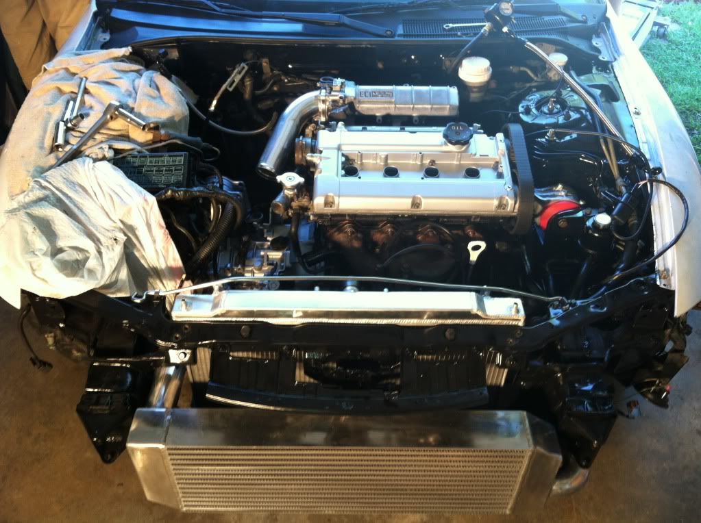

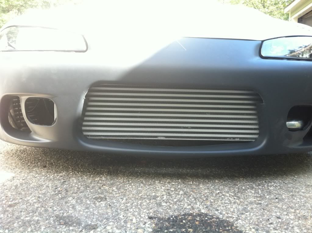

I decided that now is a good time as ever to get the front end on. I've had the bumper sitting in my garage since I got the car so today I took the time to finally put it together. I also got a set of headlights from headlightsdepot.com and I have to say they look amazing compared to the 18 year old set on my eclipse LOL

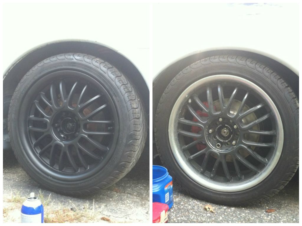

I also decided to see what the rims I have on it would look like plastidipped so I did the back wheel. The pictures don't do it justice at all, but the wheel that was dipped looks almost like an RPF1 now instead of ugly rims with a chrome lip. When I can get a better picture of the wheels I'll post it up.
ALSO: it looks like I'm gonna have to send my ECU to ecmlink to get the ISC drivers replaced which sucks but will help me when trying to tune since I just got some FIC 1050cc injectors! Next update I will take a video of the Thermal exhaust as well since I got that on. :thumb:
Love it. I'm going through a lot of the same stuff on my 2ga GSX and a rebuild on my roomates 2gb GSX. My roommate isn't big on the simple stuff, or "do it once do it right" mentality. There's a reason i'm rebuilding his motor at 140xxx. But I love to see people clean up the engine bay like that. Props for bringing the car back to life man!
I've also been wanting to put black carpet in mine and a new headliner. So thanks for the pics and the motivation too!
Good job on the build progress.

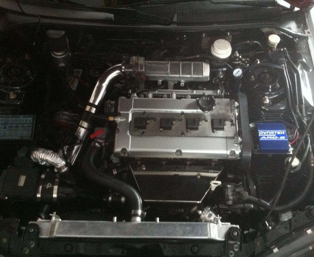

Noticed a couple things though, your oil feed line from the OFH looks like its touching your O2 housing, you may want to consider routing it in front of your manifold so it does not touch any exhaust parts. Also, you may want to double check where the line is going into your OFH.
Our setups are very similar so I can tell you you are going to have issues with your alternator being so close to your O2 housing. You may want to re-wrap that or add a layer to protect your alt from that heat. Or even do the alt swap but thats if you already got rid of your AC of course.
GL.
Edit: Forgot to mention, replace your coolant hose with a flex pipe so it doesn't touch your heat shield. Cheap insurance against melting that hose, and prevents unnecessary heat transfer.

Current engine pic. Coil on plug conversion wired for the 95 ecu and the arc-2 cdi to power it! Probably overkill for my hp goals but this is also a show car so it's more for the clean look.

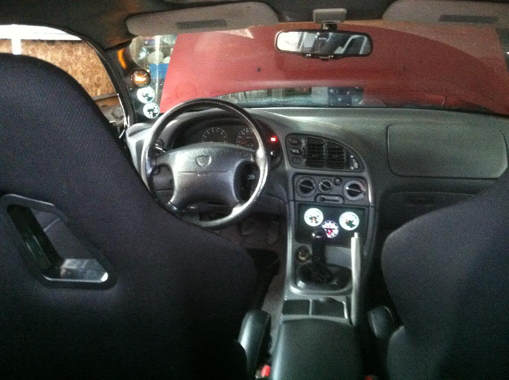

Pics of the racing seats installed, they've been in there for a few weeks i've just been to busy to take pics,
All 6 gauges are wired in and functional, pioneer stereo was relocated to the glovebox
