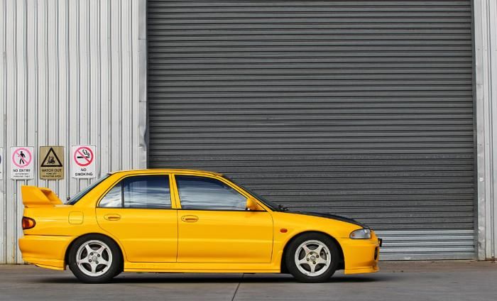

Fast forward to 2010, the old car was sold as a roller and I managed to get my hands on a 1995 mitsubishi lancer GSR.If you guys aren't familiar with these things, from factory they came with a 1.8 4g93 turbo awd setup. So the first thing was to strip it down to a bare shell and start again. The whole purpose of this exersize was to make a evo3 clone, as here in Australia you cant import one unless they are a personal import.

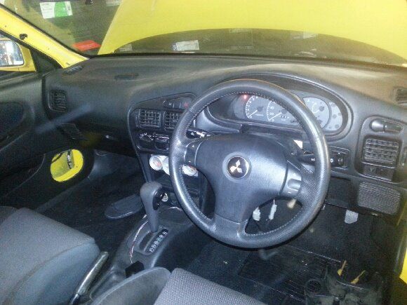

The car was stripped down to a bare shell and had a bare metal re spray in yellow, funny enough it only took 20 or so hours to strip the car down ready for paint. The re assembly was alot longer around 40 hours.

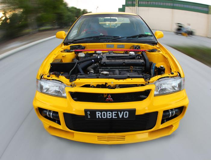

So after the interior was put back in, I put my old 9 second setup back in the car.This was sitting on a pallett in my shed at home for 2 years:)
The old set up was as follows
7bolt built 2.4
Eagle rods
JE Pistons
Eagle Crank
ARP fasteners
ported evo3 cylinder head
Cams are a custom grind and are well over 300 duration
oversize valves, valve springs and AEM cam gears etc.
GT35R turbo 1.06 rear
steampipe exhaust manifold
HKS 60mm wastegate
3.5 inch exhaust from turbo
3.5 inch cat, resinator and 3.5 inch muffler(thats a full exhaust system)
Hypertune inlet plennum
indy blue injectors 1600cc
walbro in tank pump feeding
2 044 pumps and a surge tank under the car.
Custom twin plate clutch
Shep racing transfer case
Sandard GSR gearbox(dont know for how much longer that will last LOL
Haltech E11V2 plug in
MSD DIS 4 ignition with bosch motorsport coils
EVO 3 wheels and brakes
KYB chocks with king springs.
I think thats about it
It made 670hp 4wheels on a dyno dynamics dyno 32psi E85
I had this setup in my car for a couple of years and was nuts on the street, on a slow launch 1.8 60" I ran a 10.1@148, driven to the track and driven home.I ended up selling the engine to a friend who put it in a RWD chassis.I decided on doing a 2.4 de stroked to a 2.1 build. The new specs now are

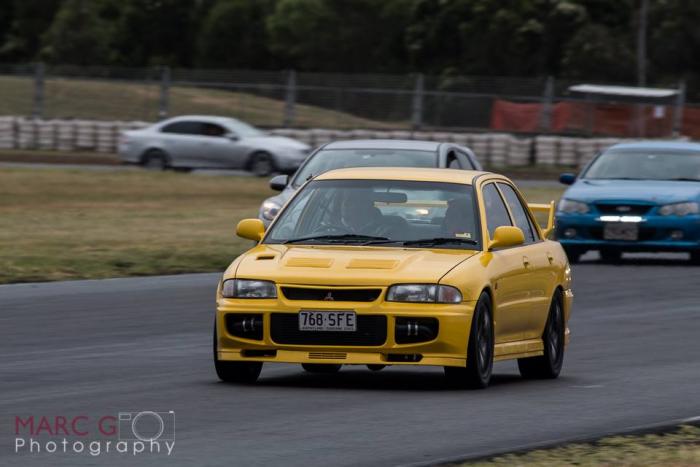

The auto set up is a built auto with a forced four shift box wired to an EVO 7 GTA steering wheel.On 22 psi it made 400whp.I took it to the track and ran a 14.8@128 with a 2.9 60".So a 50 shot was needed to get it off the line, after fitting a nitrous kit, I headed out to the track, stalled it up and ran a 10.8@128 with a 1.6 60' running 225/45R17 nankang tyres.

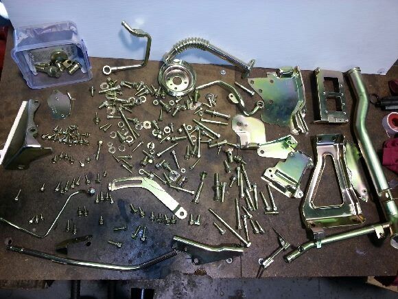

Thanks for the well wishes, Im at the engine assembly stage now and I should have the engine put together this week. I also ended up getting every nut, bold and bracket cad plated gold while the engine was getting machined,the result was awesome!!
