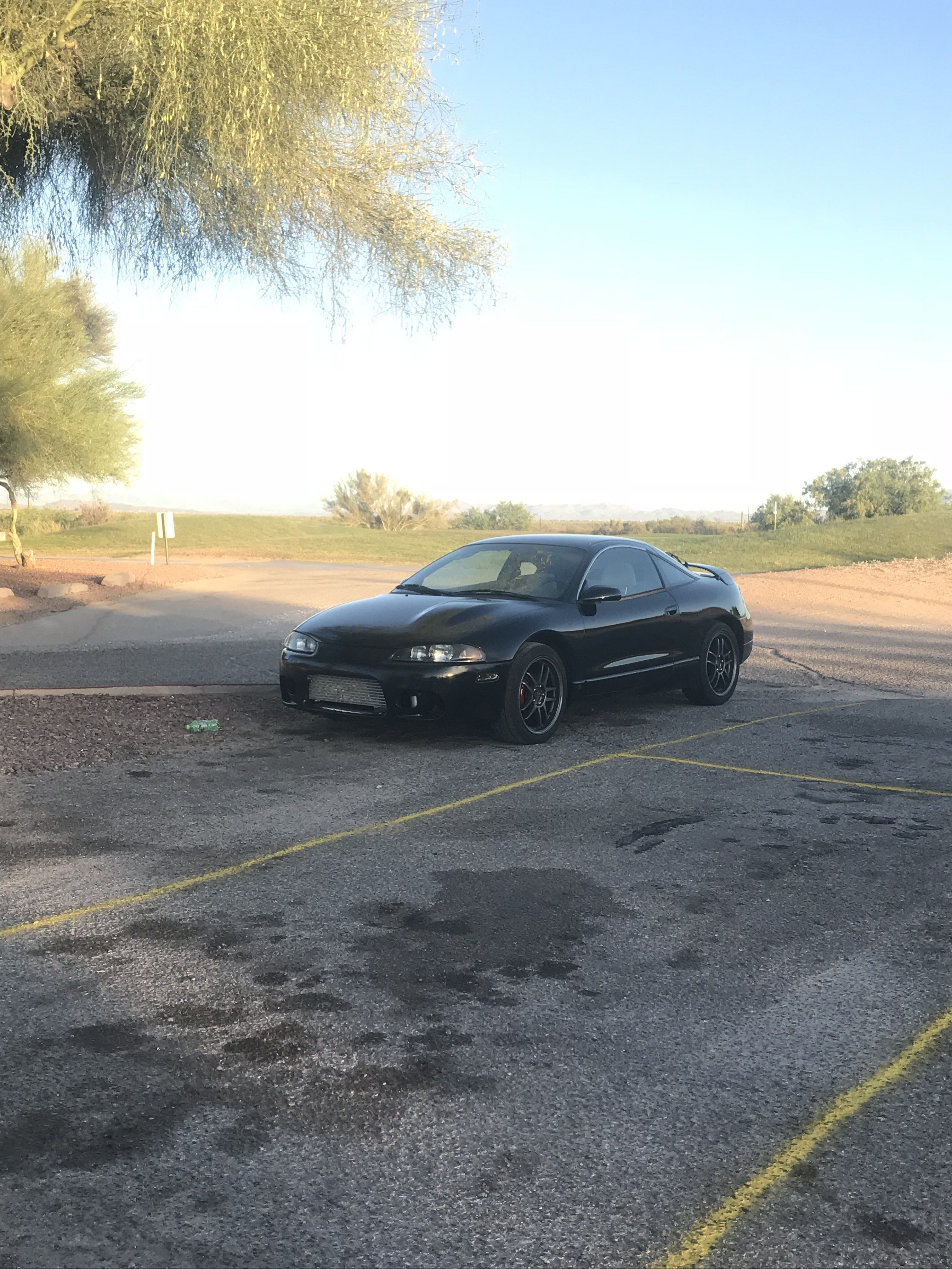

95 GST from Tucson
Here's a little backstory on the GST. I purchased it for $1200, while it had an overheating issue. Turns out it didn't have any coolant in it, so I filled it up and drove it home with no problems. Eventually it would get low due to bad coolant hoses and a faulty radiator cap. That is the reason that I purchased it for so cheap. Turns out the AC worked as well so that was a bonus. Ran extremely rich, also had a warmed up high idle which I am still dealing with.

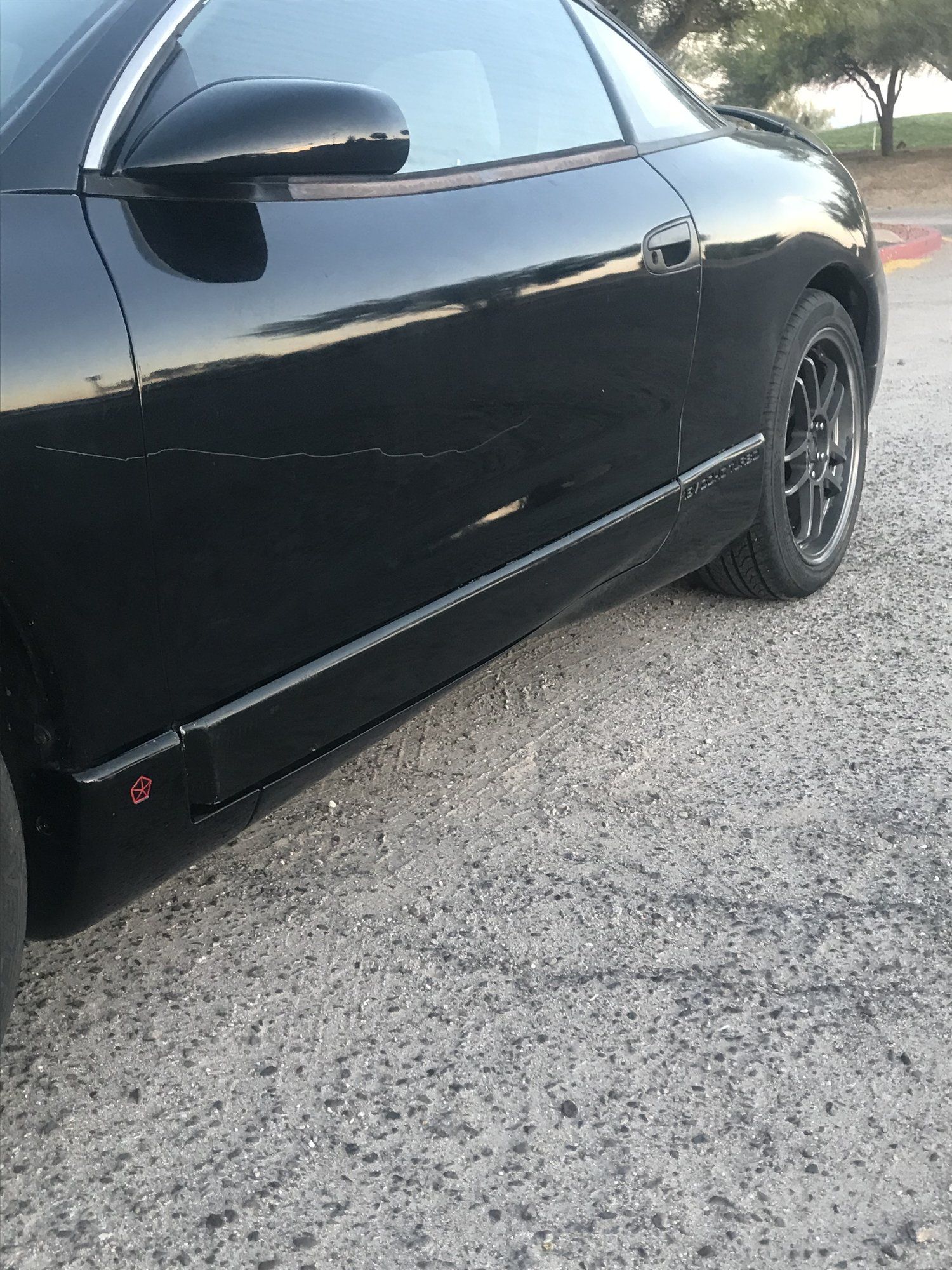

The car overall is in good condition for its age, and since it was an Arizona car there isnt any rust on it whatsoever. Paint is okay except on the pass. door that was involved in an accident sometime in its life. Interior is in decent shape not including the headliner and the sun visors. The Arizona heat has done a number on them.

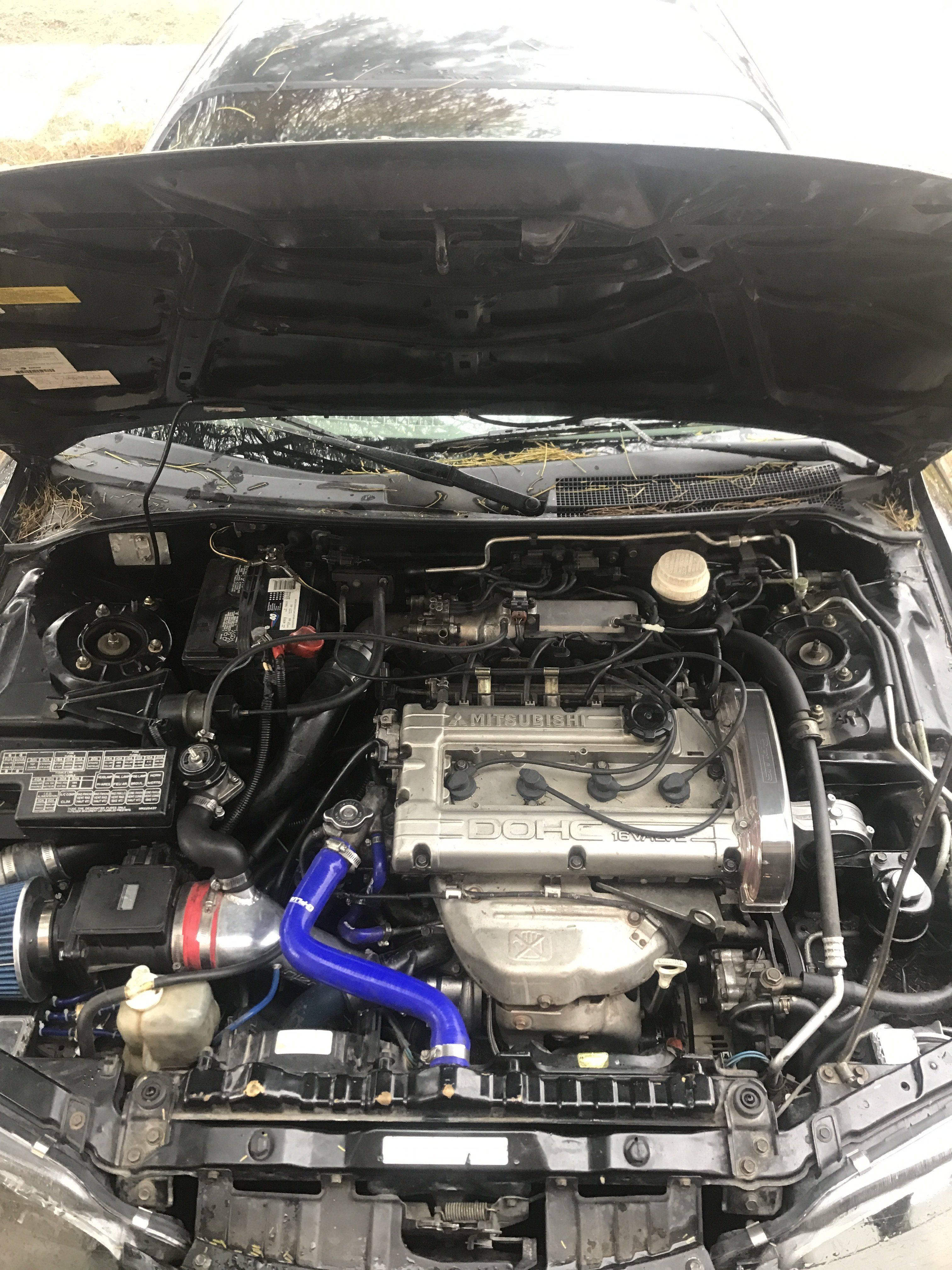

I've done most of the routine maintenance on it so far, including full tune up, hoses, gaskets, and more to come as well including timing belt, balance shaft belt, and water pump. I'll be posting more as more happens

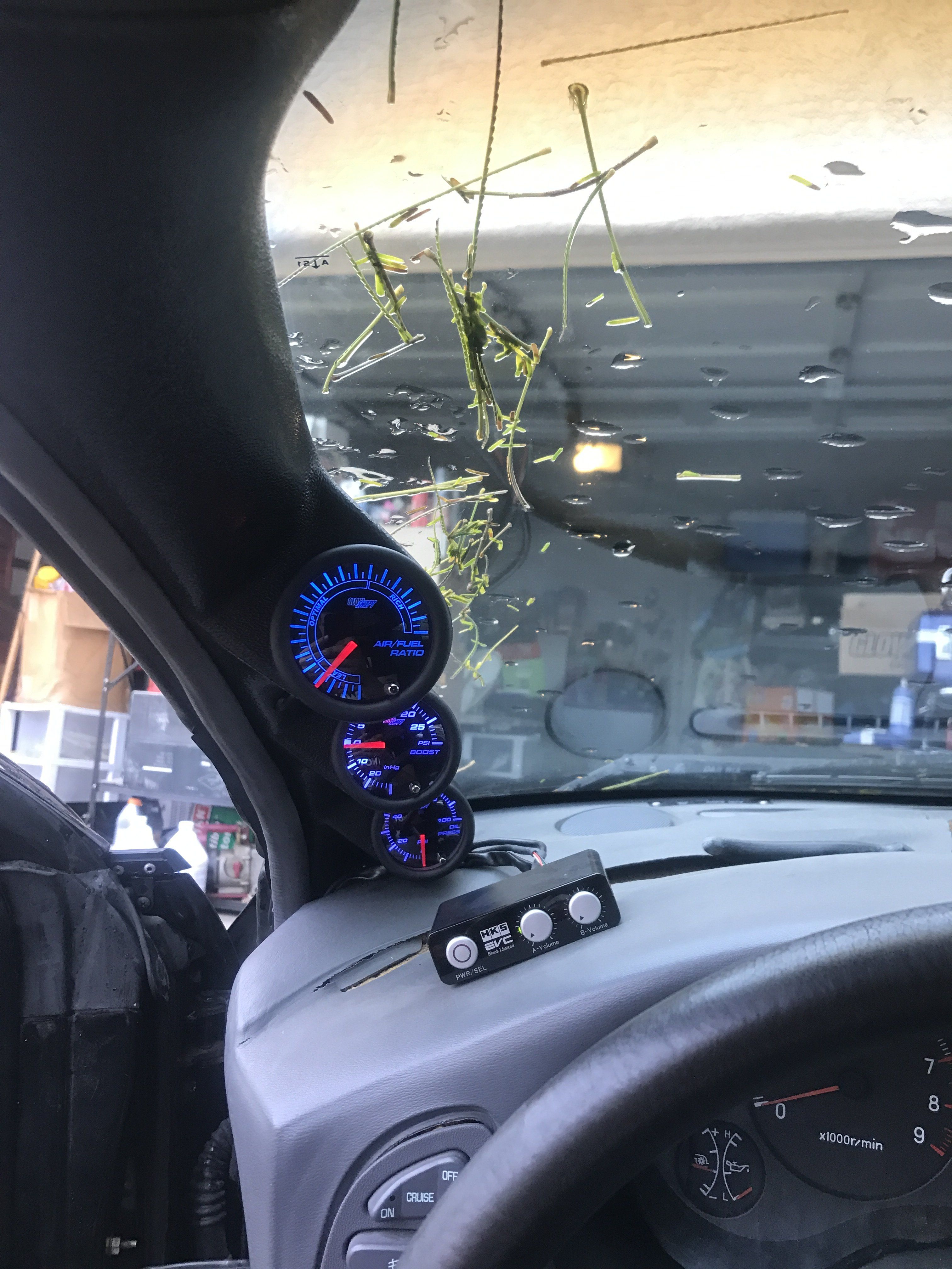

Another issue I'm having with it is the charging system. I recently replaced the alternator and the battery with an Optima Red Top, and it still isn't putting out enough voltage to run my accessories. My amp for my sub is displaying a low voltage light, and my boost controller isn't functioning as it should. Display lights up and works, but the boost pressure doesn't change. I believe it is a voltage issue because when the old battery went bad, the alt was charging fully, and the boost controller worked perfectly as well as the amp. If anyone has had this problem, any help would be appreciated.

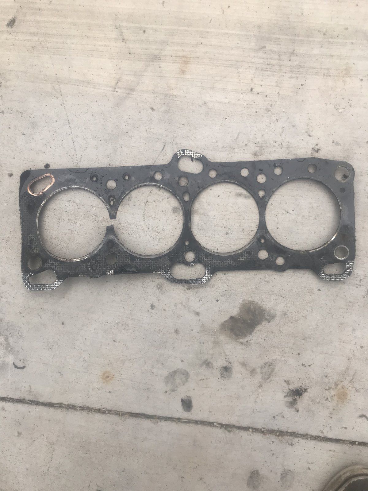

Just blew a headgasket on Monday. Compression is leaking between #3 and #4. I plan on getting it all done here in the next two weeks. I'm getting the head completely done, I have a new timing belt/ component set that is going on as well. I plan on doing the intake/exhaust gaskets, the throttle body gaskets, new 02 sensor, new cv axles, coolant temp sensors, and possibly throw on the 14b that I have as well. Any other suggestions on things I should do while its torn apart?

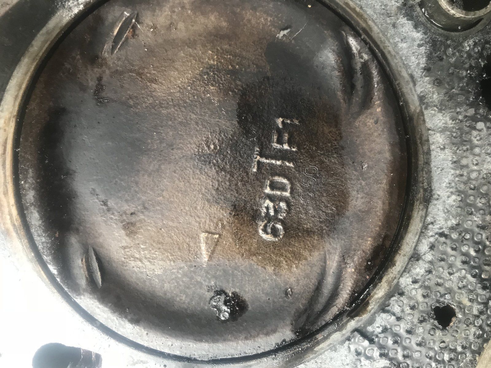

Pulled the head off today. Found a little more about the history of this car. It’s been rode hard and put away wet. Sometime in it’s life it’s had a rebuilt engine put in, and on that rebuilt engine a new head. I found some stamps on the pistons that I’m not too sure what they’re for. Figured might as well do the starter and all the mounts while It’s mostly exposed. Hopefully when this is all done it’ll be good to go for a while. If someone knows what the stamps on the top of the pistons means please chime in, it’d be nice to see what this engine is about. It says 0.50.
Just got the motor re assembled today along with all new mounts and a new starter since I was in there. Started right up, but it seems really sluggish and was only hitting 5psi of boost where before it was hitting 15lbs. Exhaust gaskets are all new intake manifold gaskets are all new. I think it may be a little out of time. I was extremely careful with the cam gears and the belt, but I think it may have jumped a tooth. Accelerates really slowly off the line. Any ideas on what may be causing this?

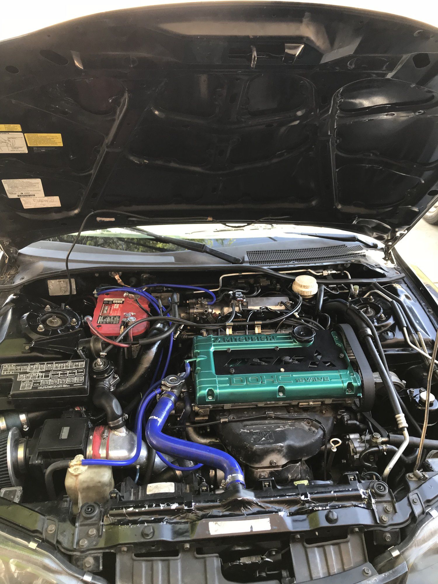

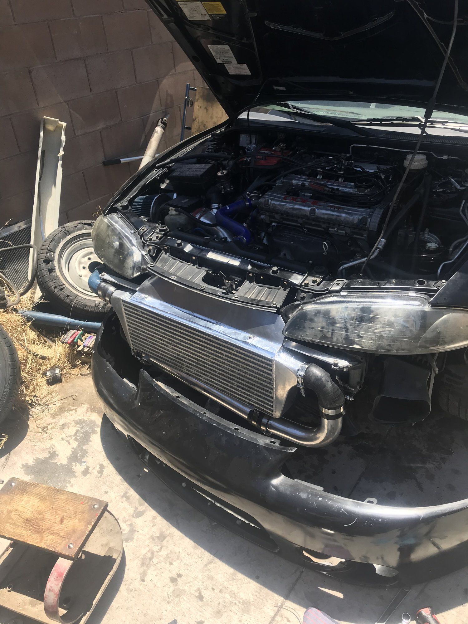

Got a lot done on the gst this week, did the oil pan gasket, helicoiled some valve cover bolts, replaced the alt with a high output alt, installed a 190 Wally and stm rewrite kit, new filter to rail line, and installed an lc-1 wideband.
I’m having a weird issue with AFRs though. It will stay around 14 until I hit 10-12 psi. After that it will hold solid around 11-10.5 up to 20 psi. I’ve messed around with the fuel in link which has helped a little but still not where it needs to be.

Here's an update. After a long electrical battle with the injectors not firing, the headgasket blew on its first drive in months. Put a "good" rebuilt head with new gasket and ARP studs. Turns out I have a few bent valves. I made sure it was in time when i put it together and also rolled it around by hand with no resistance, so they must have been bent when I put it in.
