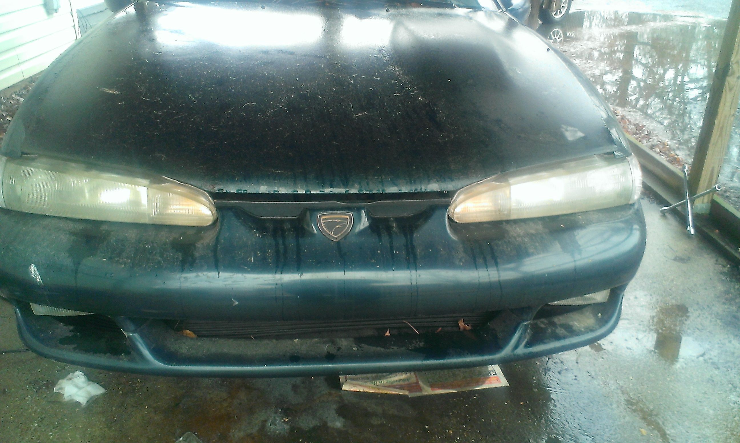

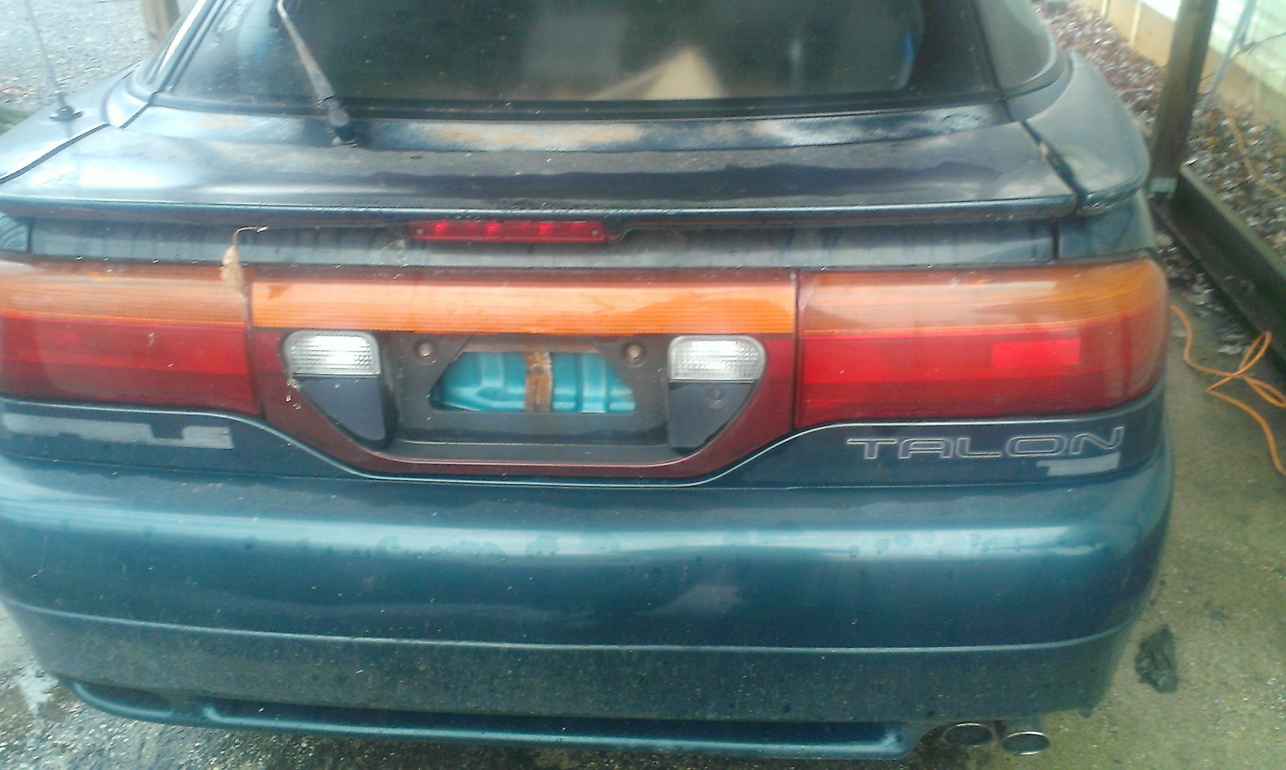

**Downgraded to parts car to support my GVR4 and Laser Turbo.**93 DD/Fuel Economy/Power is nice but secondary this time...I'd rather have than have not.Unfortunately, it is still on jack stands nearly 2 years later.

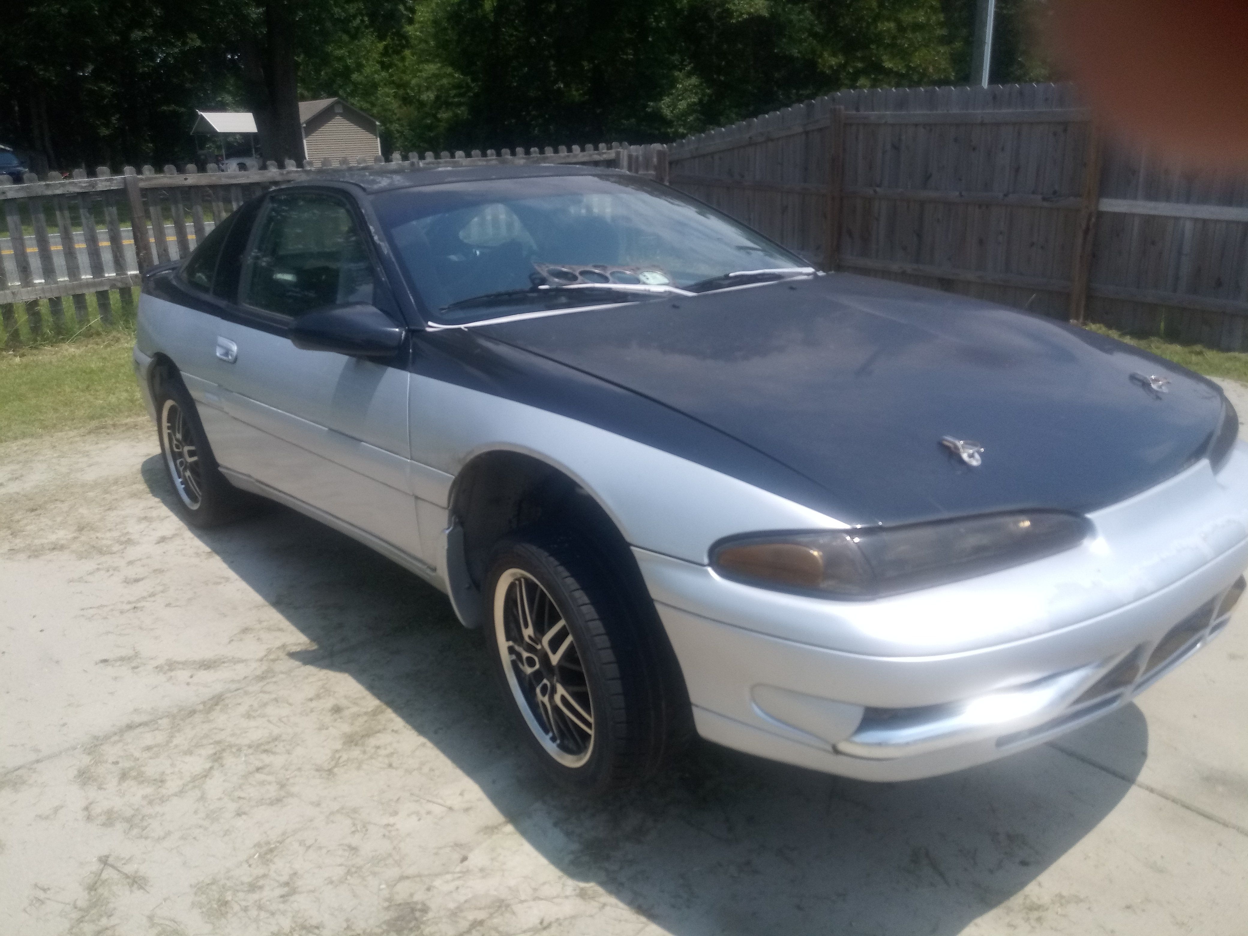

Don't worry, I feel you on the jack stands. Mine was on jack stands for months. The previous owner had it at 450 hp and didn't take care of it. So I had to clean that up and drop everything down to be suitable as a DD.

Ive been getting 25 highway if I drive right.
I struggled with misfires for so long. Ended up being that on dsmlink you have to uncheck "use 95/96 cam angle sensor". Im embarassed to say how many parts I replaced before someone local helped me out.
