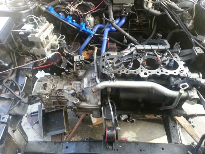

So i bought it and began tearing it apart to do the head gasket job, I found that some of the valves were slightly bent so I decided to rebuild the head as I was already there. $380 later I had a freshly rebuilt head by a buddy of mine that owners Landa Performance here locally. Bought a Cometic head gasket and put it all back together.

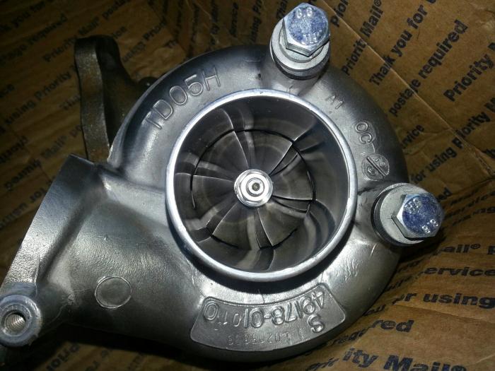

Next I sold the Knock off turbo setup to someone here on the forum for cheap and bought a real MHI EVO 3 freshly rebuilt form a member here on the forum for $380. Then picked up a new FP exhaust manifold for $200 from English Racing and a Hallman MBC for $60.

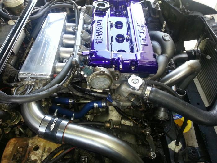

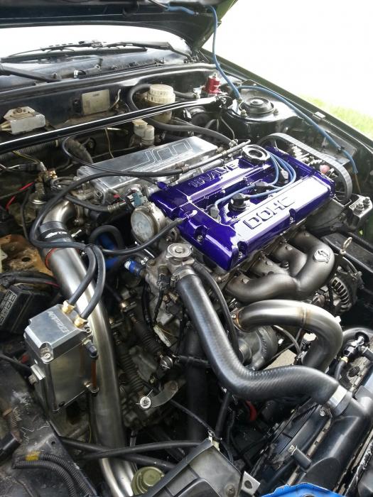

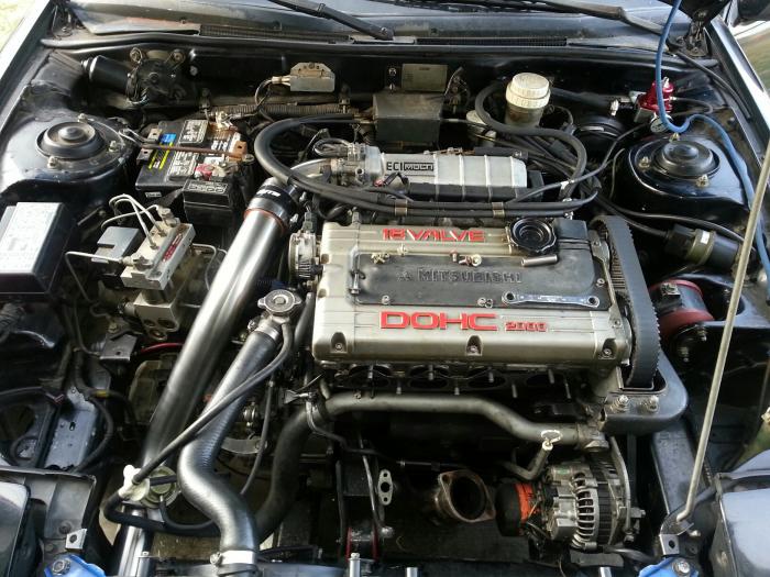

Here are a few pics of Parts Ive picked up and how the engine bay looks now.
So got lots done this past weekend.

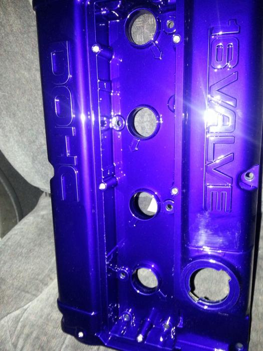

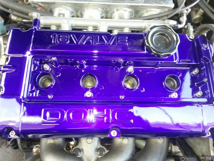

Had my Valve Cover Powder coated by a guy here local with a illusion blue color.
Fixed a few bolt hole that had stripped threads.
Installed the turbo system.
Did the Fuel pump rewire.
Installed the JMF SMIM.

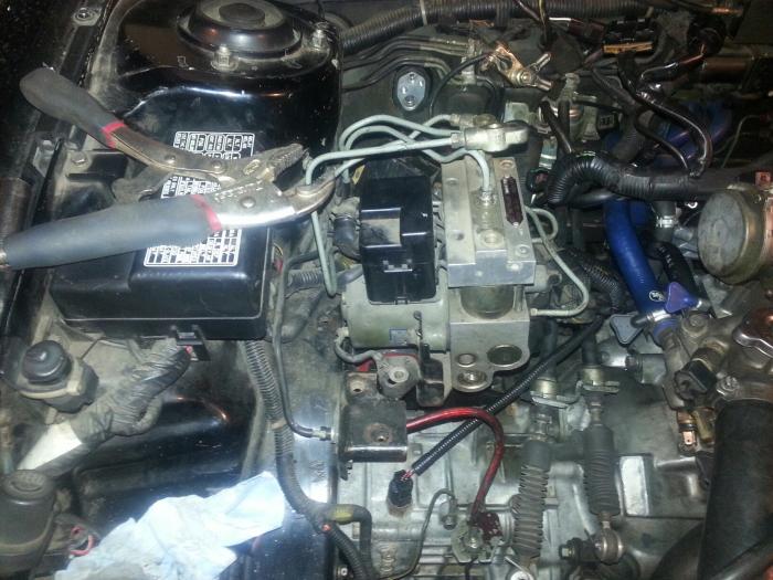

Eliminated the ABS system.
Did the Cruise control delete.

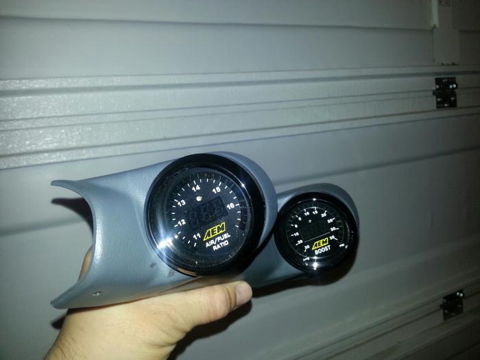

Wired in the AEM Boost and A/F Gauges.
How was the abs delete? I am about to do it on my car. I plan to cut the old lines out and replace them with non abs lines and prop valve from the junkyard. It looks so complex but simple at the same time.
Actually only took me 30 minutes to do. I had the intake manifold off already so it made it so much easier.
I just cut the old lines out. Much easier than trying to sliding them out. After all was connected had to bleed the brakes. Had my bro-in law help me do that.
Good luck doing the abs delete.
Cool valve cover buddy!

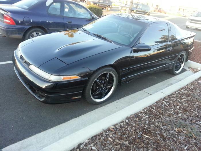

And nice 1ga. You know how to pick'em :p
