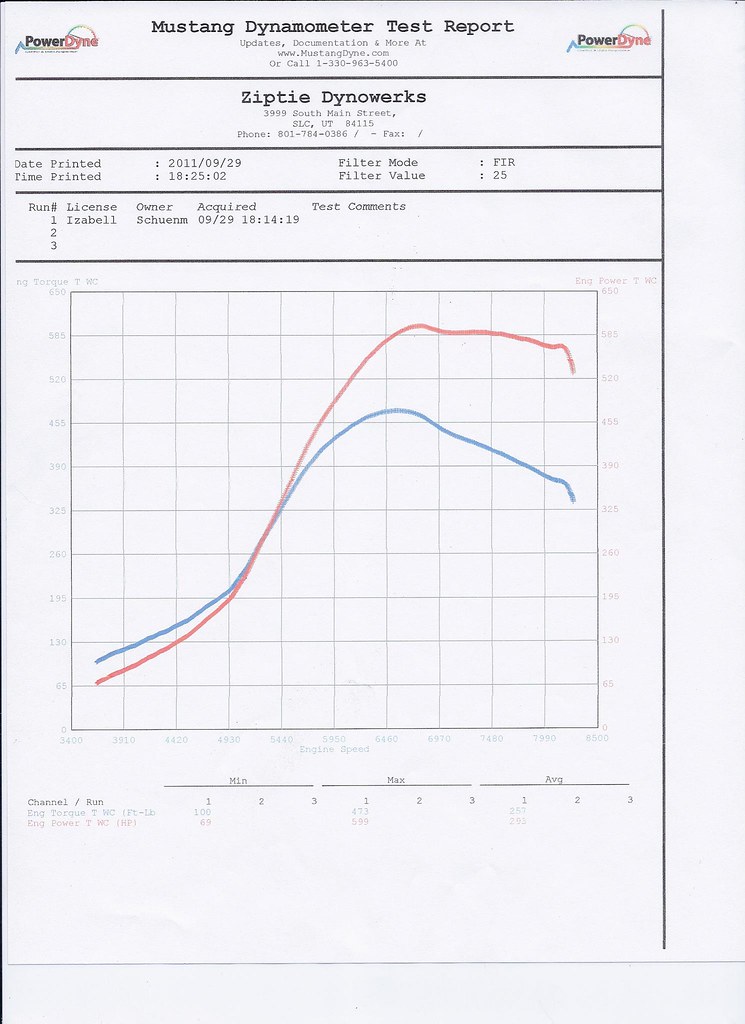

After a bust dyno session last week. We headed back to the dyno at ZipTie Dynowerks last night. T. Talon ran awesome and put down 602hp/474tq at 36 psi. I'm still running the evo maf so we didn't push the boost any higher because of maf overrun. Yes, I do plan on going speed density. The car just hasn't been up and running long enough this season to get it done. The last race of the year is tonight at Rocky Mountain Raceway. I'll be there hoping for some good times!

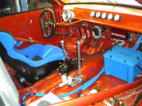

Mods:
Wiseco pistons/Eagle rods w/ ARP’s
PPG Dog box transmission
Fidanza Flywheel
Act 2900 w/6 puck unsprung
Kelford 280 cams
Magnus Motorsports drag sheet metal intake
1000cc FIC injectors
(2) External Bosch 044
Mallory FPR
Evo MAF
Garrett front mount intercooler
HKS BOV
Turbonetics exhaust manifold
38mm Tial wastegate
PTE Billet 6262 @ 36 psi
DSMLink V3
Hmmm just a guess 10s but im not good at guessing LOL. Nice sheets I hope I can stay in dsm long enough to do that LOL
