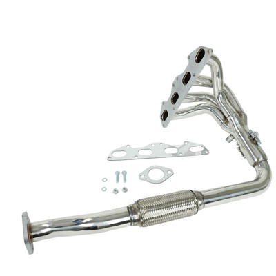

Your gonna have a hard time hooking a turbo header to the exhaust without a turbo. You need a non-turbo header for a 420a. Something like this.
4g63 manifold has a different bolt pattern. You have to buy something specifically made for the 420a Eclipse/Talon. Your 2 options are 4-1 and 4-2-1. DC Sports makes a decent 4-2-1 and Megan Racing makes a decent 4-1. Although most of the 4-1 headers seem to be the same.
