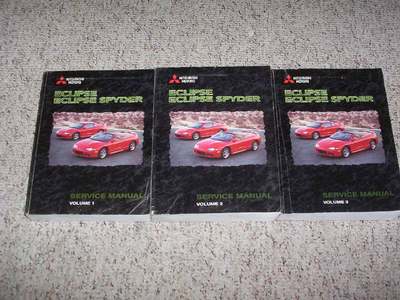

That's posted Resources section here. You'll note it's for the 1997 model year and some of the scanning errors makes it harder to follow than a good hardcopy for the right year. I also seem to remember their are pages missing for things the original scanner wasn't interested in or felt were duplicated in other versions.

I did notice that, but I can't find the specific manuals I need. I checked Mitsubishi, and they didn't even have them at this point. I'll poke around on ebay, but I prefer electronic when I can get my hands on them. Ctrl+F is my best friend. It just doesn't help here, because I'm tracing schematics that don't seem complete... they just kind of reference certain things.
I don't have any manuals here but I'll be back to home base hopefully next weekend. I think I have a few other 2G manuals in the basement, the only 2G ones in my office are for the 95. If I find a 99 manual we can figure out what you need from it.
I'd watch eBay for the hardcopy set anyway. There are out there but I wouldn't pay $200 for them.
