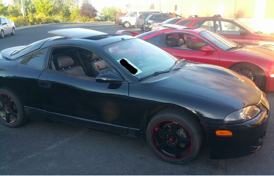

2Ga Talon
I would rather be quick than fast. Some people build race, just want it to handle well. Boost coming on soon and some low end is more ideal for what I am after.

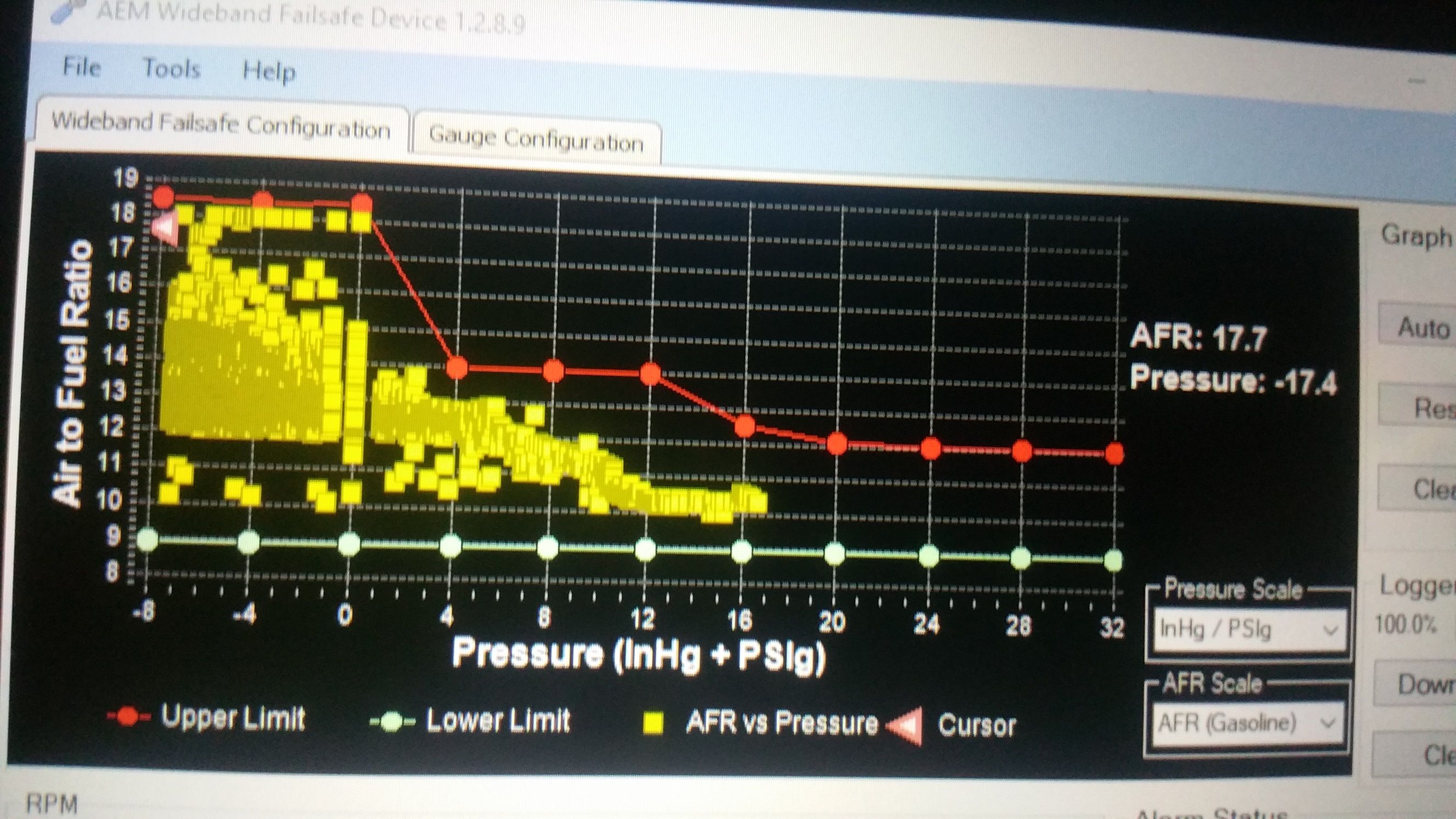

Sooooooo quick is just 1st and second gear it turns out took it to the track tonight and best 1/4 I could manage was 15.9 - I refuse to run it to redline and probably a lot of my runs could have shaved some time if I held gears a little longer but when I hit 6500 rpm it really doesn't sit well with me, maybe I just cant drive the car hard enough because its my car and I have a mental block that tells me something will probably break. I dont think I have ever hit rev limiter come to think of it and some other guys at the drags tonight were telling me that they forget to shift sometimes and bounce off the rev limiter.. one of those guys was running much better times idk.
It seems like 1st and 2nd gear I see 15lbs of boost but once im into 3rd it didnt put out more than 12lbs of boost.. 3rd fell on its face maybe its because I didnt hold 2nd long enough, but I dont want to be too hard on the engine.

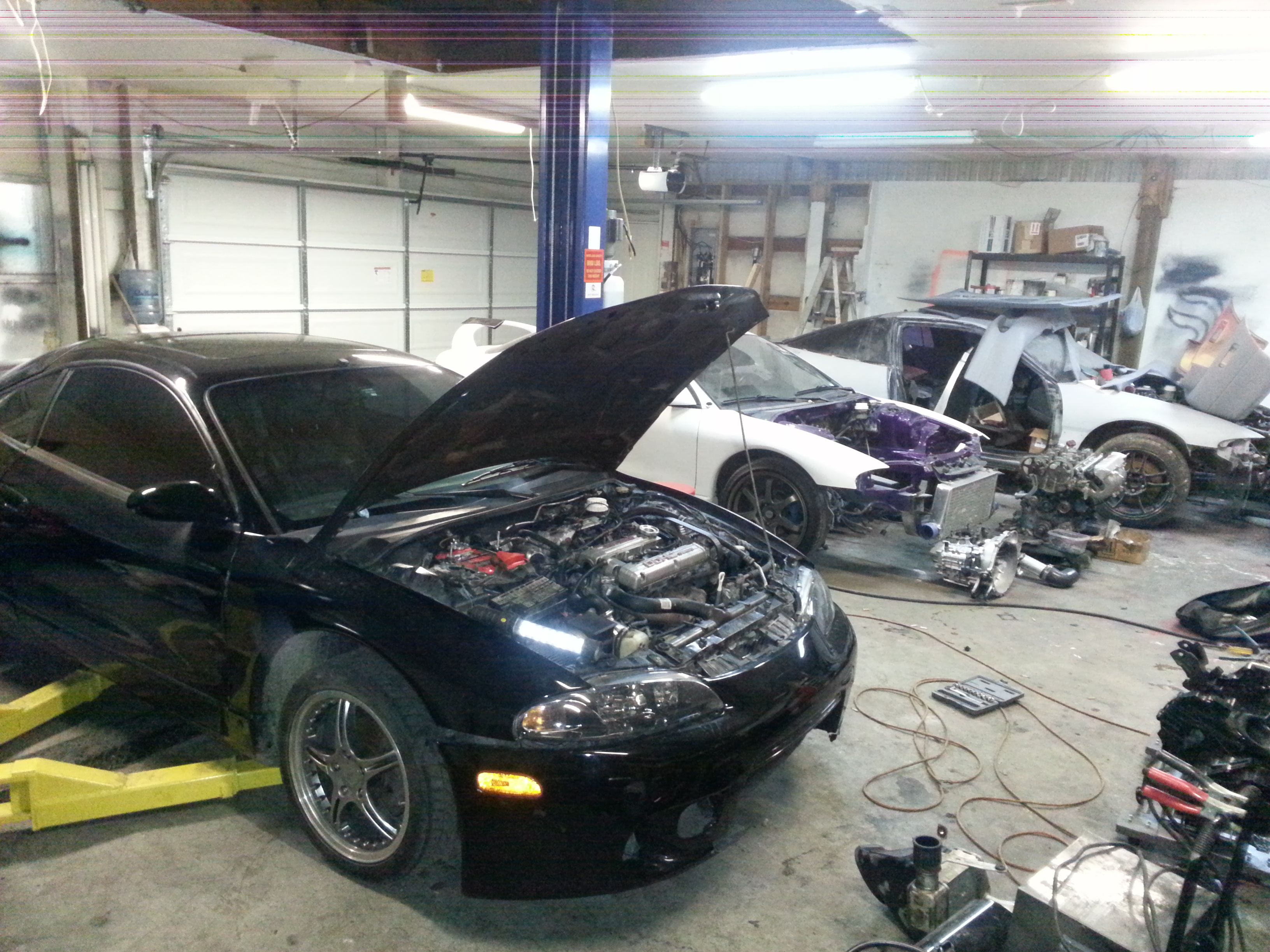

I found lots of issues over the last couple months.. The shop I had it in didnt tighten the intake manifold properly nor did they torque the exhaust manifold bolts properly one backed off enough I could tell it wasnt tight and prompted me to throw a wrench on and check them all, low and behold found lots of loose bolts SMDH. Im not super happy with the work I got from hollands. I could make a rather detailed rant of how the bolts werent tightened, one was only holding by 1 thread which it promptly ripped out upon tightening - someone placed a bolt that was the right thread but way way too short on the far right of the intake so I had to go buy a random bolt from napa.
Lets start from the beginning...
Took car in had head gasket replaced I was quoted 1200$ and a cometic HG would be used, new water pump and new timing belt.. ok sweet.
Price then goes unexpectedly to 1800 im like uhh not what we agreed on man, he tells me he will consider taking 1600, fine I just want my car back.
Upon getting my car back, was notified a felpro HG was used because block surface was feared out of perfectness.. fine..
Drive around the block and notice that my speedometer is not working, pop hood locate plug to transmission but not sure where it plugs into the sensor (because im not the one that unplugged it) drive back to shop let them know and they plug the sensor in, cool now my speedo is working.
When they had my car I asked one of the mechanics to make sure the oil got changed before they start it, I get some flack for wanting my oil changed and told thats extra.. man thats a basic part of doing a head job because water can and will get into the oil....... WTF why do I know that (oh maybe because I have personally changed a few heads myself..)
Next issue my throttle cable sticks open and idle wont drop over the next day, great look at the cable and its not routed at an angle its happy with (too sharp on curves) so I unhook it and pour gun oil in the cable and move it around so it operates a little nicer, it still sticks once on me so I go to napa and buy springs / connect them to the TB and it now pulls its self closed easier.
Then I took it to the track where I cant beat a 15.9 and know something is wrong..
While at the track my temps are a little high and I notice an exhaust bolt is loose.. so I go home and tighten all the exhaust bolts and find they turn easily all but two .. now im a little upset.
I get the car home and park it for a week, I finally go out and inspect the pulleys to find the alternator belt is too loose and the power steering belt is too tight.. I adjust the PS belt (I was told by aaron never to tighten this belt too much because its too hard on the water pump bearings) :/ I then also notice my tensioner pulley for the AC belt is loose and bouncing on the side of the block and the tightening hardware is completely missing off of it.. jesus. When I dropped the car off the AC was working and now its not.. they put it back together with the wrong belt a NON AC belt and jacked my ac belt.. thanks guys. Then didnt tighten that hardware or maybe didnt put it back at all IDK.
- Side note, the giant bouncing tension-er pulley / chunk of iron its on bouncing against my engine block while at the track im sure was really nice to my knock sensors..

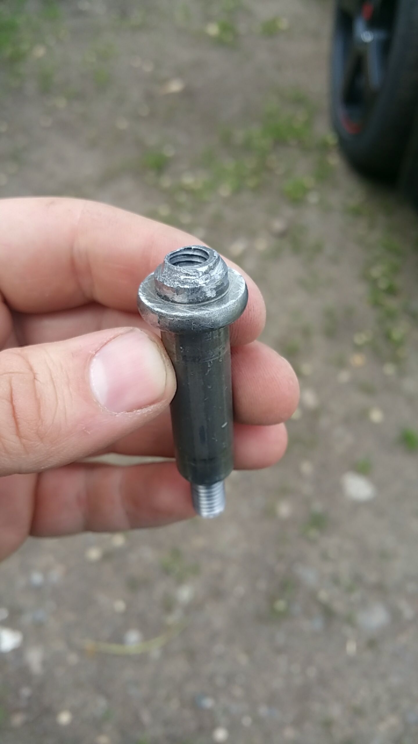

It was at this point I ran into the stripped (because the bolt was too short) intake bolt.. get replacement bolt from napa not the right head on it but right length and threads.
Side note, when I dropped my car off I had previously broke the driver door handle, but you could grab the unbroken side and still open the door, when I got my car back it had broke all the way- not a big deal as I already ordered a new handle, but just add it to the list.
Now I have replaced the door handle and fixed the electronic lock by this point. Now im just worried about the head bolts and torque specs.. the valve cover is leaking on one of the bolts thats new, add it to the list.

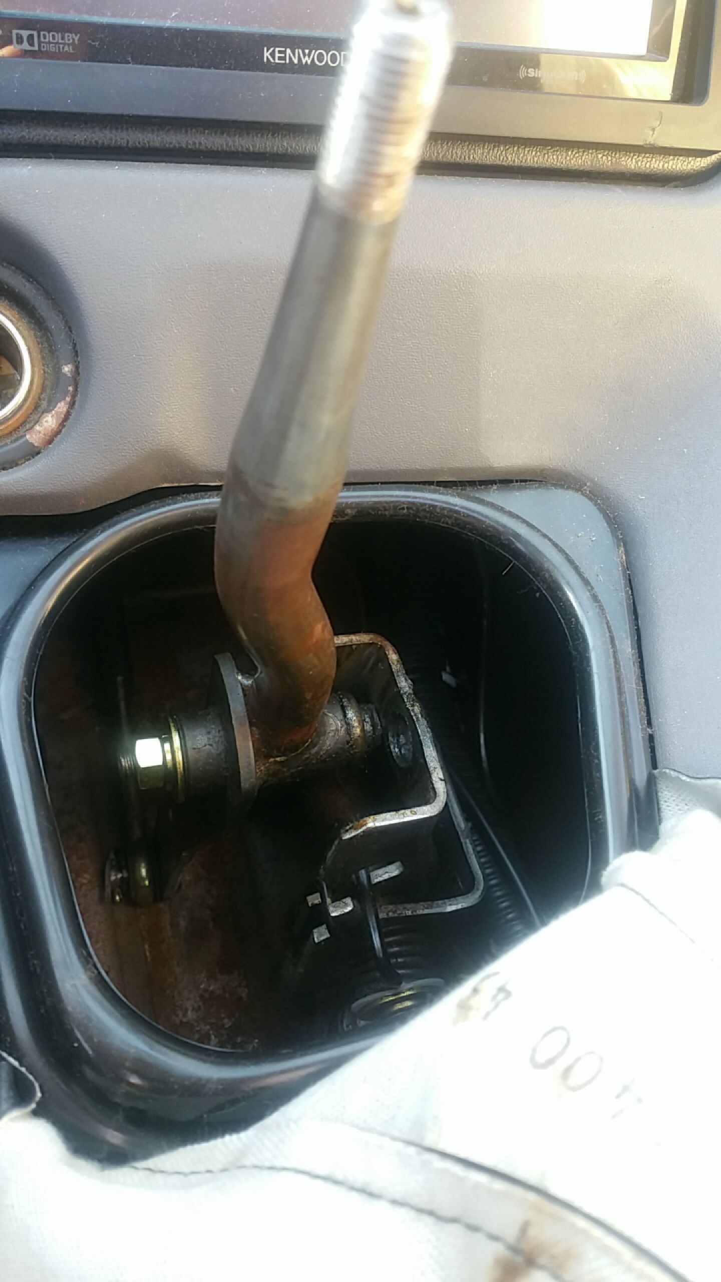

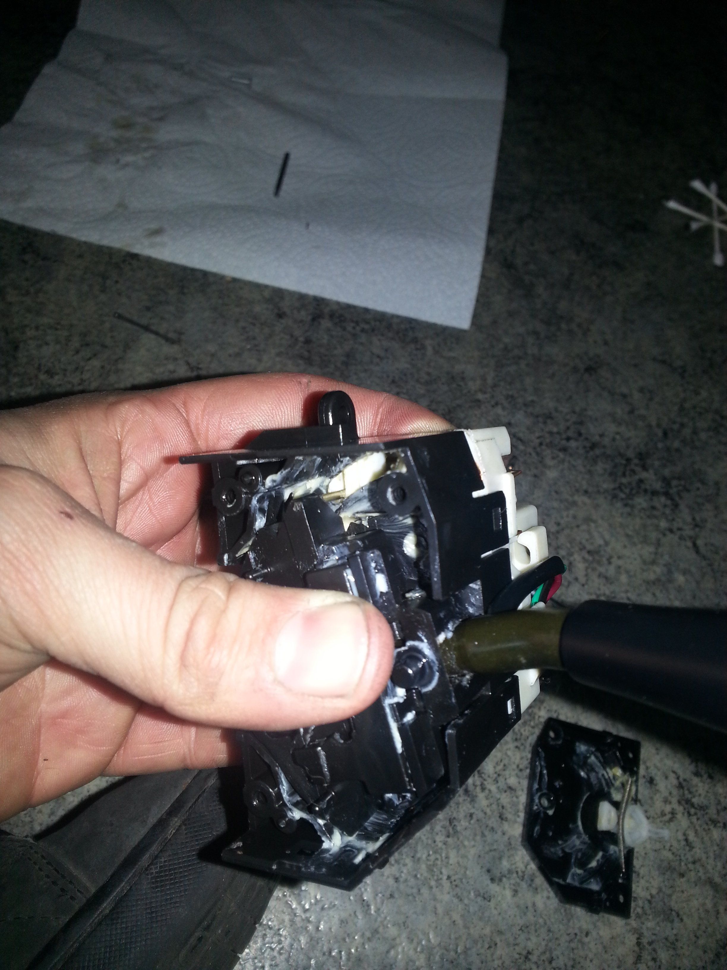

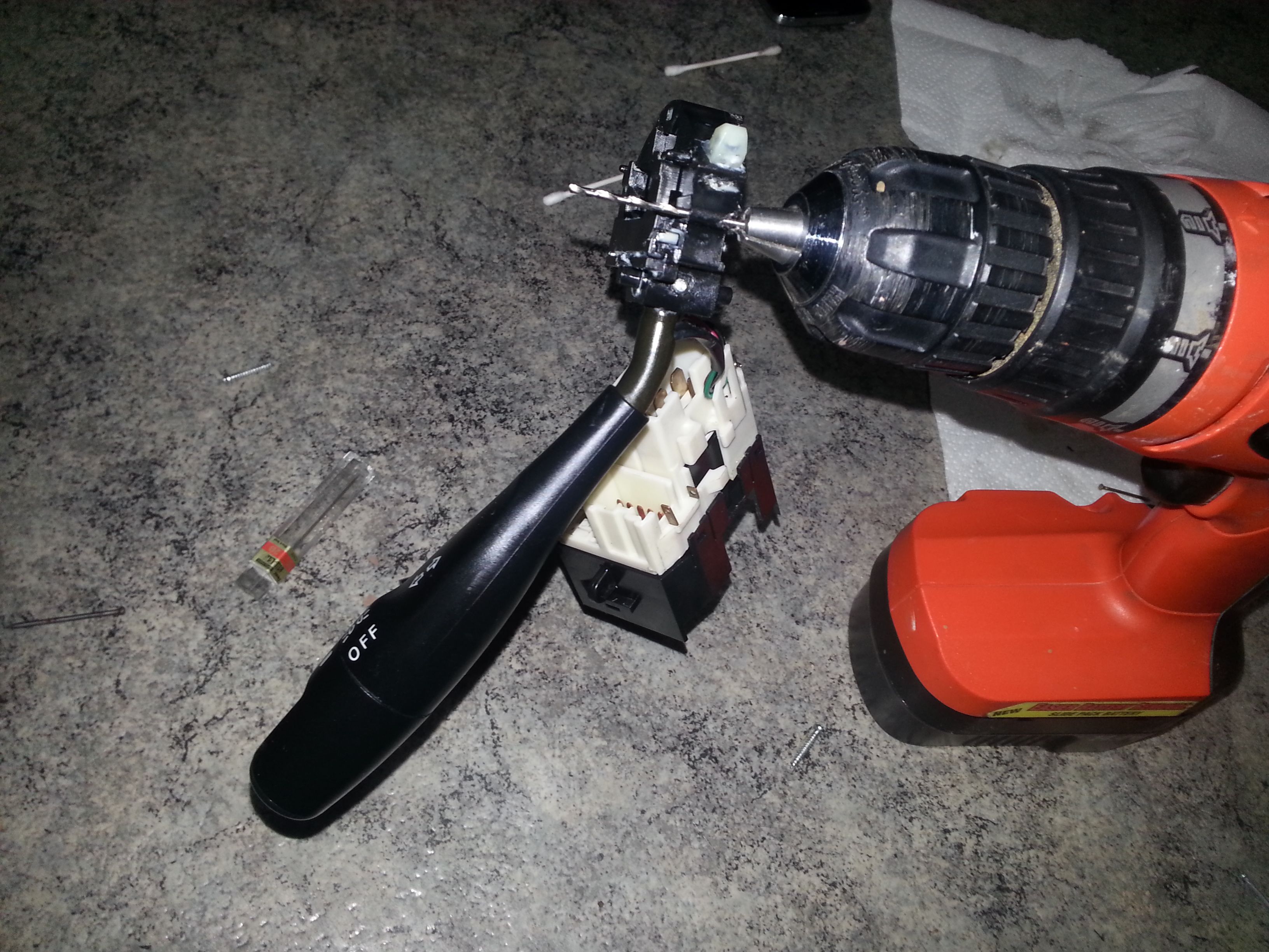

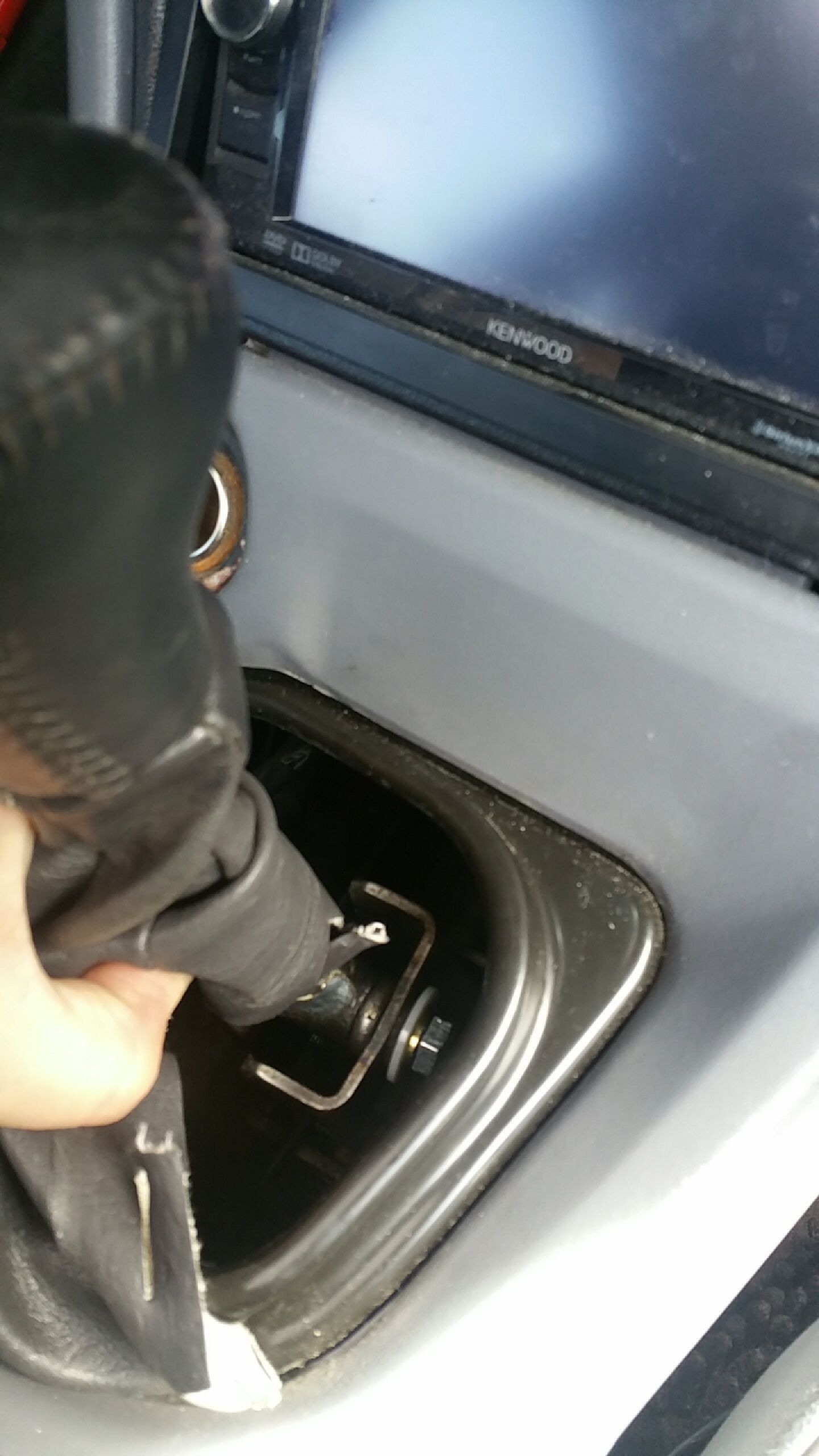

I just looked through your pictures, what's up with the pictures of the headlight/blinker switch?
The turn signal wouldn't return, so it would constantly stay on left turn and wouldn't shut off.. It was broken so I opened it up and found the peg that broke and replaced it with a nail. I did this because the quality of the factory one is really decent minus that peg obviously.. So that and a good greasing and it works flawlessly now and retains the old sturdy part.

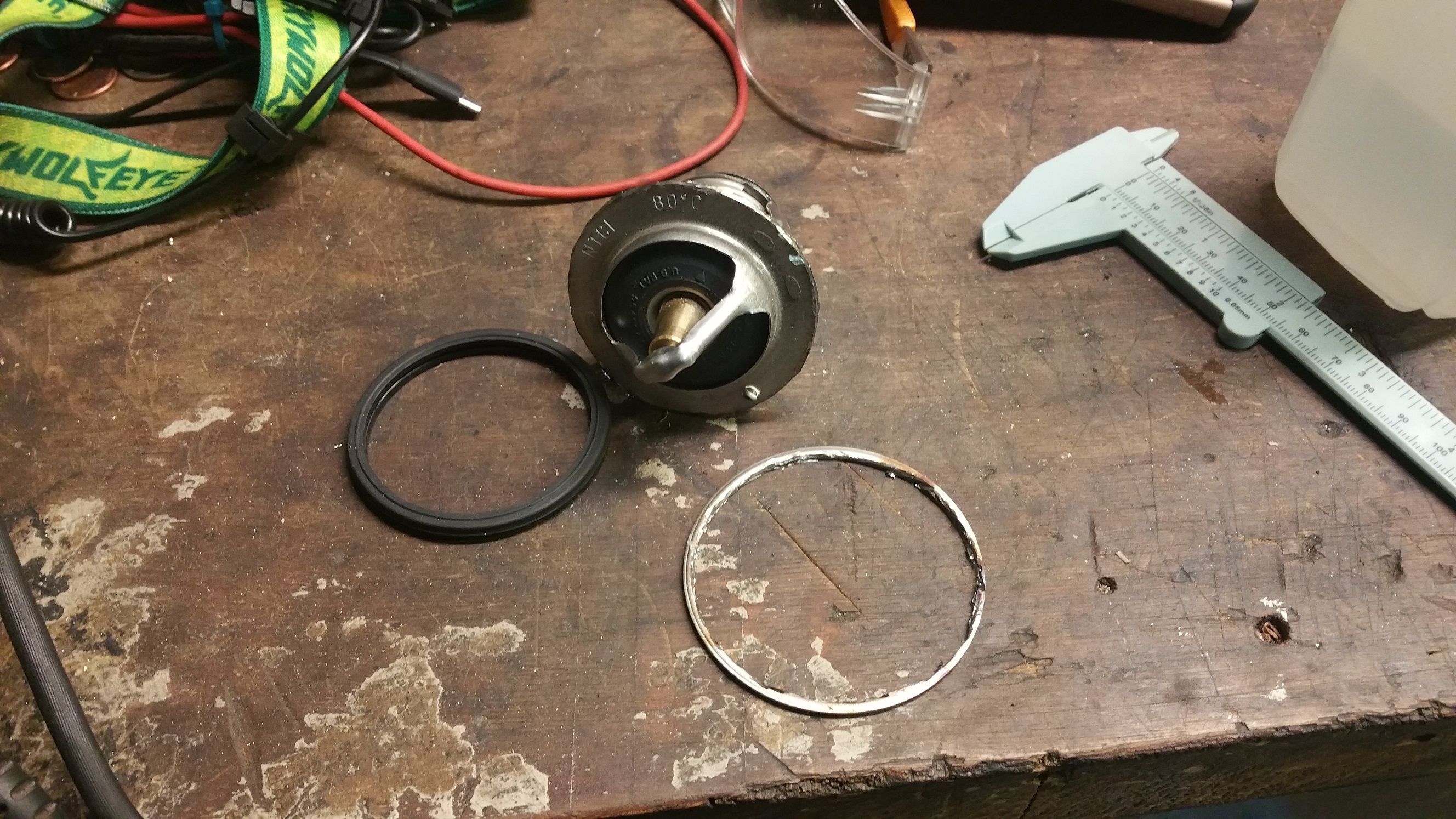

So the EVO9 thermostat does not fit factory the same / same diameter without modification. It would work if you held it in the right place and the oversized o ring would seal but outside of the factory grooves it is supposed to drop down into. I can optionally cut to size for the application which is what I would like to do.
The inner flow function (when the thermostat opens) is much larger than the one designed for the DSM 2g engine. Giving more flow, I can't argue with and would much prefer it.
Update:
I cut about 2 mm off of the thermostat in circumference and made it the right size to be used and drop in properly.
Hear me out on this one.. I forced open my run of the mill autozone thermostat to the fail safe locks. See where the temps climb to driving for a while/ do some highway driving.. Mine would run so cold highway driving without a thermostat it showed me that obviously that was the bottle neck.
What I did was bought an Evo9 thermostat and cut off 2mm around the outside and run that now.. the inner diameter of actual flow area is much better than the anemic normal dsm one.
Mitsubishi Part No. MD363571
80c For Lancer EVO
Why the EVO9 and not the much more affordable evo 8? Well.. you see that rubber/silicone covered mid section.. you see how that would help it not only seal when closed but also prevent the thing from seizing under extreme temp changes? and is larger inner flow diameter than the standard DSM one.. I didn't find this on a how to from someone else. I ordered the thermostat because it was the temp range I wanted and looked to have a larger opening mid section. My thoughts were correct on those two matters. I looked and found some places that said the thermostat used the same rubber gasket as the DSM part number to only be disappointed when it arrived. Not wanting to give up because of the obvious advantages of this thermostat I still set out to use it.
Advantages they are indeed. My temps are perfect now warms up quick, cools quick when it needs to. I trust that this thermostat will function better than the non OEM stuff and will flow better than the standard OEM DSM one.

AFR AEM gauge installed. With rewire and 450cc injectors 17lbs of boost is starting to lean from 10 afr to 10.5
