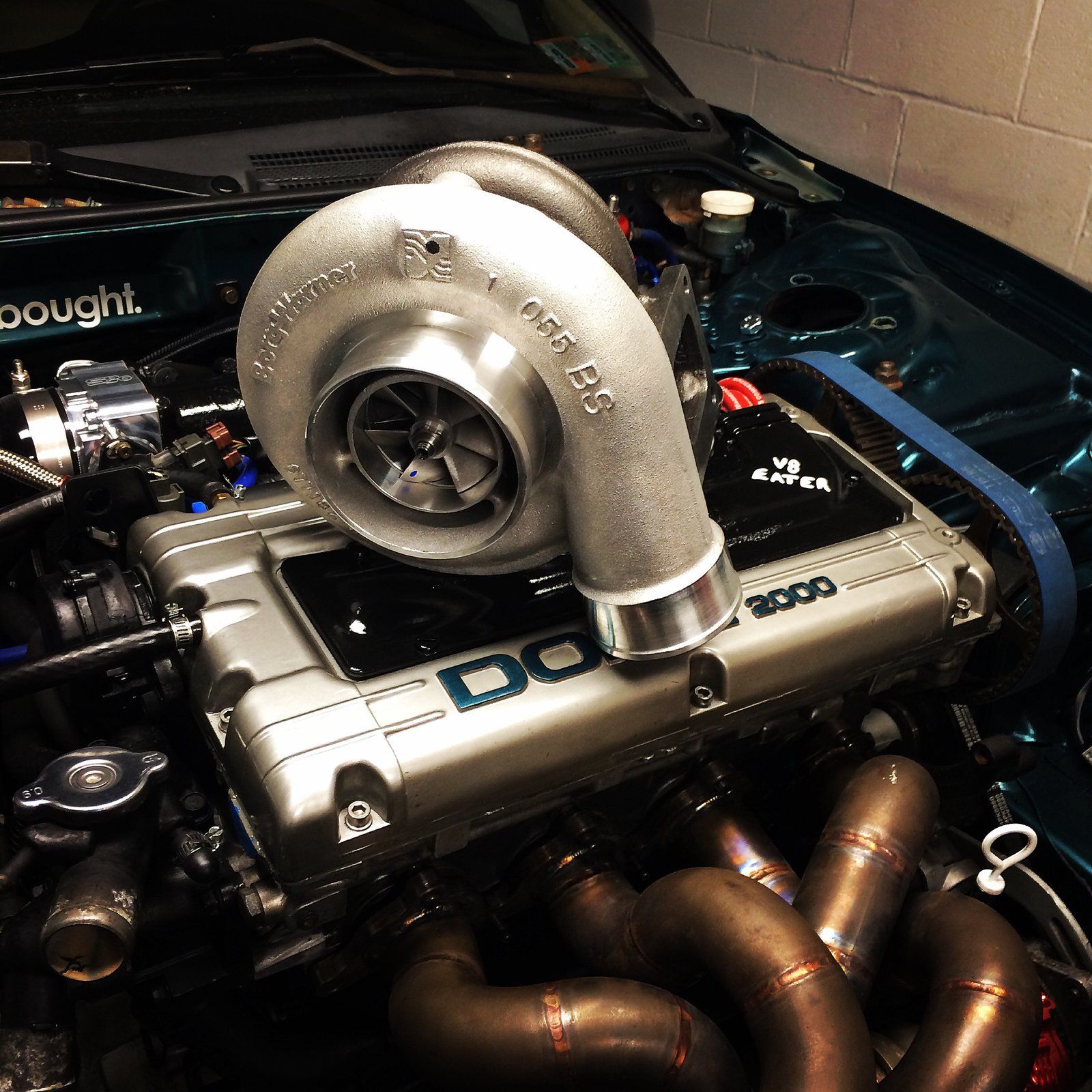

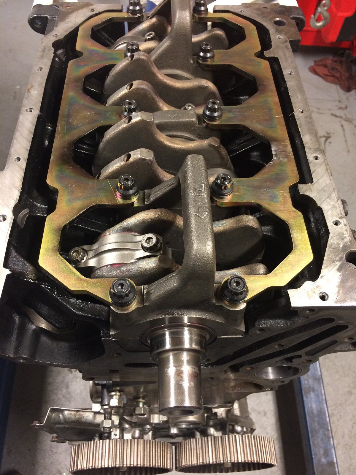

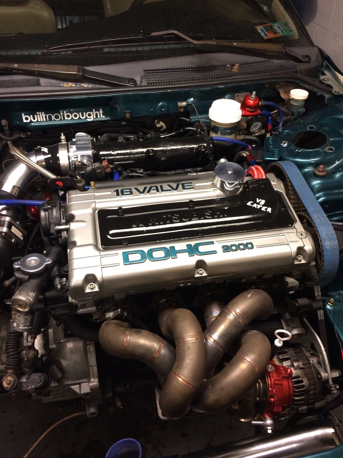

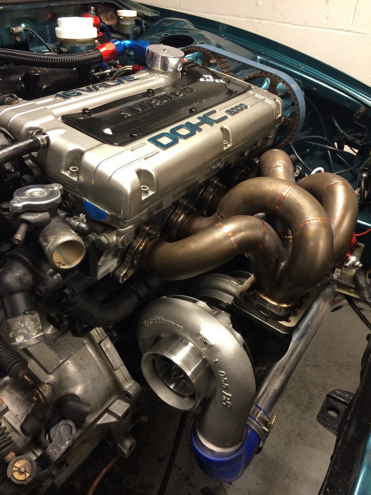

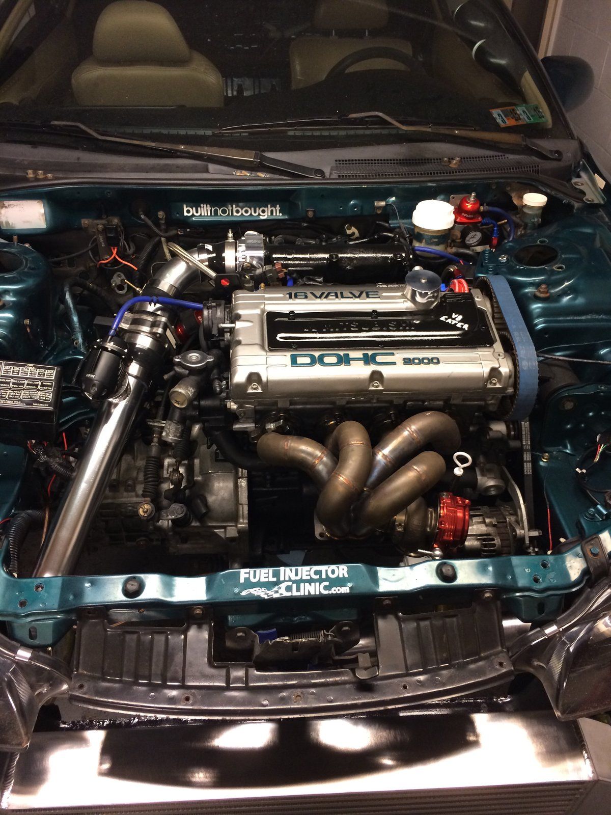

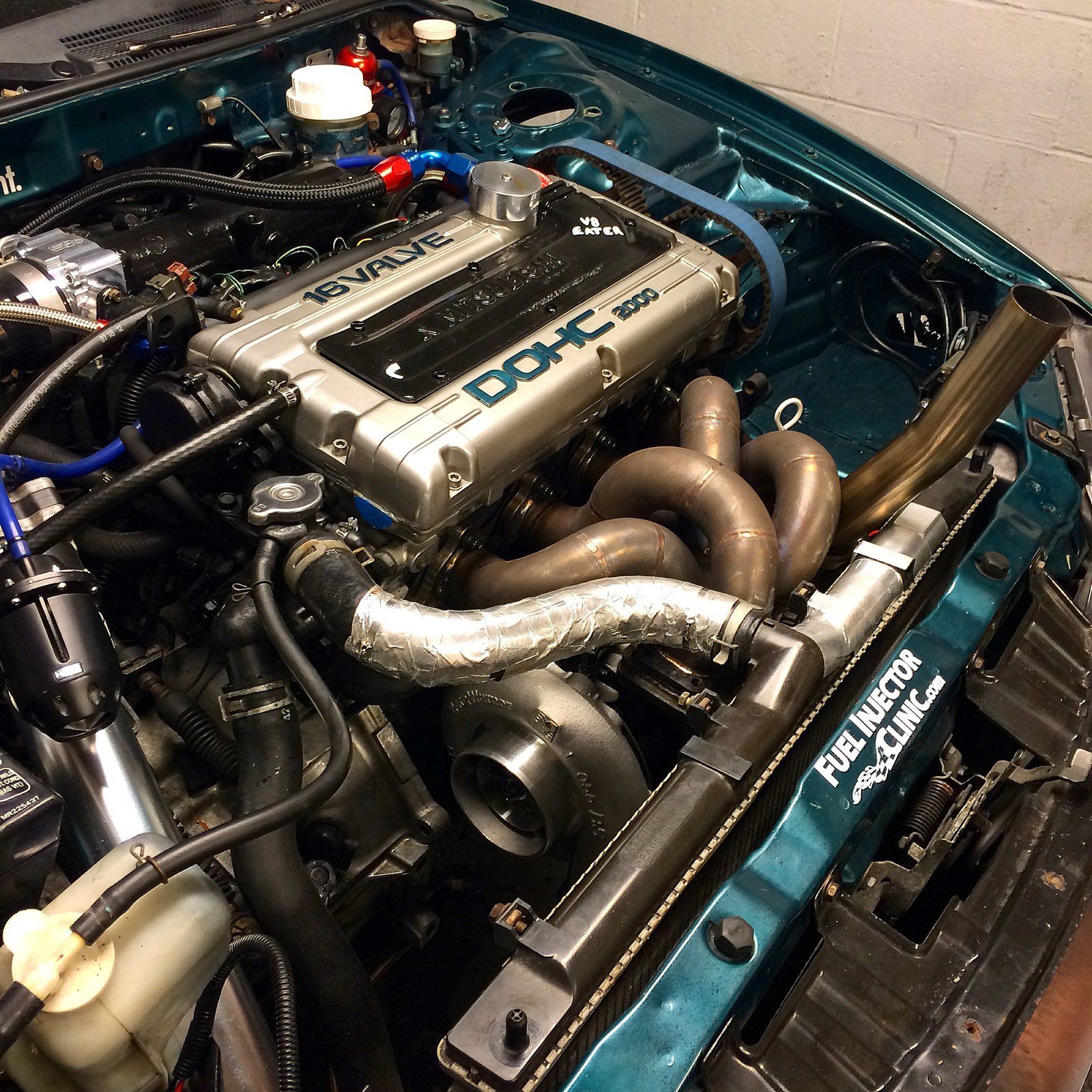

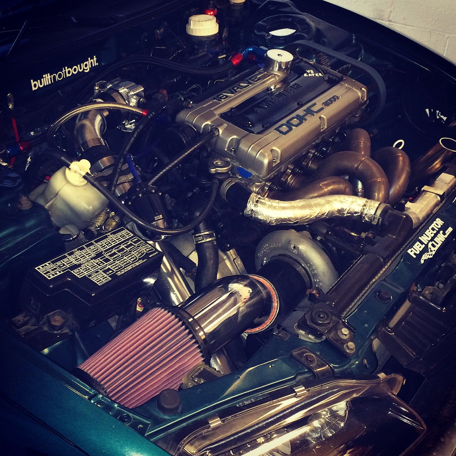

After running my holset hx40 for a year, i upgraded to a t4 borg warner s366. Only lost about 800 rpm of spool and flows about 85lb/min. Very pleased with how low in the rpm range it starts spooling and hits full boost at around 5500-6000 rpm on my 2.0L. Built my engine and transmission again for this season. Installed bigger fuel pump and 2150cc fic injectors with fic fuel rail and -6an line from tank. Last year i ran an 11.4 at 130mph so im hoping to get into the low tens if not faster with this turbo

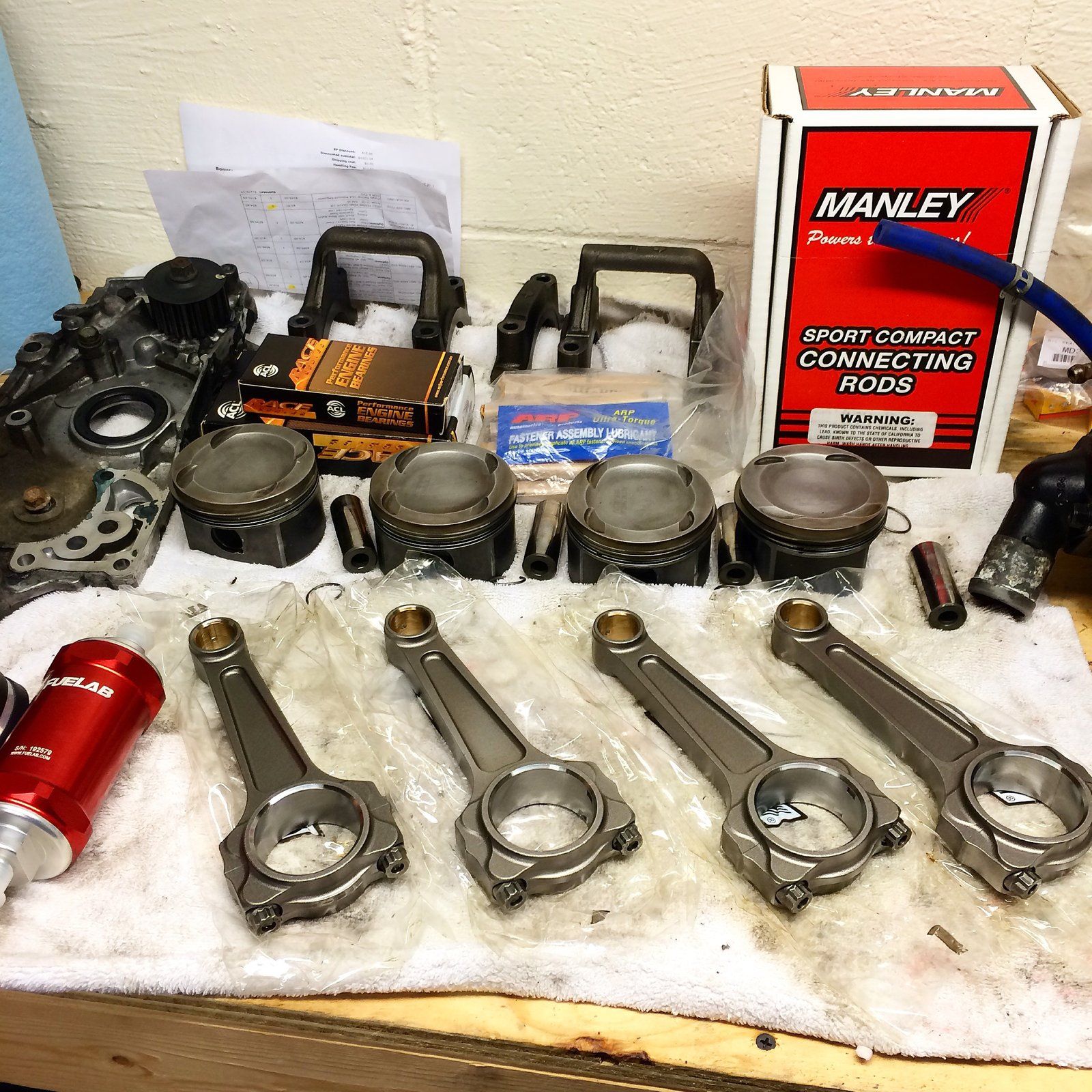

Mahle pistons 8.5 comp
Manley I-beam rods
Acl bearings
Kiggly main girdle

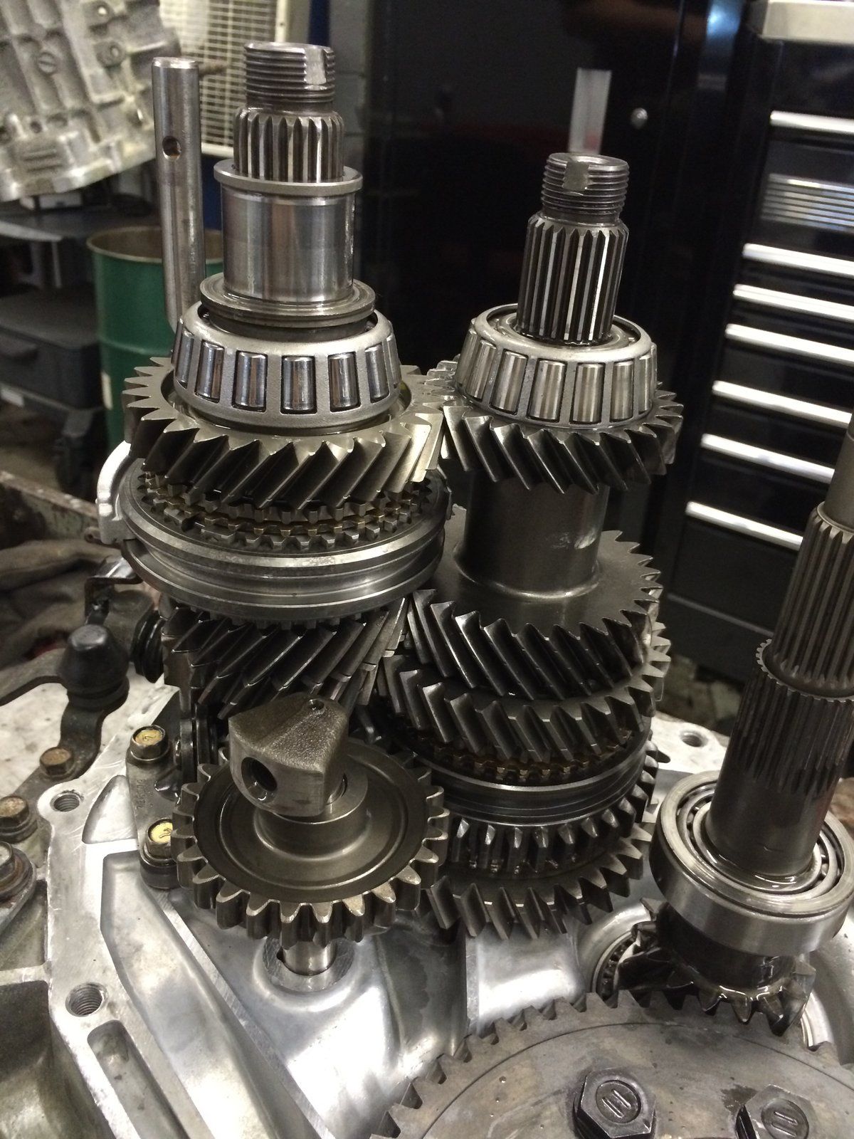

Trans-
Evo 3 gears
Double syncros
Upgraded hubs and forks
Welded center diff
Stage 4 clutch for now
Built transfer case

Punishment racing manifold
T4 adapter
Borg warner s366 .88 t4
44mm gate hood dump
