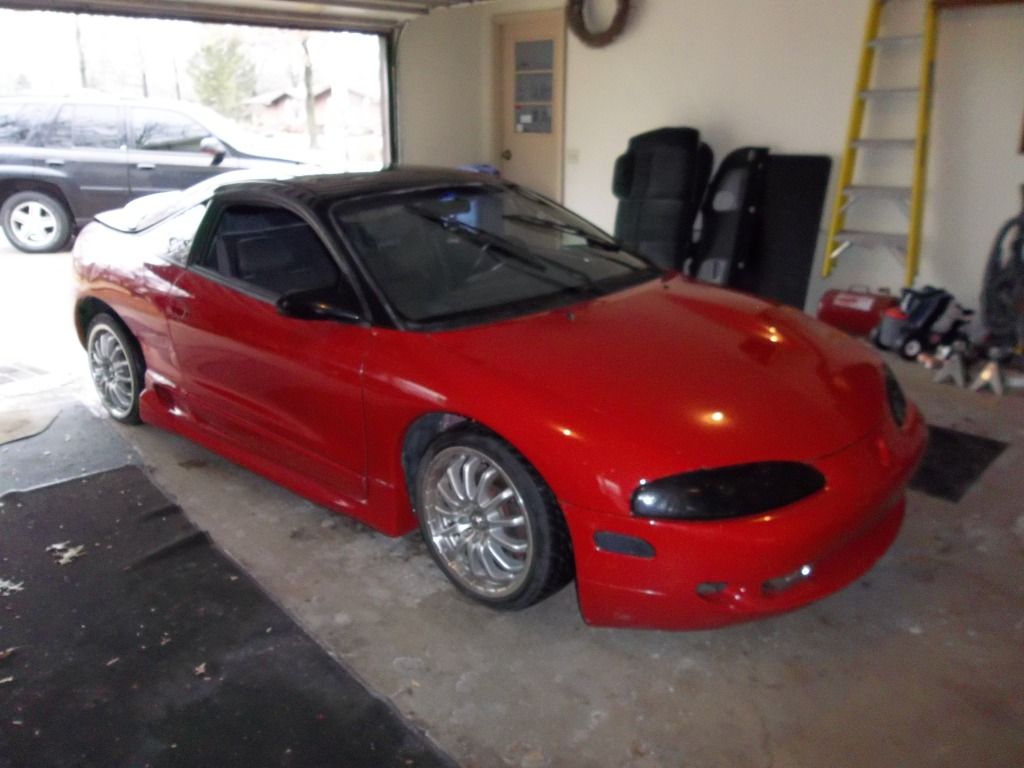

First day in the garage for starting maintenance

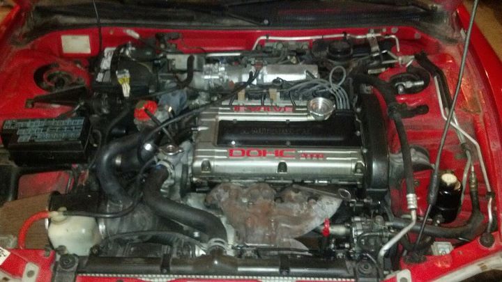

After the first cleaning of the engine bay

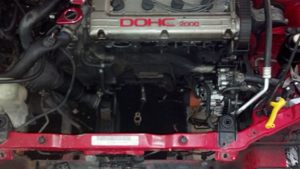

Tear-down for the 14b swap and air conditioning removal

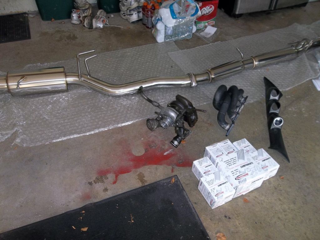

First round of goodies. 14b, prothane kit, triple pilar pods, pacesetter, srs catback, megan downpipe.

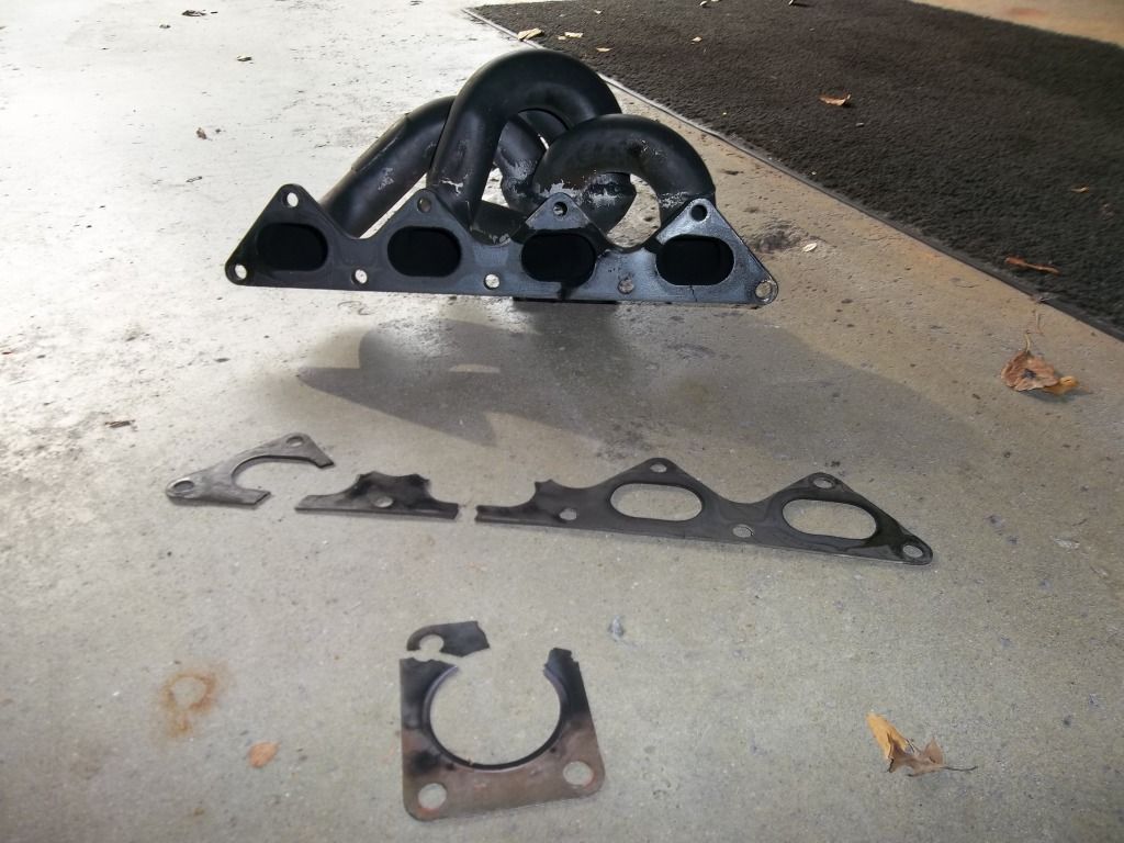

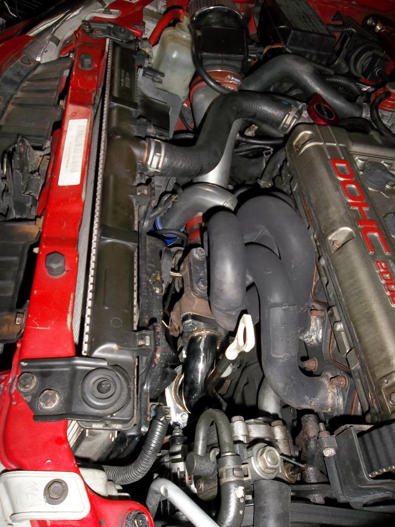

Did find that Im having an issue with the pacesetter header. That was one of the first things I installed. After the first round of exhaust leaks (I thought it was due to the crappy gaskets they sent with it) I put new fel-pros in it and they lasted about as long as the crappy gaskets did. Heres a pic of the aftermath.
Anyone else having problems with their gaskets blowing out? Or is this something I am just over thinking?

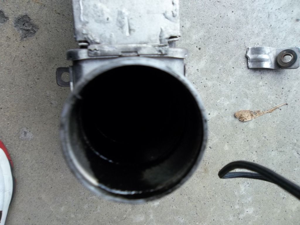

I cleaned out the intercooler with some gasoline. It helped immensely.
Before:
After:

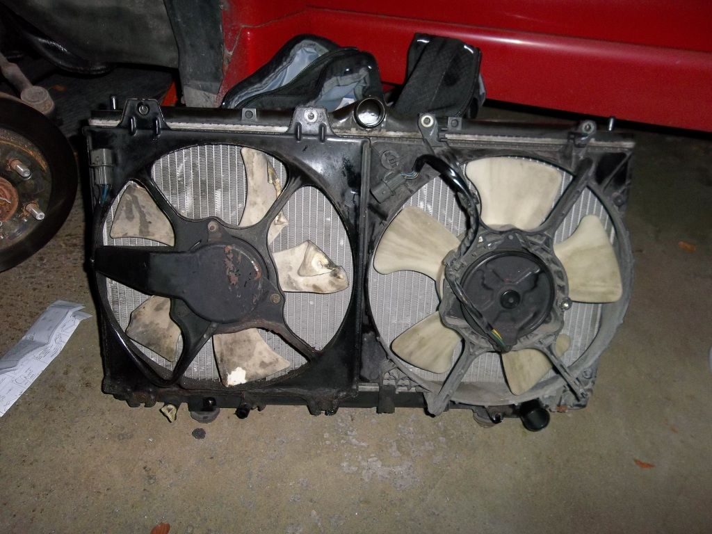

Plus I found that the fan blades had been melted from the turbo. Im gonna do some slim fans to keep them a little further away from the turbo.

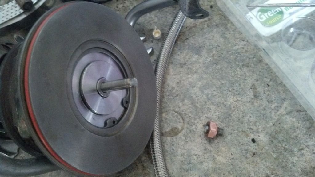

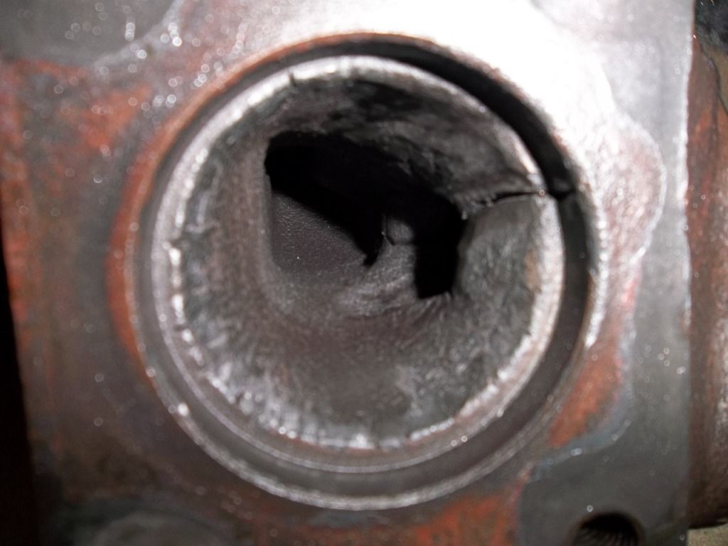

Here's the cracks in the 14b housing as to why I had to ditch it. It had about 5 more deep ones in the wastegate side and a few more surface cracks on the outside of the housing.
I was looking at the same header. What do you think about build quality? May want to go with a flexible header gasket.
The header itself seems like its pretty well built for the price. I would not recommend even putting in the gaskets they send to even test it. Mine lasted a little over a week. Im also not quite sure if it is slightly warped due to the fact that I have blown out 2 sets of gaskets now. I guess you can say you get what you pay for on this one. It was relatively cheap ($120 i think). Its your call.
EDIT: and make sure to get the polished one not the black one. The geniuses at pacesetter decided not to put header paint on it so as soon as it gets hot it flakes off immediately. Thats why mine looks like shit in the picture above.

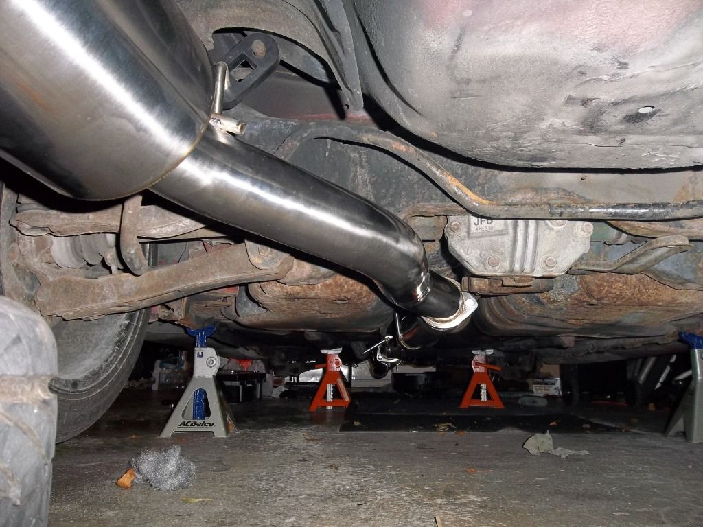

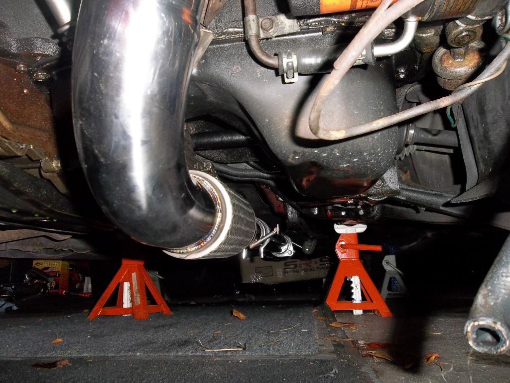

Finally got the old exhaust off and the new 3" turbo back exhaust on. Took way too long to get the old rigged one off since all of the crap the PO used was rusted. Looks pretty good and except for the clearance on the drive shaft near the diff is pretty close. Im gonna weld on a piece to the exhaust with a different hanger set up to give it a little better clearance.

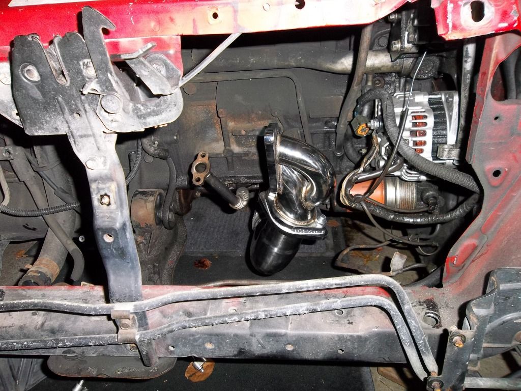

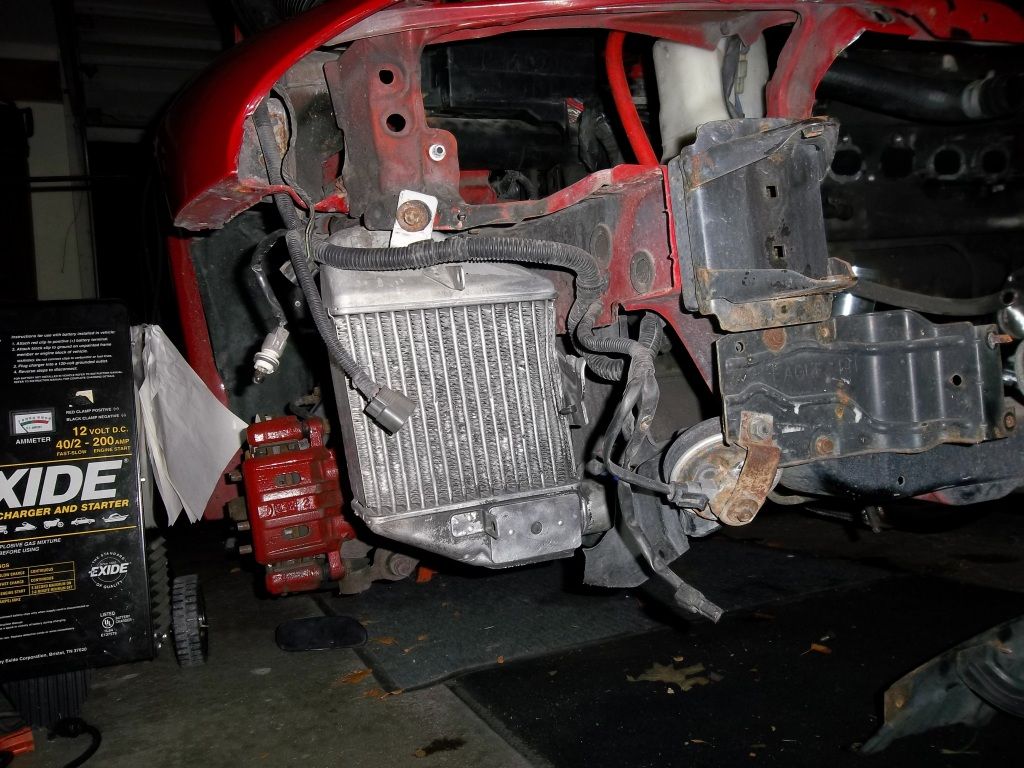

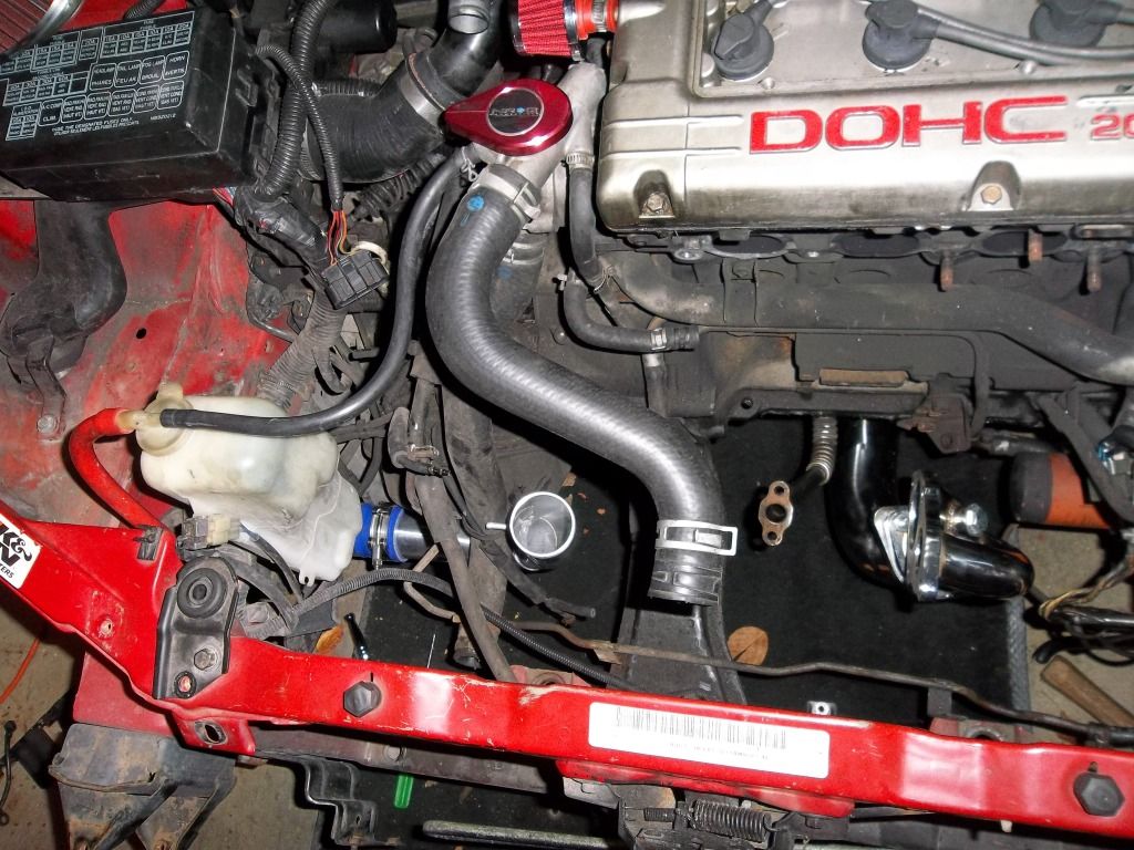

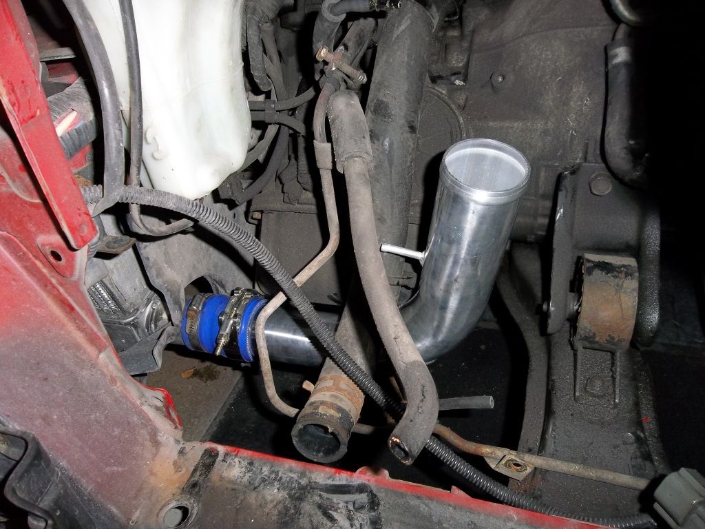

Then I got the cleaned up intercooler put back on with the lower piece of the j-pipe kit installed.

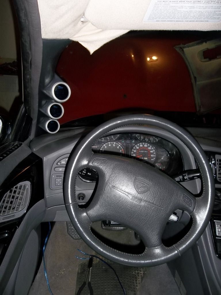

Now I am waiting to install the injen intake until the turbo is complete. But I also did get my triple pillar pod with oil pressure, boost/vacuum, and voltage installed. Wires are all tucked but havent been hooked up yet. will most likely get done this weekend.
