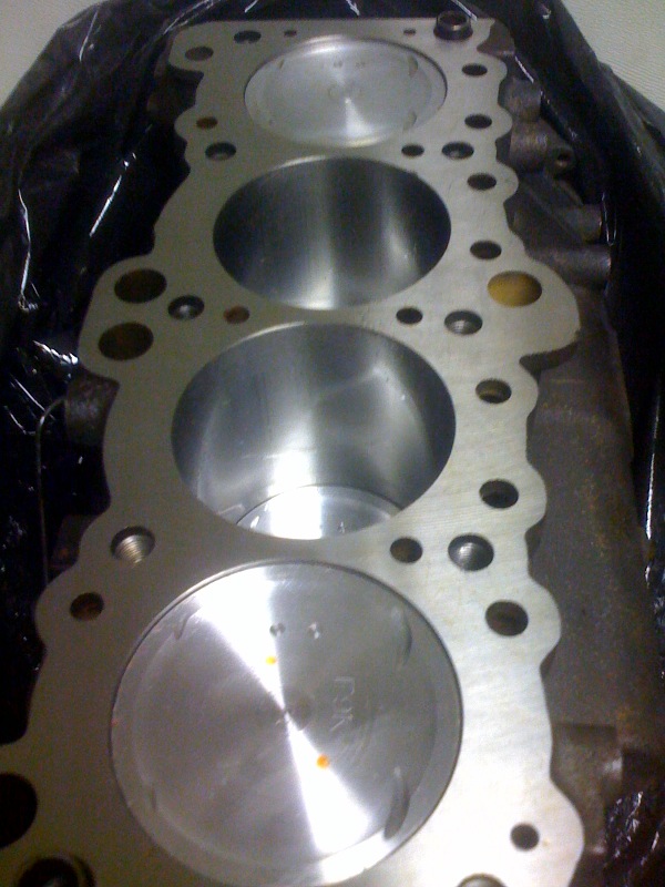

ive been doing some reserch on evo 9 pistons on 7 bolt rods and i really got confussed. people are saying to stay with 2g pistons an d some say to upgrade to evo pistons. could some one help with this.:confused:

Also if you look at the thread from page one i put up, it has a picture showing exactly the difference.

The evo pistons indeed produce an 8.8:1 CR when used in an evo block with an evo head.
In a 2g It is believed they are very close to stock CR when used with a stack deck height block.
The evo pistons are have coated skirts and forged heads. They are a significant budget upgrade. Just about the best pistons you can get for your money as long as you are picking them up from evo owners that are going to a fully forged setup.
