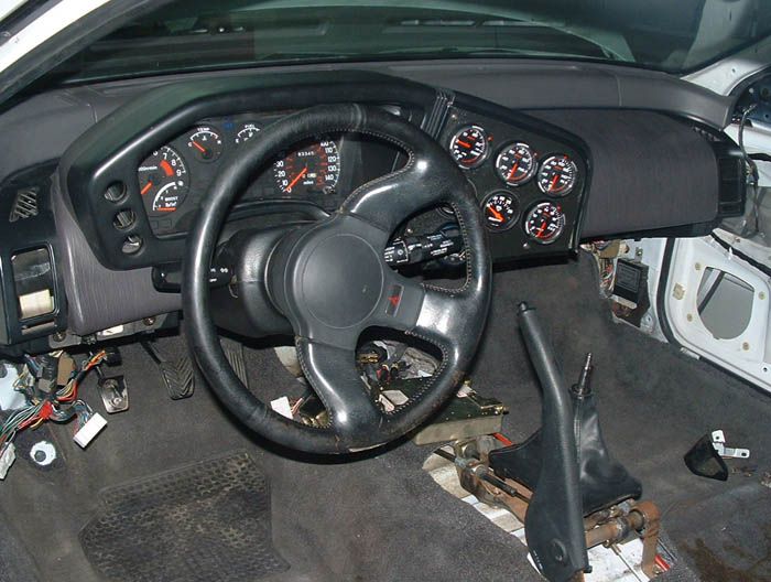

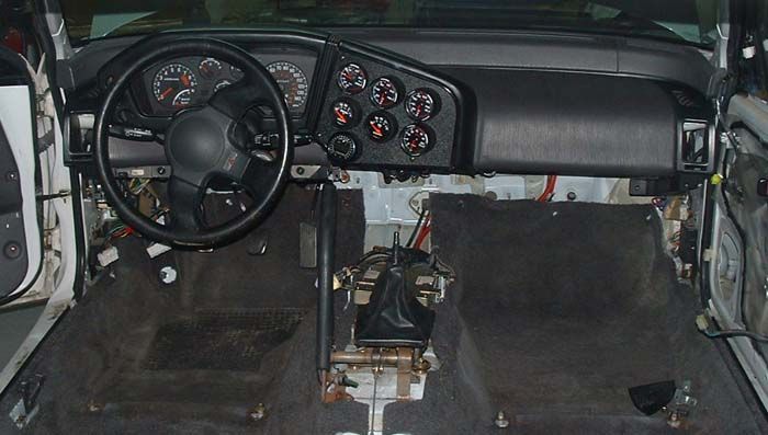

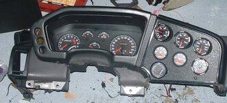

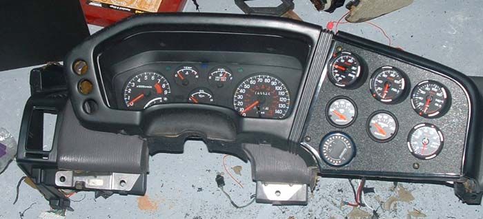

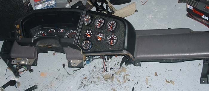

Photos of my dash work... you'll notice that I have angled bezels for 3 of the gauges so far. I still have to pick up more of those. I bought a sheet of 1/8" ABS plastic online to make that panel and will be using the rest of the sheet to make a custom center console to cover the shifter assembly.
That looks really good Chris... you're becoming quite the fabricator.
On another note; How is your clutch assembly? If there's any play (as it will only get worse with all the shifting on the track), now would be the perfect time to swap a new one in there...
It's looking good. I love the driver-centered "cockpit" design DSMs have. It makes things like that gauge panel possible.
On the carpet- did you pull the padding off of the bottom of the carpet? Most of the weight of the stock carpet is in the padding and fluff on the bottom. You can pull that off and still have stock appearance carpet that weighs very little.

Nice gauges Luda. Where can I pick me up a set that are brand new? ;)
Yeah, don't get me started on that... Friggin Defi discontinued the D-gauge so I couldn't get matching water temp and oil temp gauges. What a joke. I guess I should have stuck with Autometer from the beginning. I wouldn't have had this issue with them. I'll eventually swap all my Defi gauges out with Autometer so they match.

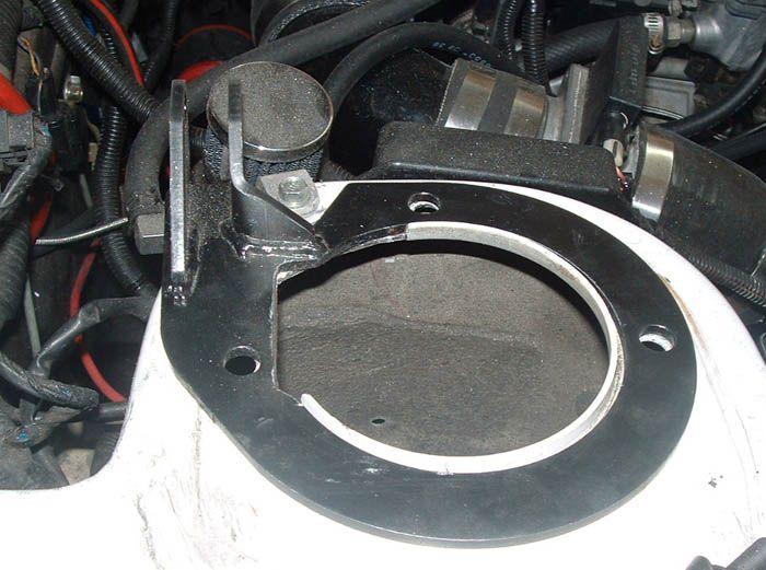

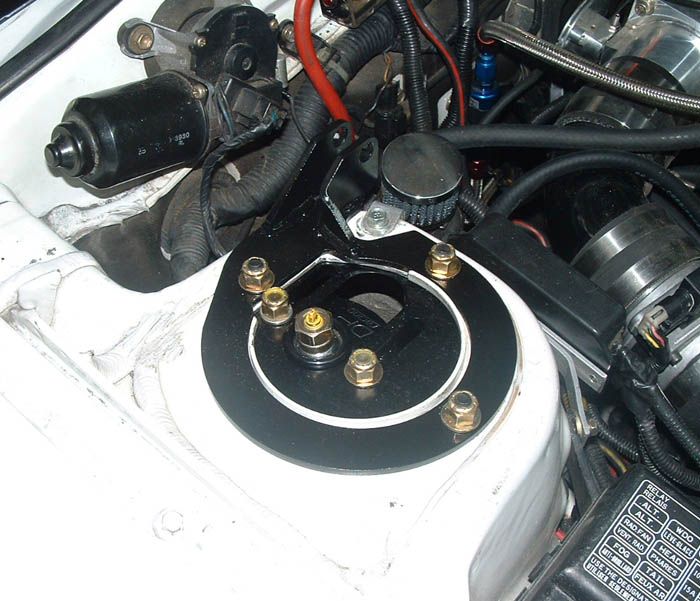

Looking good Chris! Those camber plates look sharp. Did they come with the strut brace brackets welded in or did you have those added?
The strut brace brackets are just from the GReddy strut bar. They're bolted in not welded. I just had to grind the brackets down a little as well.
New RRE Camber plates going on... you'll notice these are the ones with added caster angle, which why I had to do some grinding on the shock tower for clearance.
I have those. They might work but nothing could explain how pissed I was when I went to pick up my clean car only to find the towers have been hacked. :notgood: Either way it looks like your cut job was far better than the guy who did mine :thumb:
Sorry to hear that about yours - but glad to hear mine looks good :) I tried to only take off as little as necessary and still make it look good.
You should cover the metal too. The guys that did mine decided that a cut off wheel was the tool of choice and they decided to cut from the top so I have the over cuts past what needed to be cut. Looks like a 10 minute job. Either way good luck this summer. :thumb: :rocks:

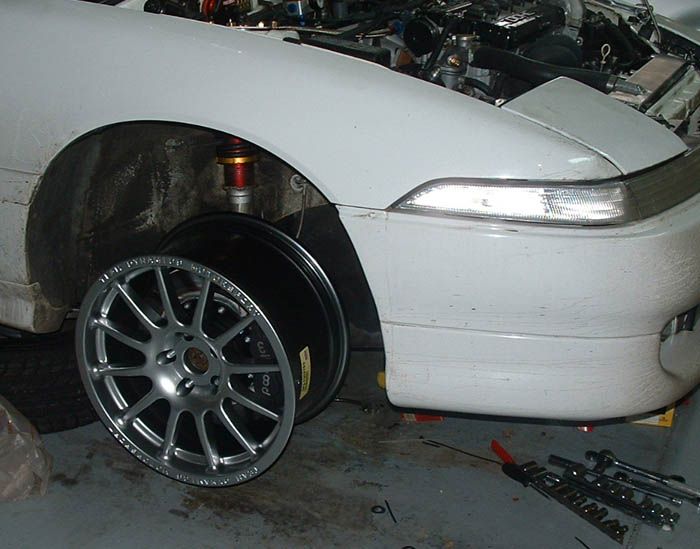

I really want to see the wheels and tires because i have some D2's on my 1g that i want to run some wide tires so i can auto-x it. i want to see what the wheel fit is going to be.
