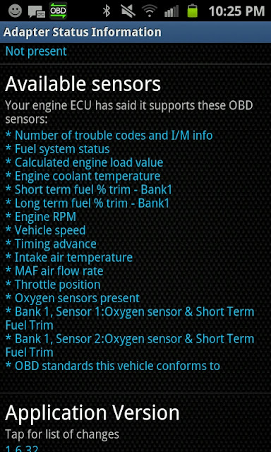

I used Torque today and everything I could compare to my actual guages seemed accurate enough. However I set guages for fuel trim, Bank 1 - Sensor 1 sensor 2 and so on to sensor 4, And im only getting readings on sensors 1 & 2 and not 3 & 4, Is that normal? And the readings I get on my fuel trim is like around 17% depending on throttle, normal?
And also on the Air fuel ratio guage there are two, commanded and Measured which do I use? I have tried Measured, and doesnt work.
And my Throttle only goes up to 97%.. App error or is it me? Lol thanks

The Gages that don't work you probably don't have sensors for, if you go to adapter status it will tell you what is available from the ECU. You should post that here.

Because you only have two sensors. 17%+ or-? At idle cruise or?
97% is probably you, slack.in the throttle cable is common

So 1 sensor controls 2 injectors? And I did see negative percentages aswell. Should use the logger on the injectors? What should I use in correlation with logging them, RPMs? Im new to this type of stuff.
Edit: At idle My fuel trim bounces between -.8 and 1.7

Fuel trims should stay +-5%. If they do your good
I don't remember anything about logging injectors??
