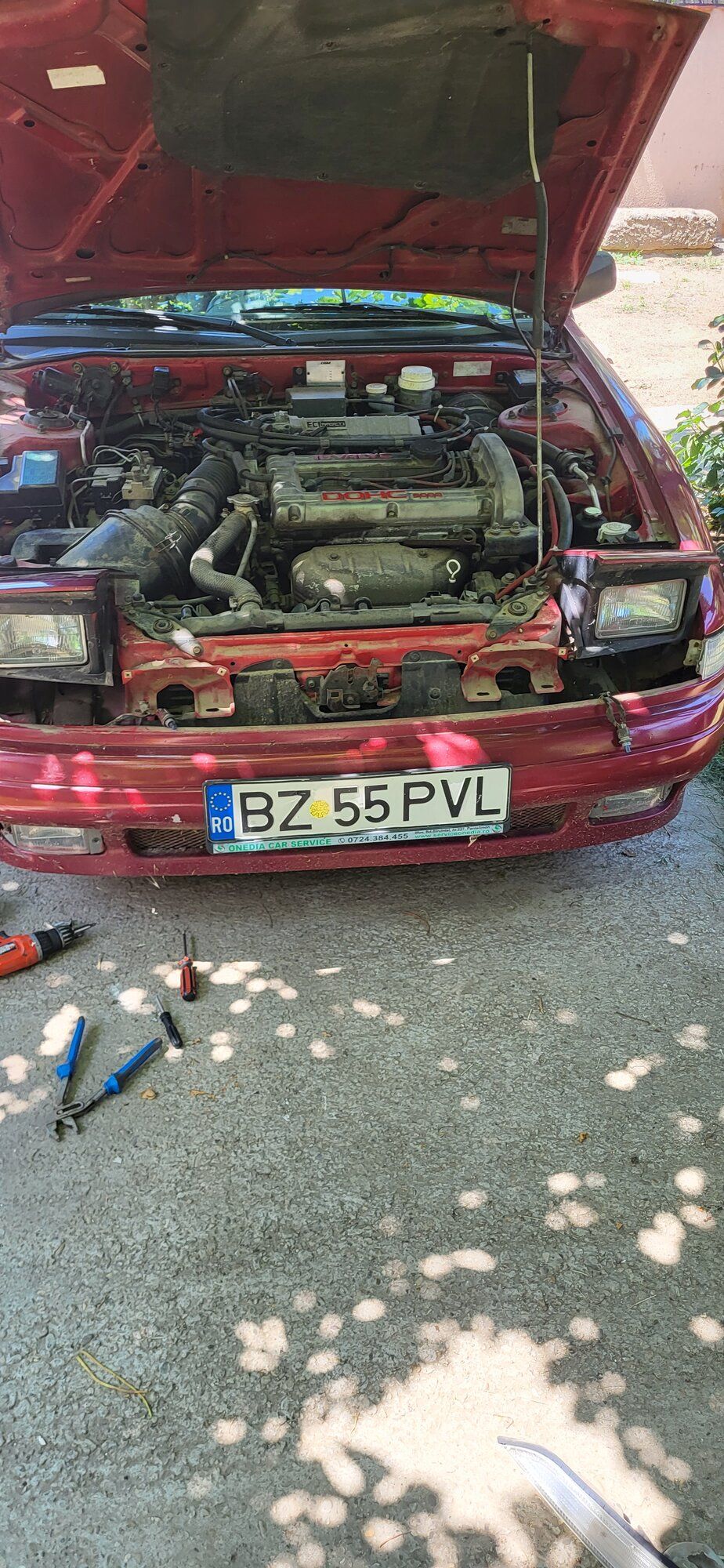

I bought the car a few weeks ago. It had been sitting for 2 years barely running, but the guy who owned it kept it well maintained except for the right corner lights which were broken and I could barely find replacements.
My goal is to reach 200hp but only after I repair and replace everything that is damaged (belts, hoses, filters, some bodywork, and small interior issues)

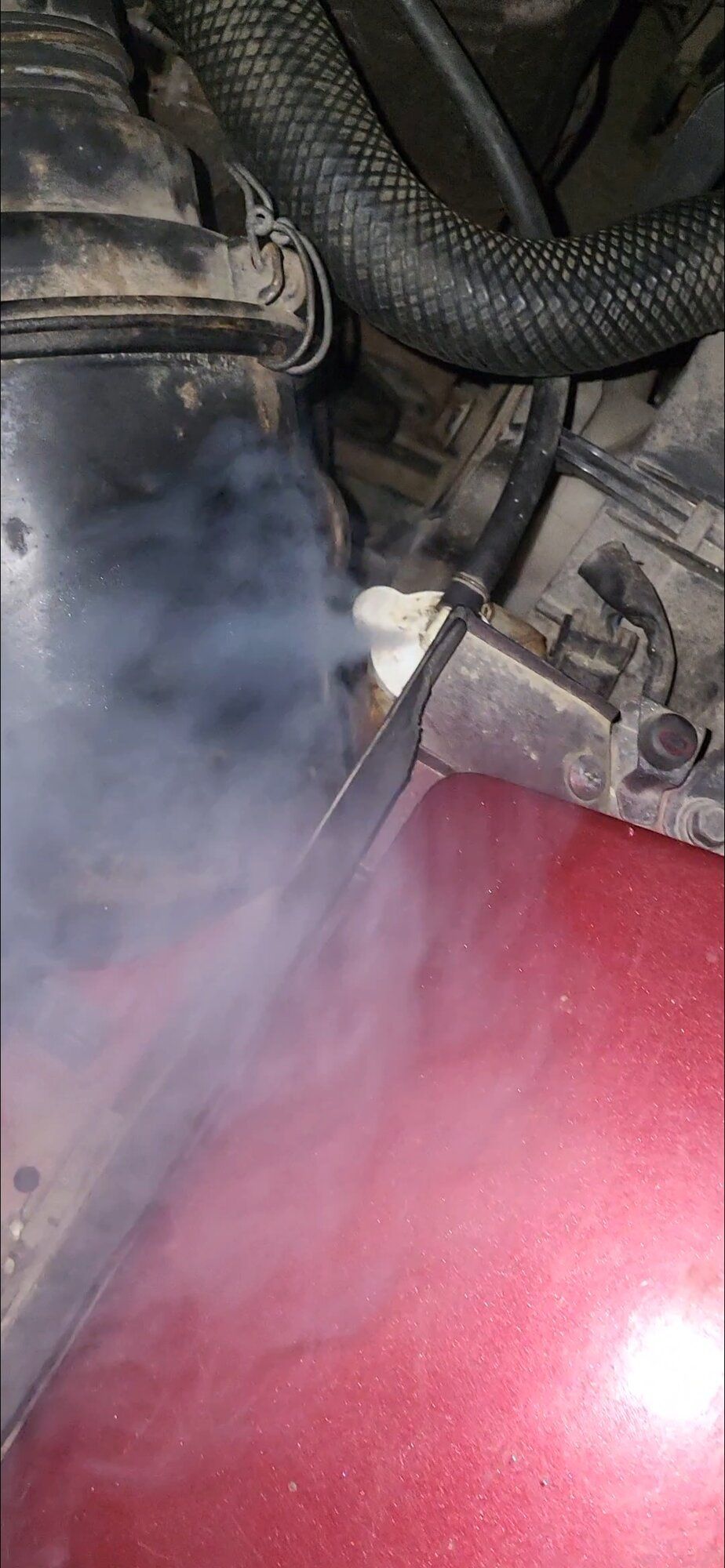

Small update, the thermostat blew up and the water started boiling, luckly it's only the thermostat and not the headgasket or something else, also I need to replace both CV axles which I can't find anywhere right now. Buuuuut besides that everything is fine🫶. I bought new wheels I'm gonna repaint it next week.
The headgasket is burned as hell guys, apparently it has been burned for the past year good thing i drove only a few times.

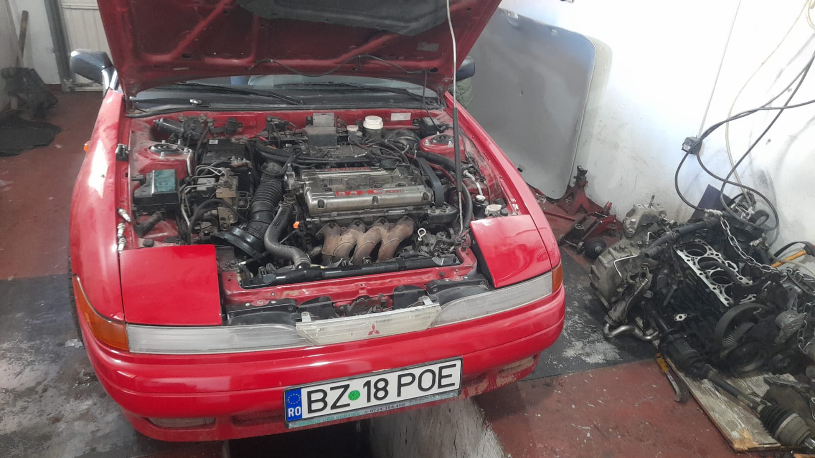

Kinda big small update, block is warped.
I'm trying to find a turbo engine and swap it in.
How do you know block is warped? Why not pull it and have it decked?
Took apart the engine to resurface the head and change the headgasket, tested the block too and the machinist said it might be to much warping to shave the block too
