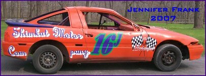

Sorry trying to deal with kids and type at the same time. i have a 90 Plymouth Laser with a 2.0 dohc non turbo engine in it. i built the car last year for circle track racing. This year they have changed the rules and i have to run a sohc engine. Was wondering if i could put a sohc 2.4 head on the 2.0 dohc engine? Or could i swap a 2.4 motor in this car. i want to stick with a 6 bolt motor but this year i really want to make the guys cry when i fly by them! Just trying to figure out what my options are. I WANNA GO FAST LOL!!!!!!!!!!!!!

I also have a 90 laser with a 1.8 in it, but i didn't know if it had any potential to kick butt also. I am running against Dodge Neons this yaer and a couple of ford probes. The neon is what won the points last year in this class. I would love to race what i have, but they have eliminated my class so i have to drop down a class. I put up a couple of pics if you go to view my public profile just so you can get a better idea of what i have.
