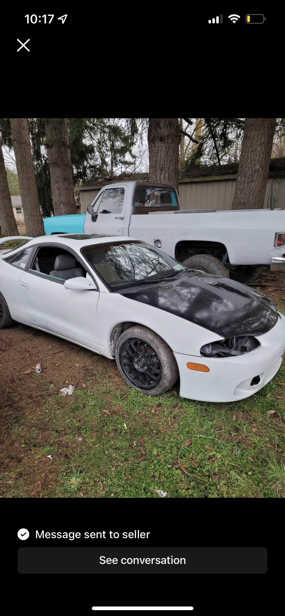

This is my very first project car I picked up when I was 19. It is a RS that I’m converting to a GSX
This is the Build Thread for 1999 RS-GSX. Reply below.
