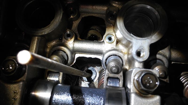

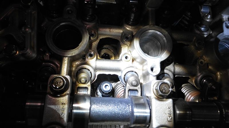

I installed ARP L19 today, one by one. torque to 90 ft/lbs.
Lubricant.
Use a wood stick to locate bolt hole.
Ready to finger tight.

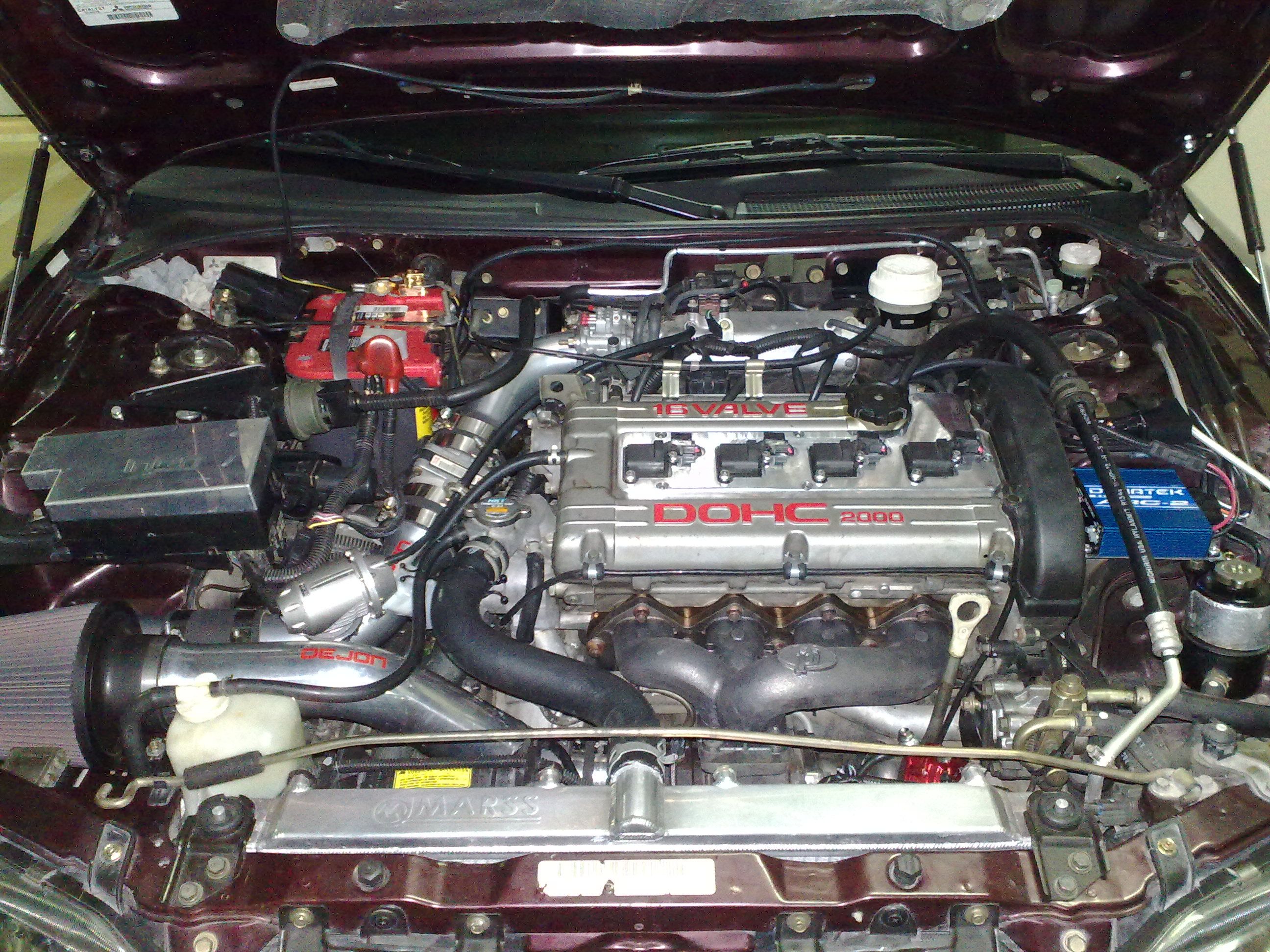

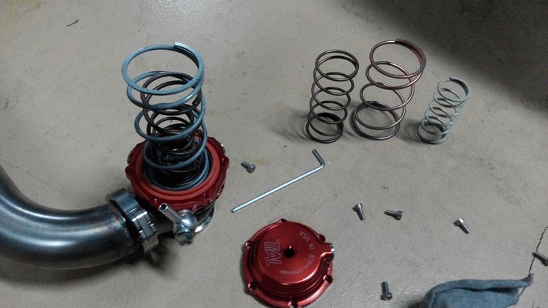

Adjust my TiAL WG to 1.5 bar, around 21.76 psi.

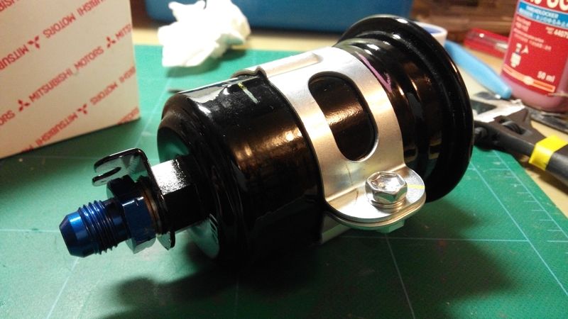

replace OEM Fuel Filter, with AN fitting.
Have to take off battery tray to access it.

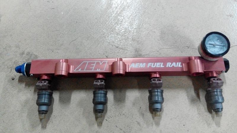

AEM Fuel Rail and EVO 560cc Injector.

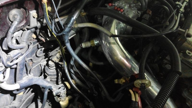

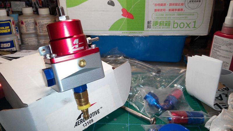

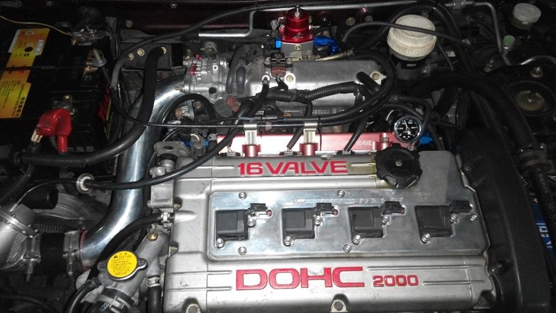

Aeromotive AFPR.
Done.
I relocate Aeromotive AFPR after this shoot, because it might hit IM.
