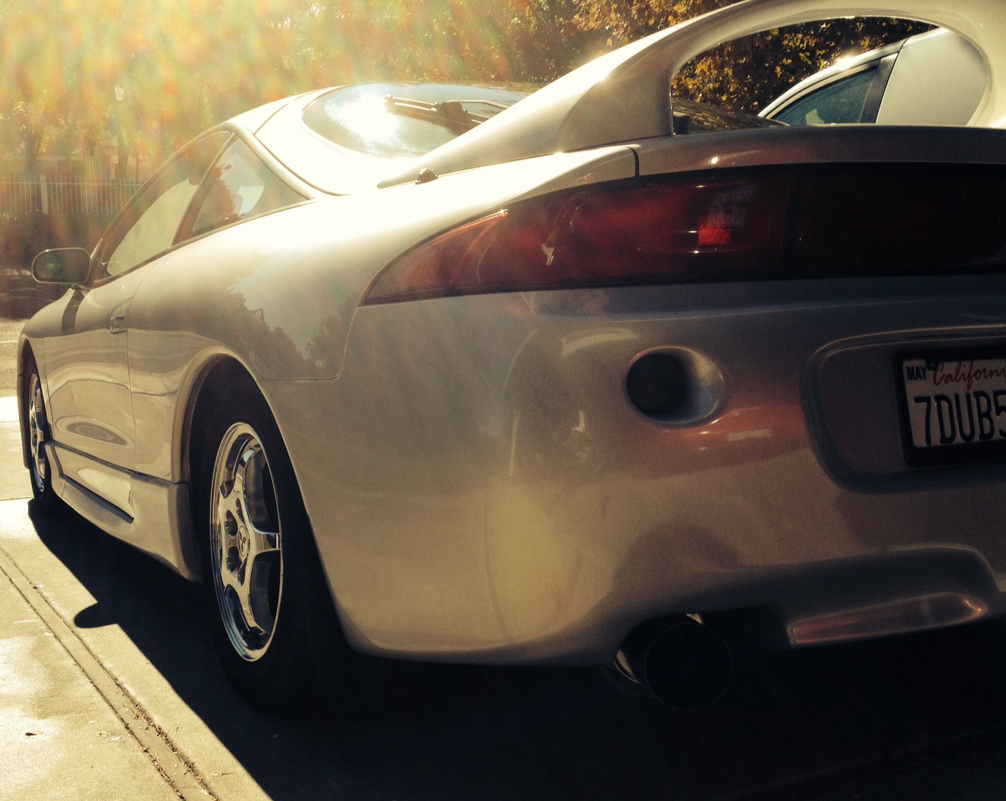

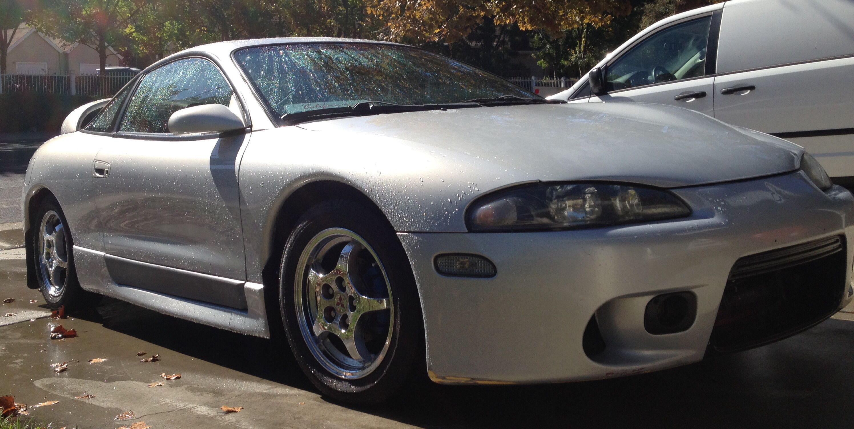

Picked up my 3rd DSM in late jan 2014 after my honda was stolen and recovered same day.
Upgraded parts since owned:
Kyb shocks
Tein S Tech springs
Street performance hawk pads
Drilled and slotted rotors
New 450 injectors

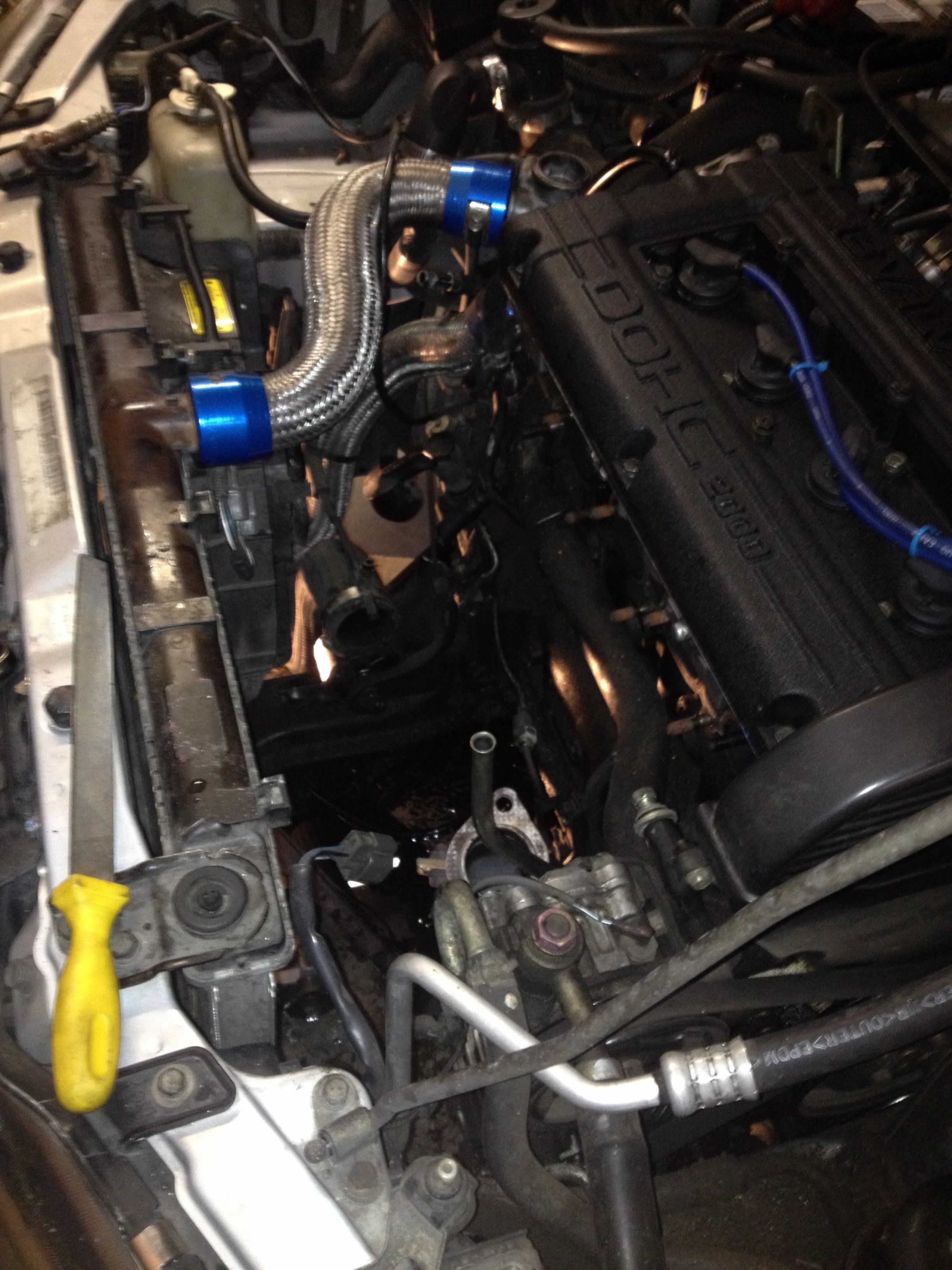

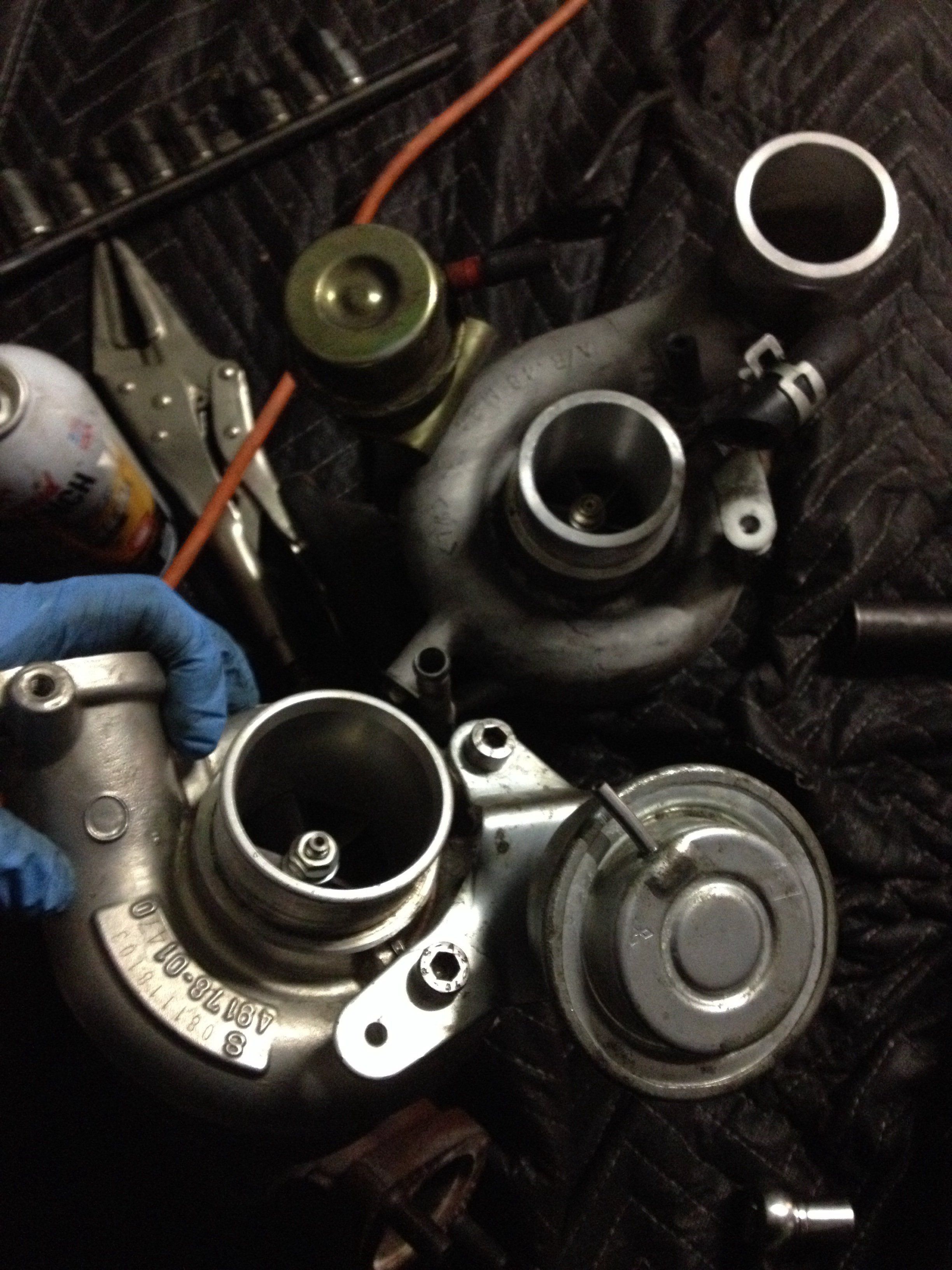

Recently purchased a Evo 3 16g turbo waiting for my forced performance install kit to come.
Other then that I been jus maintaining it regularly and trying to keep it clean
After I finish installing the turbo I'm planning on getting a Punishment Racing FMIC and upgrade the fuel system
It's a slow work in progress since I'm working 40+ hours a week but everytime I get paid I plan to buy something for my car that is needed an will help gain power!

Spend the few extra dollars and go with the VSRF FMIC kit, much better fitment and way less headaches.
Fitment for the FMIC depends all on it's size. Depending on if OP want's to cut the bumper plastics up, ditch the fog lights, or bolt and go.
28x7x2.5 Will be Ideal for a 16g
Going to big on a FMIC will hurt flow!
The most important upgrade is not listed...
Are you still using the stock 2g bov??
2g BOV is the biggest problem, stock with your 98.
Agree. don't get a huge front mount.
May want to run some bigger injectors and a walbro 255 with a Maf translator
They are super simple and can do a lot
The stock fuel pump can't really handle anything more then then the stock set up
