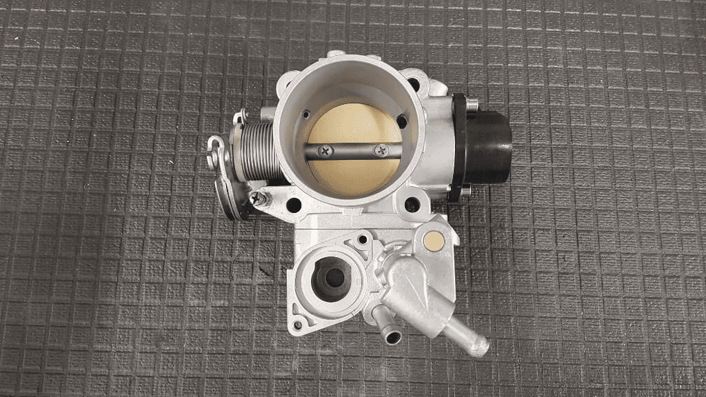

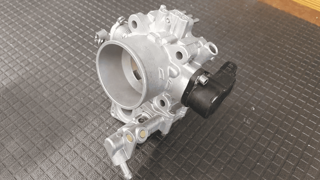

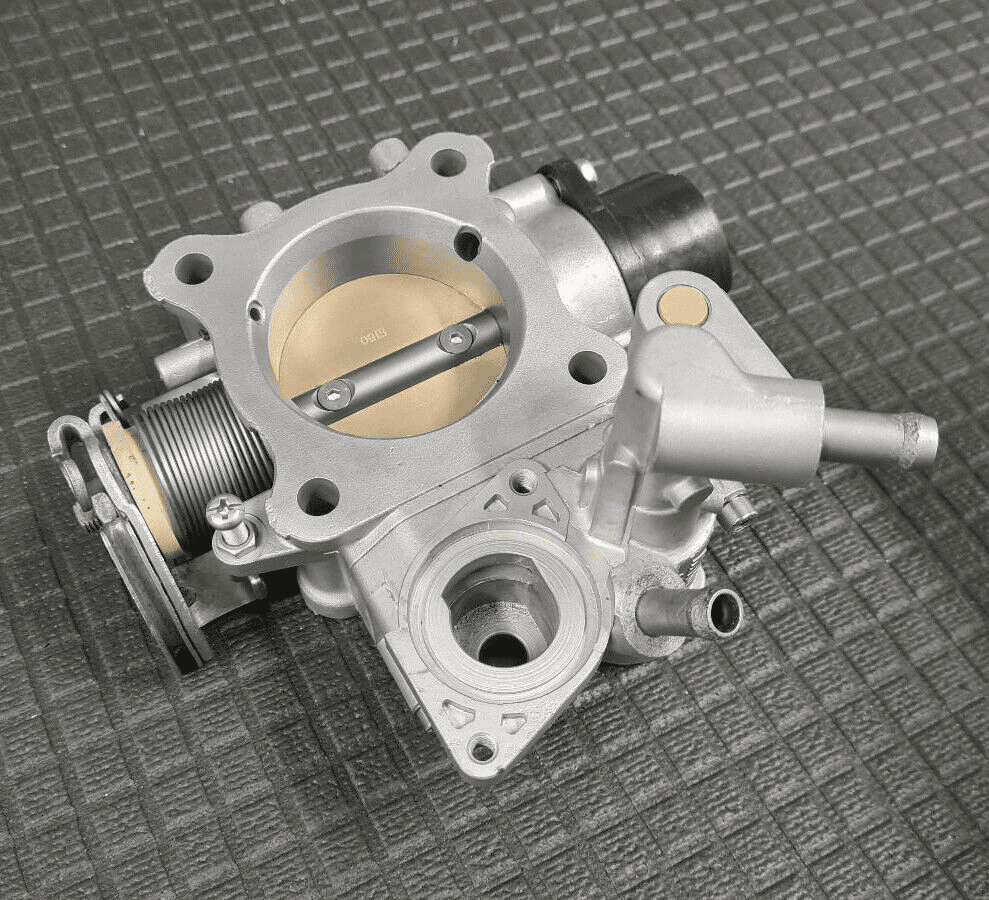

- The throttle body depends on your intercooler piping choice. If you use the intercooler piping you have in the main list you will need a GS-T throttle body for that (I have the same setup). If you go with an universal piping you can connect the GS TB with a coupler. The main difference between the two throttle bodies is that our OEM GS ones have a small pipe on them to connect to the intake with a coupler, while the GS-T ones have a flat surface, so it connects with bolts. I attached some pictures so you can see the difference:
OEM GS throttle body:
OEM GS-T Throttle Body:
