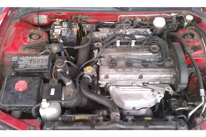

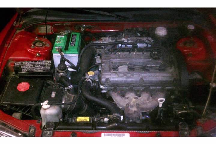

Original engine bay shot from first day owning the car:

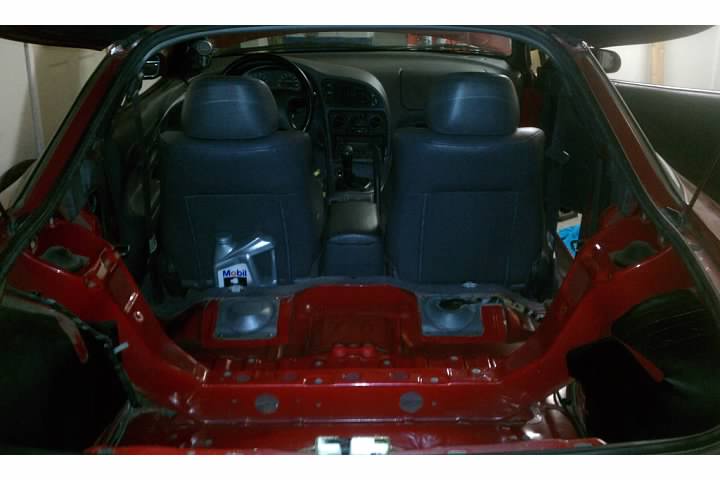

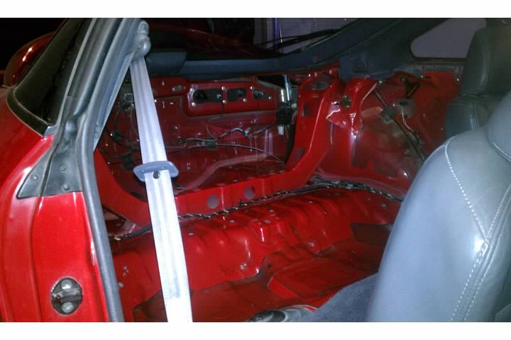

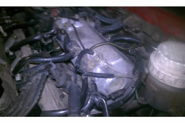

You would not believe what was under the carpet/plastic! I can't believe I didn't get a disease from sitting in this thing before this...

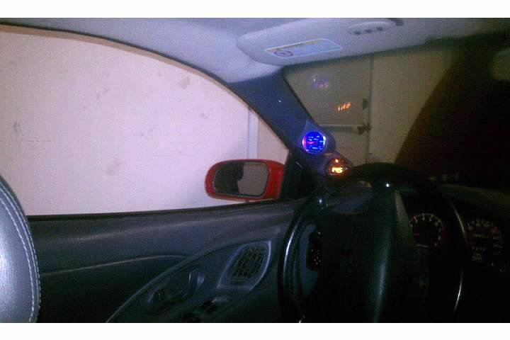

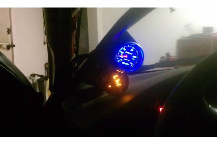

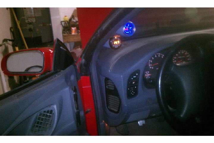

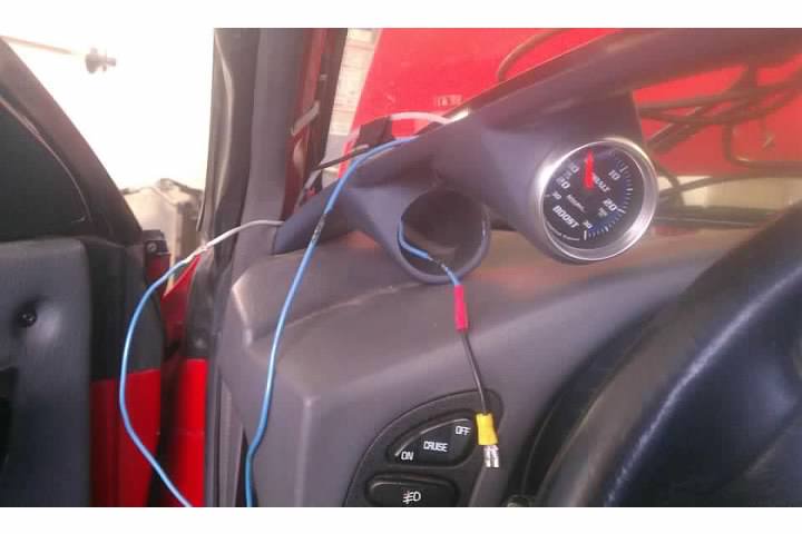

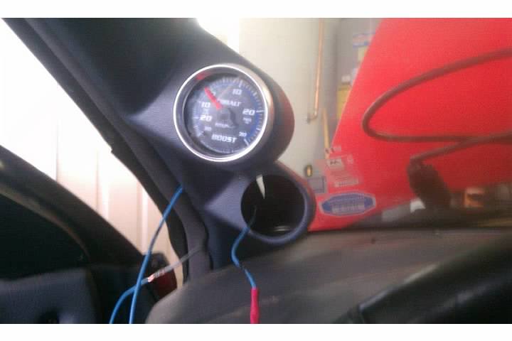

I wired the mechanical gauge to the cigarette lighter for its power and then for the wideband I tapped into the fuse panel under the dash. Grounded them both, then wired the WB to ECU pin 76.
