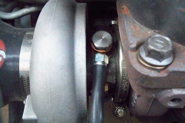

I guess it's just not getting a good seal? I took a pic of mine this morning to post up here, but never got to it. Will do in a second.
Jayson
This is where mine was leaking until I put in those two copper crush washers you can see in the pic.
Jayson

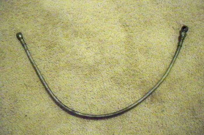

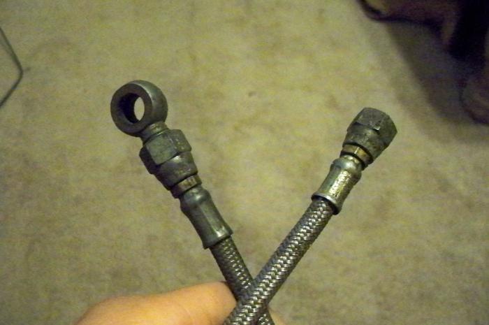

Thanks for the pic man!! What set up on the oil feed line are you running exactly? Im using the stock feed line, it screwed right into the new turbo but leaked right on start up.. the line moves up and down inside the fitting even when tightened all the way.. :ohdamn:
Oh damn that's not good haha. FP recommended it to go with the red, it's a 1g ss feed line. I have a spare that I took off when I swapped the green for the red. Not sure if it will work but its yours if you want it, just send me your shipping info :thumb:
Jayson
Oh sweet man!!! Thanks alot i really really appreciate it.. i hope it works, if i figure it out before your ss line gets here, ill ship it back to you.
Where did you hook up that female end to? Where should i hook mine up?
Also, do you have a build journal so i can subscribe and learn off your build =P
Ill pm you my info man, thanks again!! :thumb:
