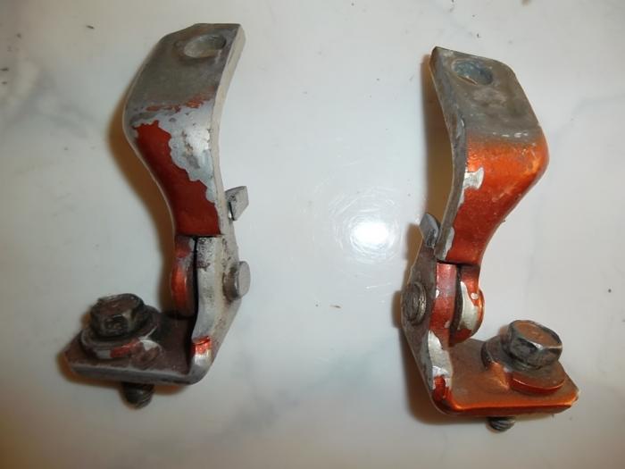

Lightened the doorhinges a "little" :)

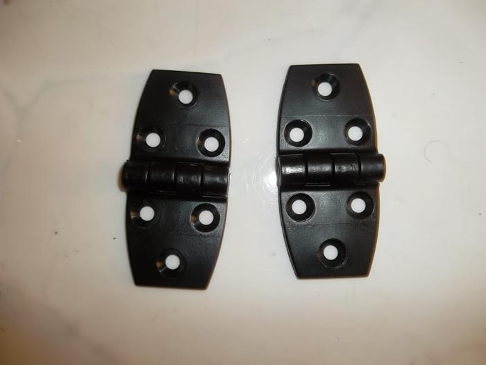

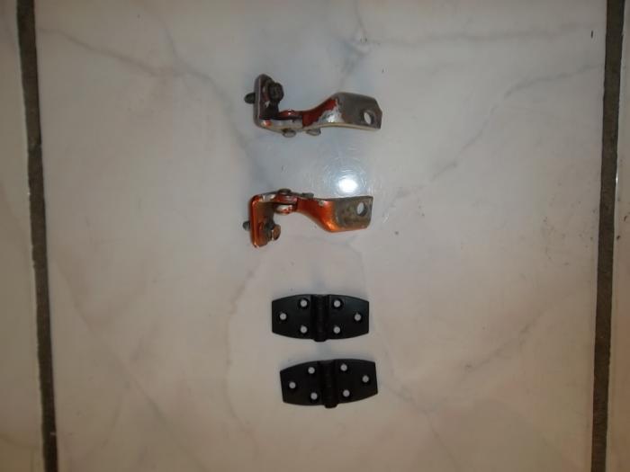

I cut my hinges in half, and using the top half, of the upper hinge, and the bottom half of the lower one, but now I am trying a set of marine hinges on the passenger side, they are plastic, I will have to do some adapting to them.
You could still cut yours in half.
I am now looking at a marine one that comes in 2 pieces, and all you would have to do is lift the door and the door will come off, easier to work inside car.
Nice work.
Sound great, but could you please show me a picture:

front doorhinges... :)
I´d love to see those marine-hinges also.

Here are a couple of pics, the one I mentioned that you can just lift the door up, I dont have it here.
Well for some reason I cant upload the pics. giving me file error.
