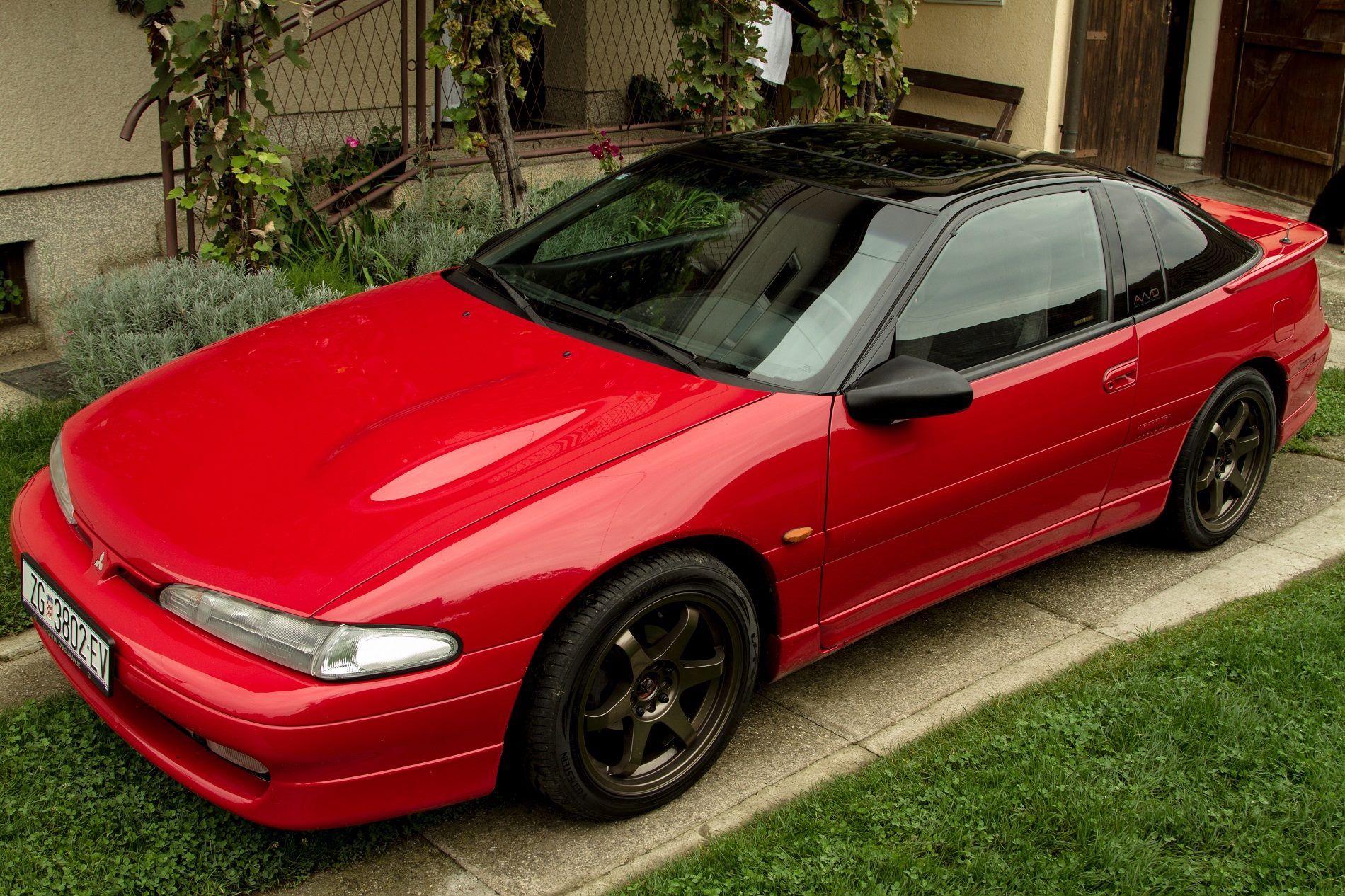

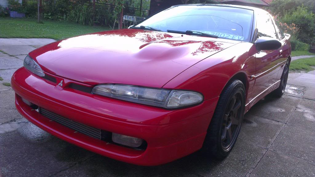

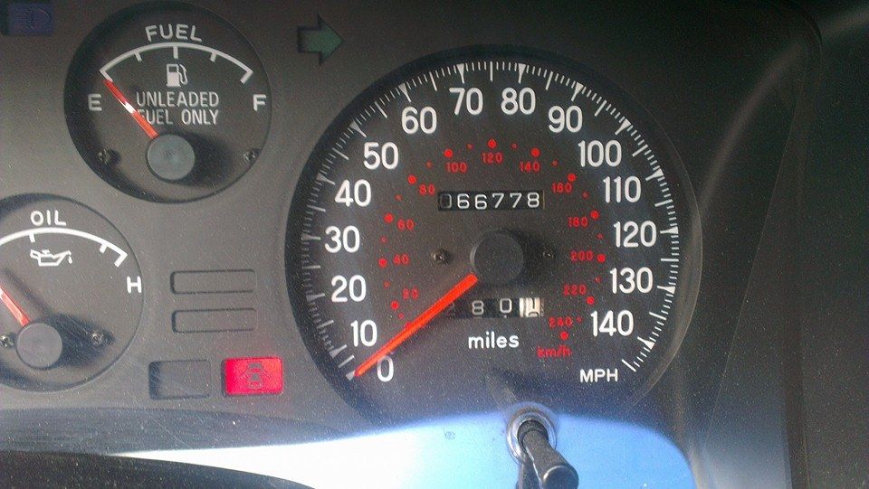

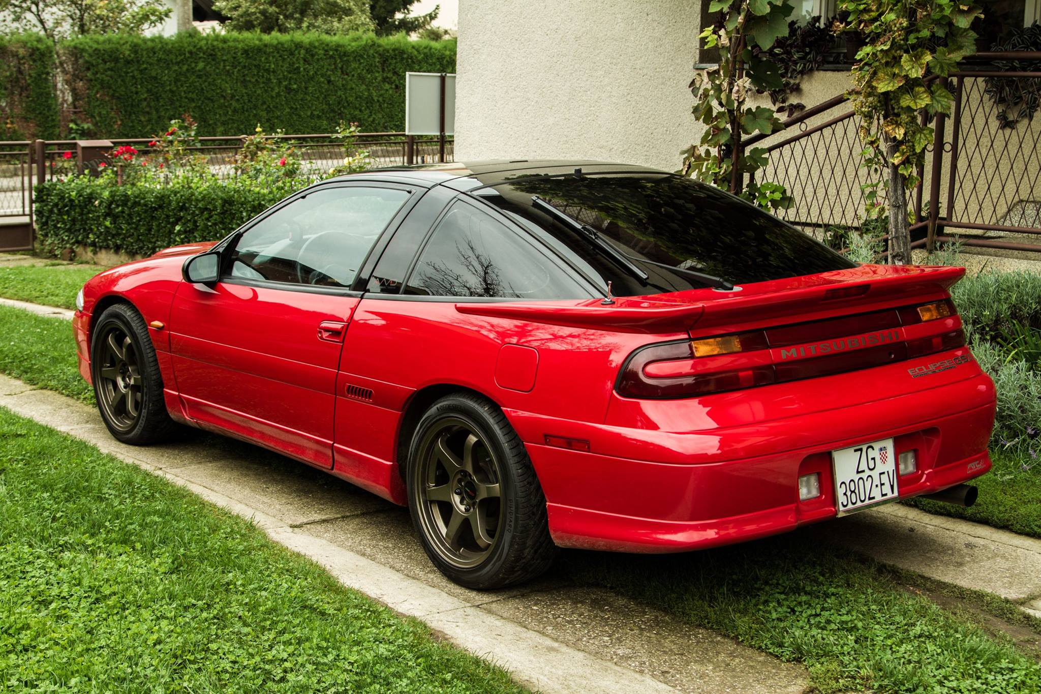

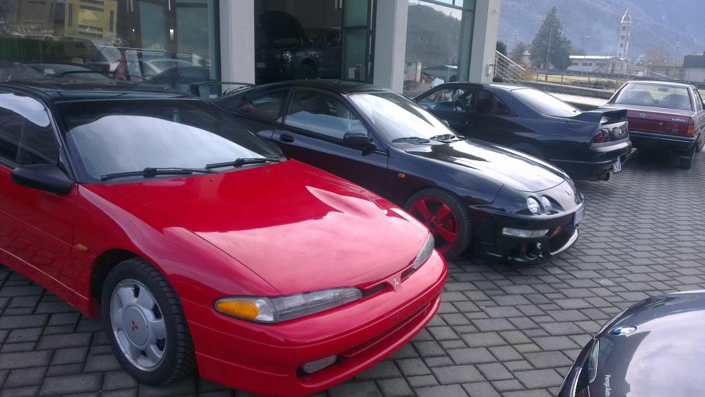

I found 1GB GSX in Italy. Ad said it only had 66.000 miles and on the pics it looked very good.

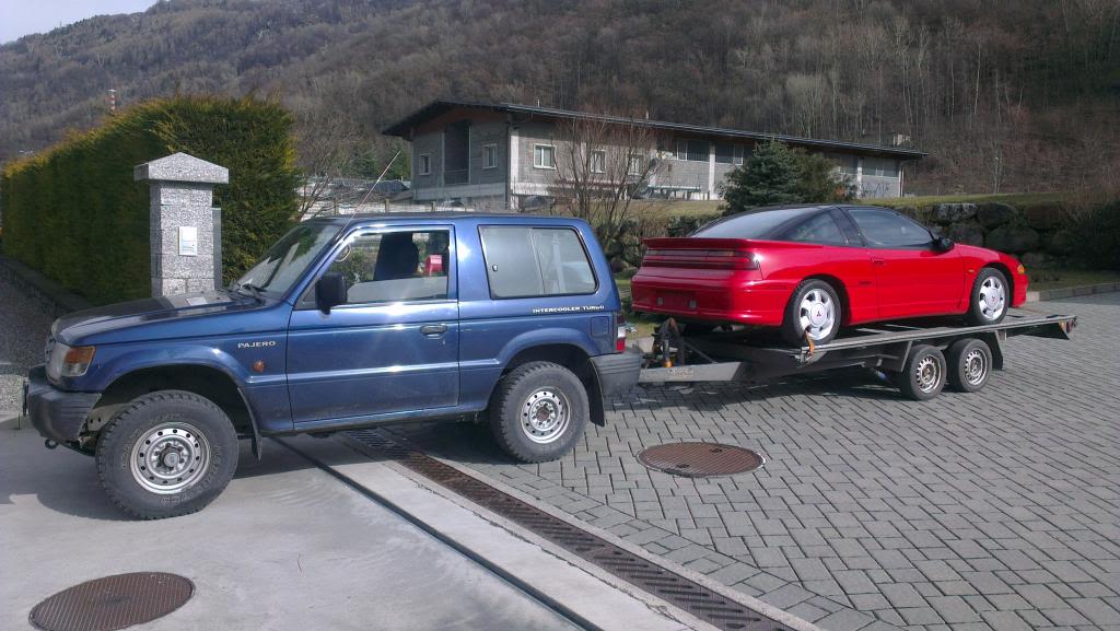

We decided to take a road trip to Italy to take a look at it. The trip was 1000 miles long.
When I sow her in parking lot I said, there goes my money.
We inspected her and there was few issues, like broken water cooler, rear springs were not the same, bad seal on transfer case, nothing to big.
Oh yes, and the engine was 6 bolt, 4 bolt rear LSD diff and 23 spline transfer case.

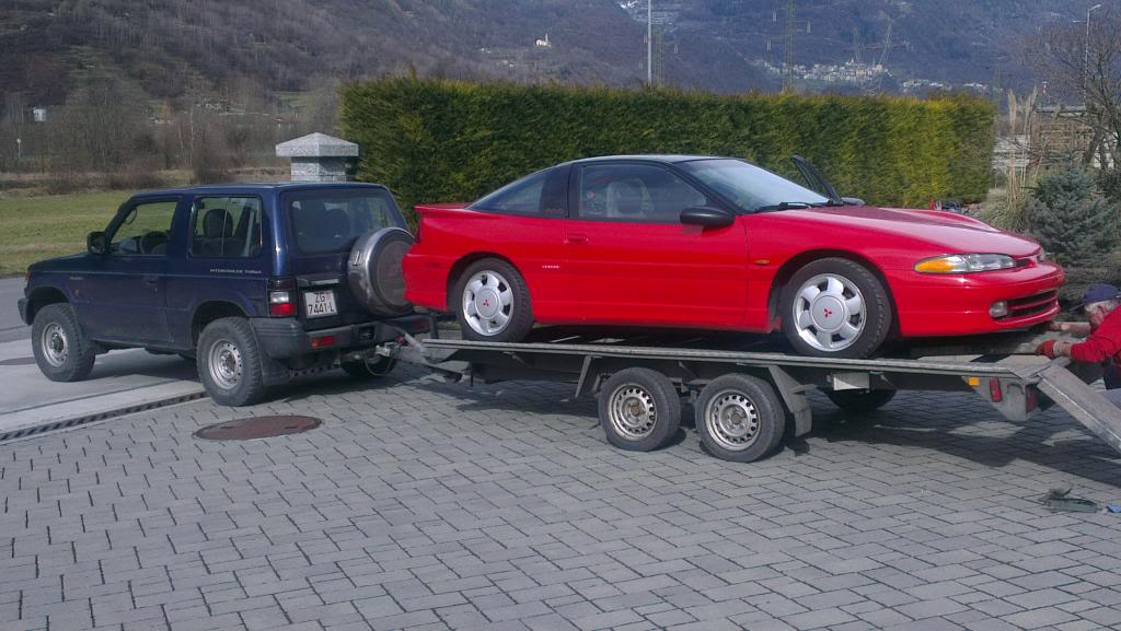

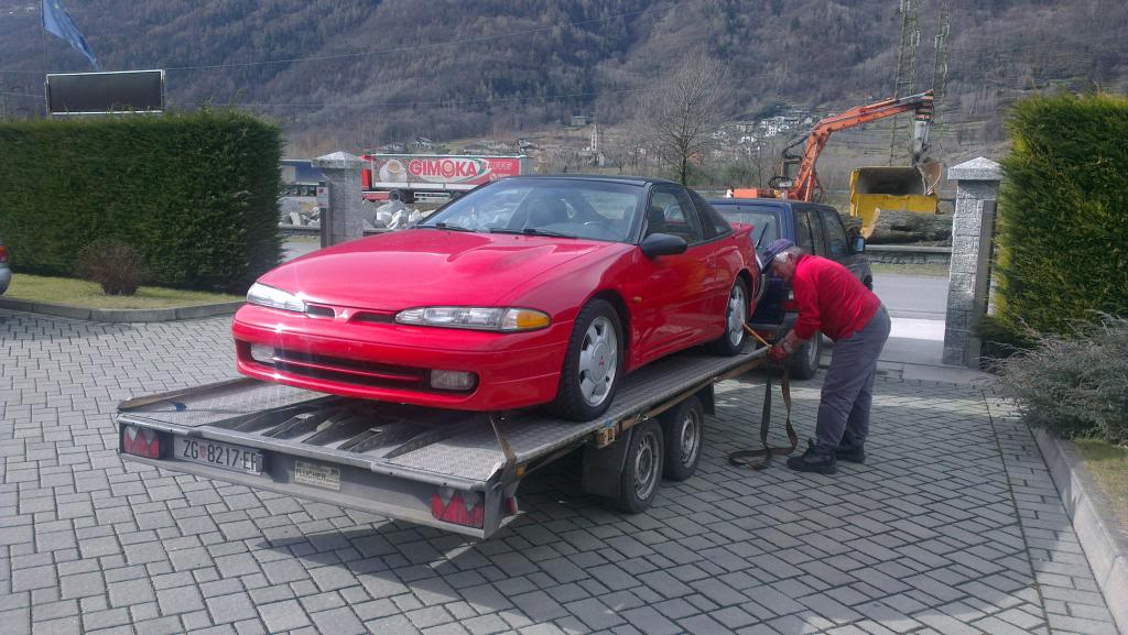

When we got back to Croatia I gathered the money and head back with transport to get it.
Here are some pic how she looked when we came to pick her up.

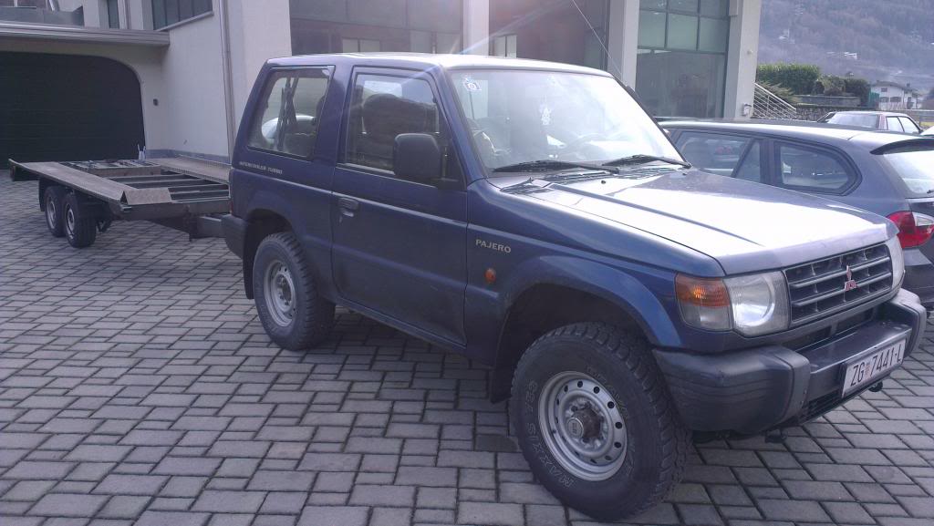

Our transport Mitsubishi Pajero.. I will never do that again, that was most uncomfortable trip ever..

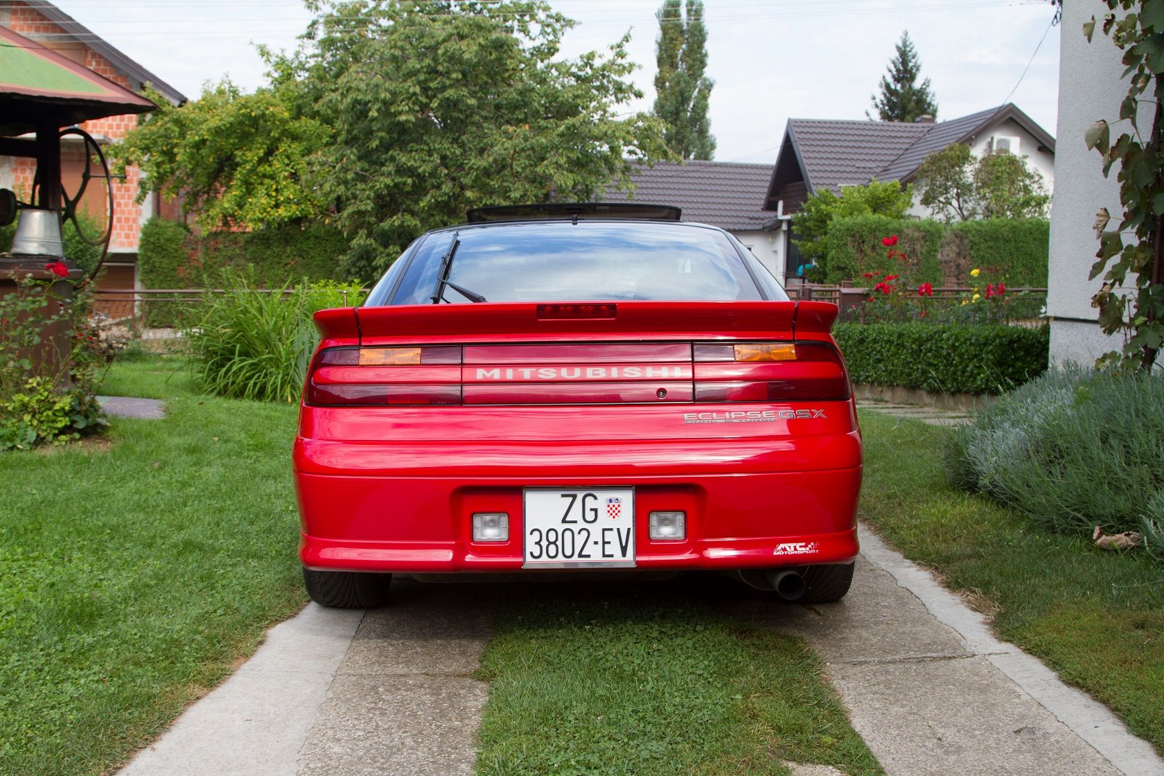

Then we had some papers problem.

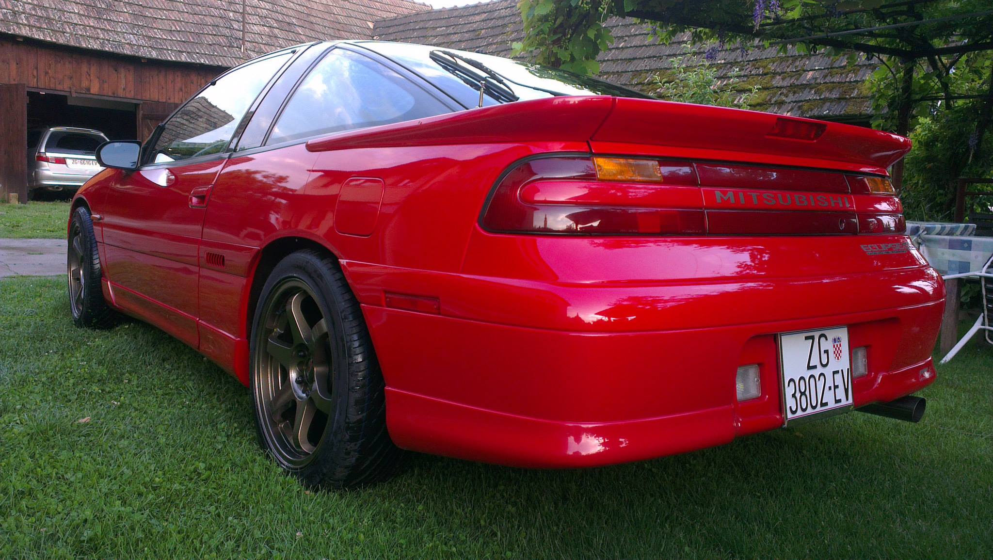

When they imported it new from Florida to Italy in 92 they couldn't register it here because of the red rear blinkers. They had to be orange.
So they cut!!!! the rear lights and put some orange inserts in ti. :ohdamn::ohdamn:
Also added some ugly orange ones on front side of the car.
When they did that they change the car VIN number because it had modifications.
New VIN number was stamped into right strut (don't know if that is the right word) and it looks like the kids were playing with it.

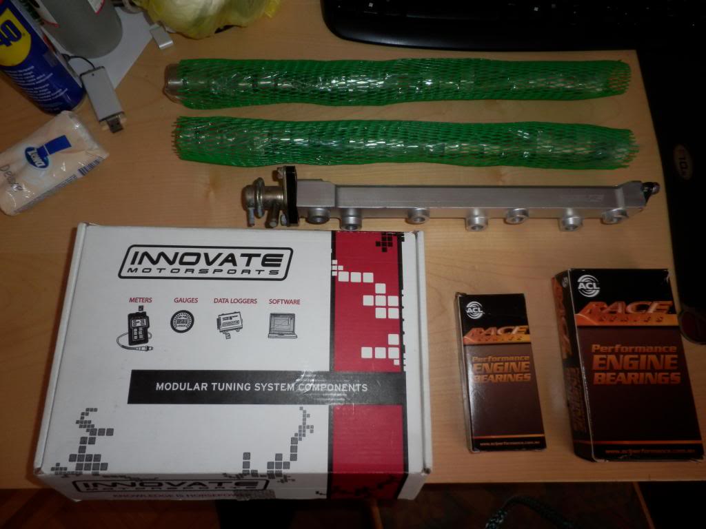

Here are some of them.
TZ-Series Kevlar Clutch.

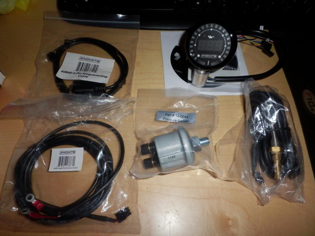

GSC Powerd Division S1 cams, OBX fuel rail, ACL Race bearings, i Innovate MTX gauge.

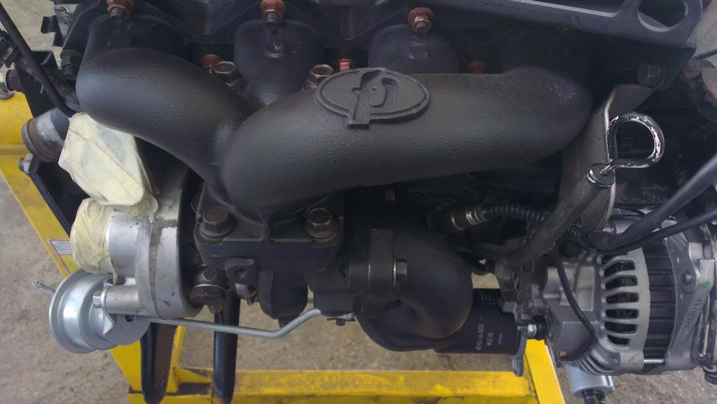

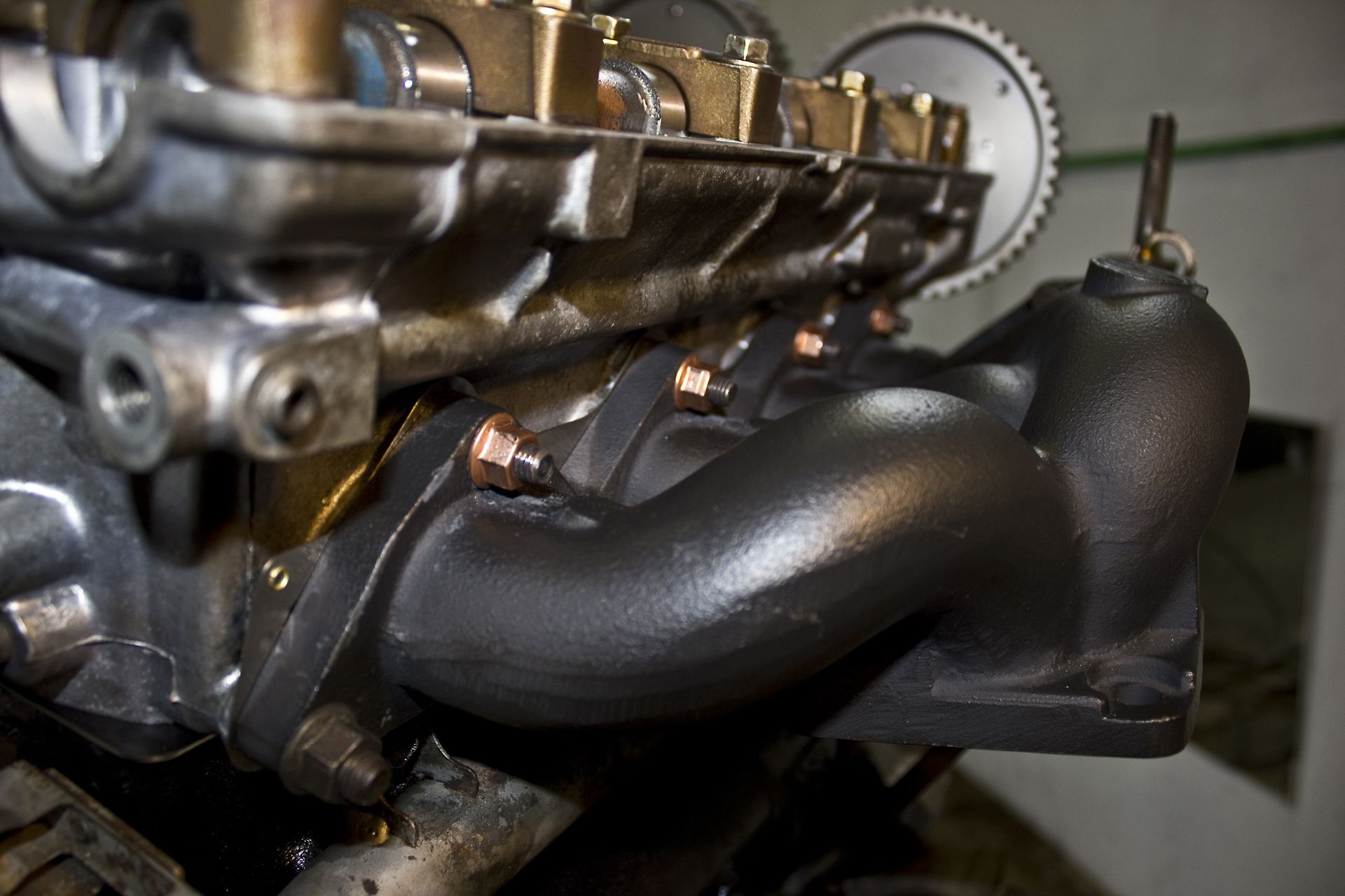

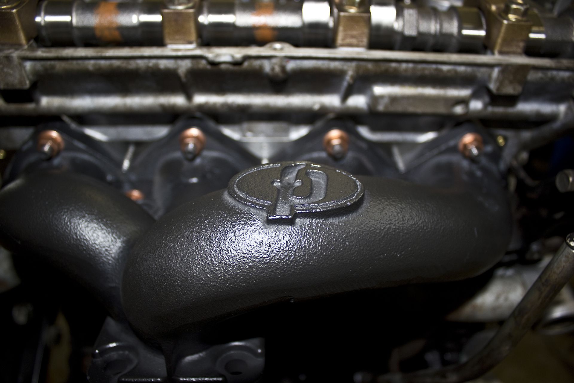

Few dark parts :D Forced performance 68HTA turbo and exhaust manifold with EVO 3 O2 housing, all coated.

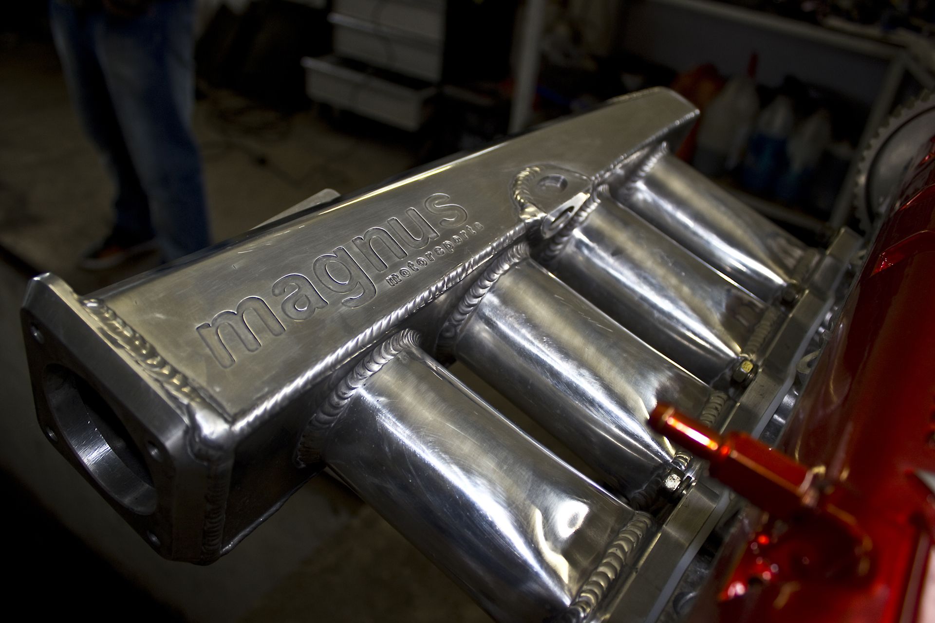

Magnus intake

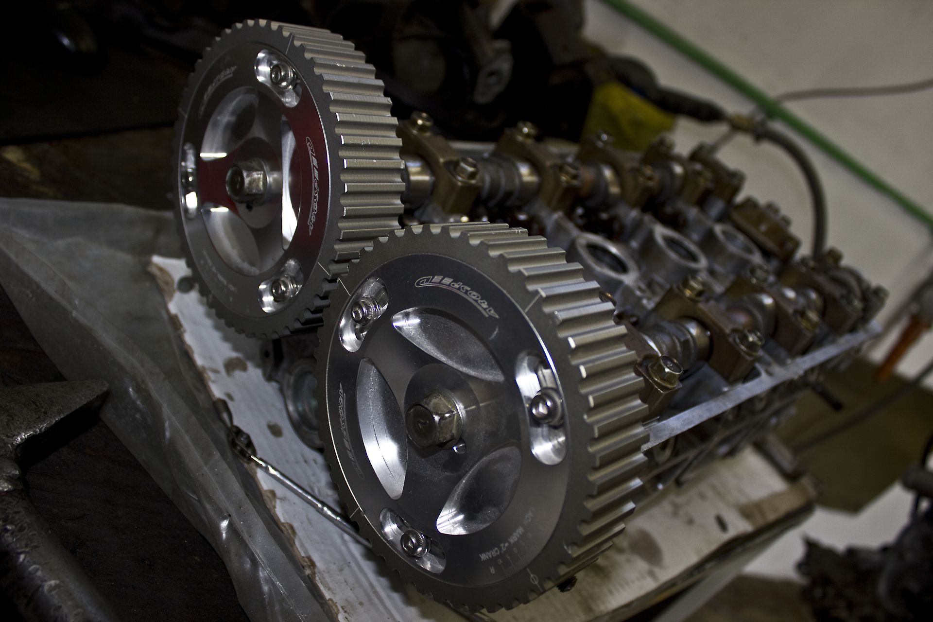

There are more parts like 255 FP fuel pump, aeromotive AFPR, ARP head studs, adjustable cam gears..

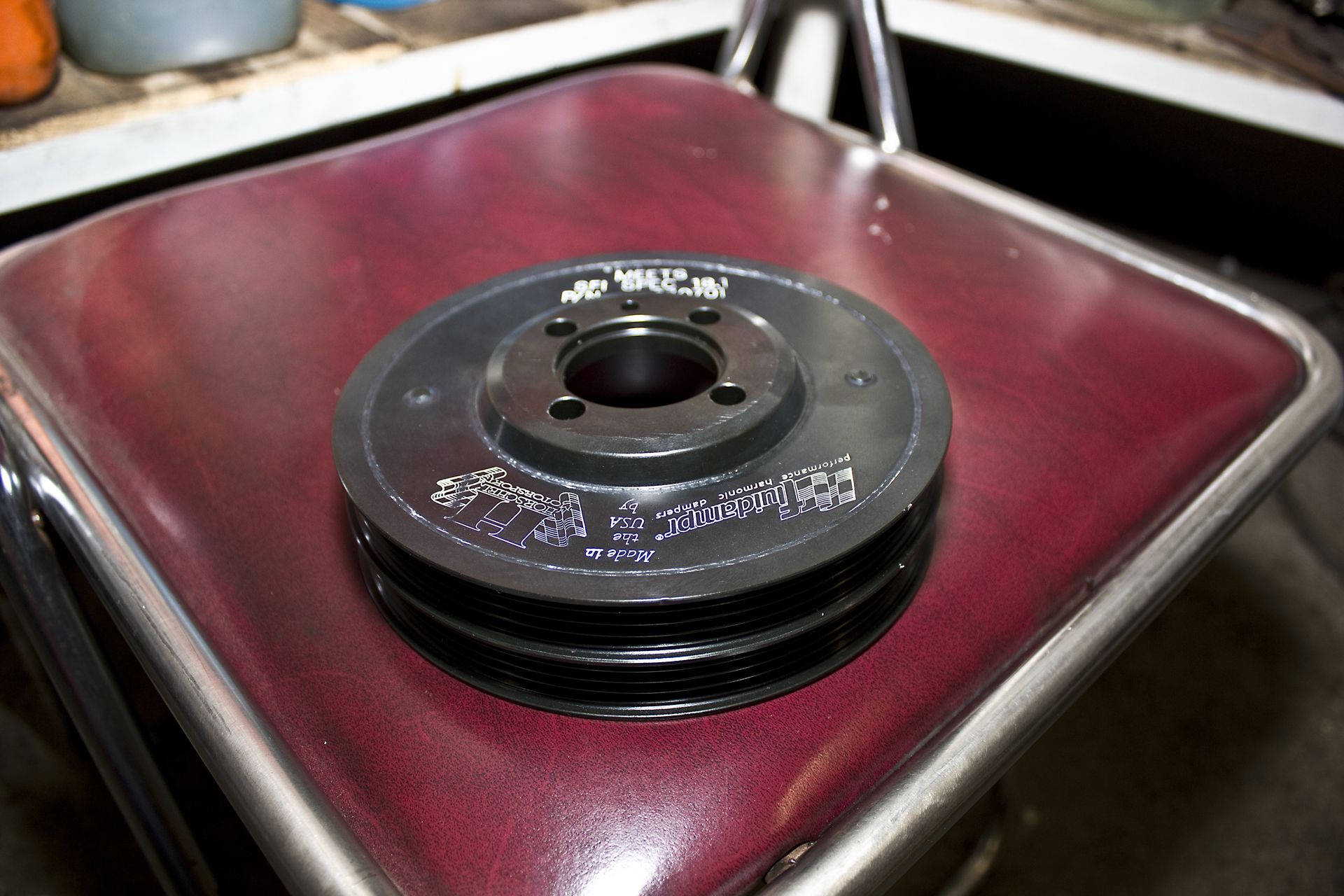

AWD Fidanza flywheel and fuildampr are on the way from US so I don't have pic from them.

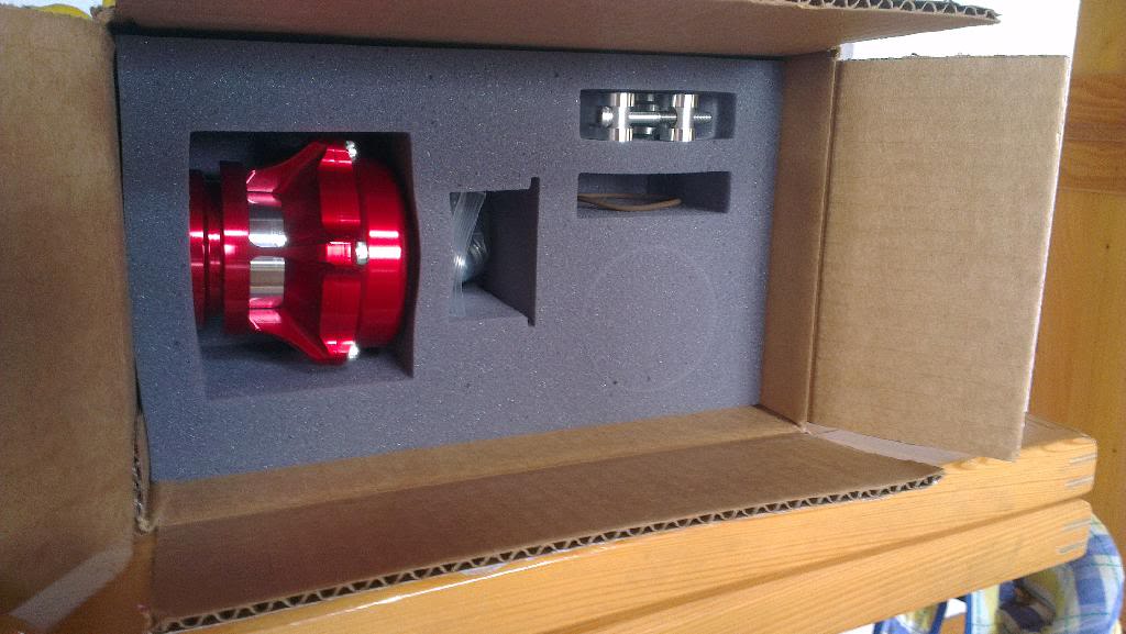

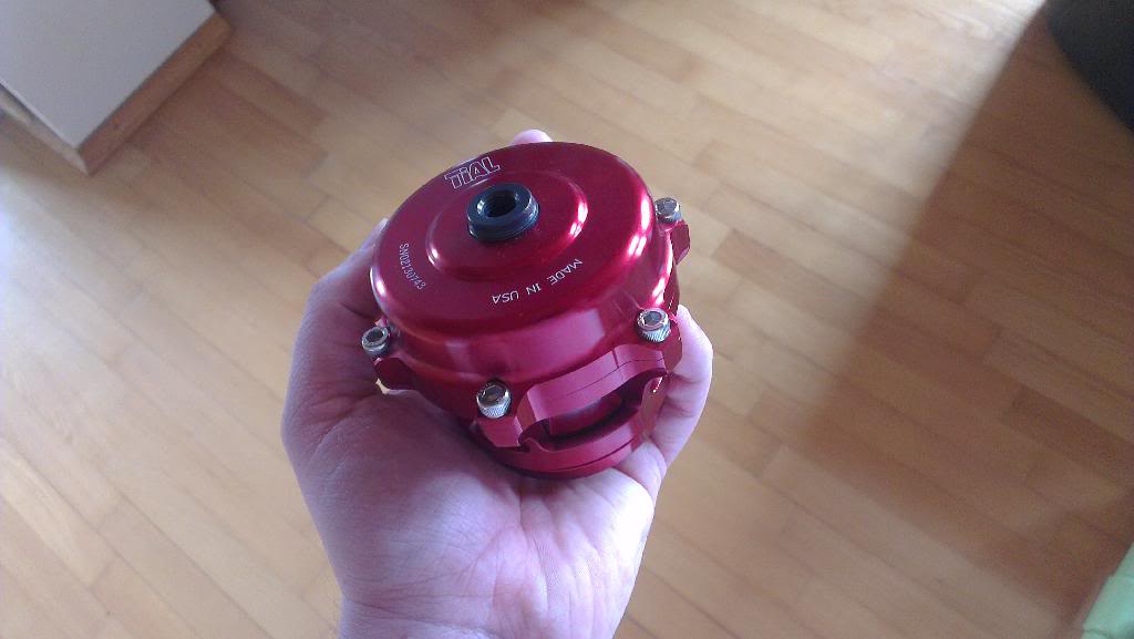

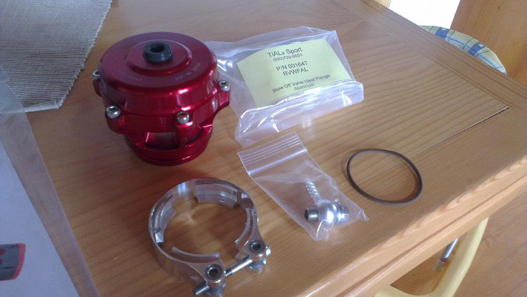

Few days ago Tial Q bov arrived from Germany.

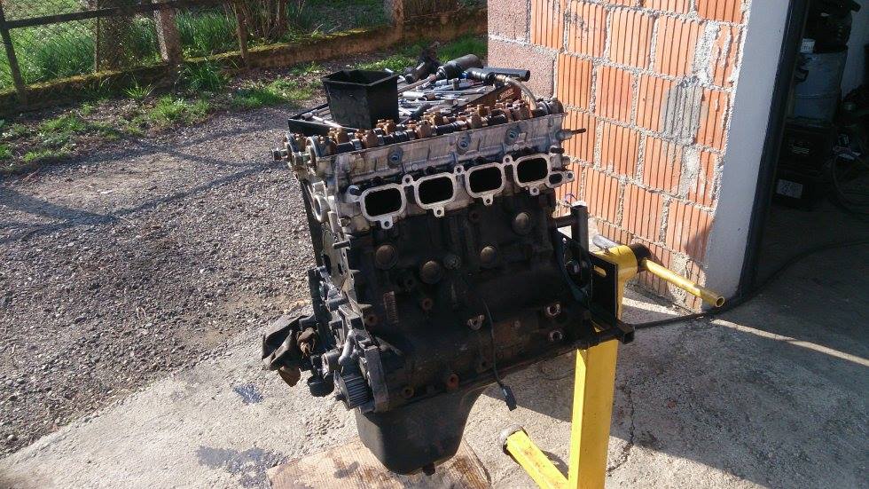

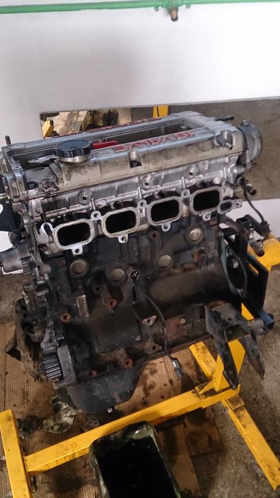

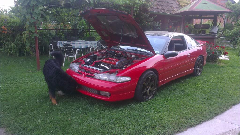

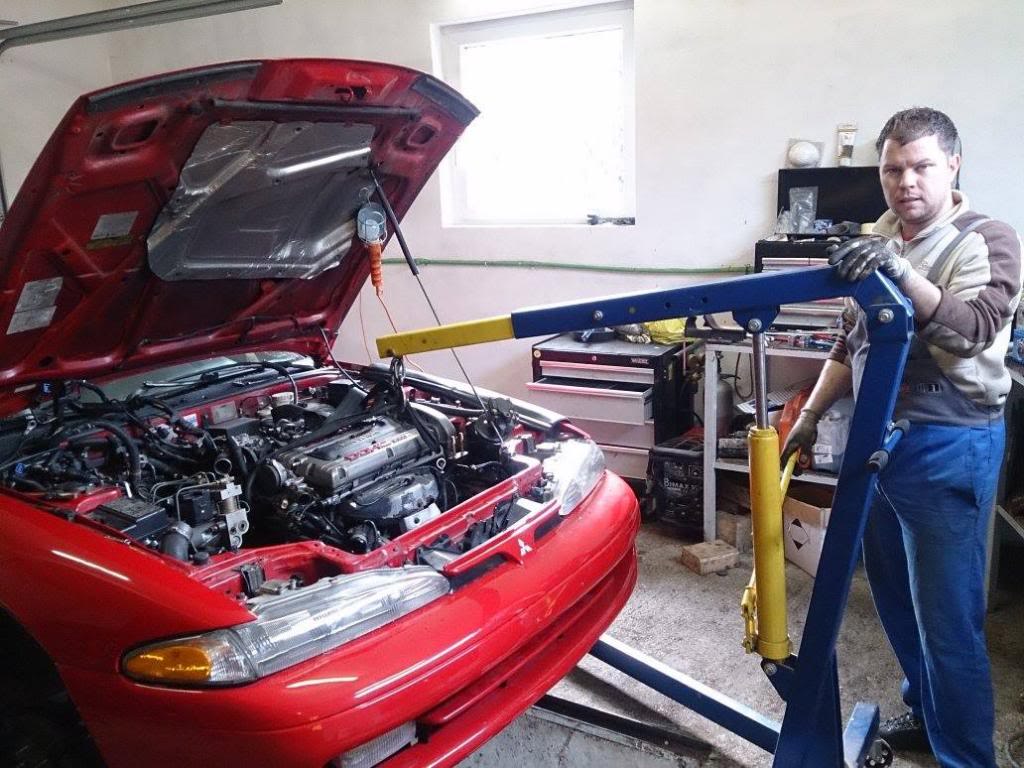

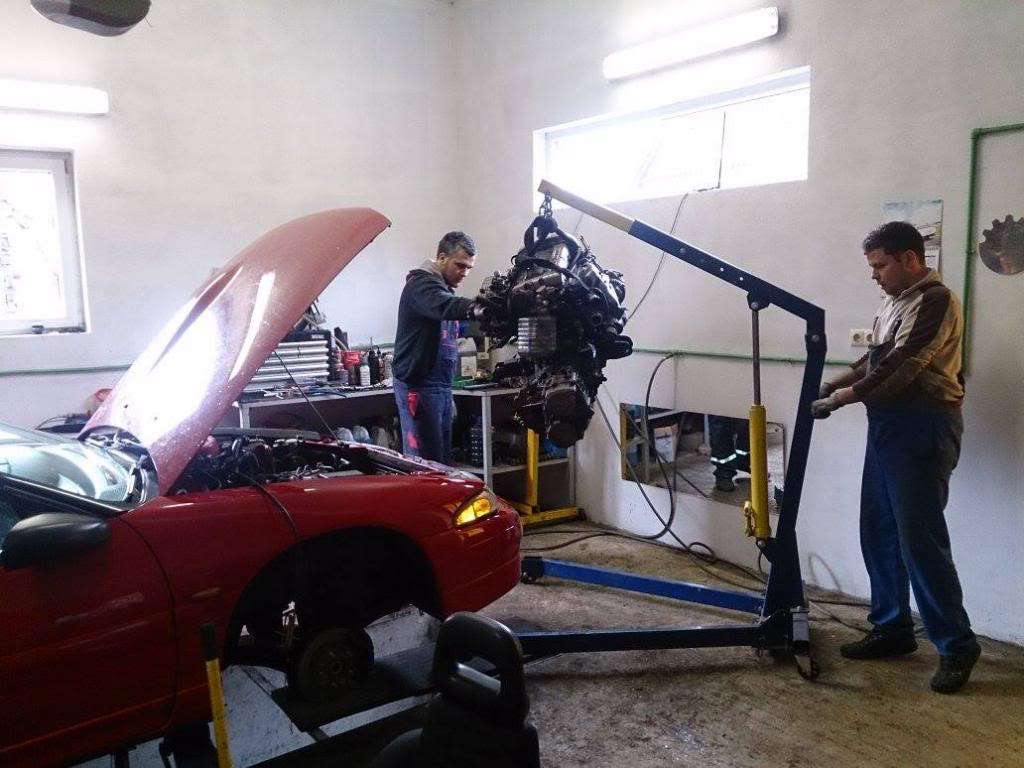

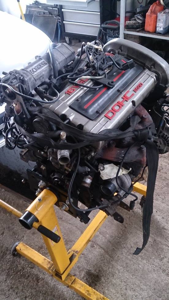

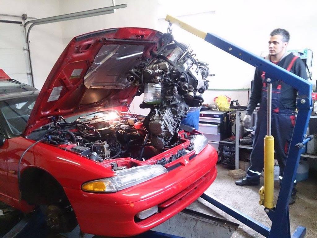

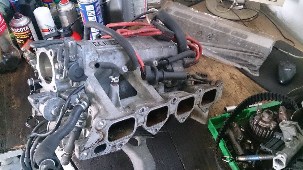

Here are the pictures from taking out the engine.

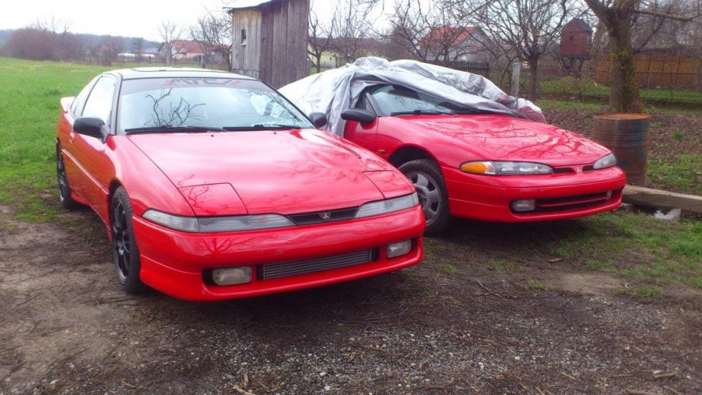

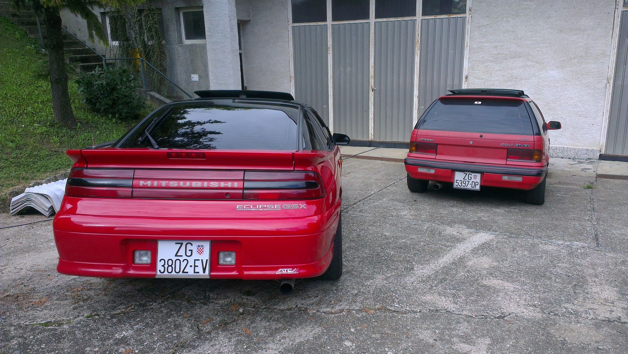

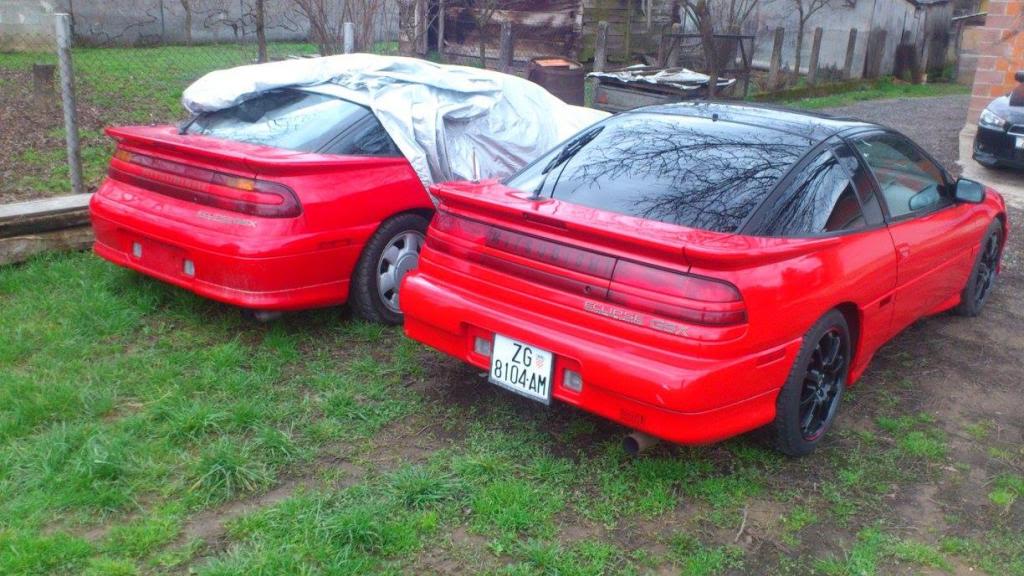

Here are the Pictures with Flashback's Eclipse. Two sisters, the only one in Croatia :)

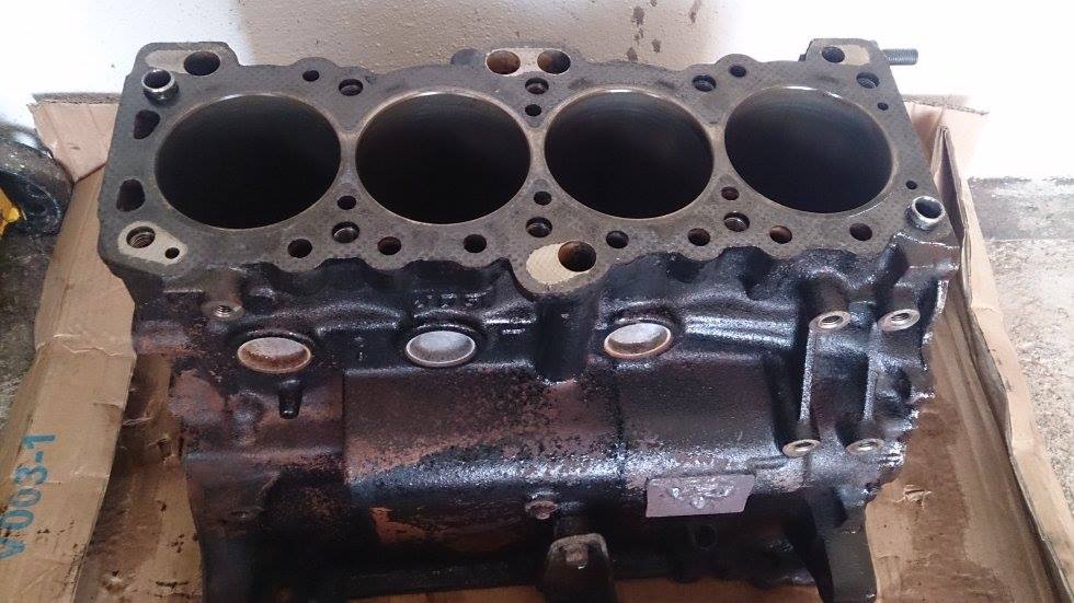

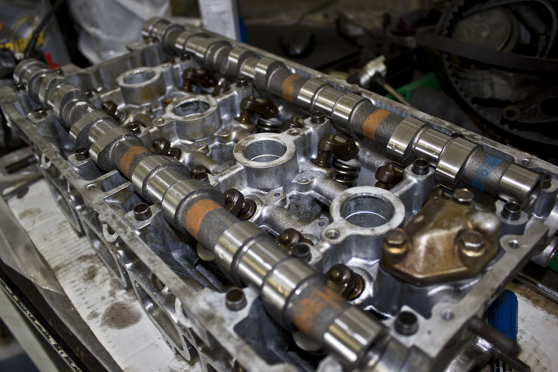

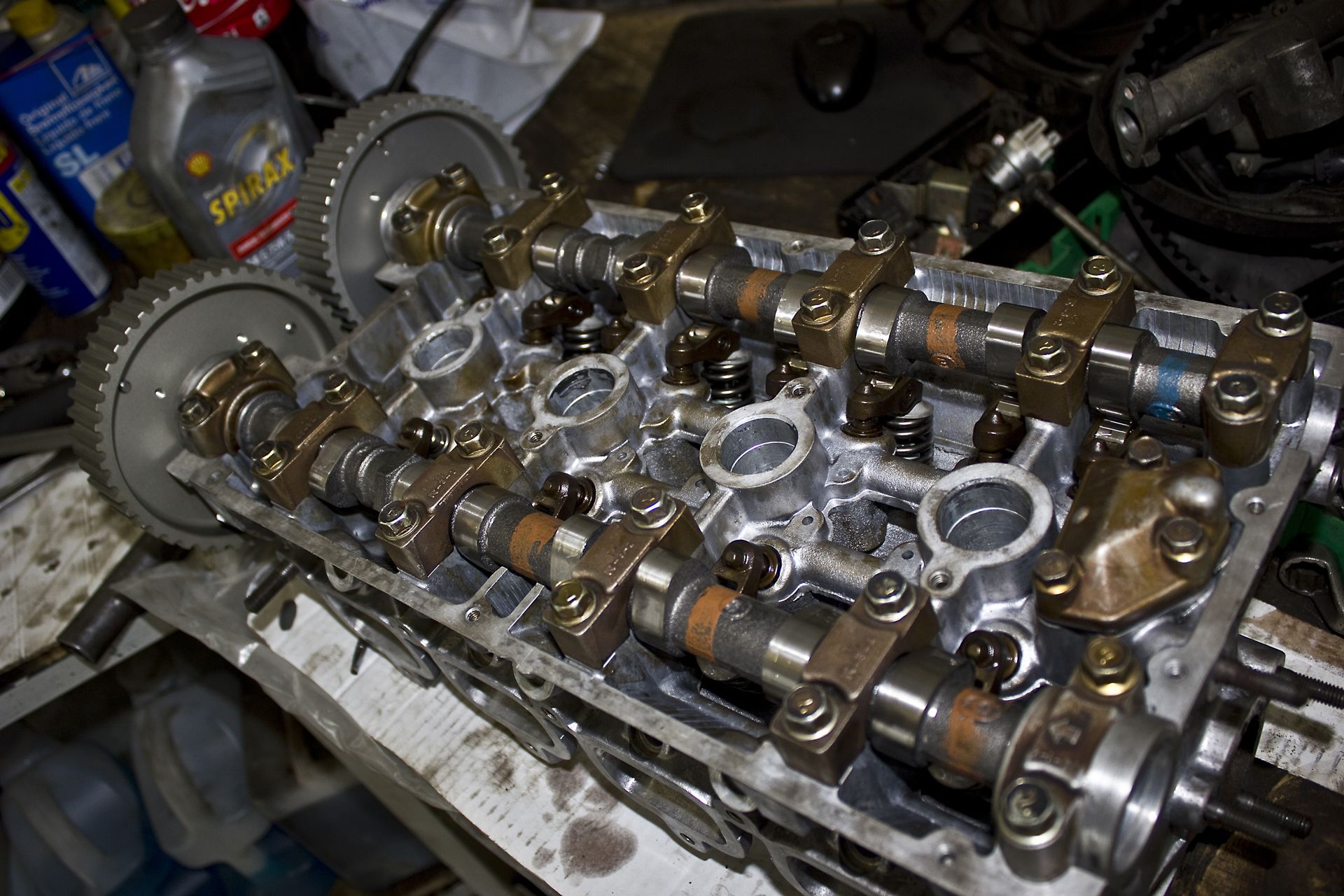

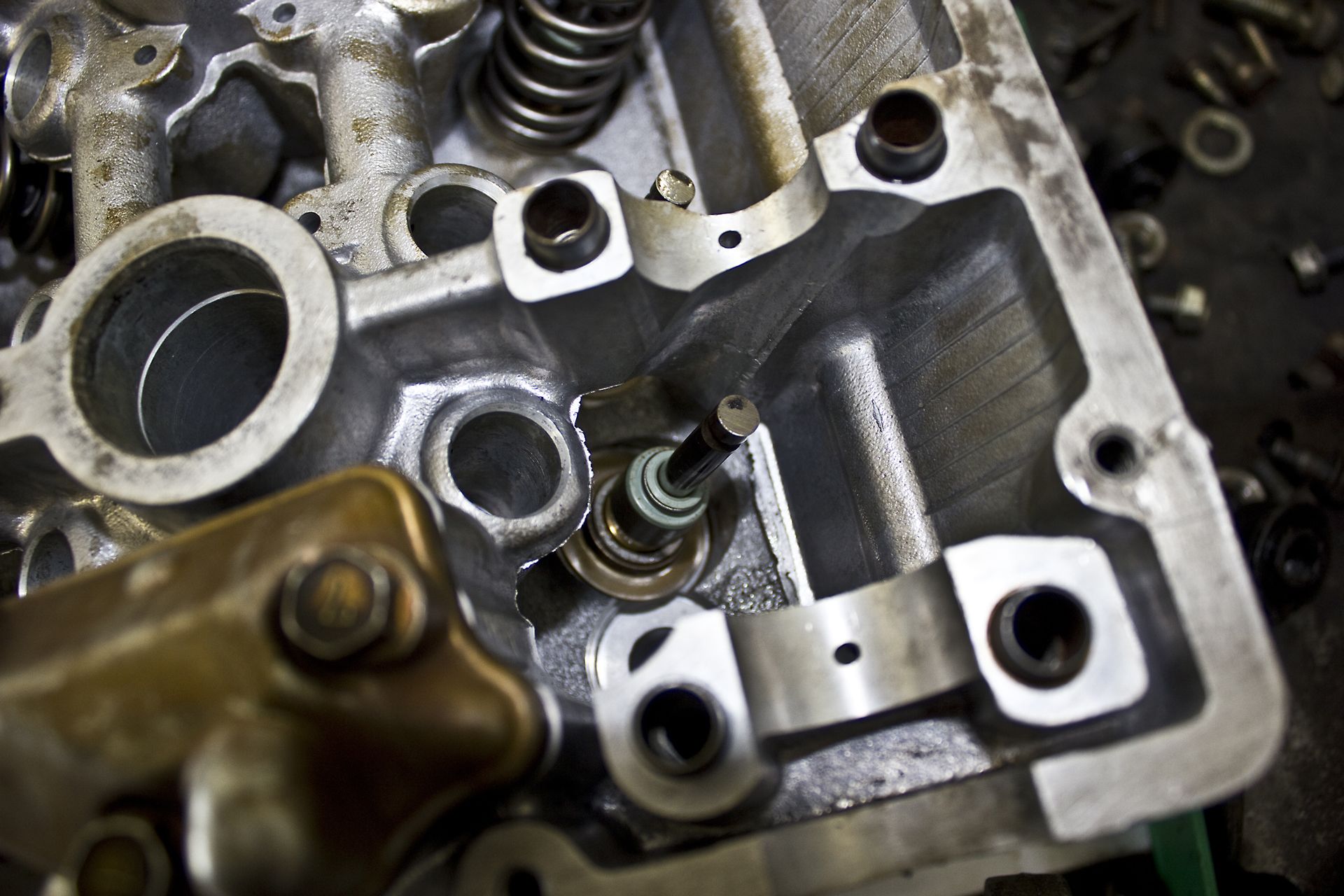

Now the pictures from stripping down the engine.

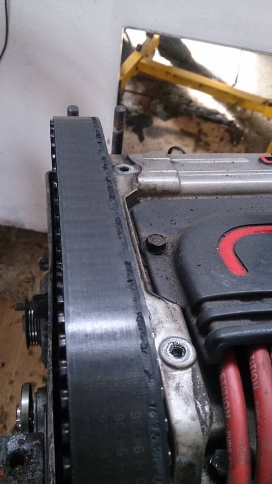

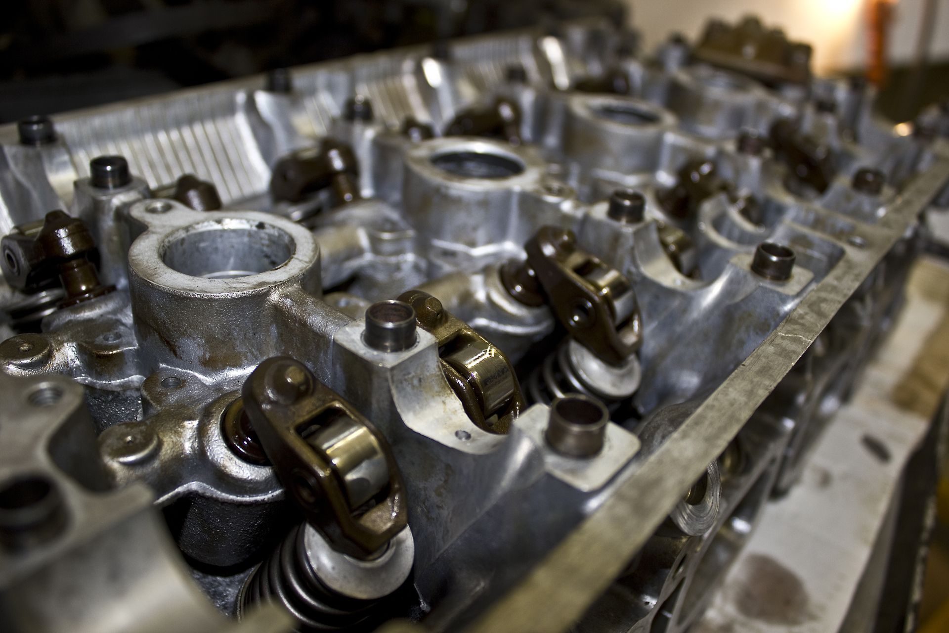

Then the first shock came. When we took down the cam gears cover we sow this..
Something must have been scraping the belt, but we didn't find any trace what could it be.

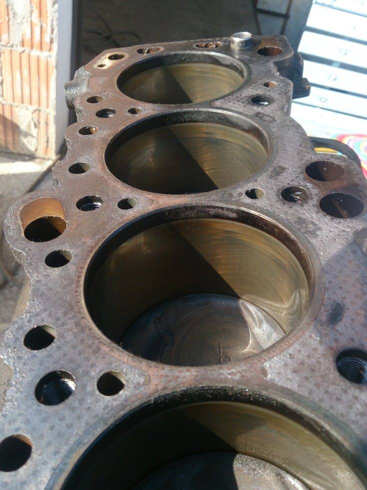

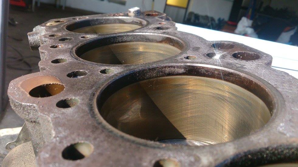

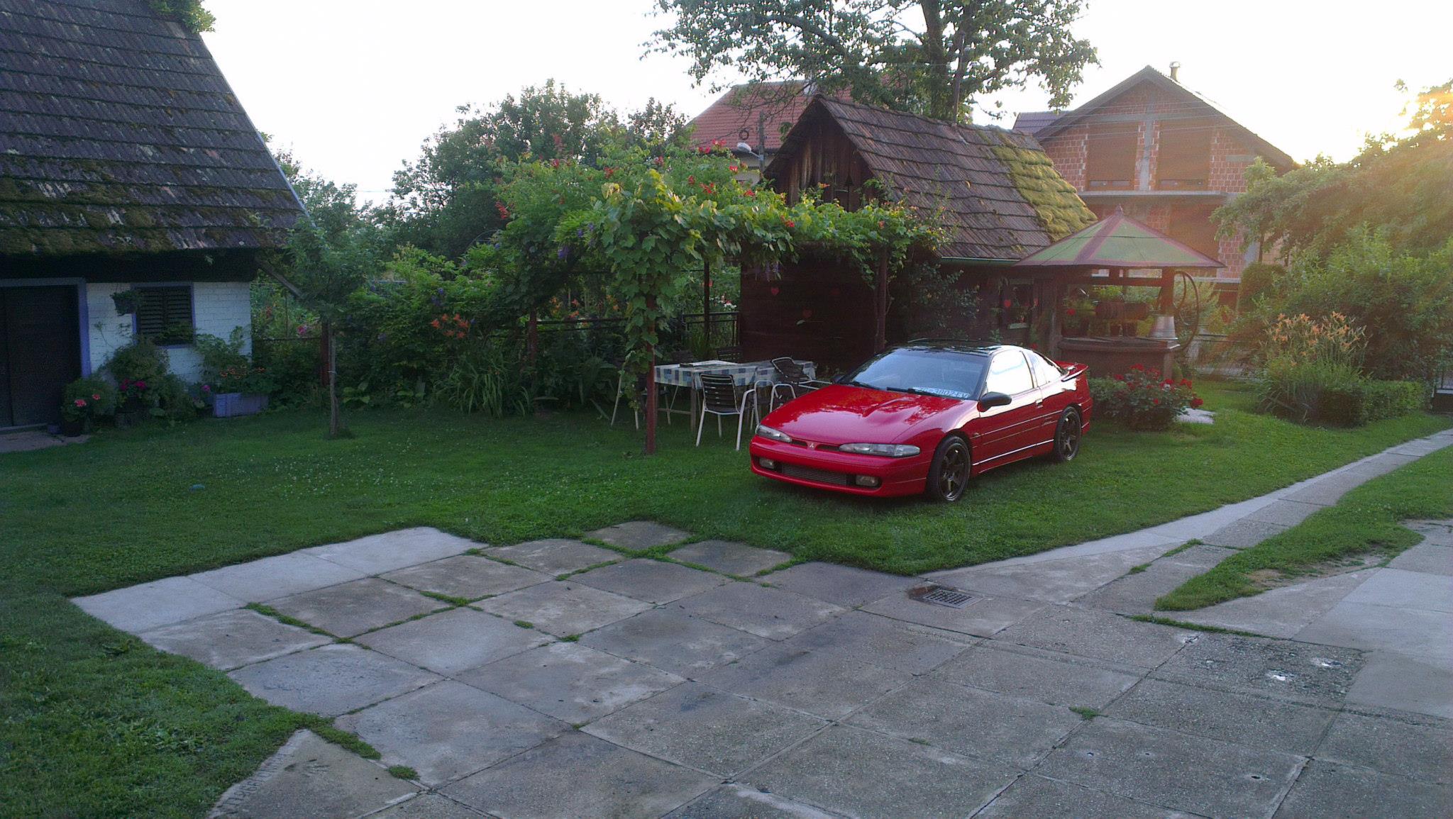

Sun finally came, so we took it out side :)

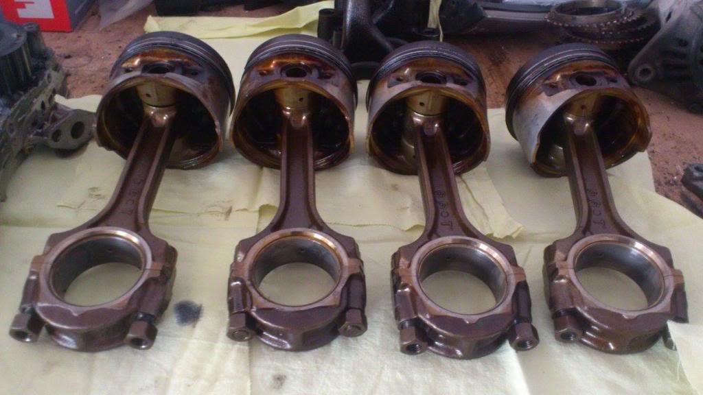

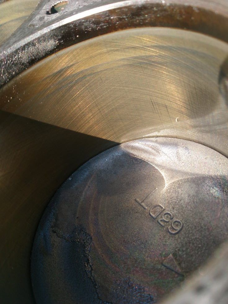

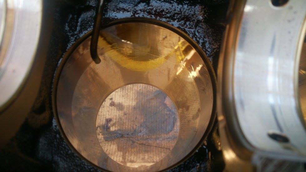

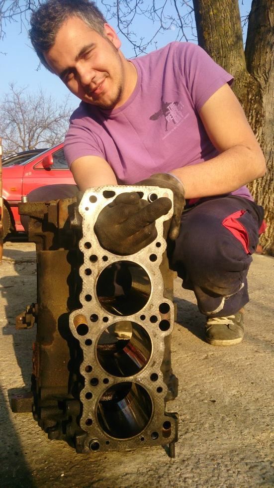

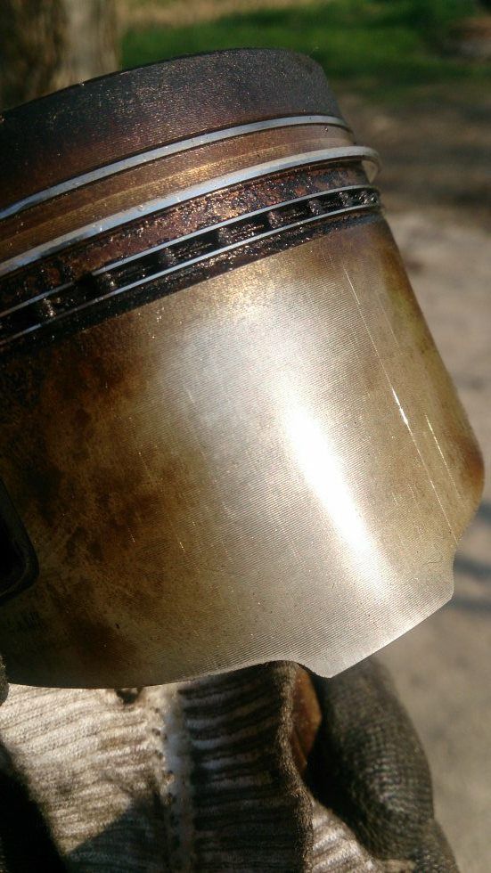

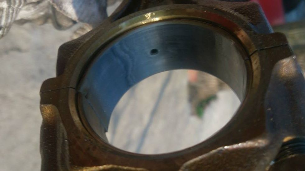

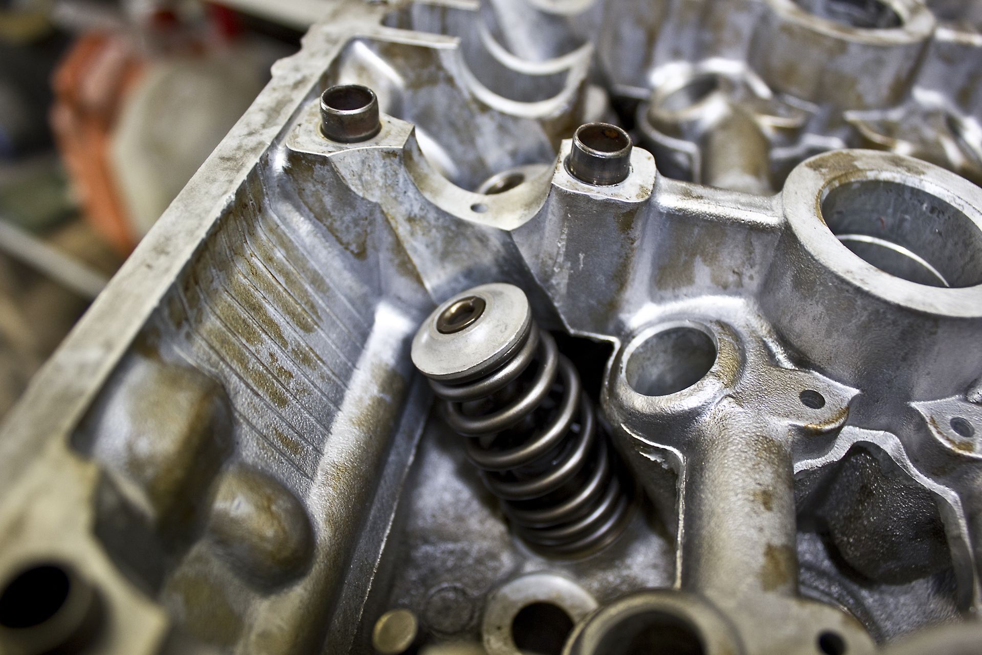

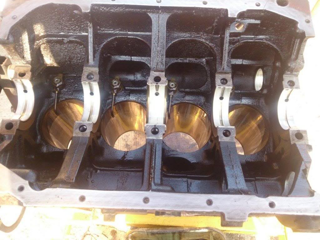

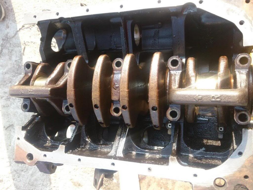

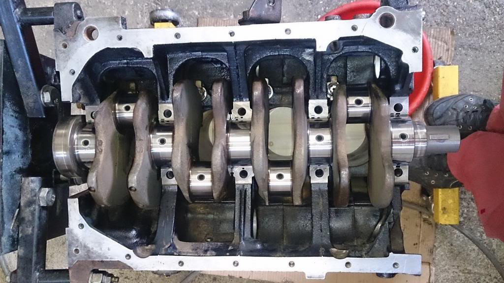

So here are the internals on 150.000+ miles engine. Engine was driven hard. I only had it for like 30.000 miles.
I took good care of it, but I cant say the same for the guys that owned it before me.

The mark on the timing belt looks like the wrong oil pan bolts were used. The oil pan bolts in the front of the engine should be shorter than the rest.
Good luck!
Don't think that is possible because when we swapped it into colt we replaced the belt with new one.
Along with other stuff. But ok, new gates racing belt is here on, so no worries.
And thank you :)

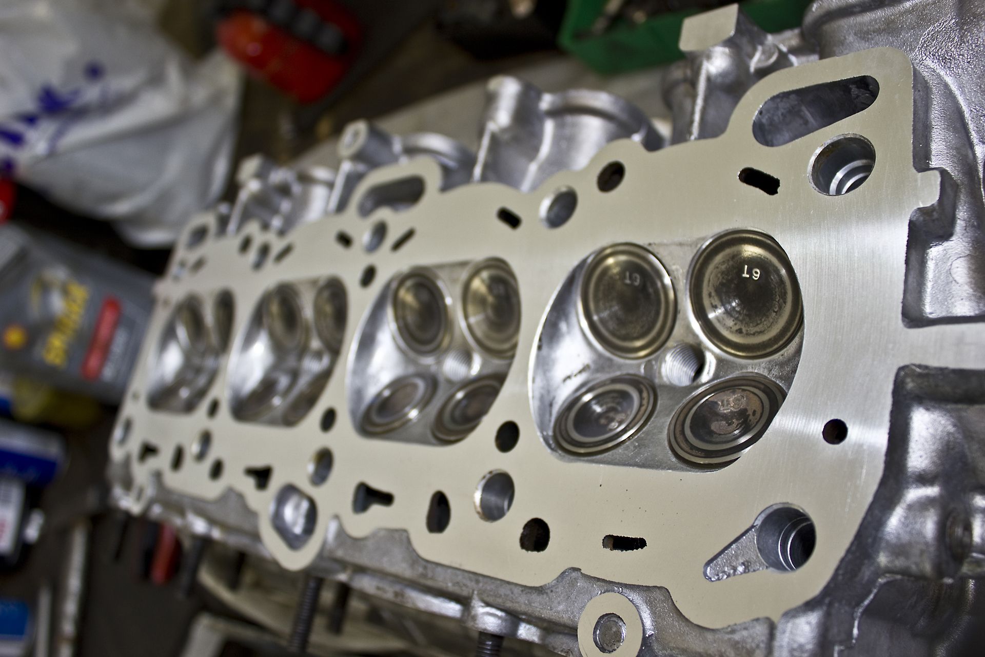

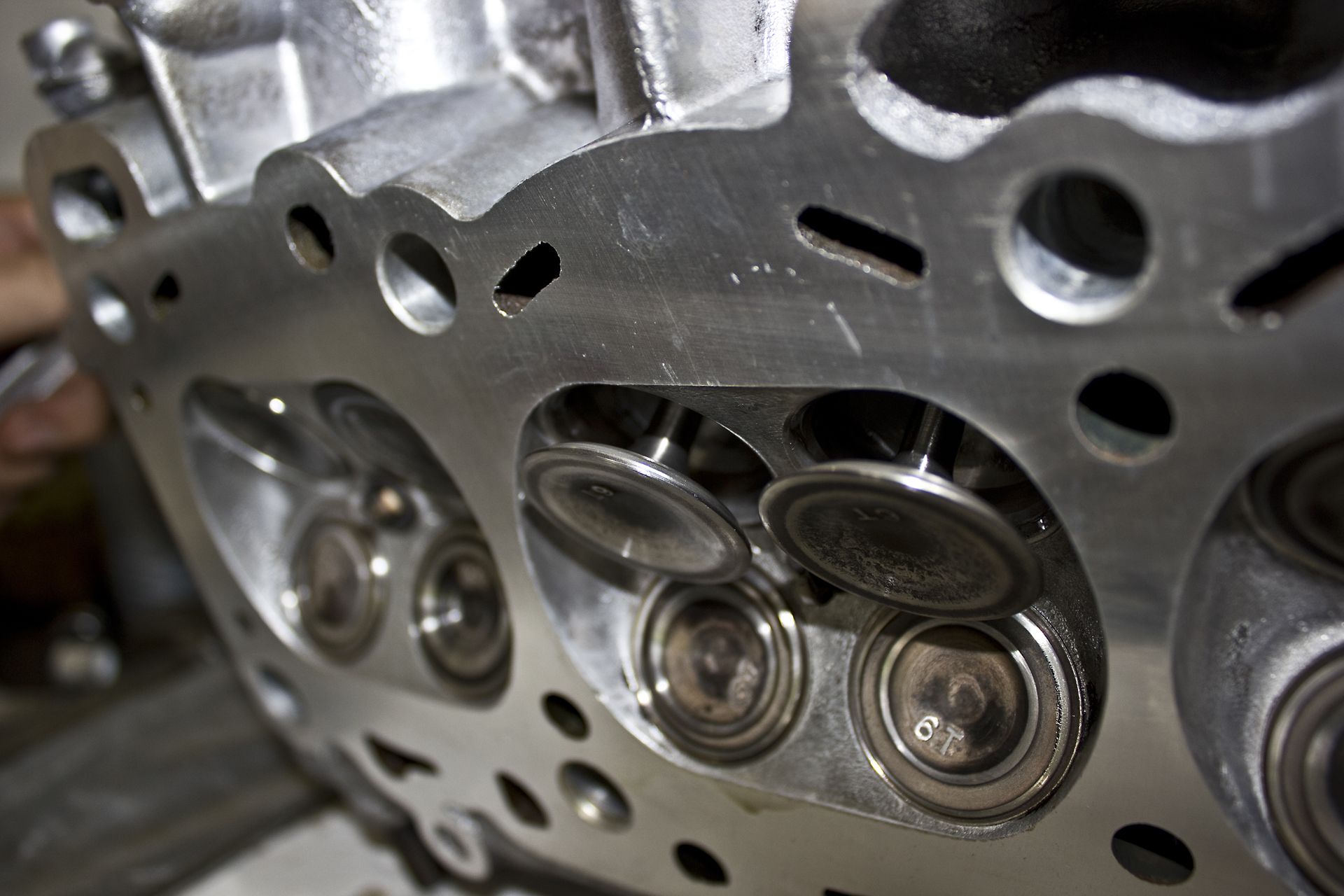

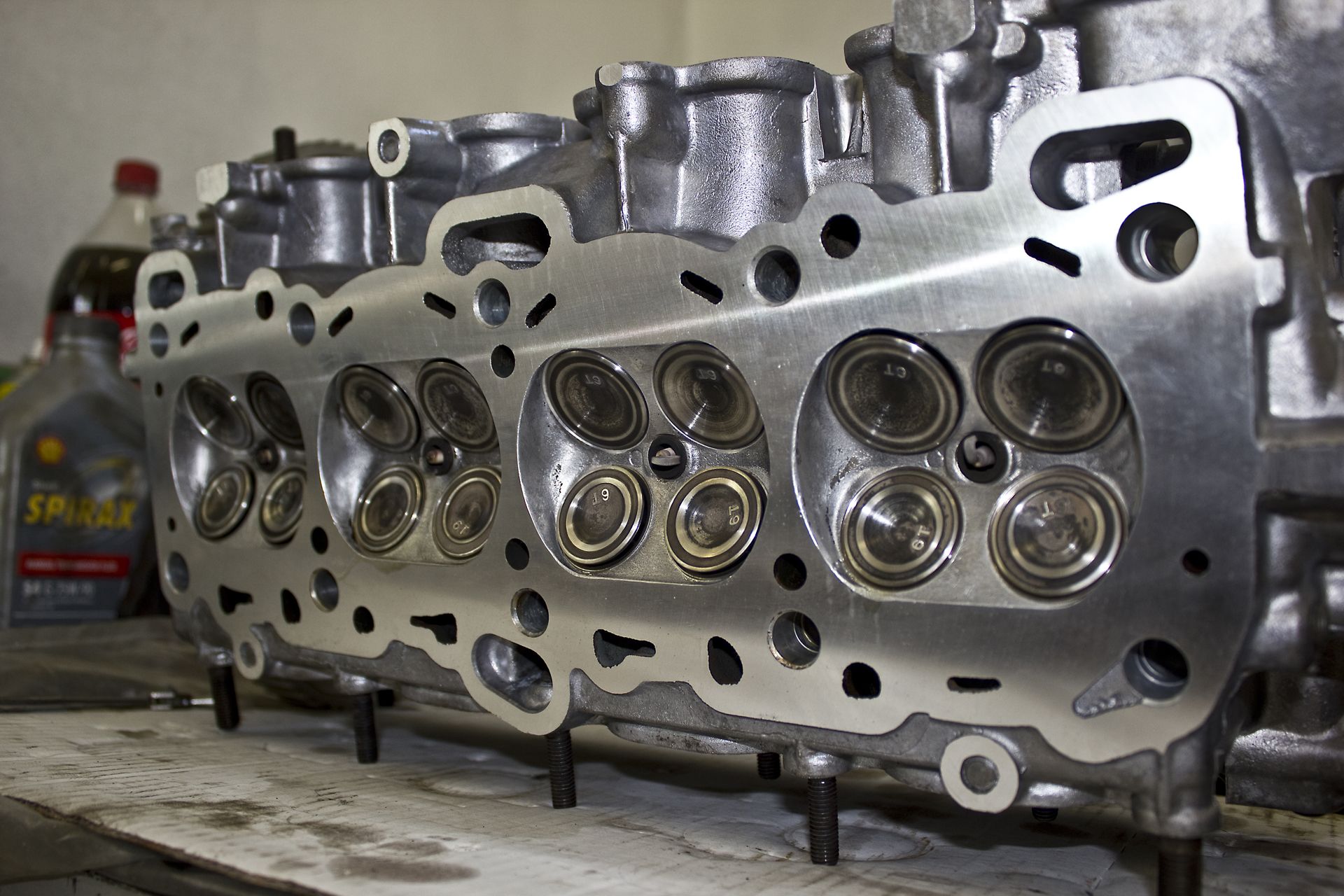

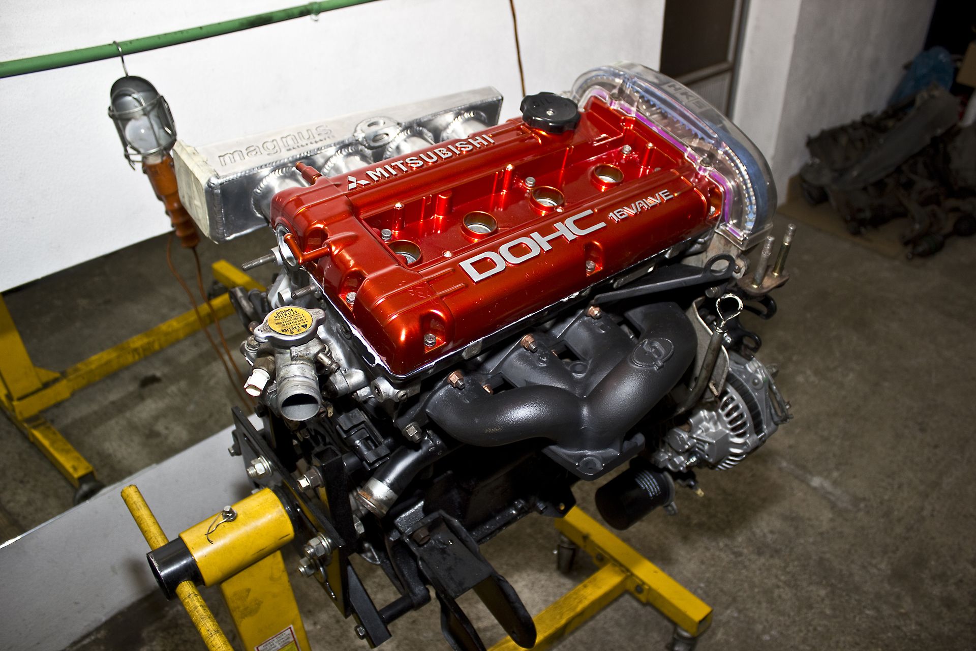

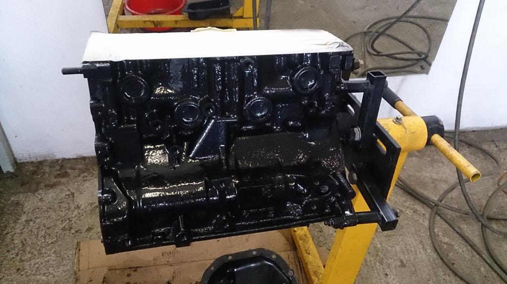

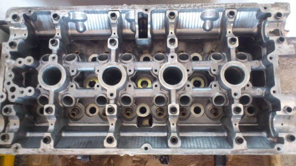

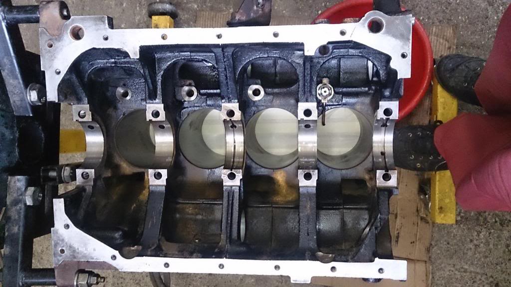

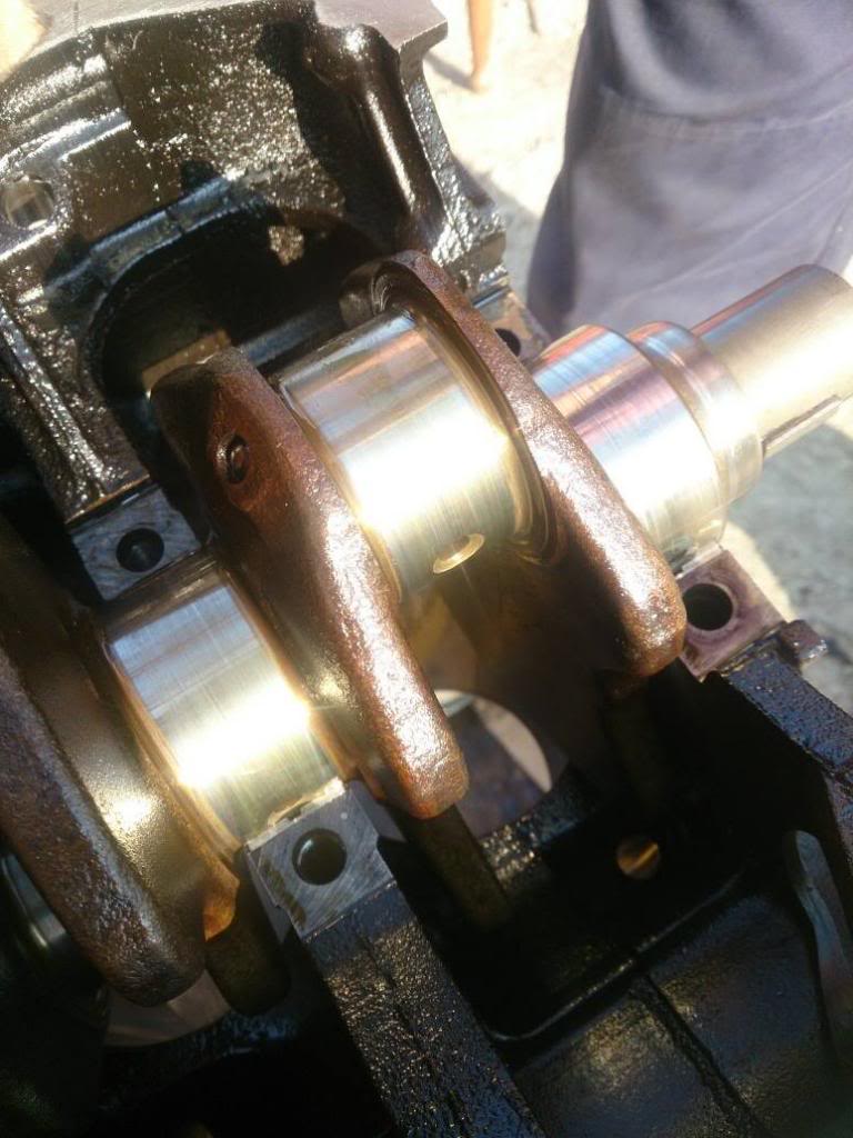

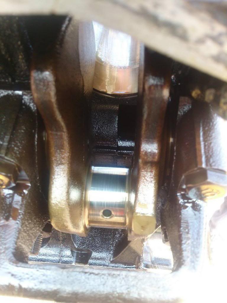

Engine is now clean and awaits Monday, when it will be sent to machine shop for treatment :)
Everything balanced, polished, block painted..

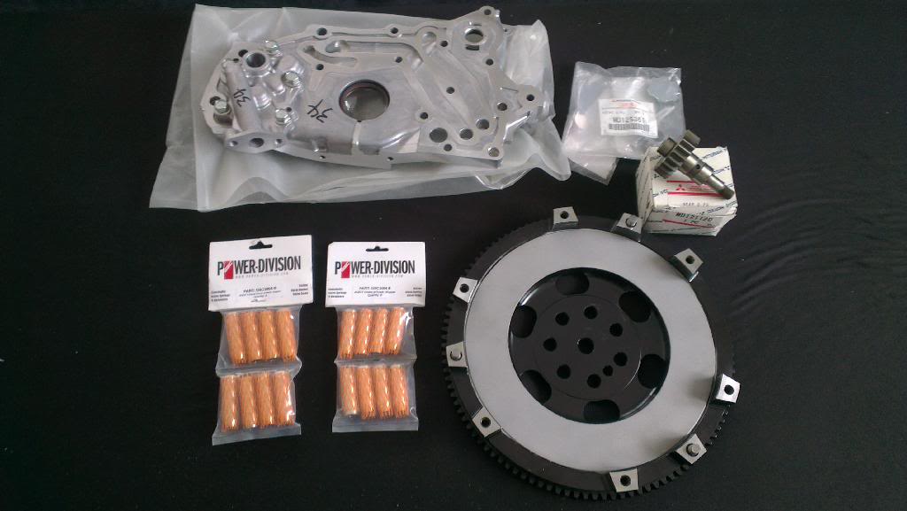

Today I got the rest of the packages at post office, will be getting them tomorrow.

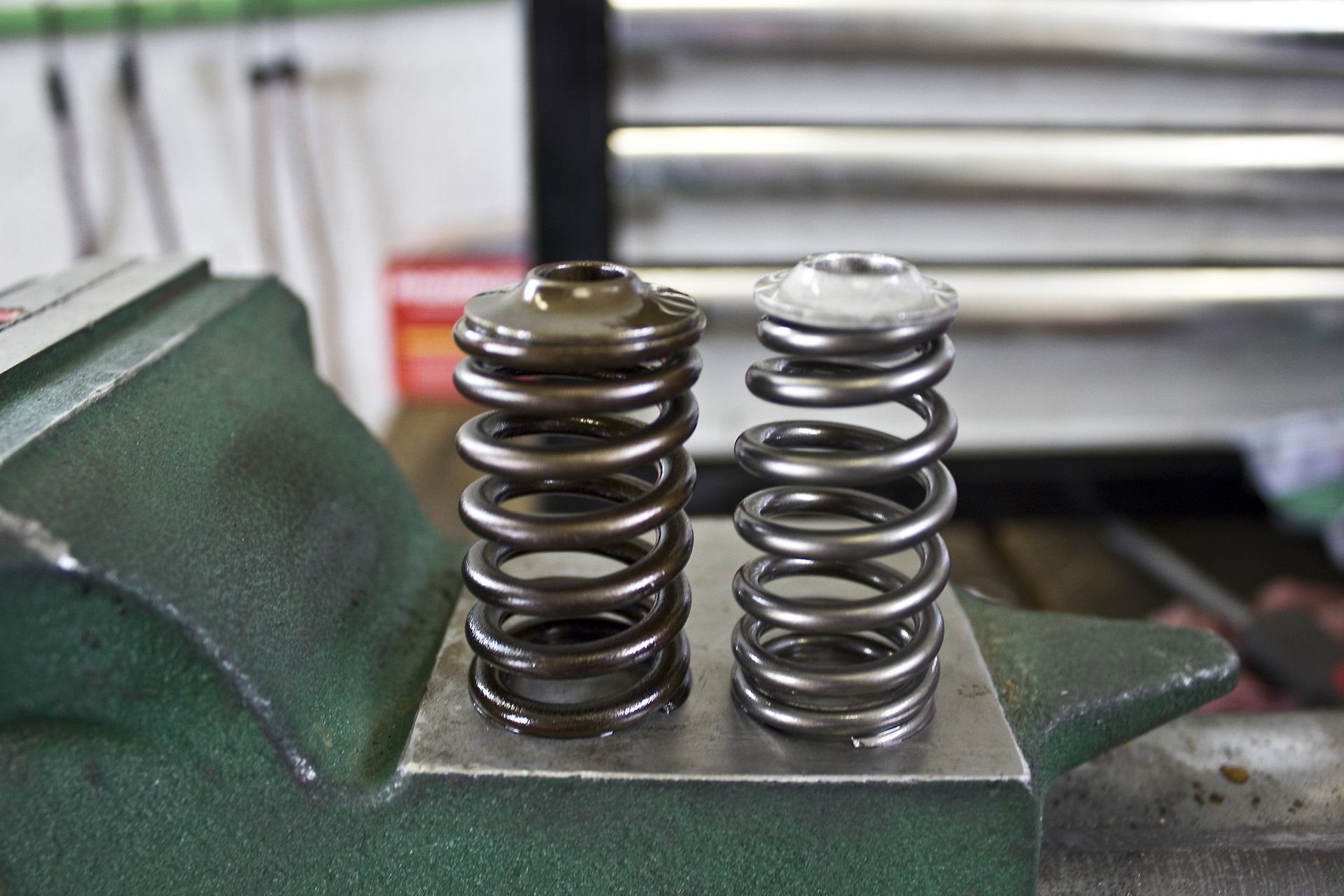

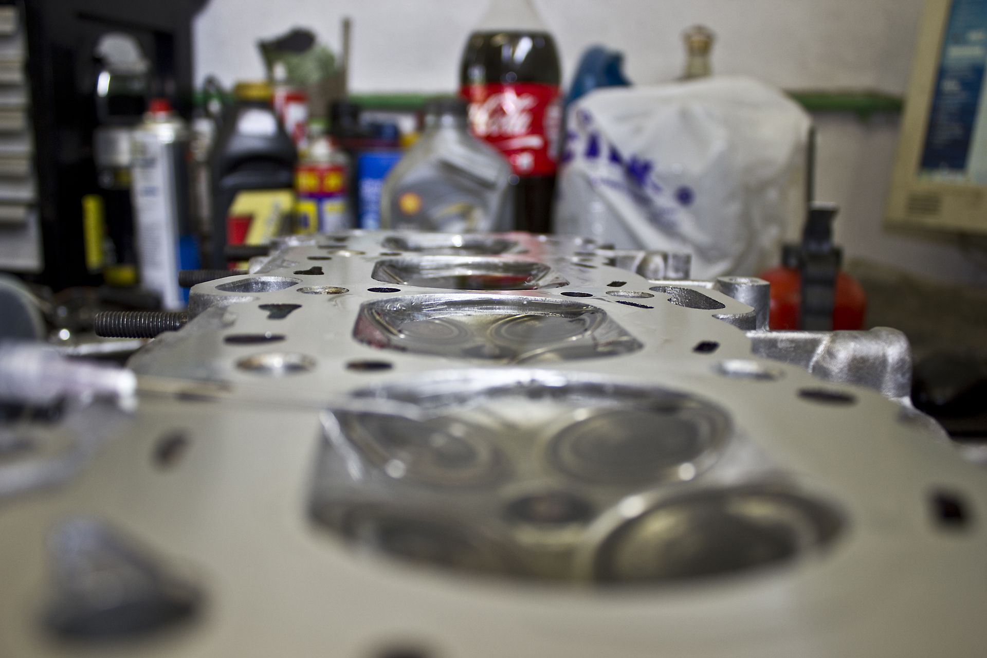

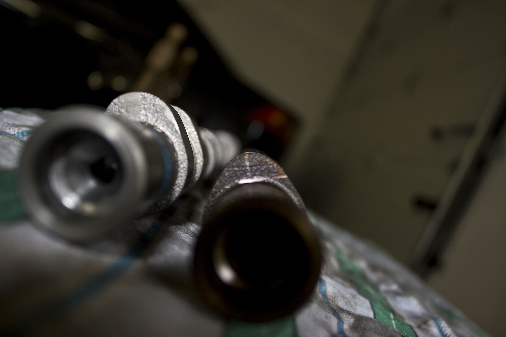

Need to take GSC valve guides to machine shop so they can finish up the head.
Also new OEM oil pump that is in same package as guides will go up on the block.
Also this arrived yesterday.

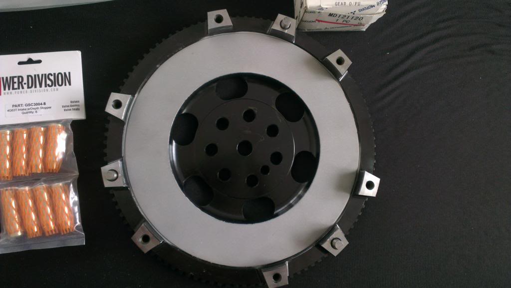

Aldo some changes came up. I will not be using this flywheel.
I have TZ series kevlar clutch and what I have learned that it will not be the best combo.
So instead i ordered "Competition Clutch 4140 heat treated chromoly flywheel" that I will also pick up tomorrow from post office.

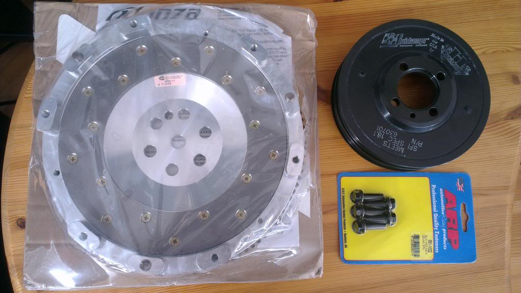

I got the flywheel from TMZ Performance.. I was very happy, but then I counted the holes.
It was 7 bolt :(

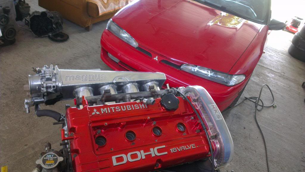

Here are the rest parts that arrived (new OEM oil pump and GSC valve guides).
I contacted Tim, he sad he will ship a new flywheel today. But I have to wait another 3 weeks or more to get it.

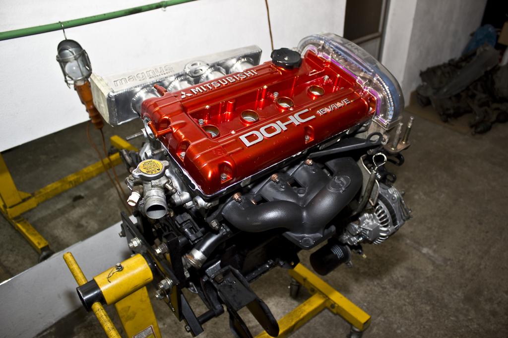

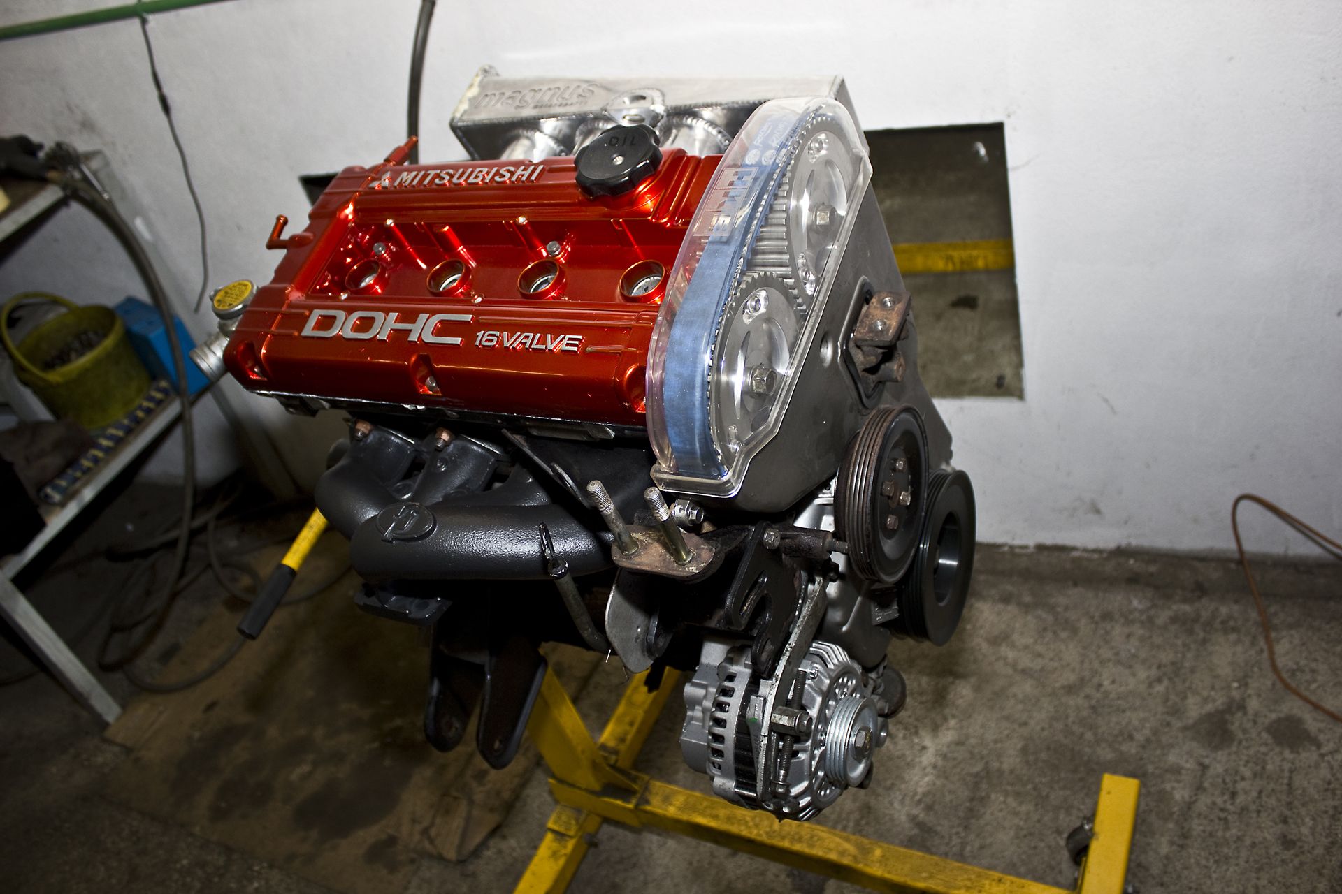

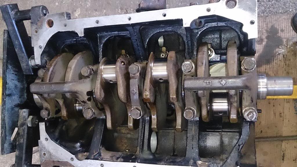

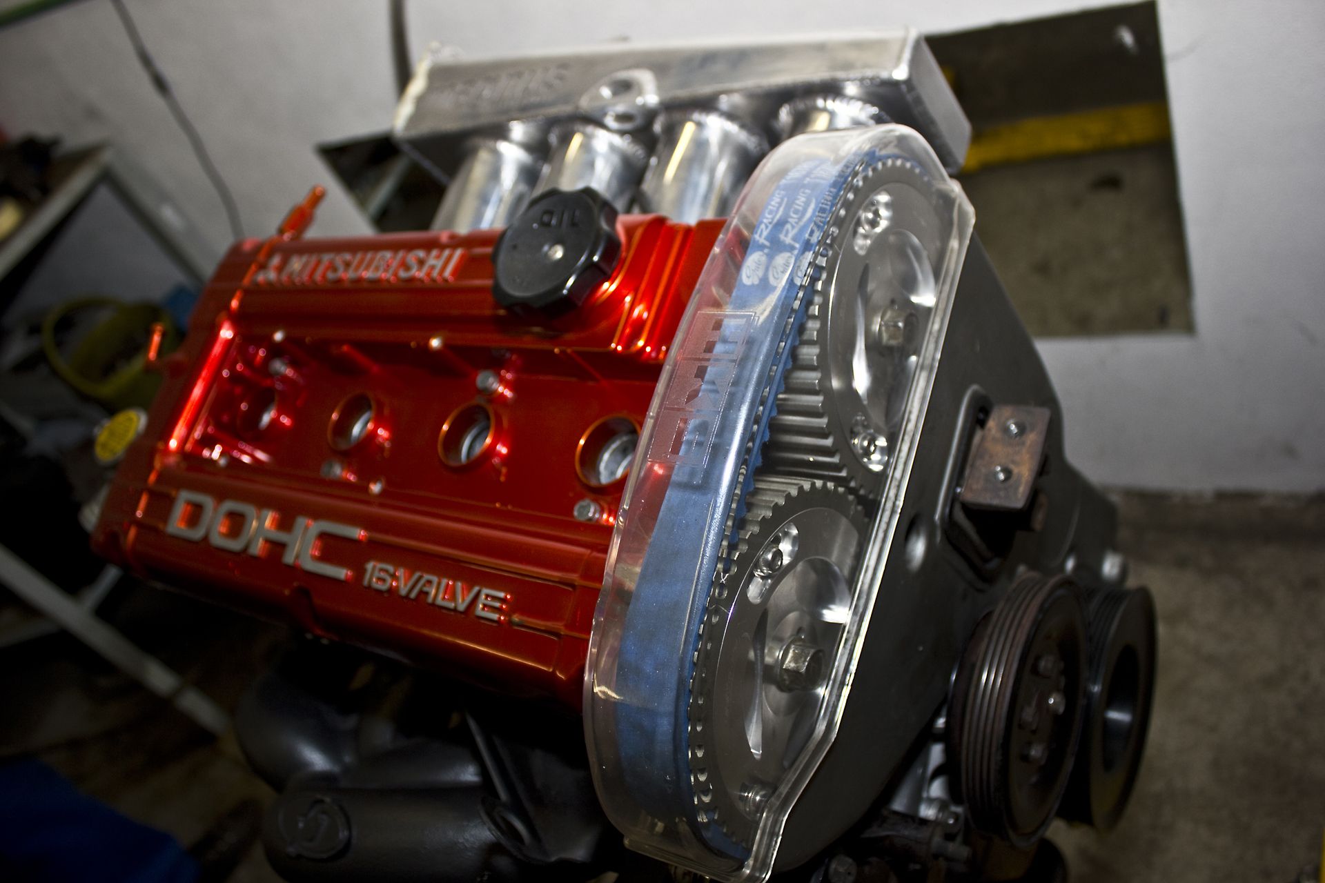

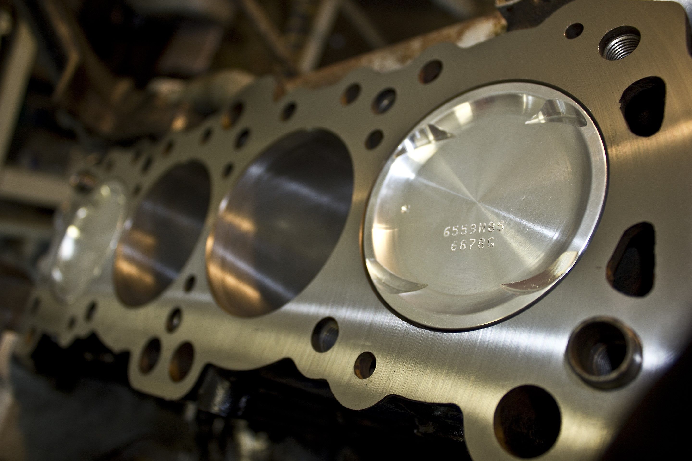

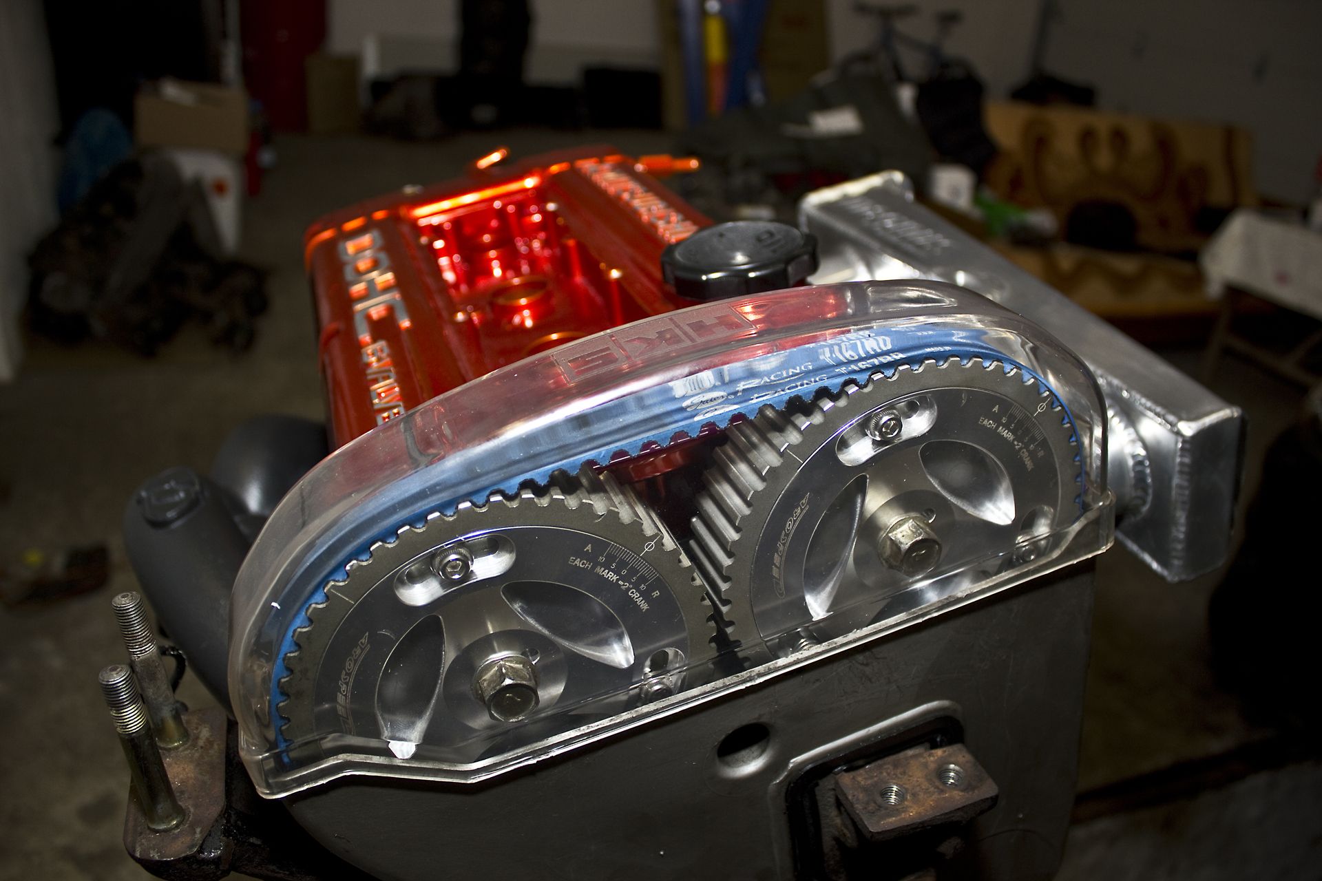

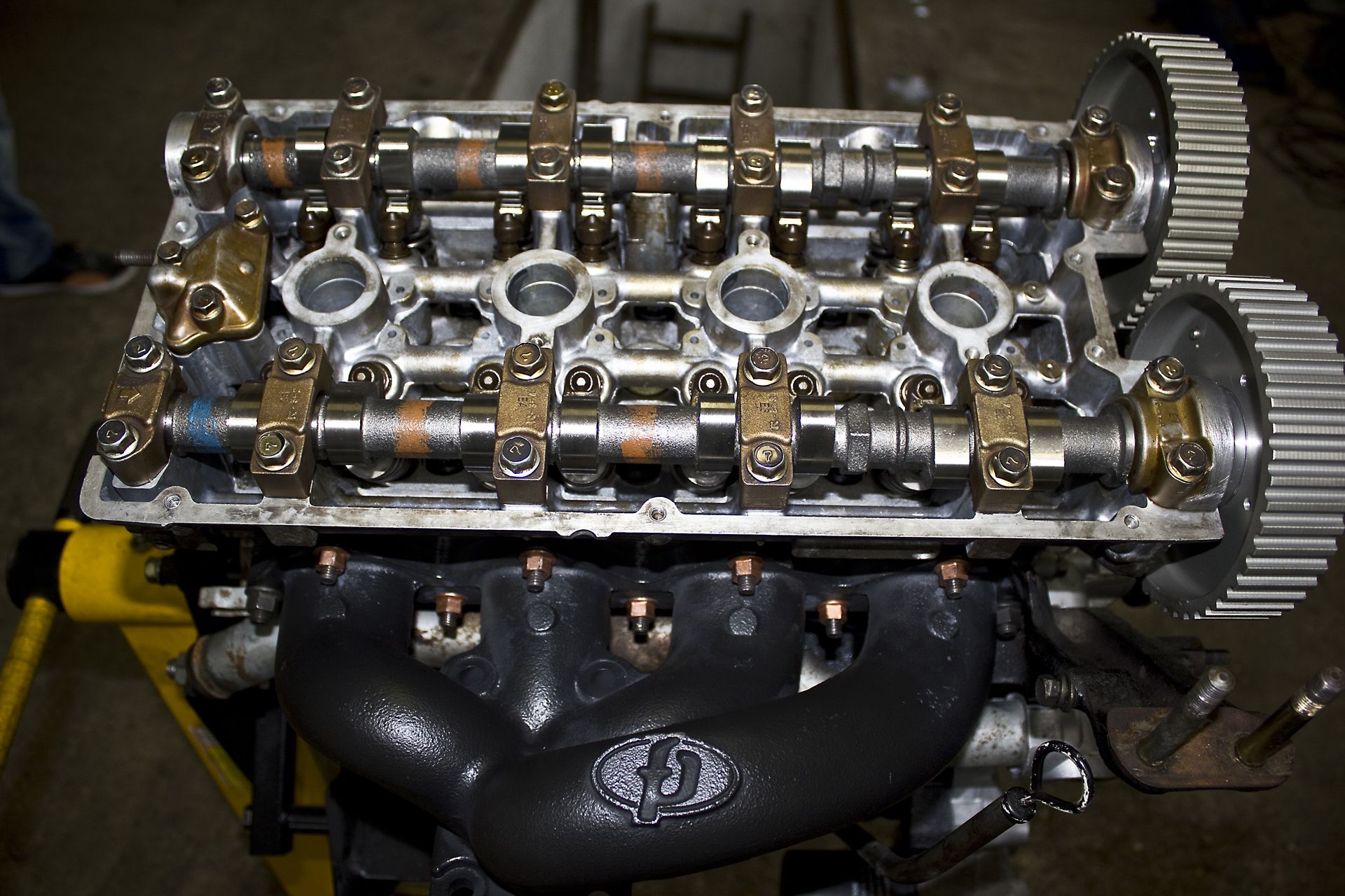

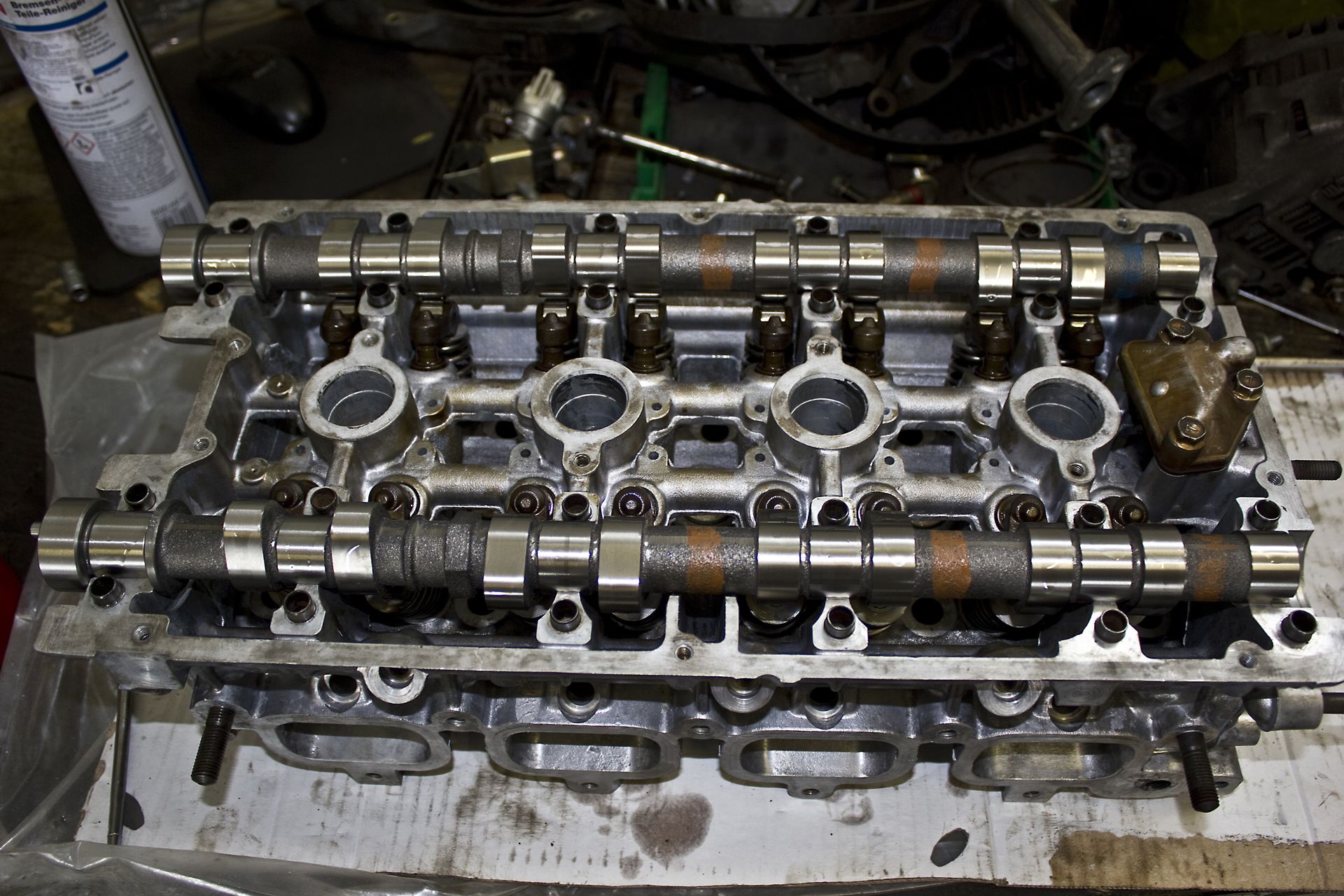

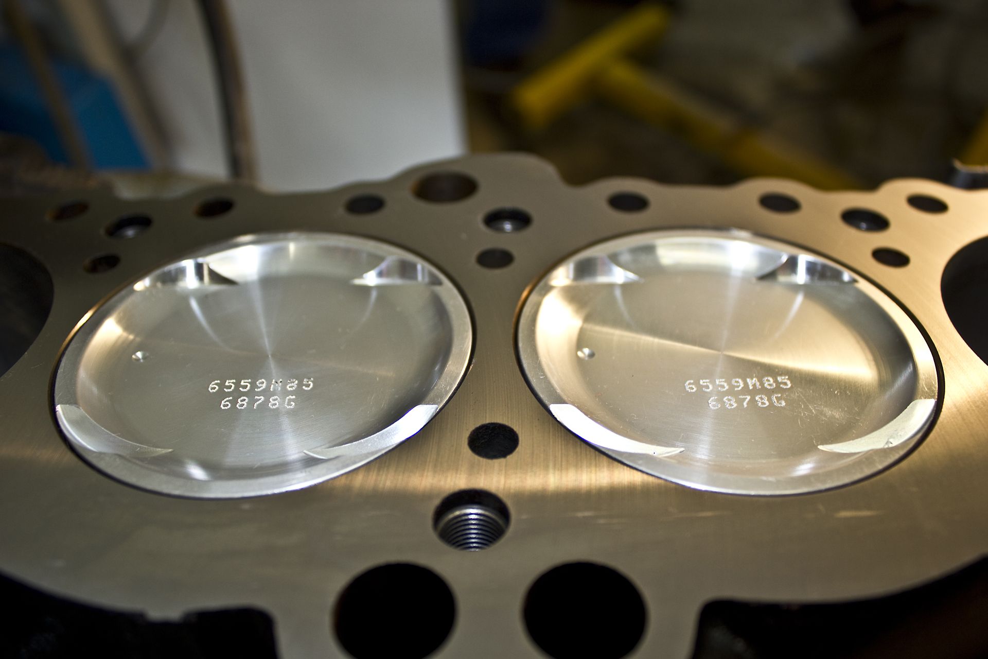

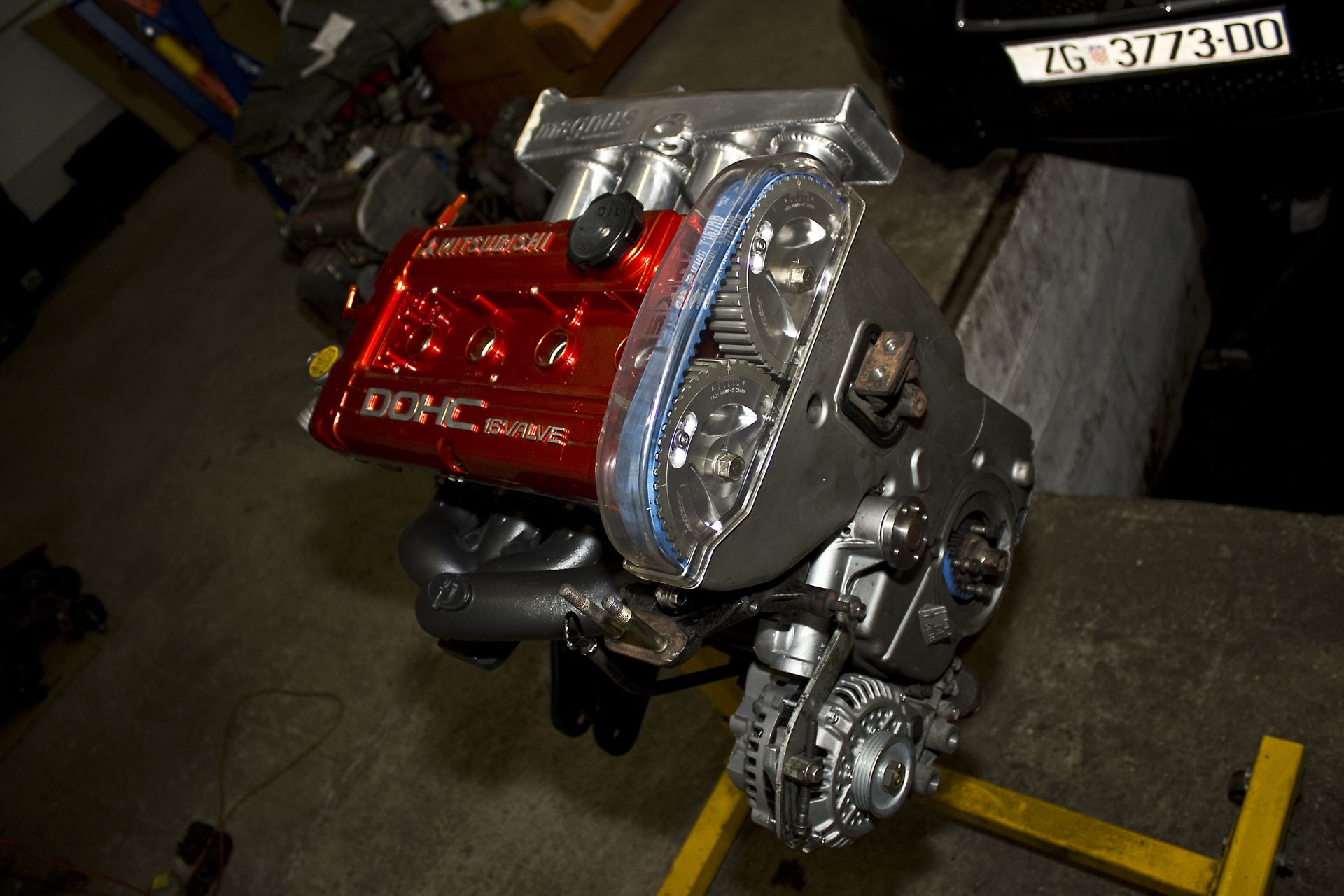

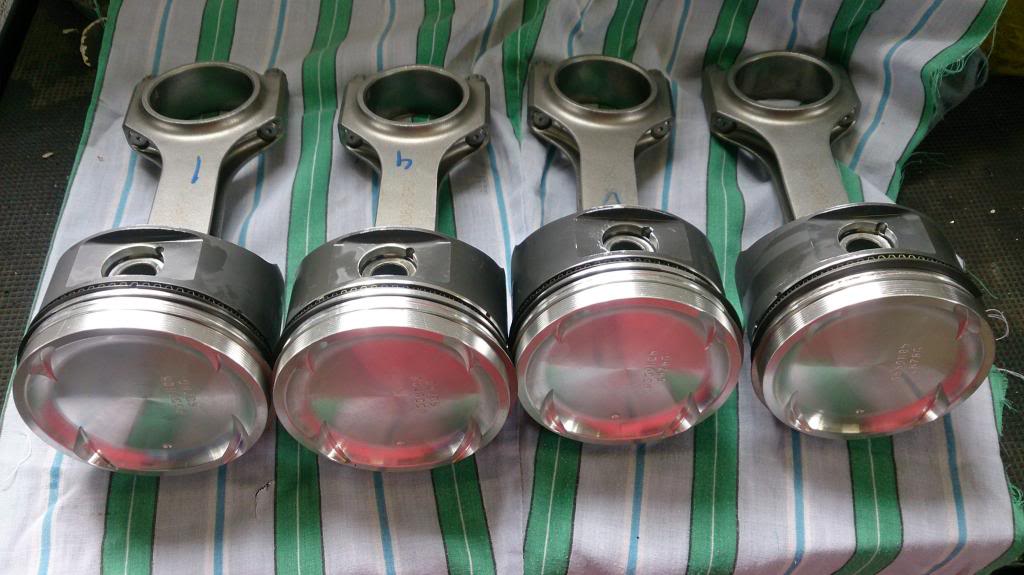

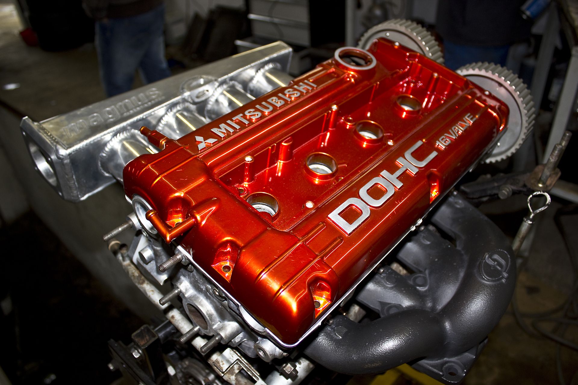

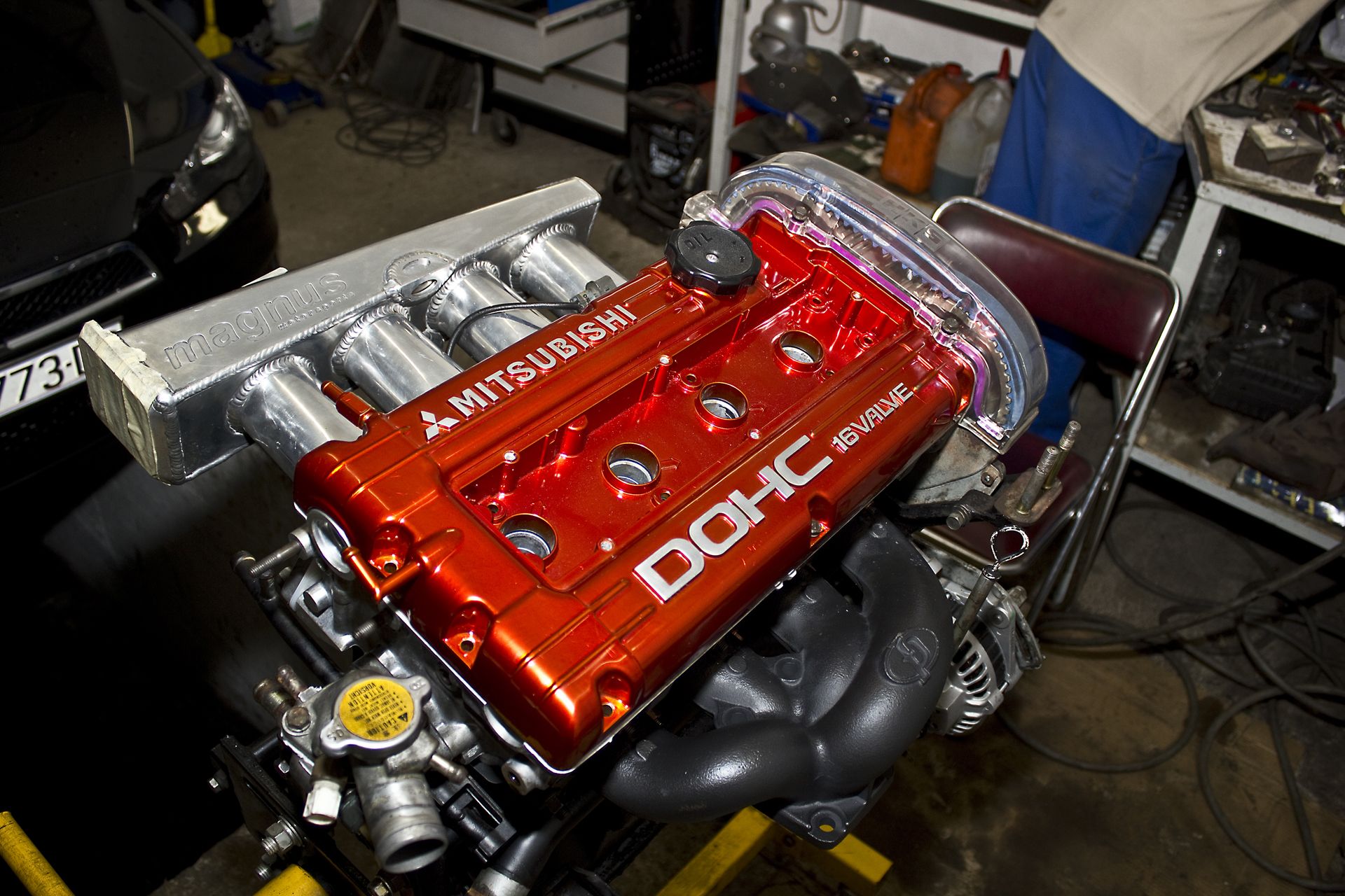

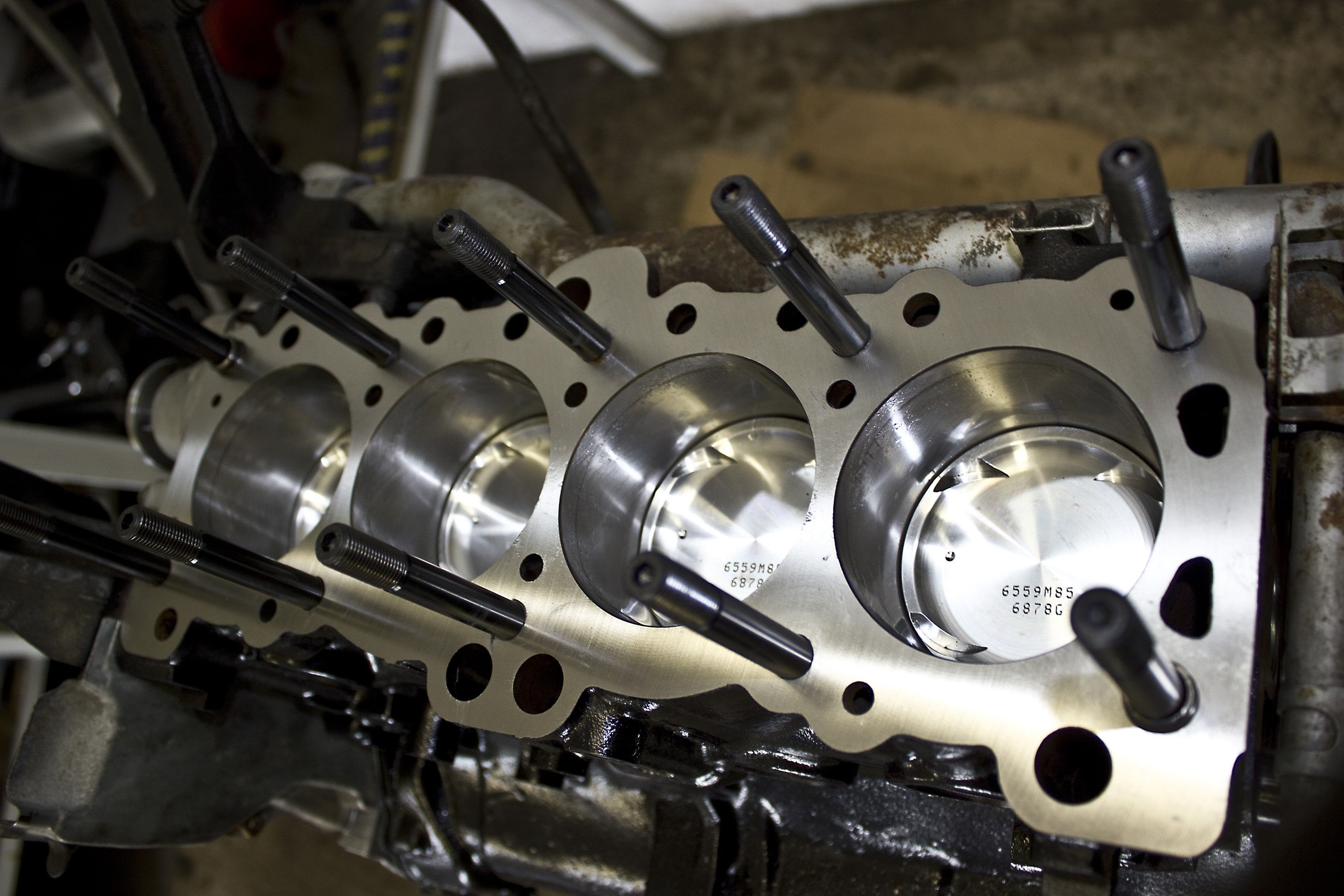

The engine is coming together.
The pistons and rods were only put in for picture, they are not tighten.

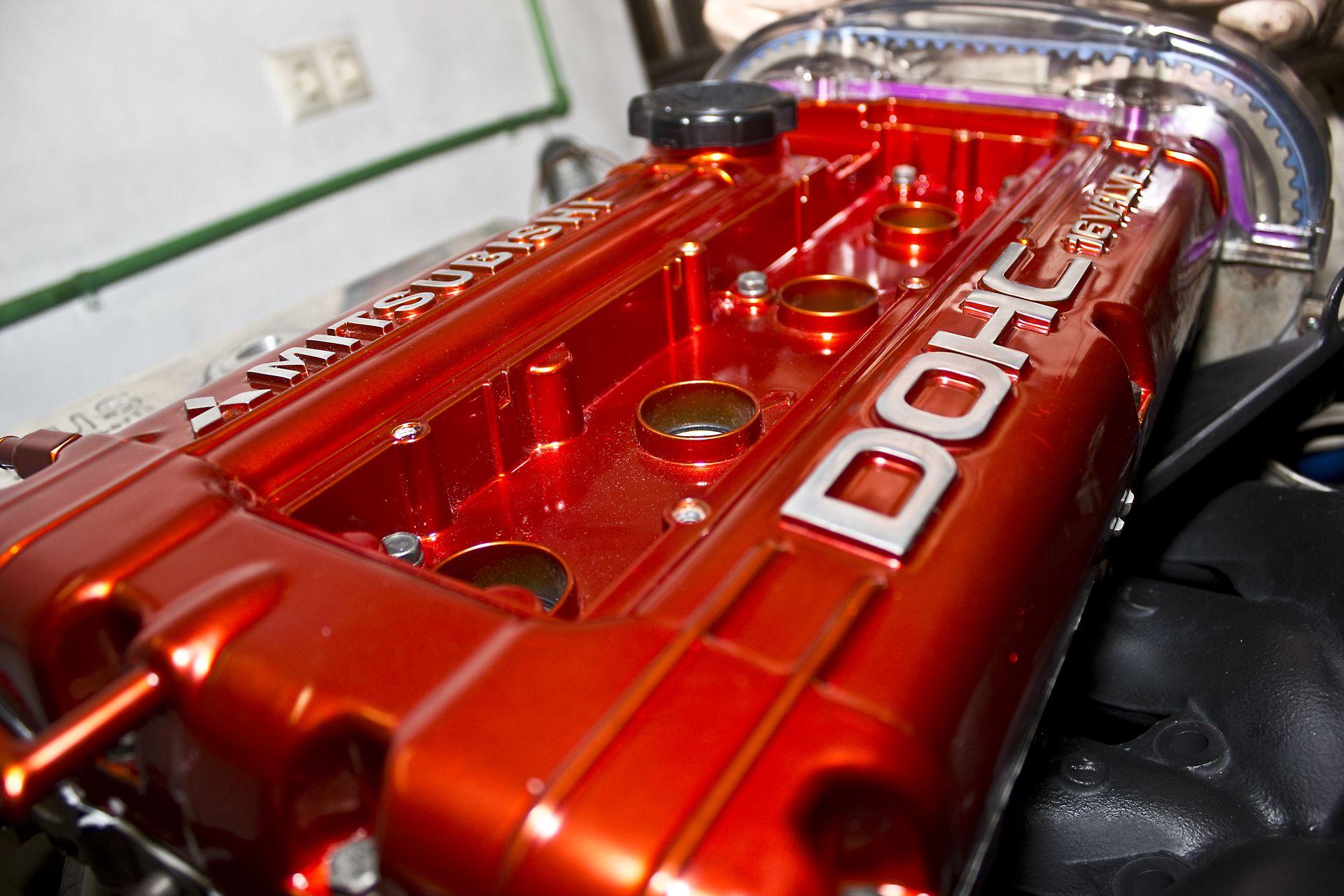

Sweet build i have the same color valve cover on my car, great buy and love the cams, does the rear bumper warp in the middle ive seen so many 1gb gsx eclipses do that over time.
Haha, yes getting all the parts from US takes time :) And money! I have to pay almost 40% on tax when importing all the parts. I have been collection parts for 3 years now. Soon all of them will be up and running.
Waiting on CXRacing water cooler from Poland and flywheel from Tim and we can finish it.
No for now the bumper is in good shape, no waves.
Today I stopped at garage.
Turbo is bolted up, everything is ready, only waiting on flywheel to come from customs, so we can put it back in.
We also swapped the fuel pump and rewire it.
Just need to move the car battery into the trunk, replace motor mount inserts, change few seals on transmission and t case and thats it.

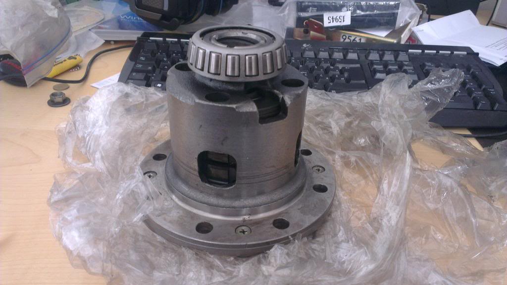

One bad news.. It seams previous owners swapped the rear diff.
It is 4 bolt, but NON LSD.. I was very sad about it.. So I went and bought EVO LSD from a member here on forum. I'm happy again :D

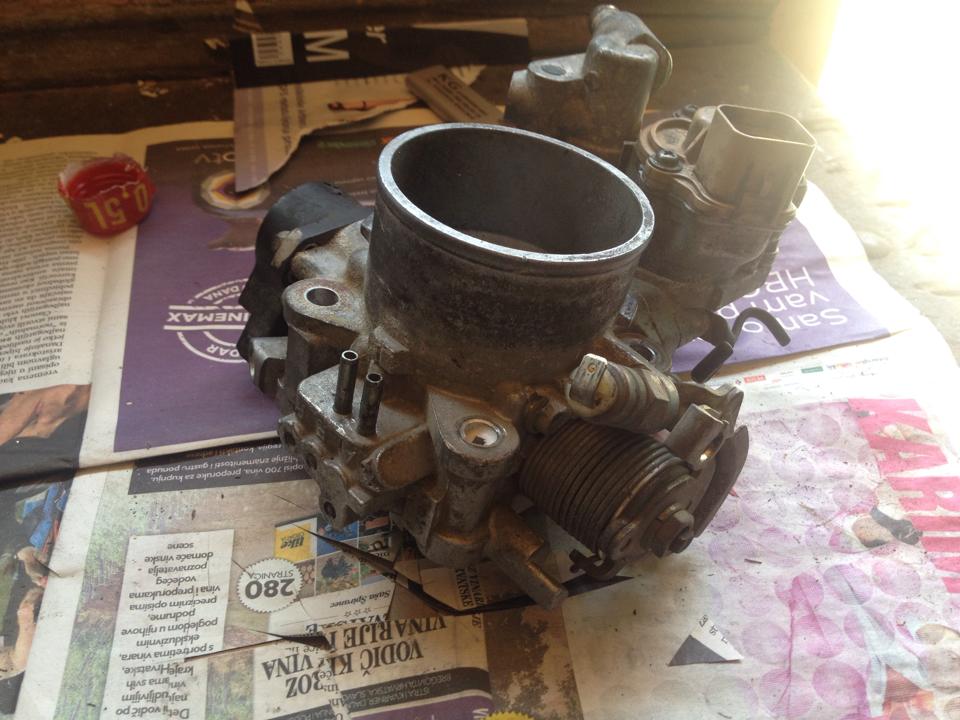

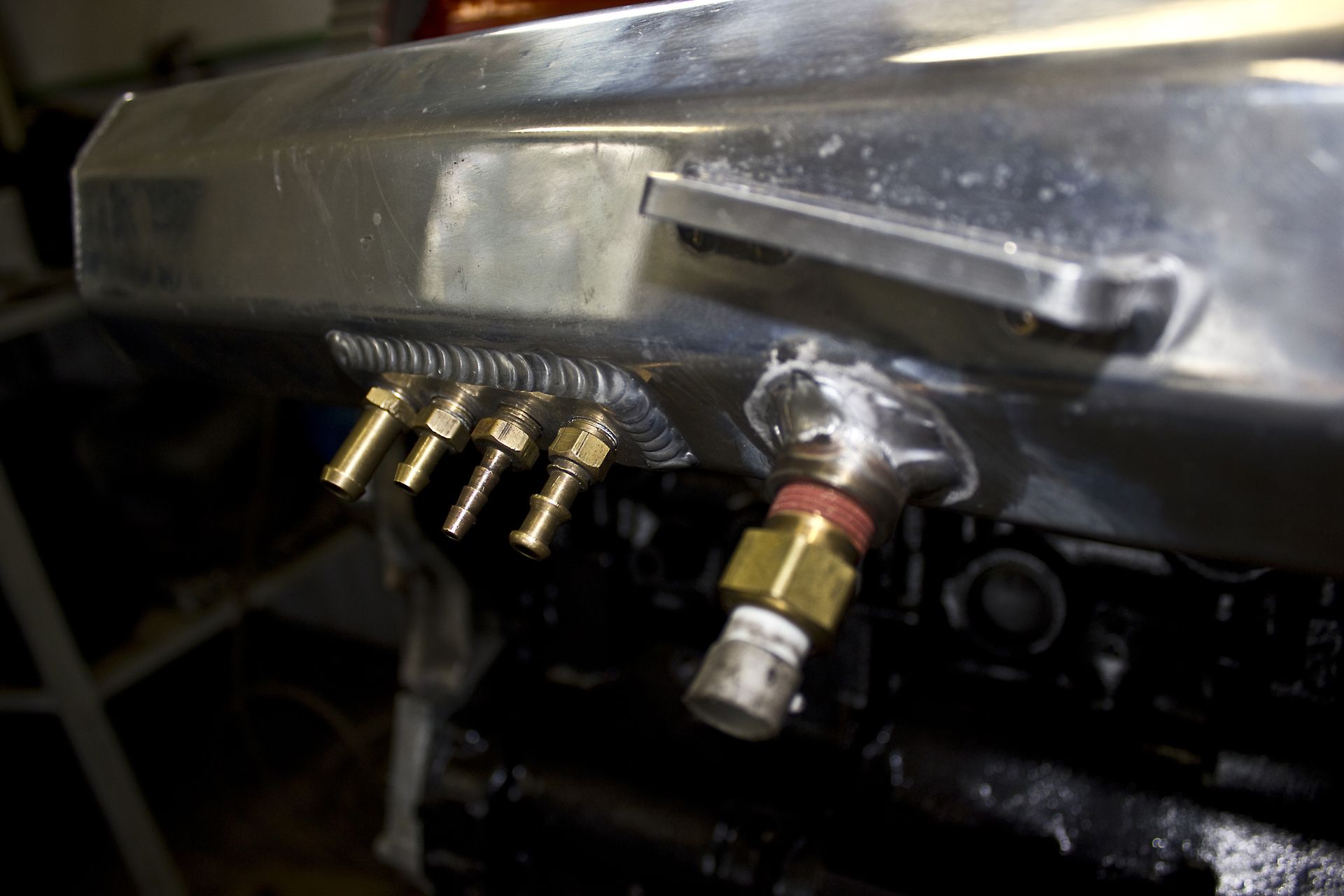

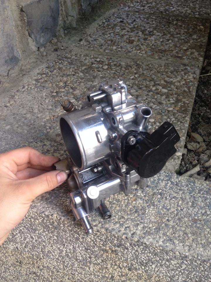

Alo I gave throttle body to my friend and he polished it.
Before
After
Few pics from today.
Fuel rail is temporary, because we will fire it up on original injectors, ECU and MAF.
After the break in period, we will switch to other fuel rail with 850cc, ECMLINK and SD.

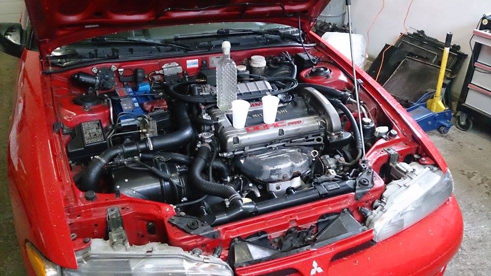

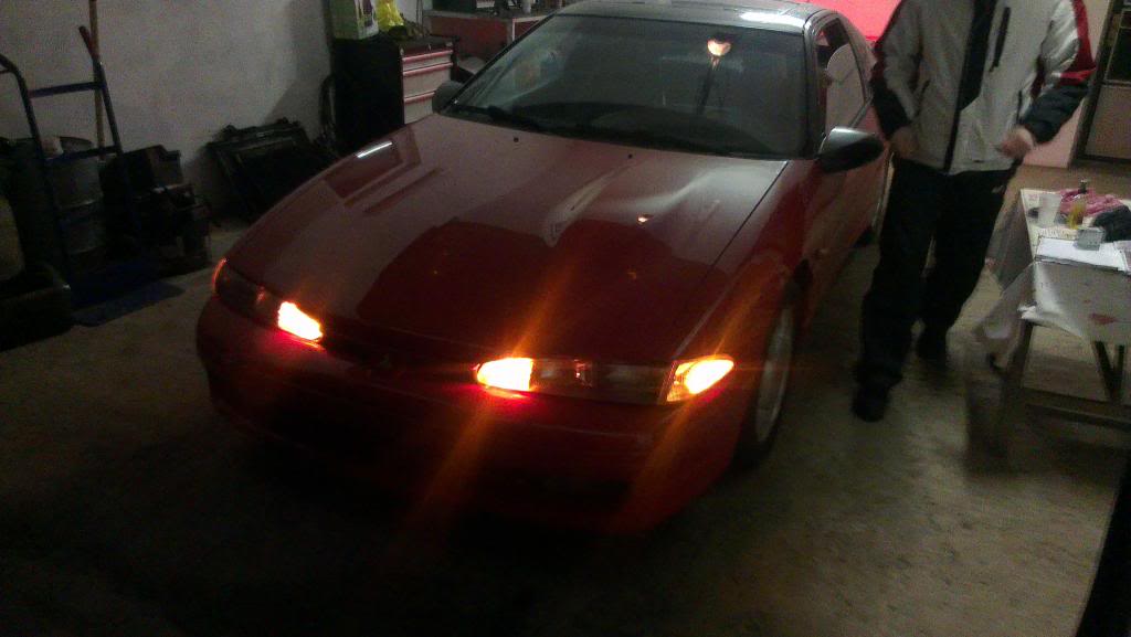

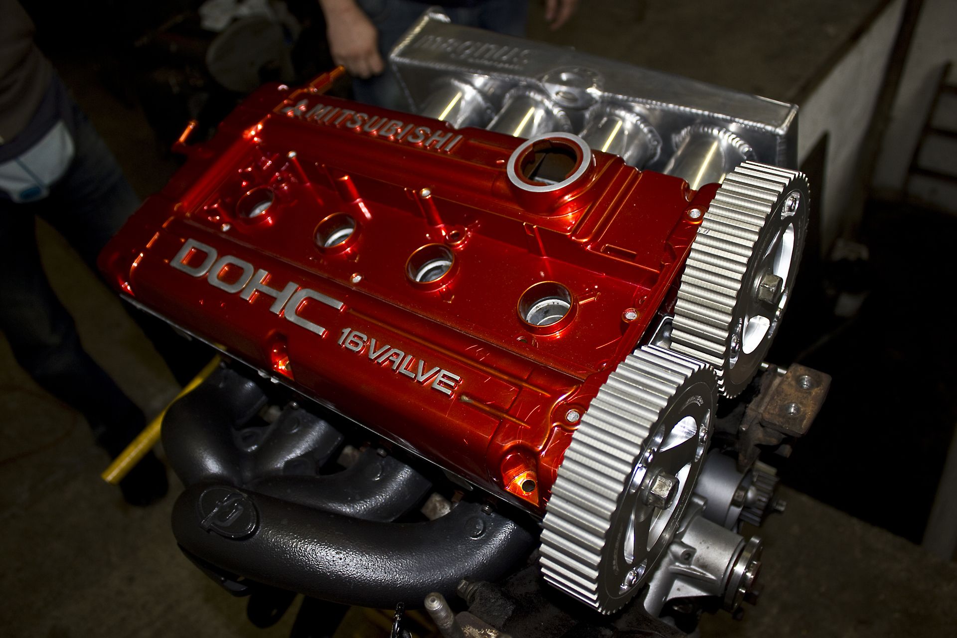

We fired it up last night. Just to see if all is good.
Had a few sweats, because it didn't want to build oil pressure wile cranking.
Oil pump is brand new so we had to "push" the oil through it.
Next is custom exhaust and IC pipes.
We staretd it on oem 450cc injectors and ECU.
After the brake we we will switch it over on 850cc, Ecmlink and SD.

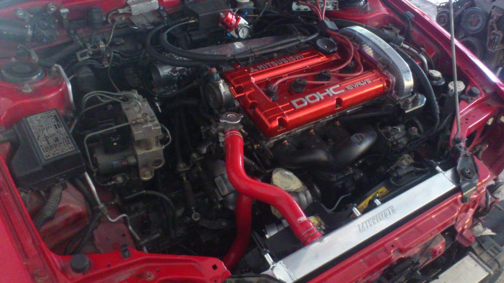

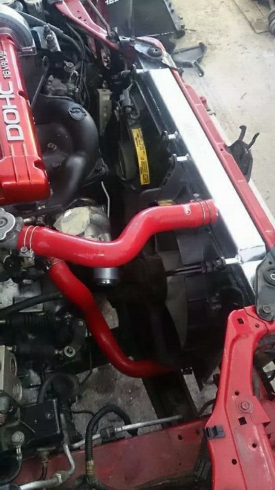

Mishimoto radiator came in yesterday. Was fitted this morning.
On monday the exhaust and IC pipes will be finished.

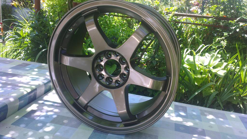

On wednesday new tires arive so I can put them on.

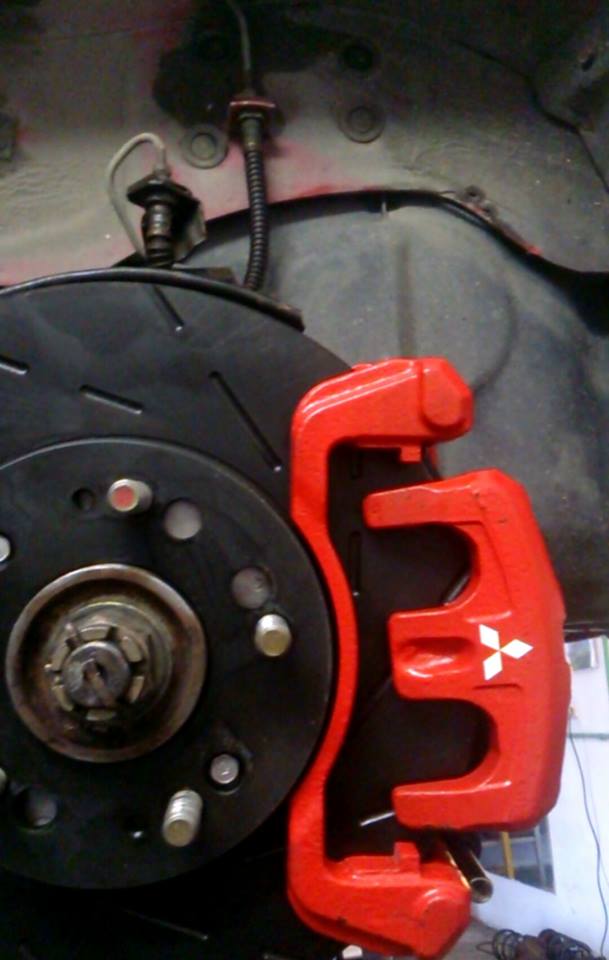

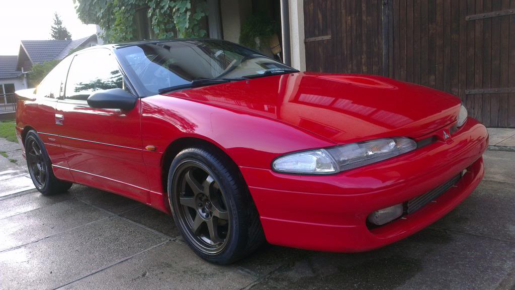

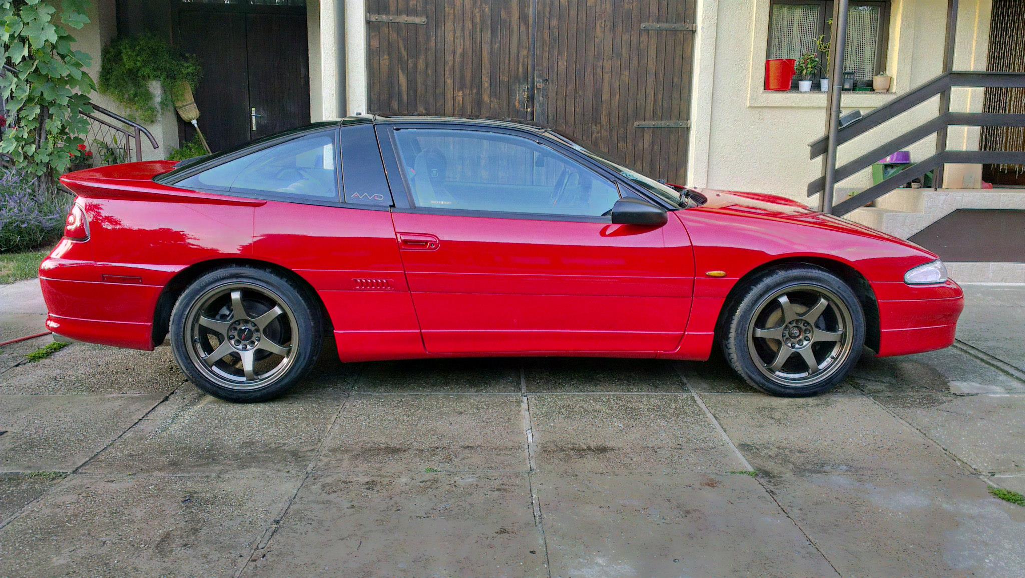

Wheels are up :)
Having a small problem with bov. It will be dealt with on monday.
At the moment she is run on 450cc, maf and OEM ECU.
After the brake in she will go on 850cc and ECMLink with SD.
Here are some pic and short drive video.

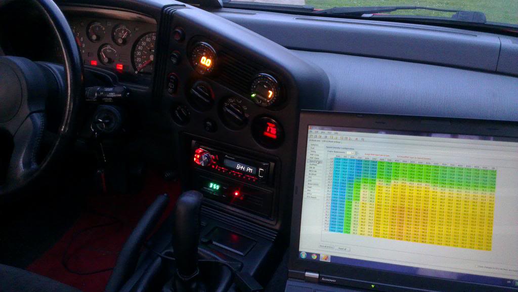

Made first 500 miles of brake in. For now she is still on OEM maf, 450cc and ecmlink with basic setup.
Soon she will go on speed density and proper tune up.

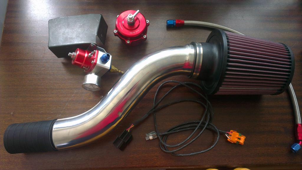

Some of the SD goodies.

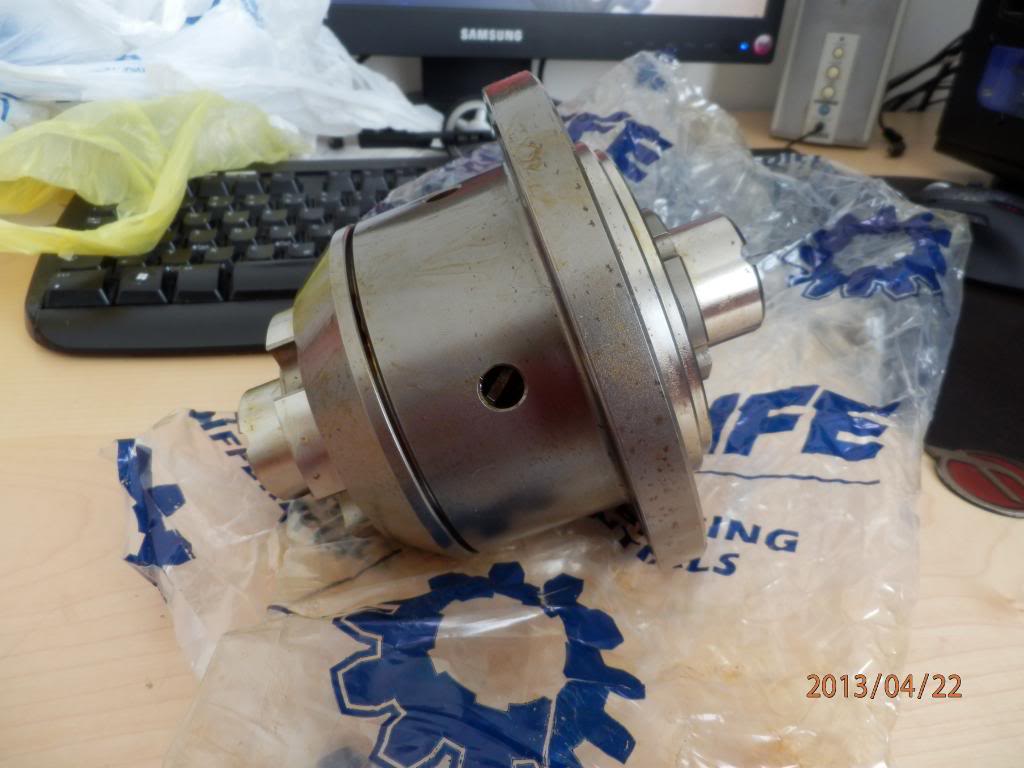

I also bought from a member here EVO rear LSD diff.
I just need to find some rear axle cups to make it work.

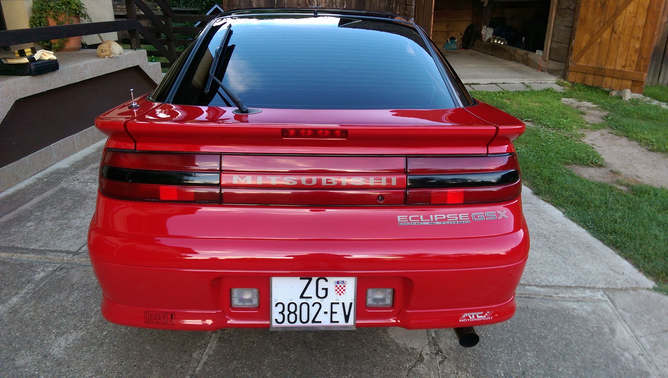

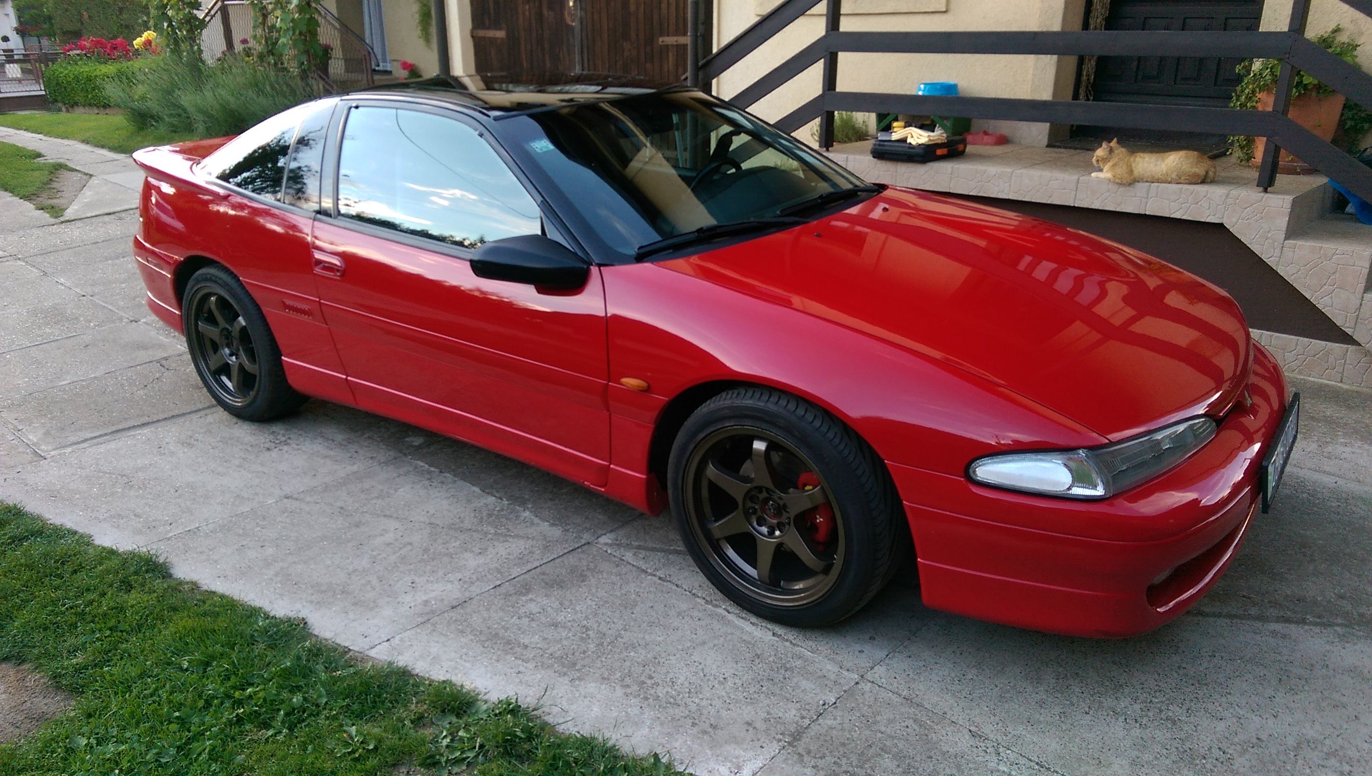

She also got her first bath :)
Next on the list to do except going SD.
-get some new lowering springs (Eibach, tein etc..)
-get new tail light (they f*ucked up these with orange blinkers)
-tint the windows
