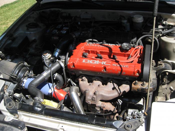

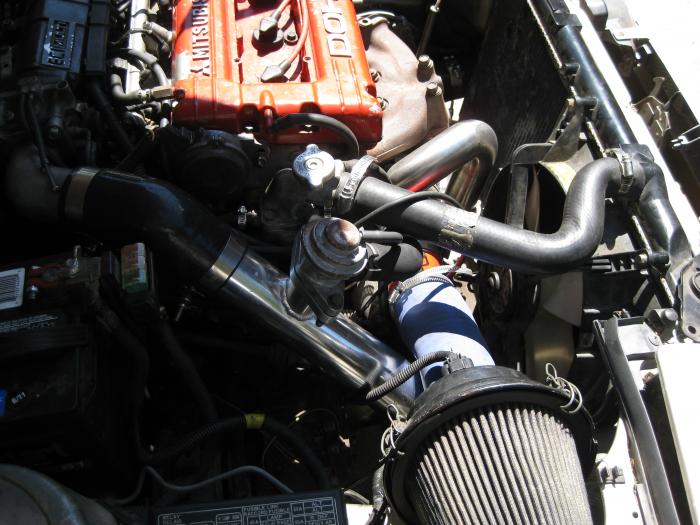

its a 1990 talon awd tsi it has new intercooler, 3in exhaust,megan racing coil overs...but it doesnt run well and i have no clue what i should do...it will start but wont idle...barley give it gas and it will rev up:confused:

I would put money on the fact you have some leaks in that intake, from looking at the pic it looks like 3 pieces of rubber hooked together........i think that would be a good place to start. You can get a solid metal intake on ebay(the price you pay will dictate the type of metal you get) for around $60 shipped. This will get you buy for now and make the car tunable, it wont be capable of 500+ hp but you get what you pay for.
well i found out the problem it was the maf...now i need to figure out why the awd isnt working i only got the front wheels working...i will be doin more mods over time
