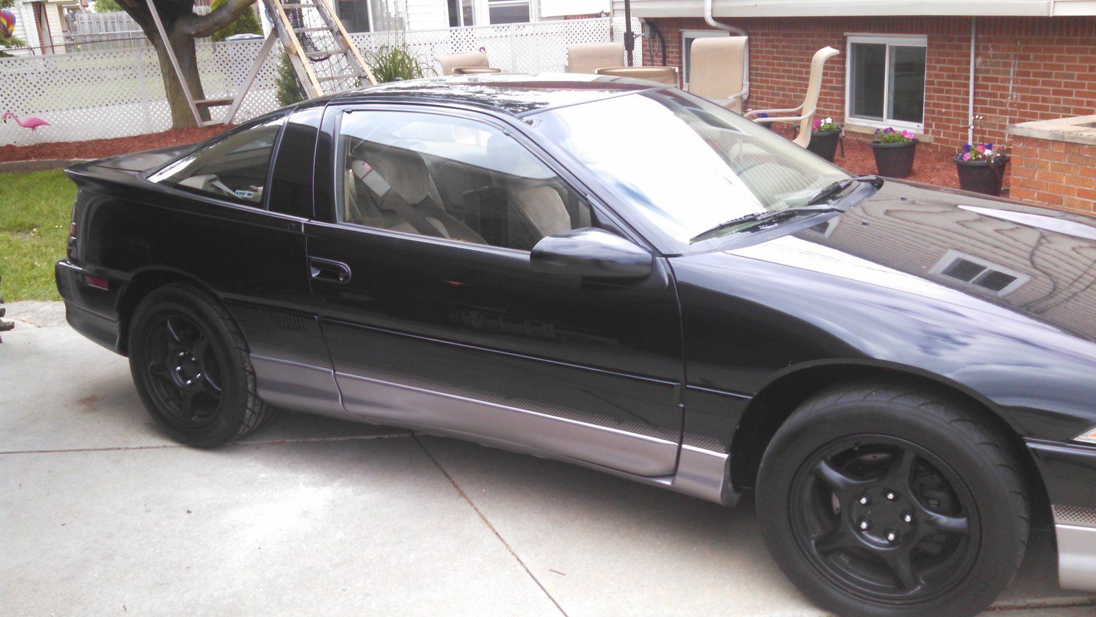

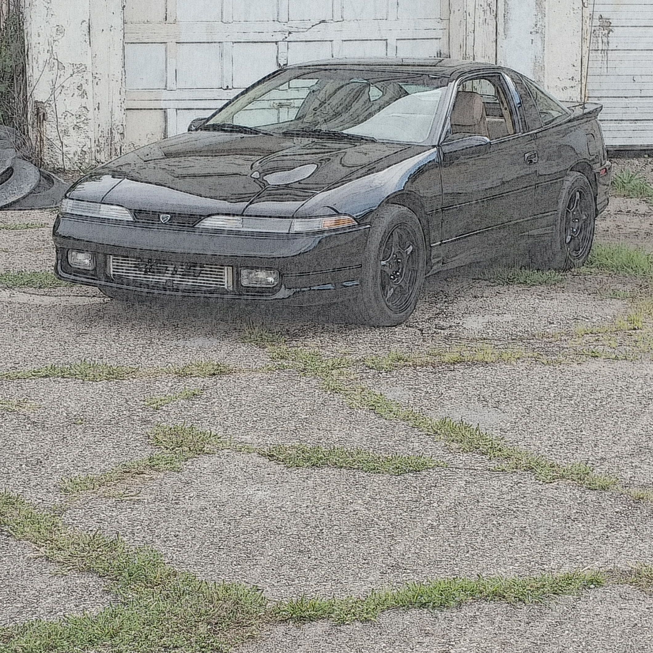

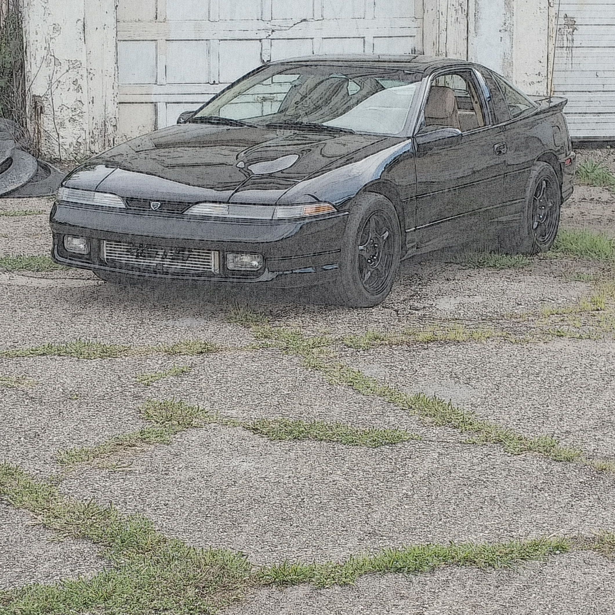

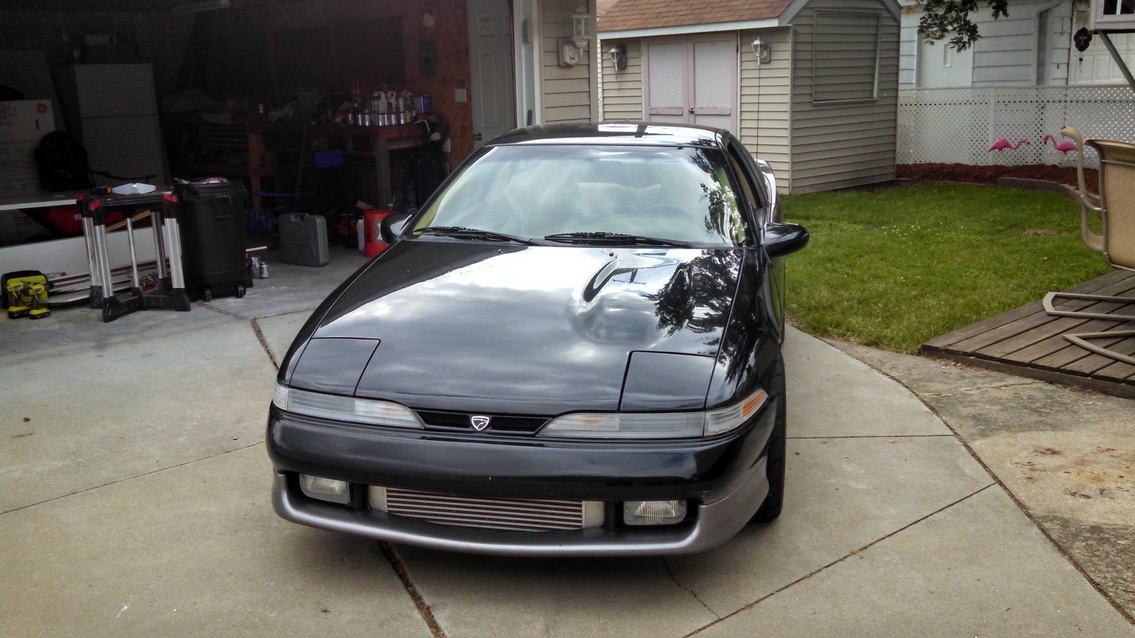

So the first two pictures are of the day I brought the car home and how it looked(keep in mind I bought this car fully built driving and running). about 2 weeks after I bought this car my cousin was getting married in Iowa so me and my other cousin jumped in her and took off at about 1am got there about 10am. made it the whole way on E-85! averaging about 19MPG. not to shabby and round trip cost in gas was about 75$(even though we seriously stopped about 6 times on the way there for gas and 5 on the way home LOL.)

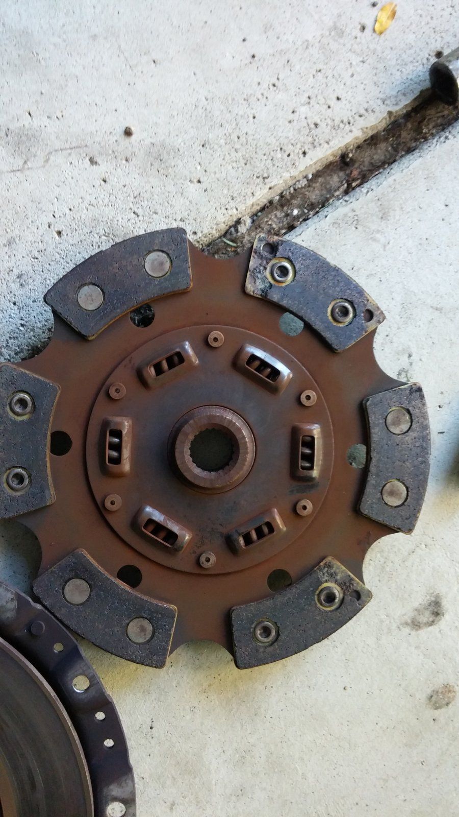

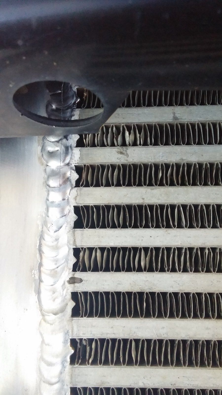

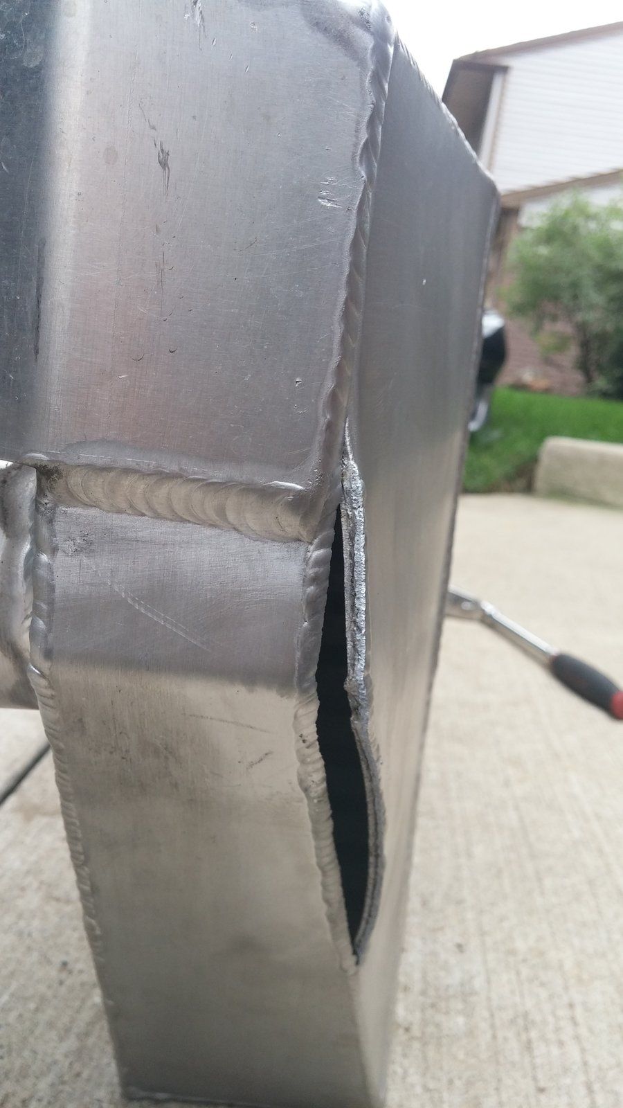

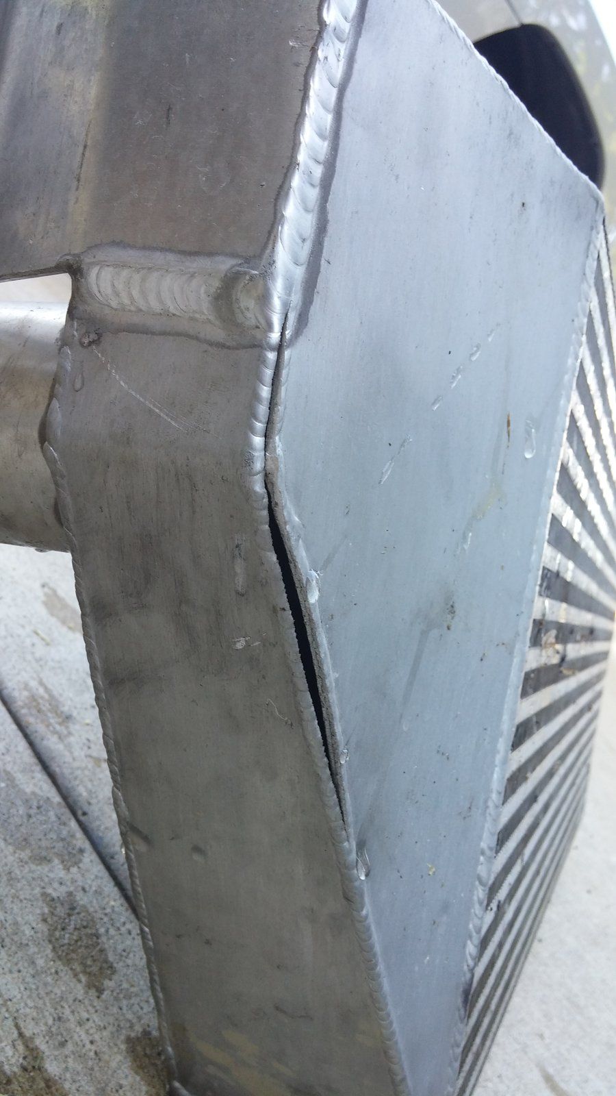

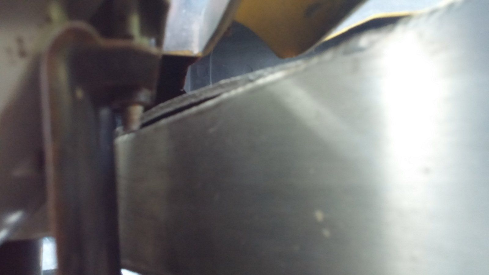

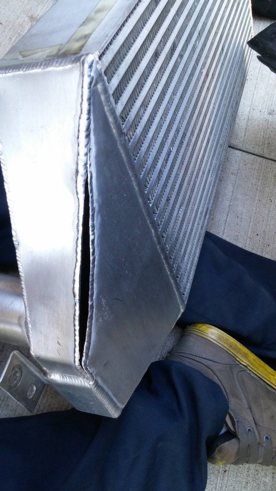

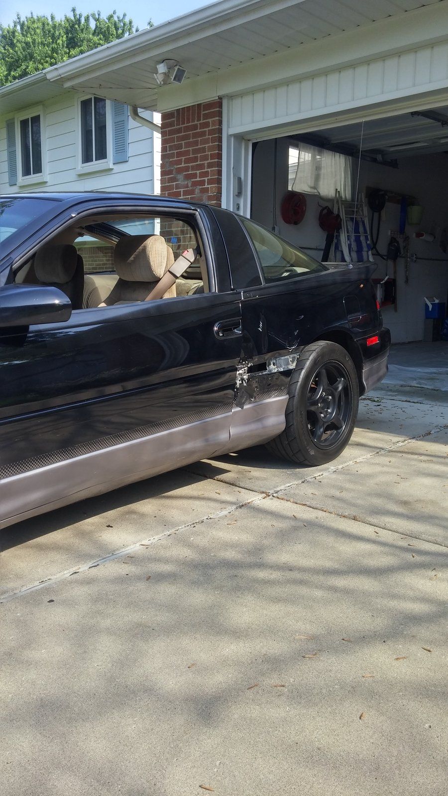

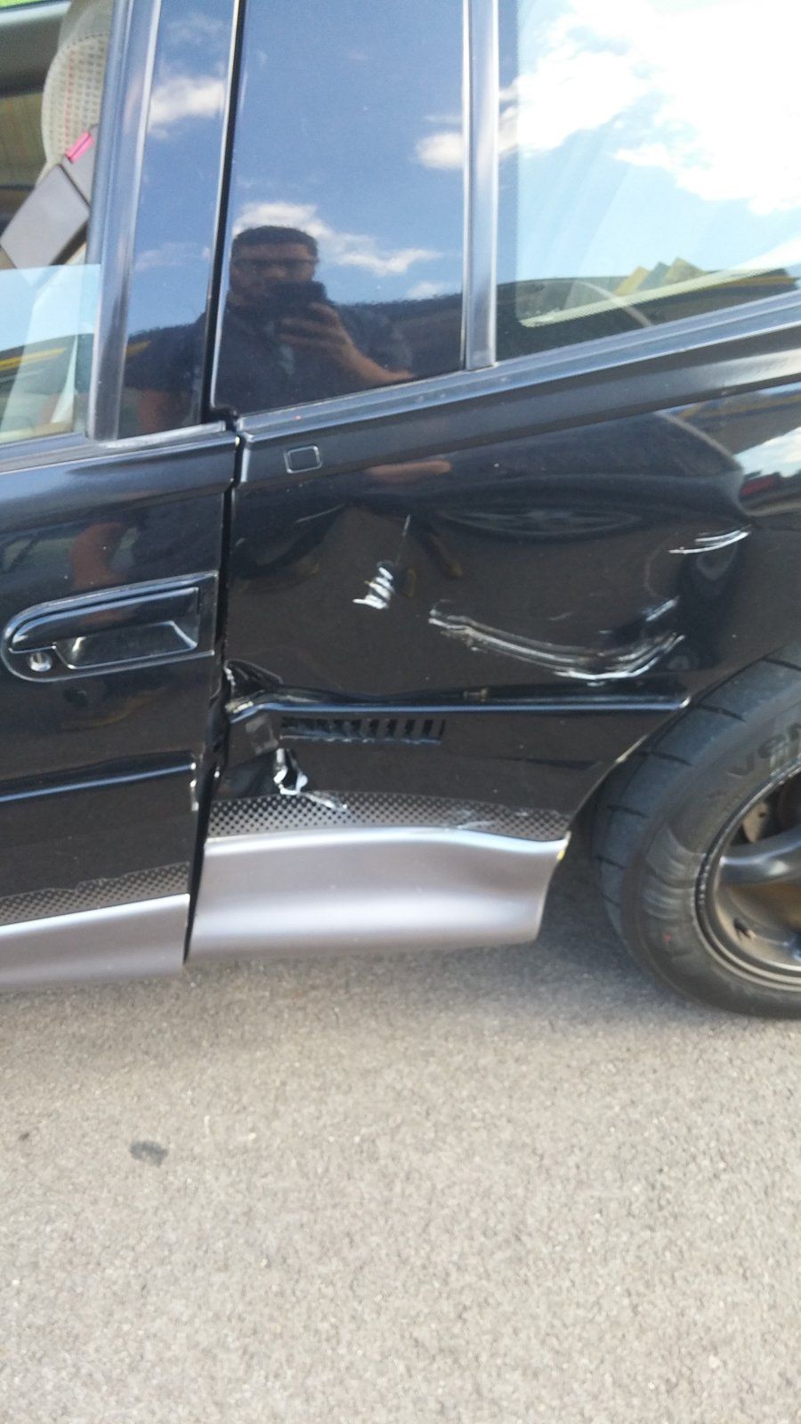

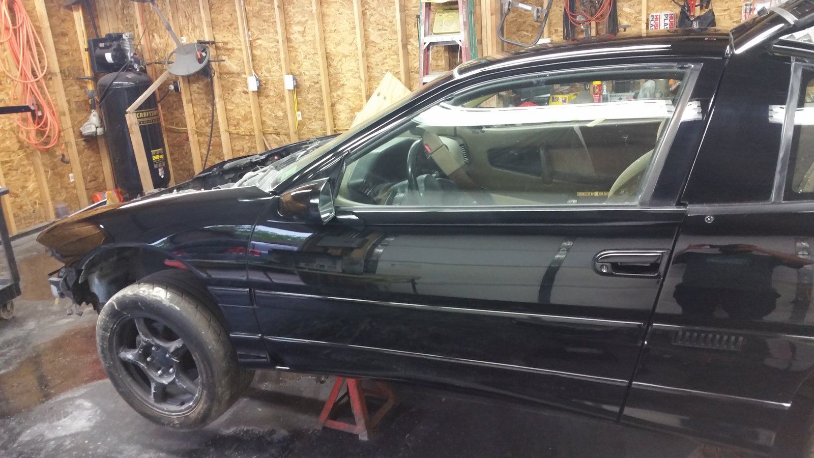

Now comes the fun stuff, issue one. driving around all of a sudden no more boost uh o. do a little boost leak to find my intercooler is cracked, pull it off take it to work get it rewelded, issue solved Right?? nope about 2 days later pop again different spot, take off intercooler get it welded install drive and again....this happened like 6 times, I tuned the boost down to about 25 and it still kept popping, well I didn't have enough funds at the time to buy the ets I needed so badly, so I just kept band aiding it. Well then one day I drive the car to work because my daily died on me up north(this was by far the worst week of my life ever) I was leaving work and right in front some lady blew the red light hit a jeep who came over 3 lanes and smashed the side of my car in, FML! o but it gets better, so the next day driving to my grandfathers for dinner gave it like 1/4 throttle to get through a yellow and bang, car comes out of gear. so push the clutch in nothing but horrendous grinding noises. pull over less then a mile away from his house and got a tow to his house(luckily this is where I was parking it that winter so winter started early for me). tear it down to find out I blew out the splines on the clutch. so bought a new comp clutch 4 puck and threw it together got it running again the next year. didn't drive it much because of the intercooler issues. nothing major or interesting happened this year just drove it around all banged up because well it was fun to have people in nice new shiny cars laugh at the damage of your car then leave them in the rear view mirror. so winter came that year pulled the motor and trans and emptied out the engine bay as much as possible and sent it to a good buddy of mine I used to work with who painted this car and did all the body work for me and it came out stunning! yes this car was painted in the garage not a booth. so I got it back from him cleaned up the engine bay a bit and then started installing motor trans etc. I FINALLY got my ETS 3.5" intercooler got that installed and all new piping put on and bam good to go! drove it around barely that year I put 600 miles on it that's its. I was just afraid of getting it scratched because I just spent so much money on getting it to look this good. parked it last year went over there about 3 weeks ago and got the car fired right up and went cruising with my cousin for a little, not a bad day. now we are here cars back home and trying to sort out this weird bug I seem to be having all of sudden. tonight im digging into it more and will hopefully resolve it once and for all.

Car looks really nice!
Ahh, you had the old SBR fmic. Those things are notorious for blowing welds. As a matter of fact, I had one just like it and got rid of it for an ETS kit due to blowing welds. I sold the stupid thing for $50.

Yea i blew the welds about 6 times had enough of the bs. The end tanks are to big for high boost applications and expand and contract way to much!
