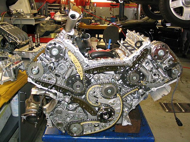

Oh, did I mention that the timing chains are on the BACK of the engine? Audi has 4 or 5 different 4.2 designs and they designed this one to be stuffed into where a 1.8/2.0 4cyl or a 2.7 v6 is supposed to go.

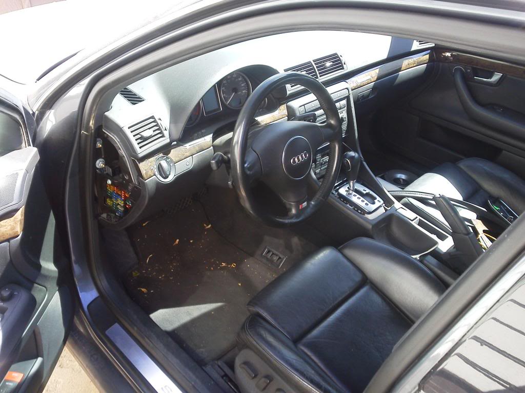

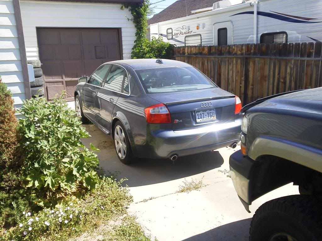

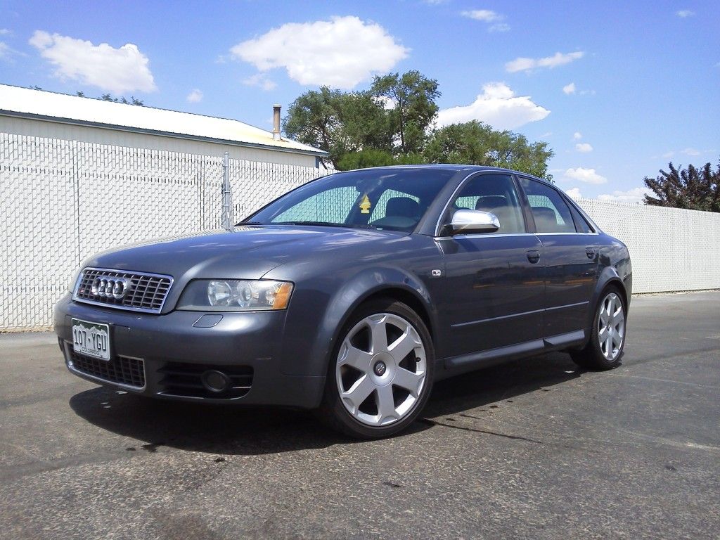

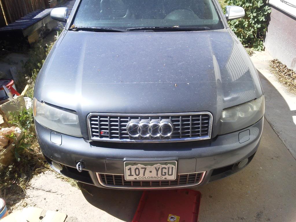

The S4 when I got her

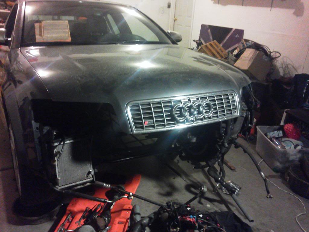

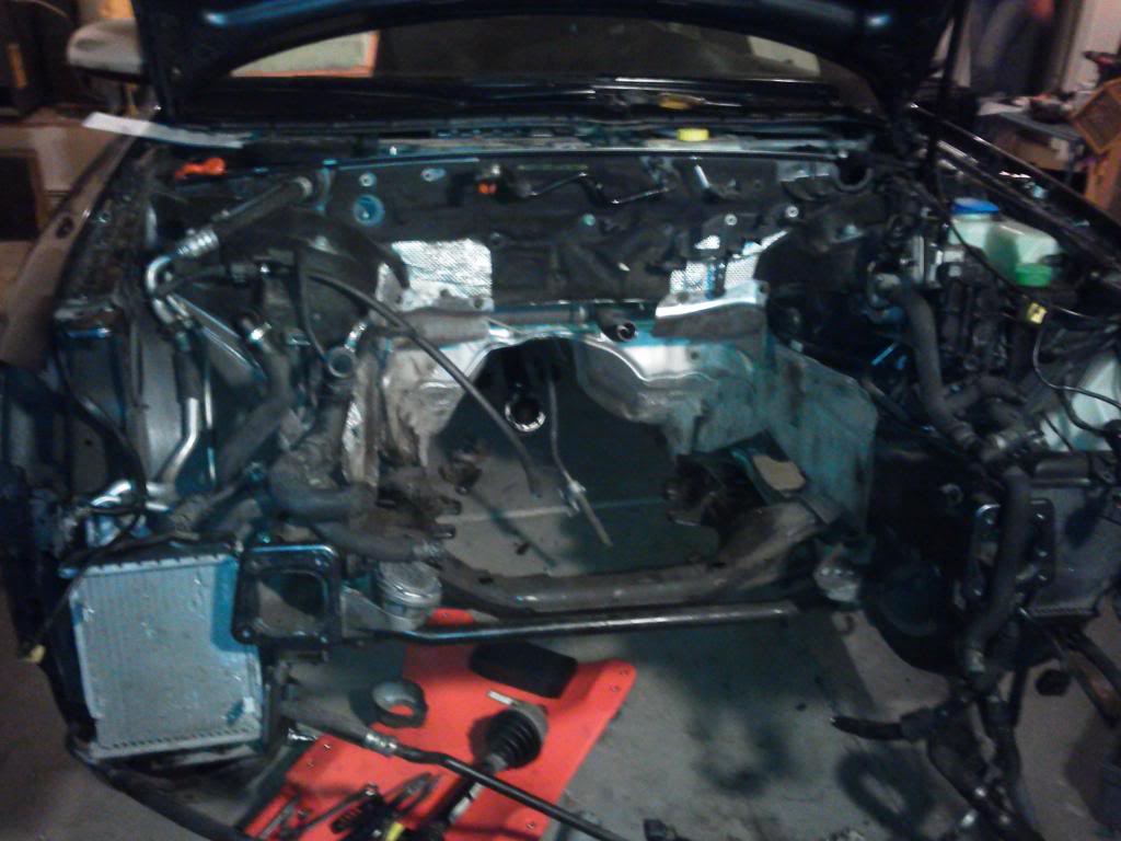

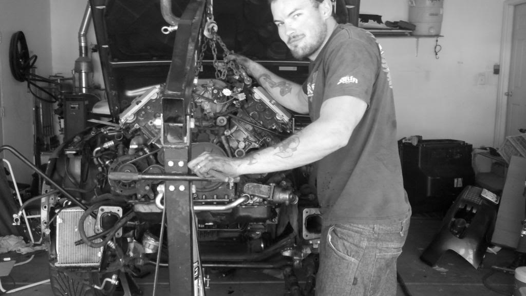

and now out with the crap 4.2!!!

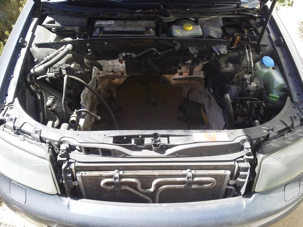

Gone!
The wife wishing it a fond farewell in the back of the z71....
at the new house
looking so lonely

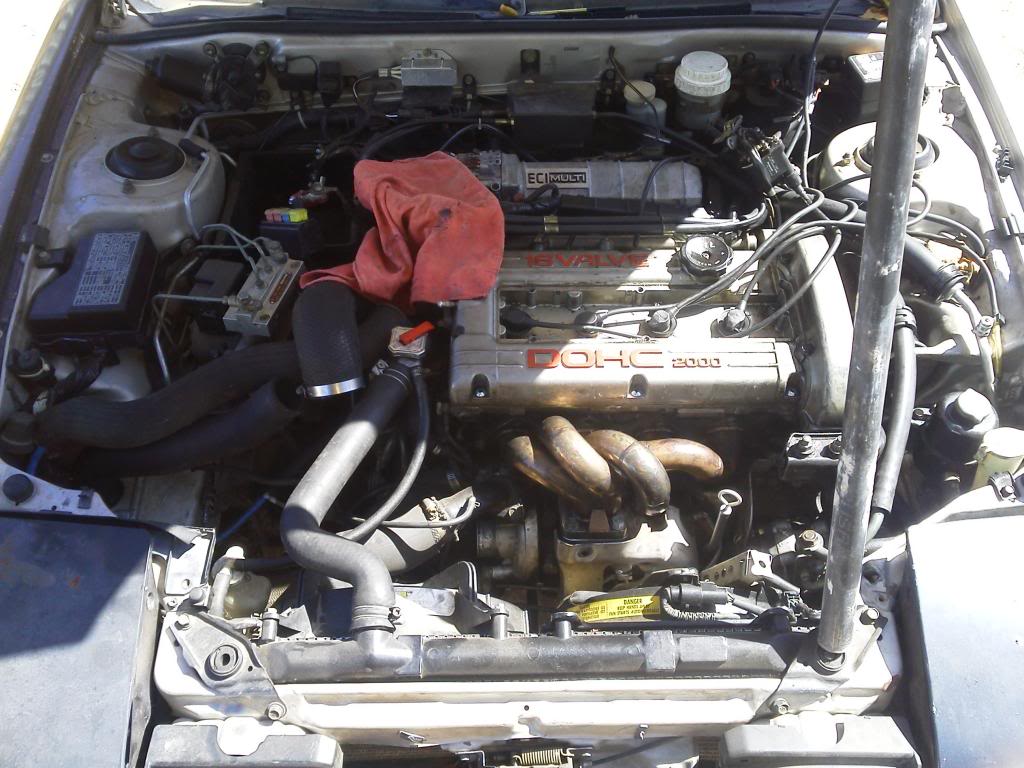

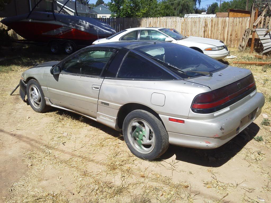

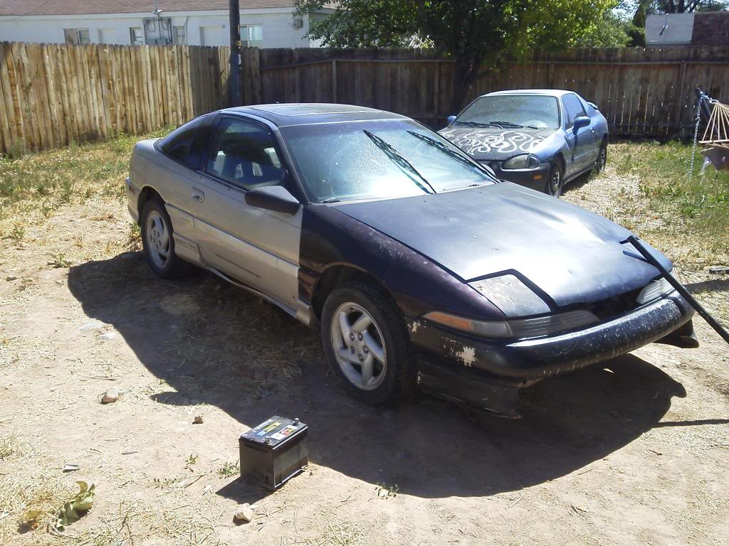

The 1g sitting in the backyard with its yardmates

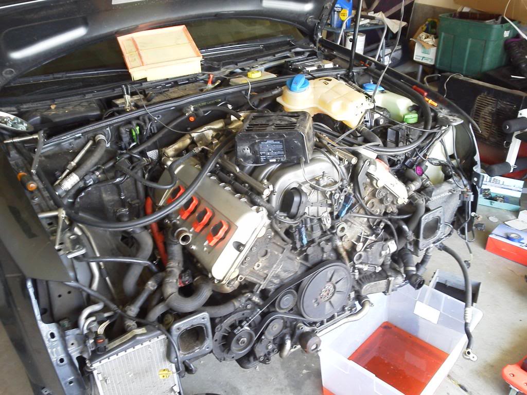

here is a pic I found of the BACK of the S4 4.2
I was actually looking a b5 s4 before this one.. (I should have got it). A few people have swapped the 2.7tt into the B6 s4 chassis with great success, but I like to do something different and off the wall. The S4's suspension and steering is absolutely beautiful.... but they need to get their priorities together with their electical system and simplify their engine designs.
Jesus look at that timing chainWTF Looks like four chains there I'd say. Wow! Glad my MB is not like that. However im sure the Audi gods are screaming there heads off about this swap!:thumb: Looking forward to seeing this build. Think I would have gone 2jz with her though because its a heavy car. This should be a blast though.

Jesus christ. DSM guys complain about timing jobs with our engines.... imagine doing this....:barf:

I have done timing chains on a 4.2 s4 when i was at audi. They arent bad once you get them apart. The 4.2 non fsi is a dog of a motor, so the 4g will be much better. Lighter motor too.

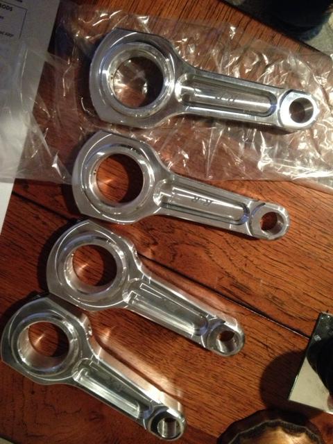

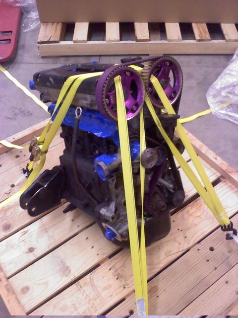

Got a good deal on a fully built 2.3 stroker to fit in the audi and get all the kinks out while I build the 2.0.
Engine Specs:
8.3:1 wisecos
Eagle rods
4g64 crank
H11 headstuds
Fully ported 1g head
Si +1mm valves
Si dual valve springs
Kelford 280 cams
HKS cam gears
5 angle valve job.

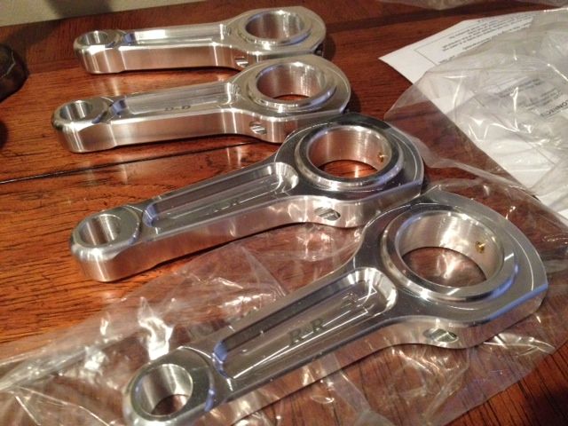

Engine already dyno'd 703awhp with a hta3794. I also got my Bill hincher 4g63-to-sbc adapter plates. Also ordered R&R pro aluminum rods for the 2.0L. Looking around for a good th400 or 4l80e right now. Will be running an s366 at first
