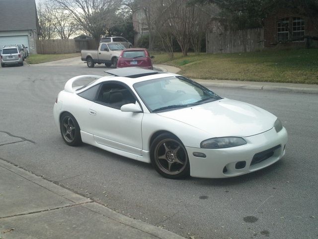

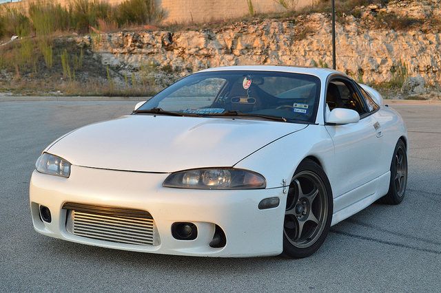

I purchased the car in January 2014.
January 2014:
April 2015:
Everything on it was stock aside from:
  • Greddy RS bov
  • Greddy intercooler piping
  • APEXi gt downpipe and exhaust system
  • Intake w/ K&N filter
  • Tokico Illuminia shocks
  • Eibach pro-kit springs
  • Large, ghetto stereo system
  • GSC zero tick lifters (I added these, put took it to a shop because I was naive and held zero mechanic experience.)
That stock-ish life though
