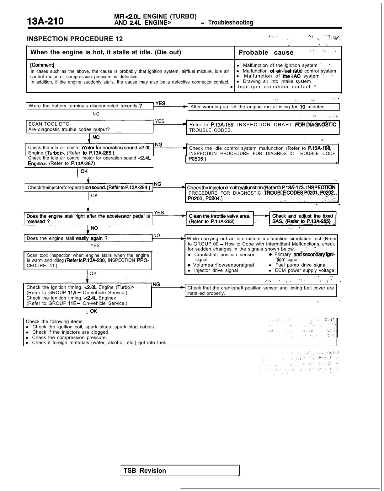

I'm in agreement this sounds like a control issue. Additionally an IAC valve can cause problems if the idle is not set correctly. When the car is cold it runs. After it warms up you run out of range on the IAC. Setting the idle correctly May fix this problem.
