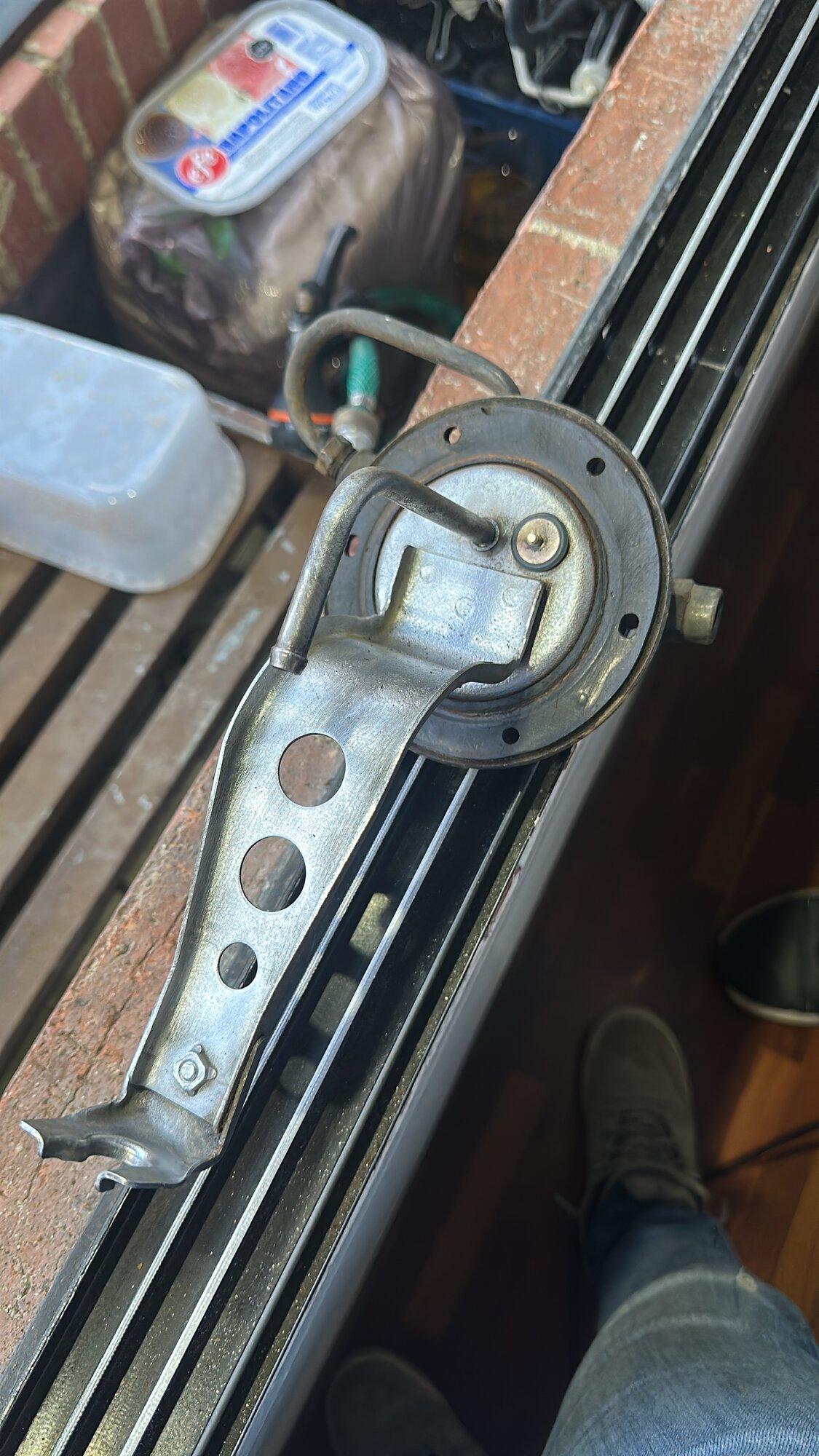

So some friend told me to put the sending unit in clorhydric acid and I did. It removed all the rust from it. Then I washed it with sodium bicarbonate and after that the parts that were not reached by the CA got cleaned with a brush. This is the end result. I'm actually quite happy :)
Maybe tomorrow I will be putting it all together in the car and filling it up with gas. THEN SOME CRANKING TILL IT STARTS

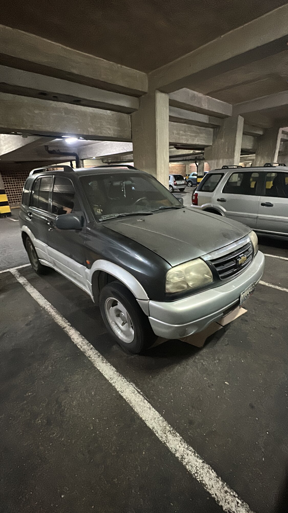

Really happy to see that people care, rn my Vitara and uni got my tied up, but that thing is gonna run this year. Shout out to my broken Vitara, it gave me the motivation I needed to get back in the project and fall in love with being a mechanic once again.

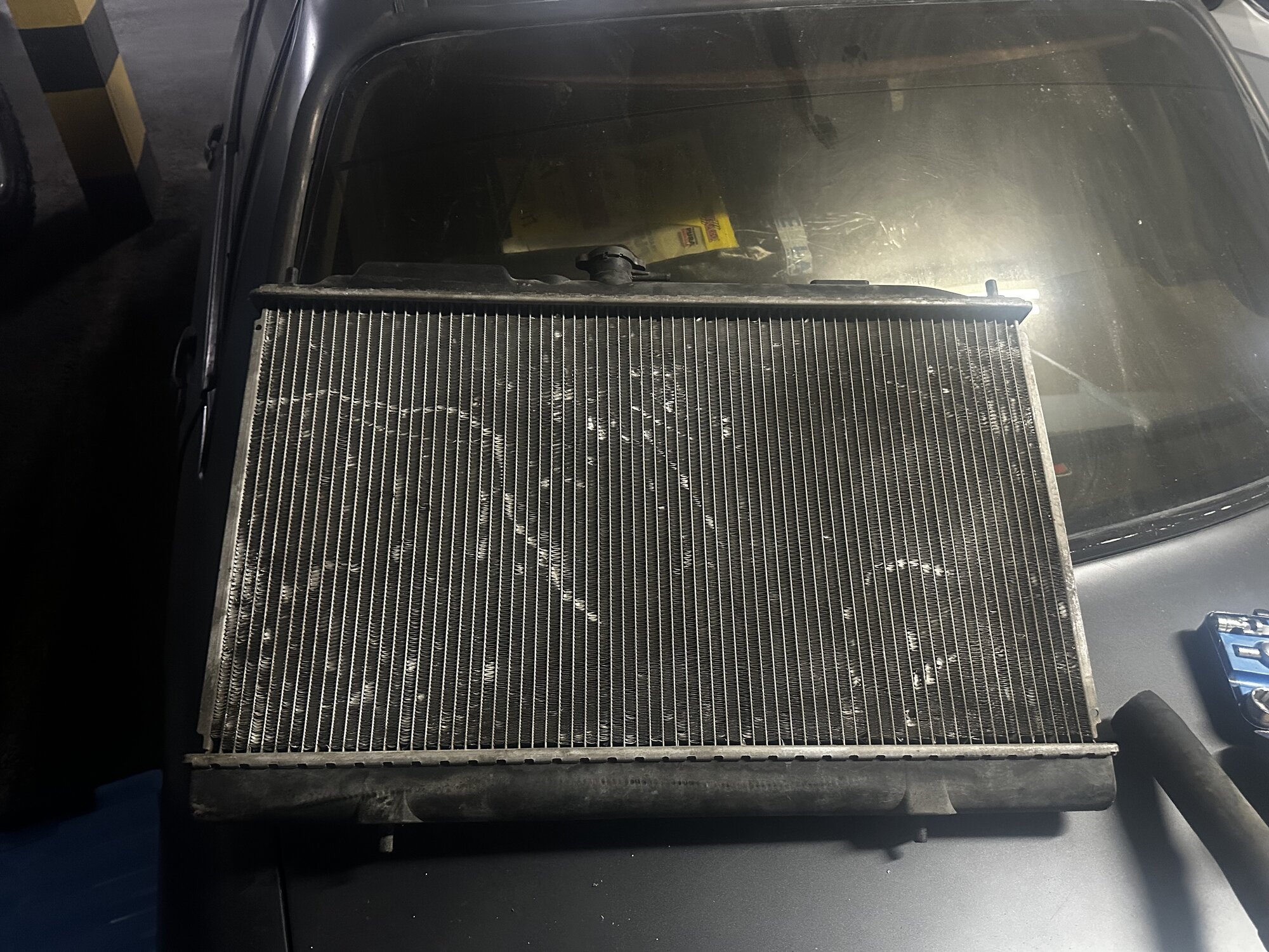

another little step! I'm sending the radiator to get checked, hopefully there will be no need for a new one.

Greetings. I think I'll be hearing from the radiator shop today or tomorrow, hoping for good news.

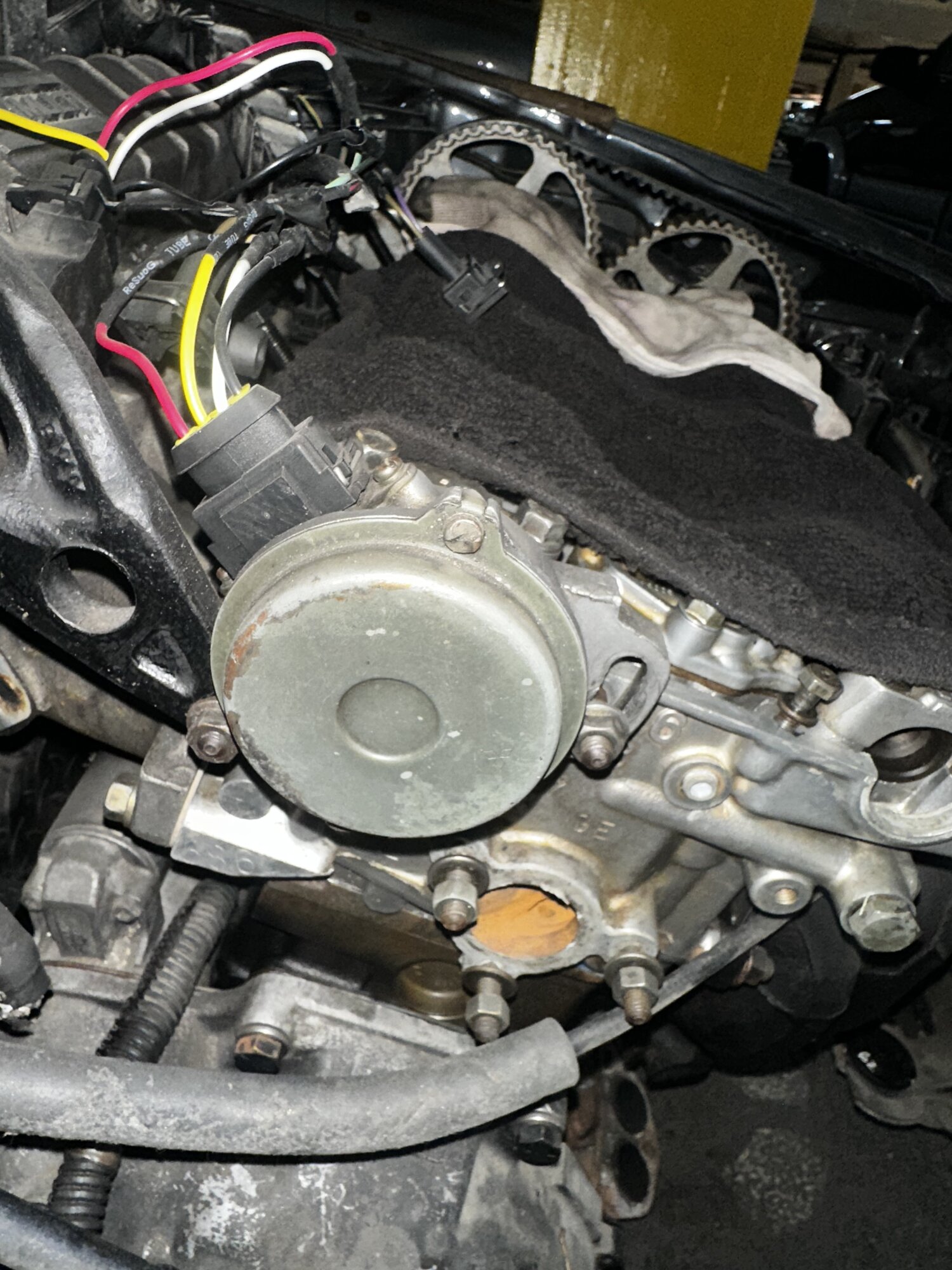

First, is this the right CAS for a 1991 model?

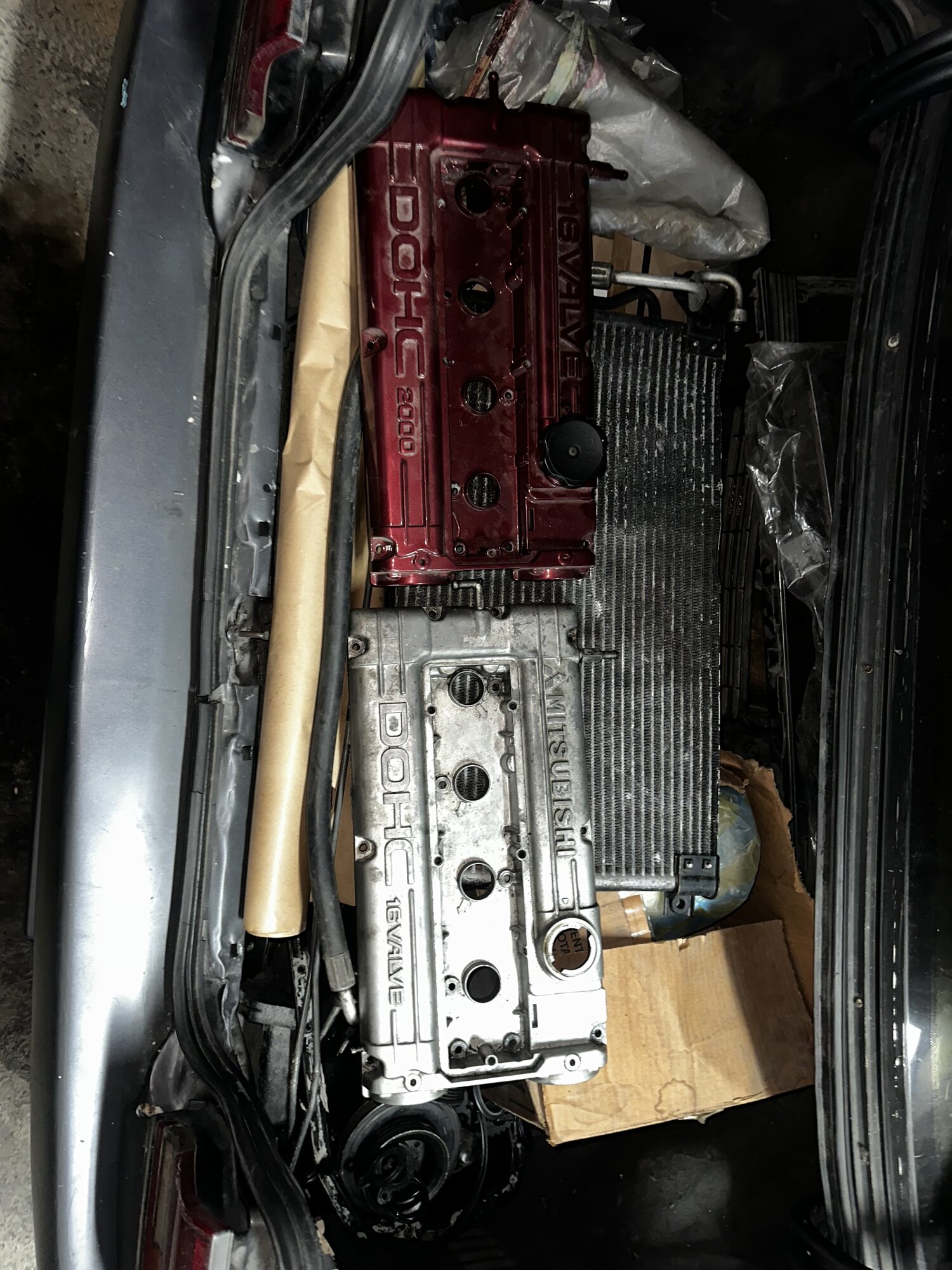

Second, got these VCs, want your input in which should I use. The red/wine paint is going away

Good news! the radiator shop said it was all good and got it home. Installed it and fitted perfectly, but decided to put it in the back for now since I have to take all the wiring out and fix it. Many wires were exposed, broken or badly fixed; so I think is in my best interest to take my time with that and make sure everything is nice and tidy.

It’s def a green top 1G CAS.
But the 89-90 version I believe has the wires coming out of the top of the sensor,
Did you have another style sensor before ?

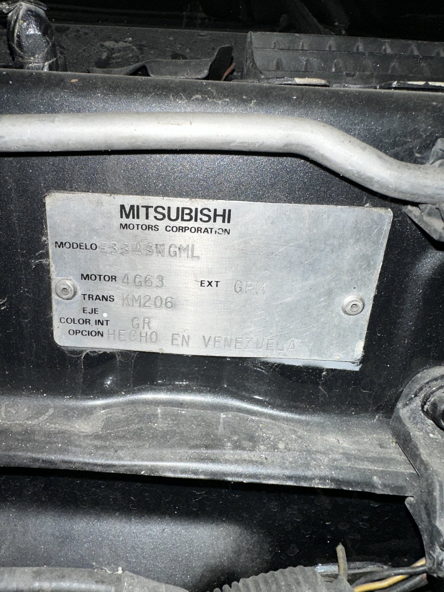

I really don't know, back when I bought the car didn't pay attention to any of that, but I think is the one that came with the broken engine. this is a 1991 model, SNGML to be exact. mmm maybe I can check the part number for the CAS. anywho, kinda pretty sure is the original one

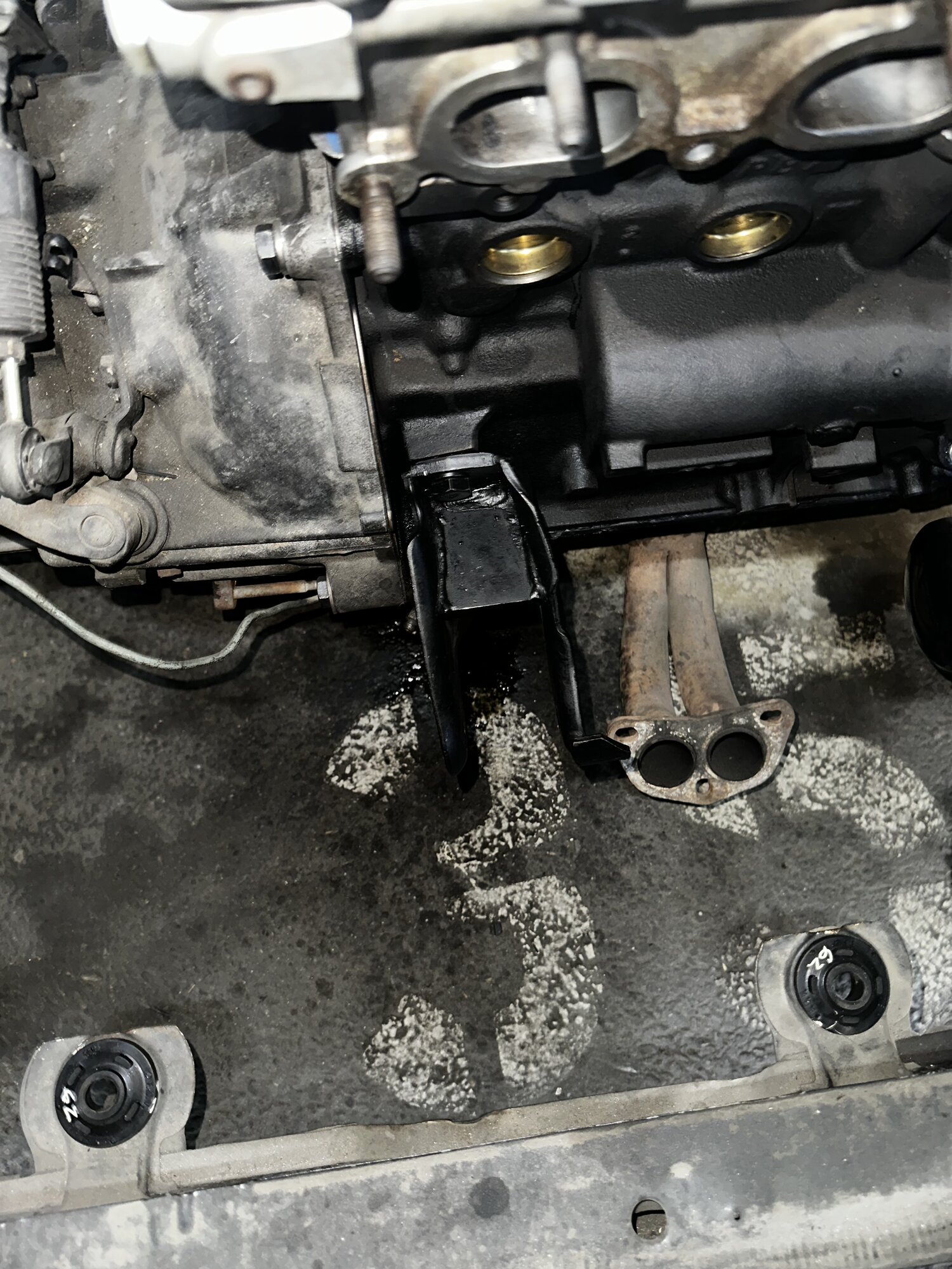

today I did some minor work, bought the engine mount bolt I needed, thermostat and front engine mount. Thankfully the threads on the block just required a minor chase, so that was done and the bolt threaded beautifully
After that I was going to put the cross member on, but the jack was in the other car and the jackstands in my room, so I got lazy and just left it for tomorrow.

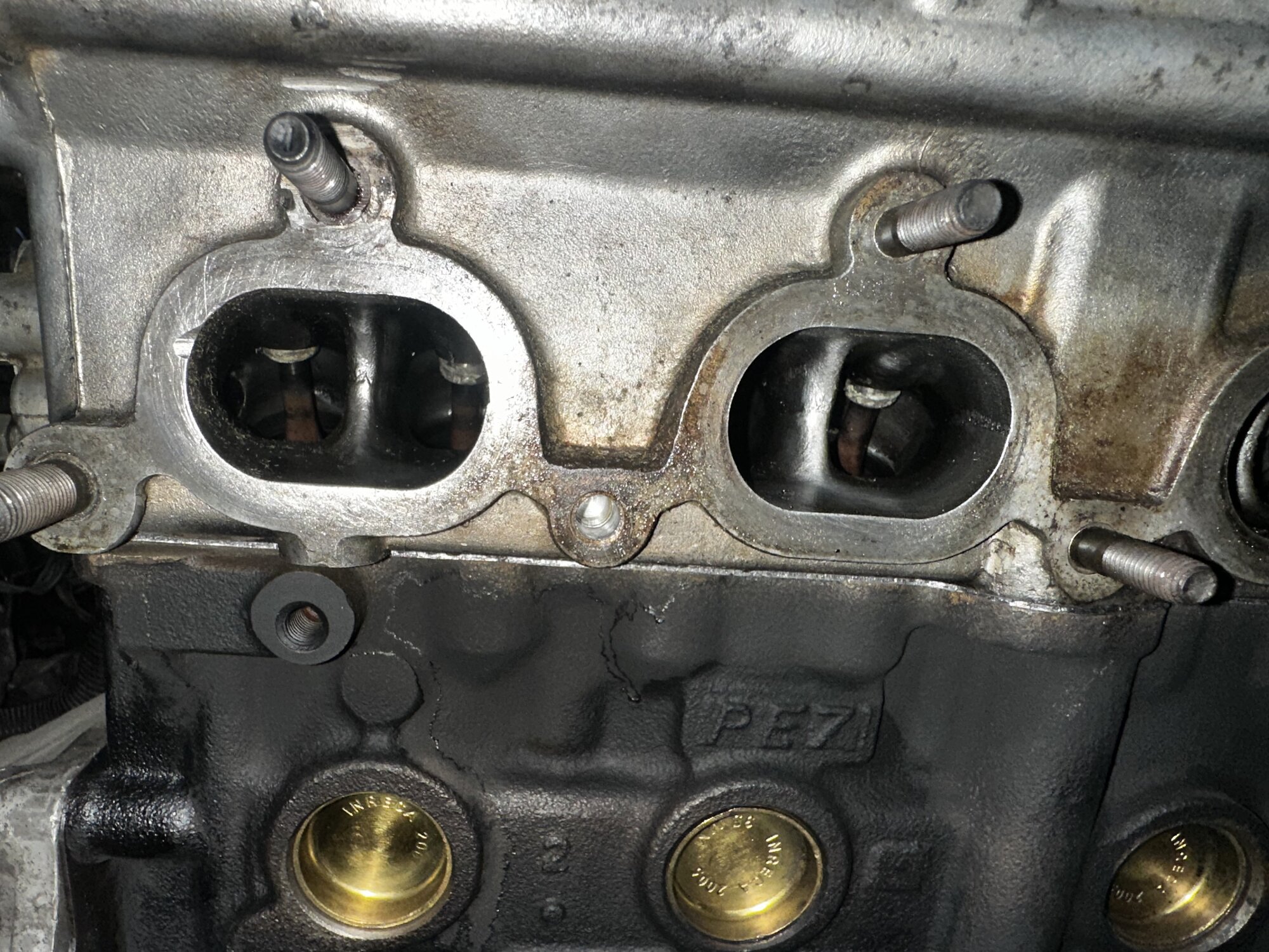

Also took off the exhaust and one of the studs pulled the threads. I knew about that back in May 2025 when assembled the engine but said "ehhh fudge it, we ball", but now I'll get the helicoil, probably a "new" stud and the exhaust comes back in.
For my very good luck, the stud that damaged the threads wasn't the one that goes into the head

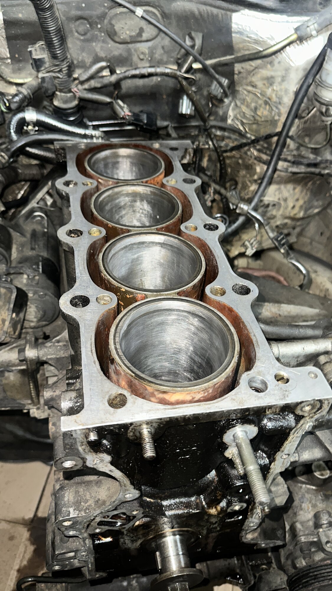

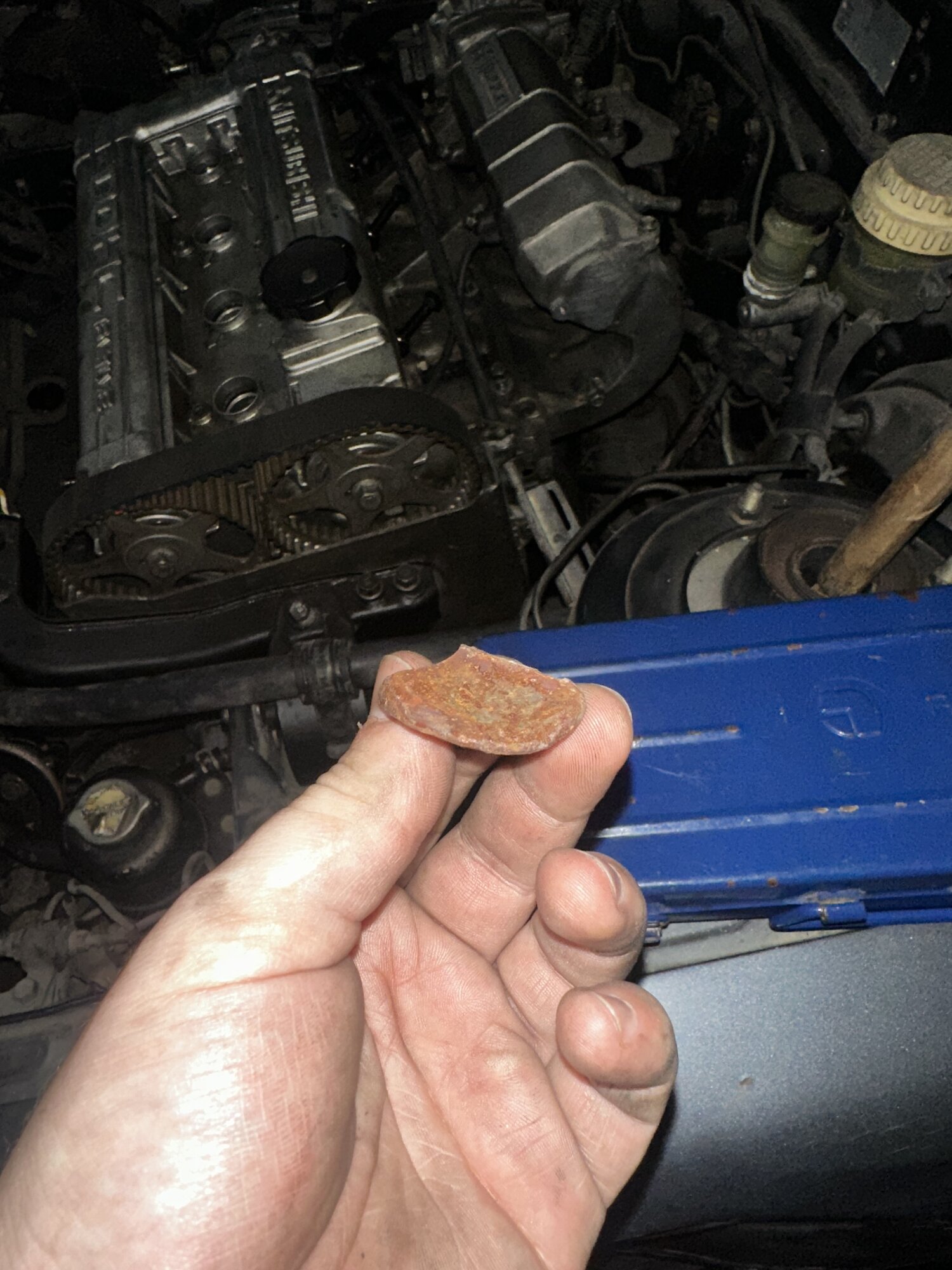

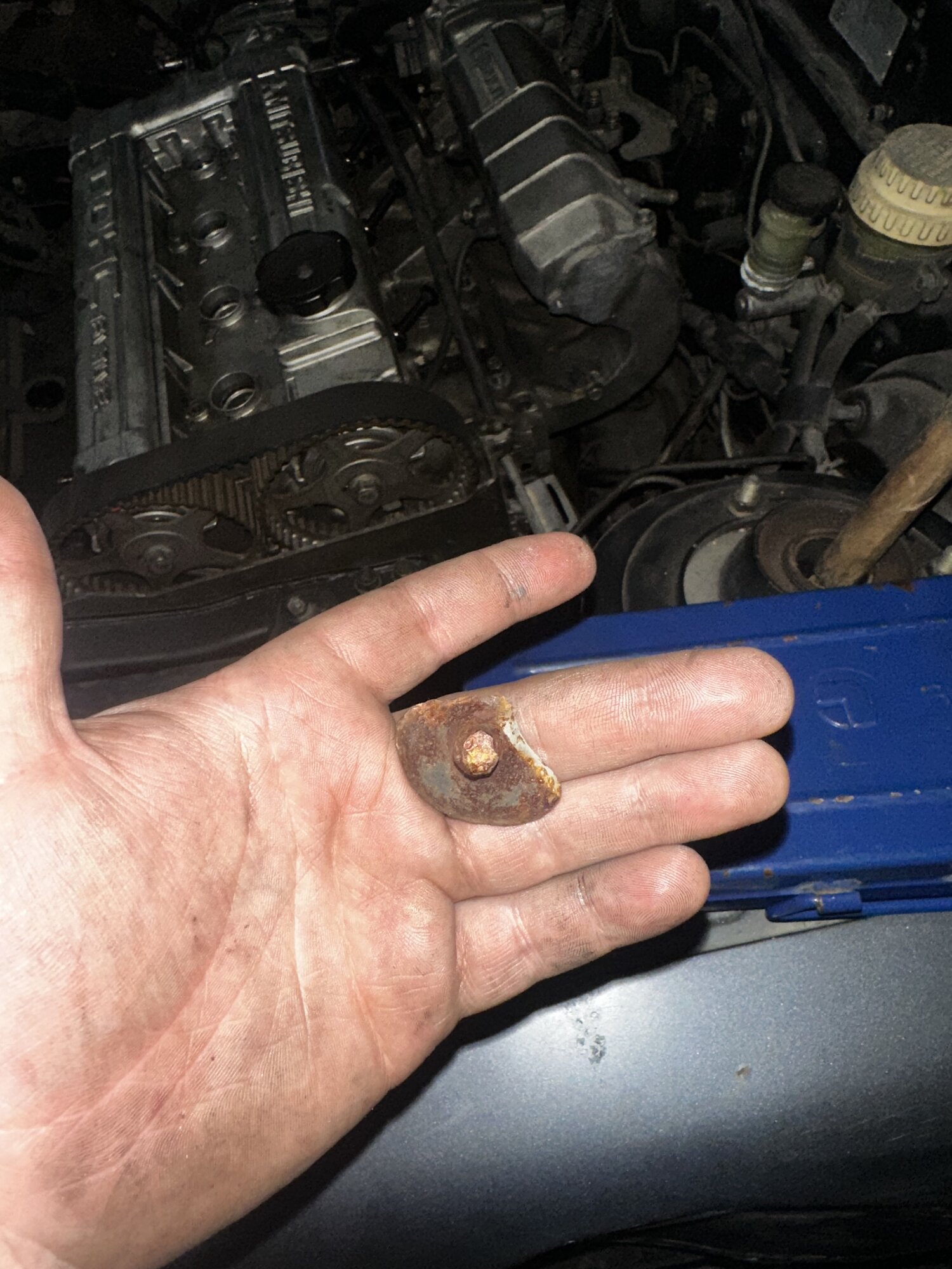

Also, was doing a little cleaning and found the culprit of killing the previous engine
(Can't remember if I shared the video of what we found in the engine the day the car got home)

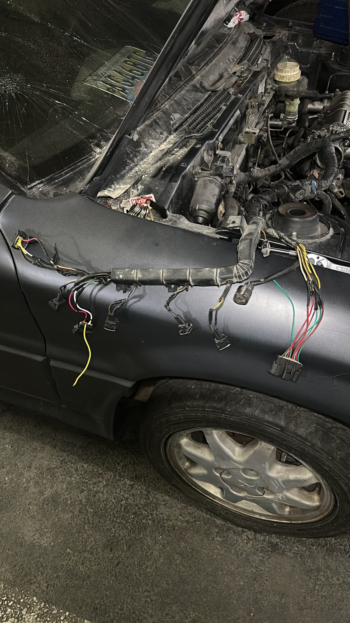

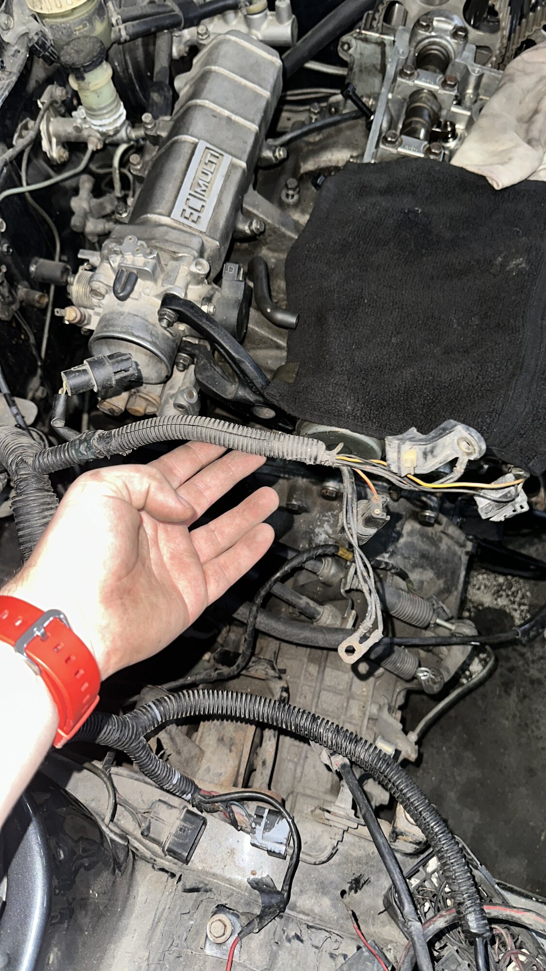

Lastly, took all the engine harness to a side and checked it for any damage. Last year some repairs were done (CAS, TPS, inyectors and Power Module connectors were replaced), I'll have to re-repair some of those since wasn't done pretty nice.

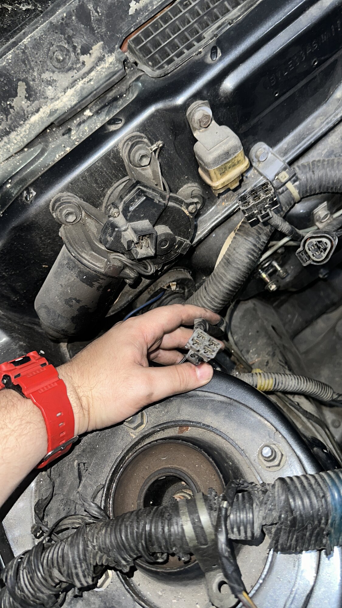

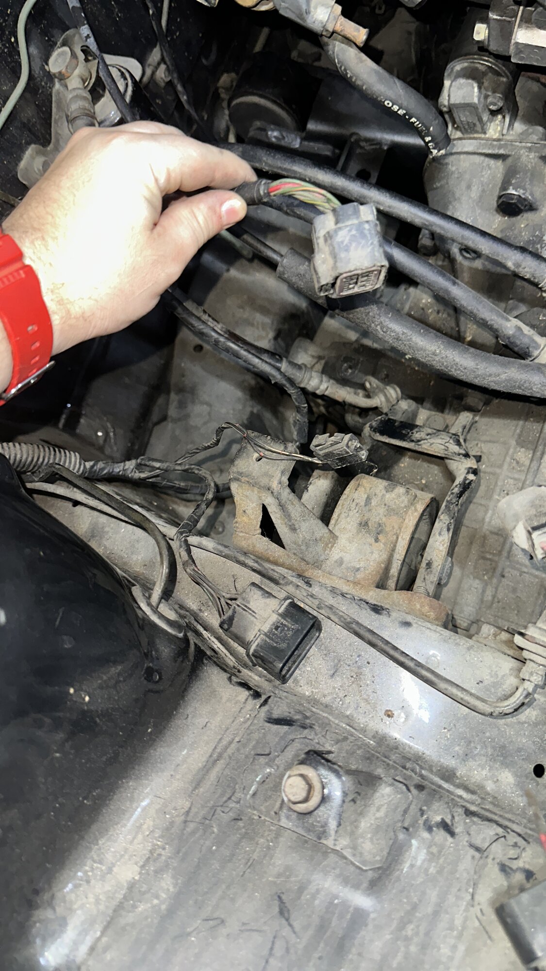

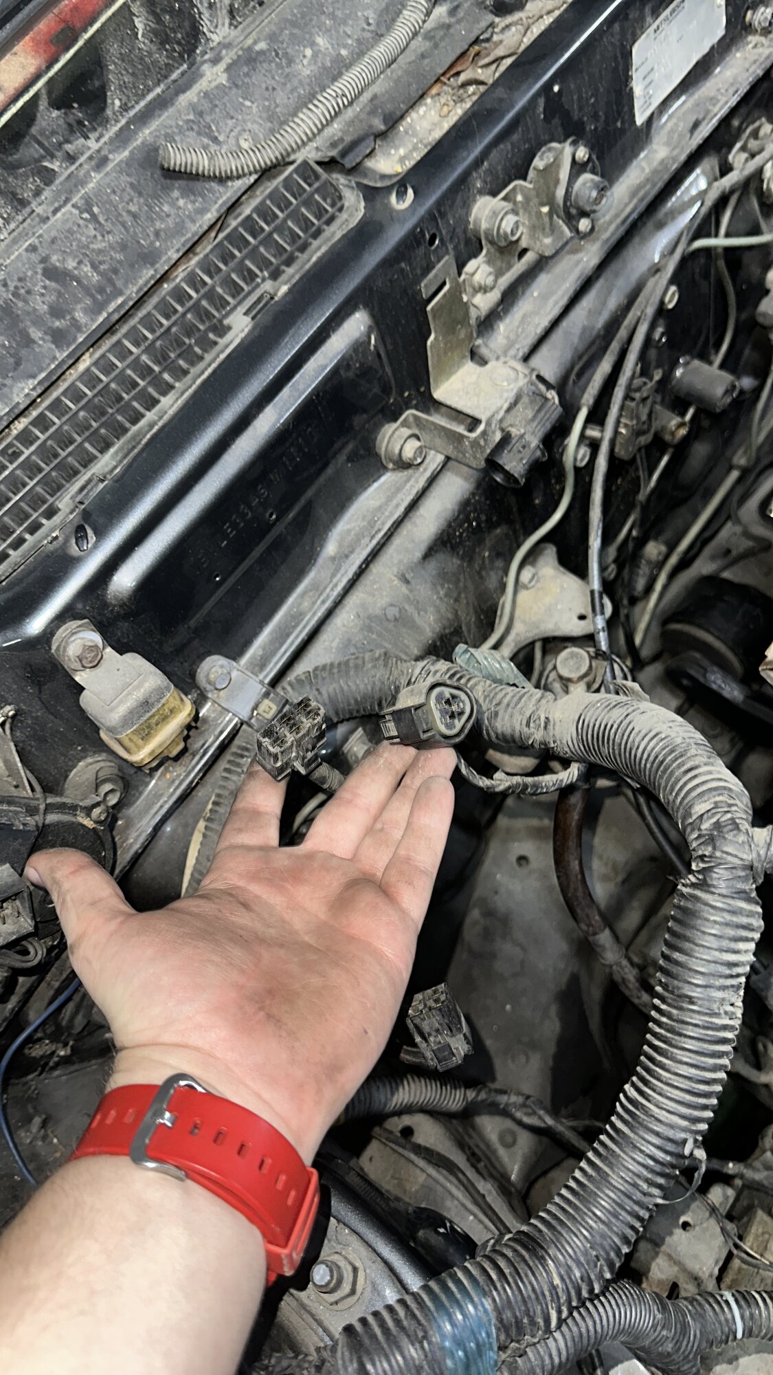

Took a video of the whole harness and many pictures. Some of the connectors are missing and some I don't know were they go, so I'll share it with you guys and hope someone can give some guidance.

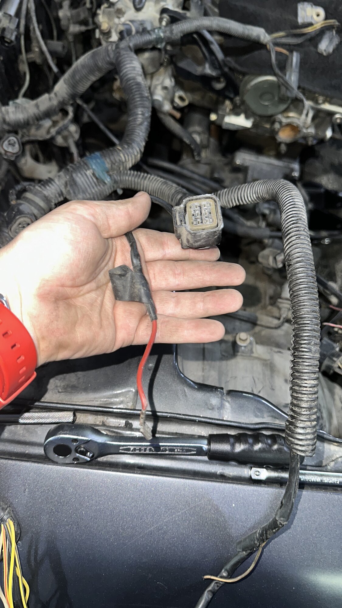

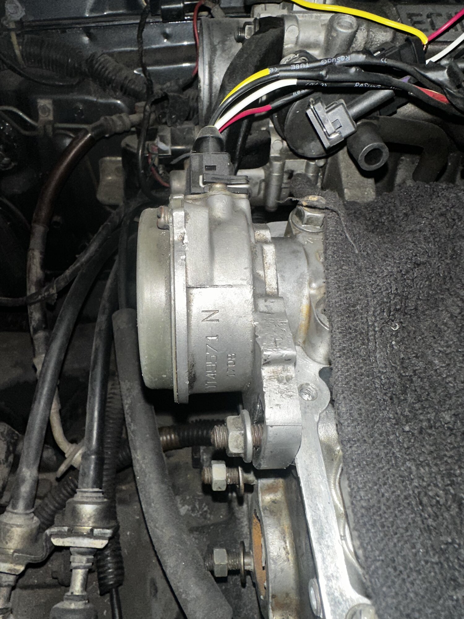

Here is the CAS, TPS, Inyectors, power module, coil, and that one wire that is near the power module I don't know what it's for
IIRC those are IAC and the one that goes on top of the throttle

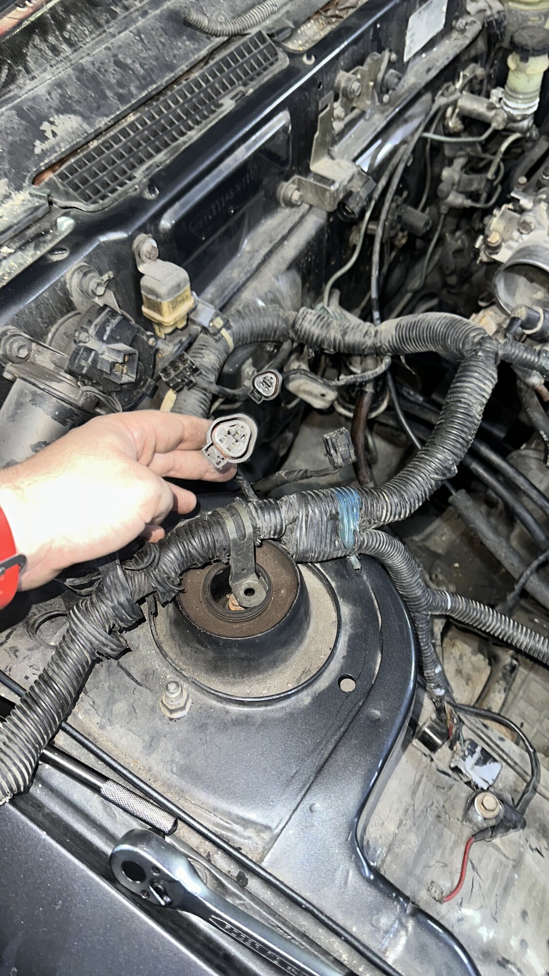

These IDK and there is a bare wire there
I think this is the AC compressor

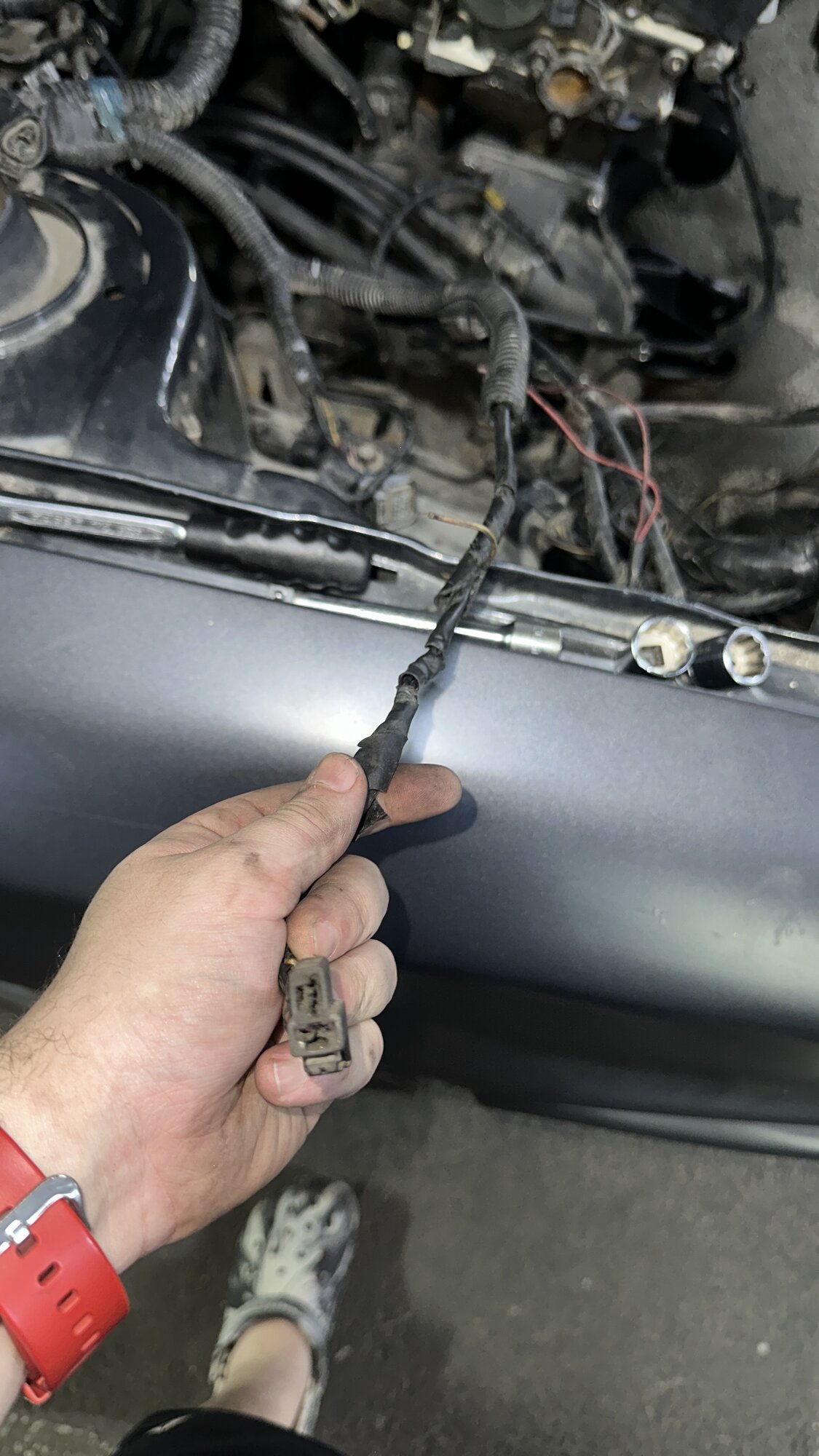

This is the one part that goes near the break booster
These are pretty obvious were they go. Don't know the name of the parts or what they do, but at least I know where to plug them
Didn't know what it was, then realized it was the windshield wipers motor
The one I'm holding most probably is the MAF one, the two wire connector IDK, and the other connects to the harness that comes from the fuse box
All in all, I think this side of the harness is in acceptable condition, still gotta figure what some of those are/go

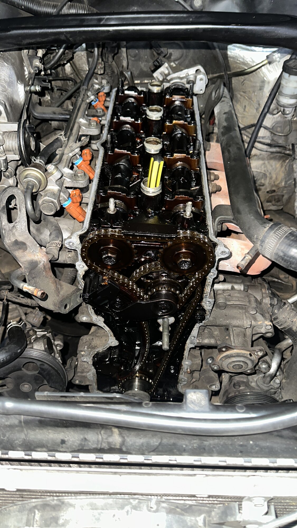

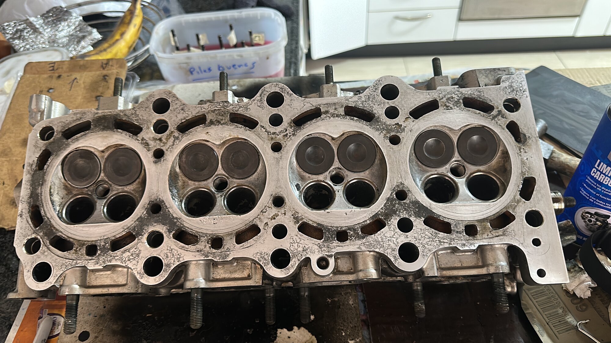

greetings, everyone. About a week ago I was doing some work to the car, was nice, but i think I will be taking a couple steps back with this engine. When i first assembled it in may 2025, when the cam caps were torqued, the camshaft wouln't turn. I had some old cam caps and "cleaned" them up, installed it, so it turned. Back then I just said "f*** it, we ball", but 2026 me kept thinking about that, making me call a pretty good machine shop, that's also pretty far away. The machinist called me, itialian guy, we talked for a bit and the conclusion was that the engine should be taking apart, checked and reassembled. Thankfully I hace every gasket I need, and actually there are some part stores that sell the eristic gasket set. A little step bacj, but don't want to see that engine blow up at the first start after all the time and effort ($) I have already given it.
So, the engine is coming apart soon, but in the meantime I'll move forward with some other things in the car

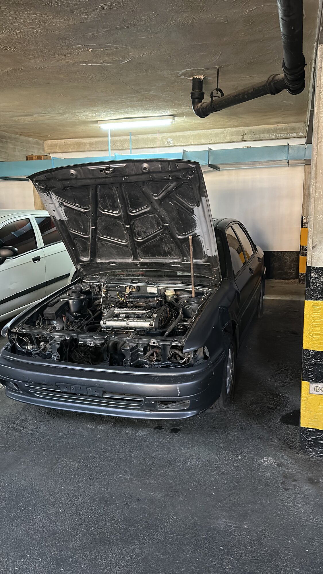

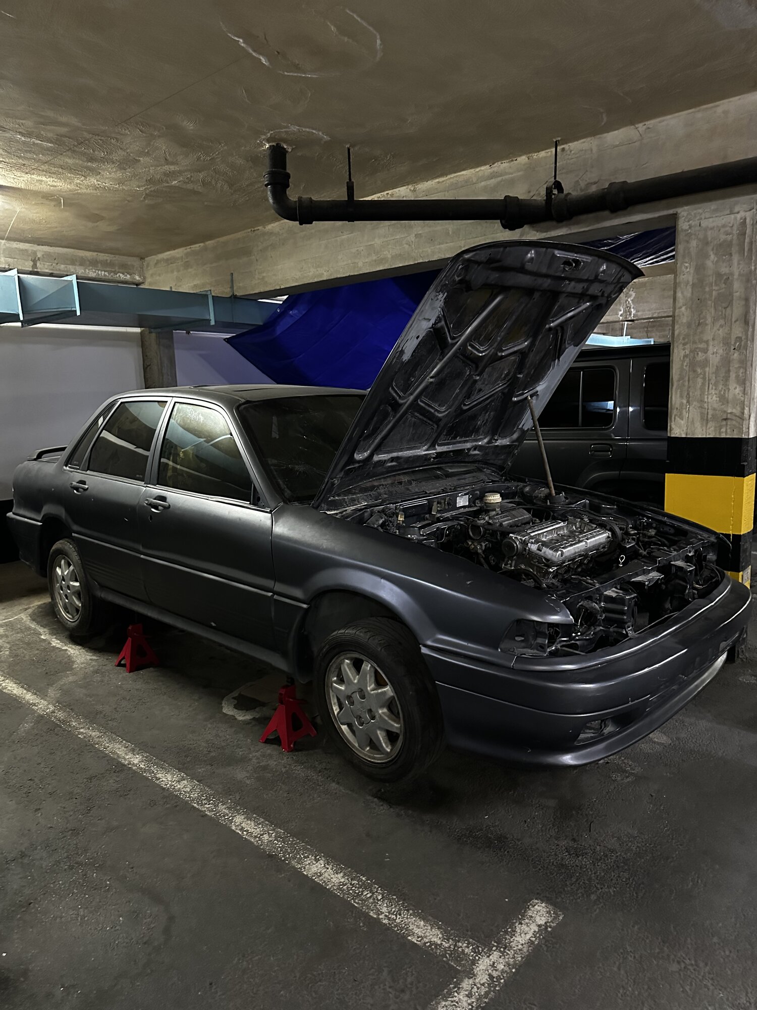

Here is a photo of the last time I worked on the car
