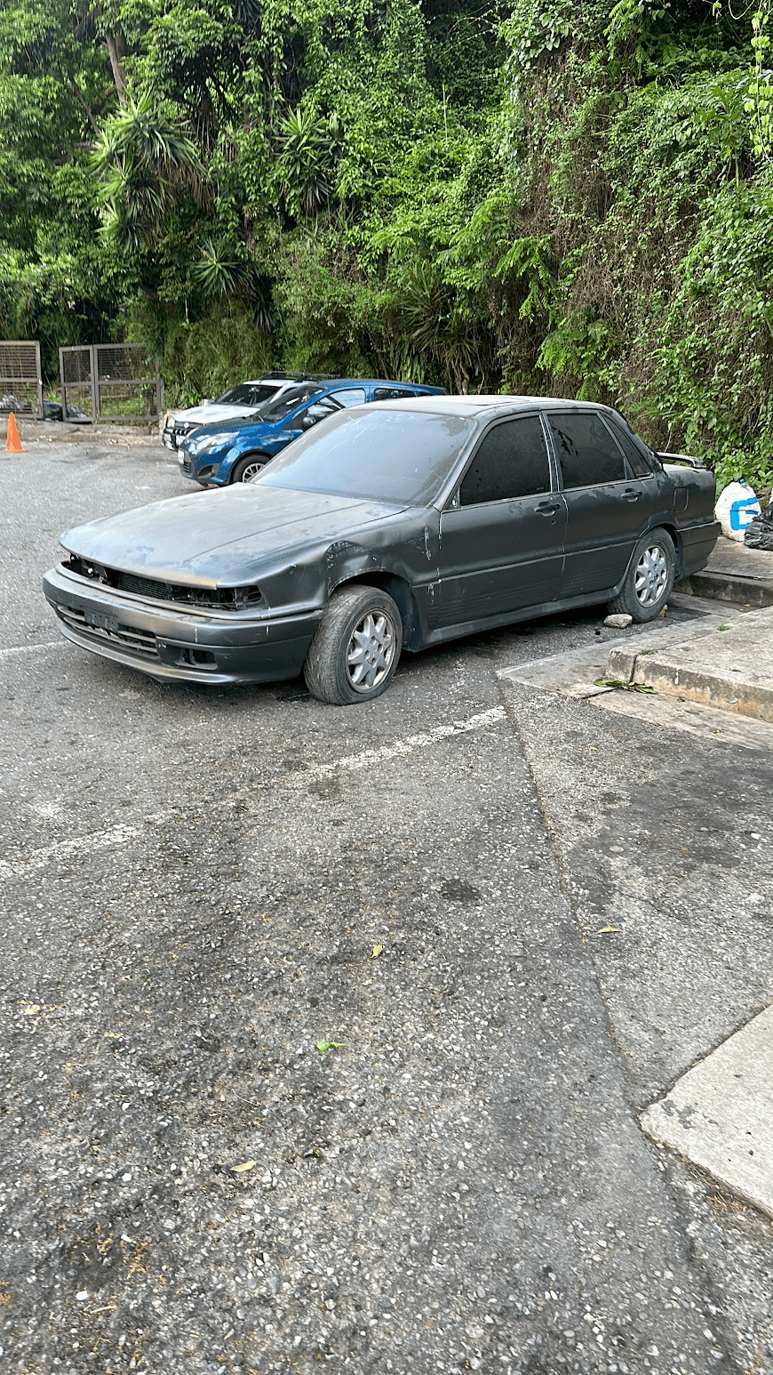

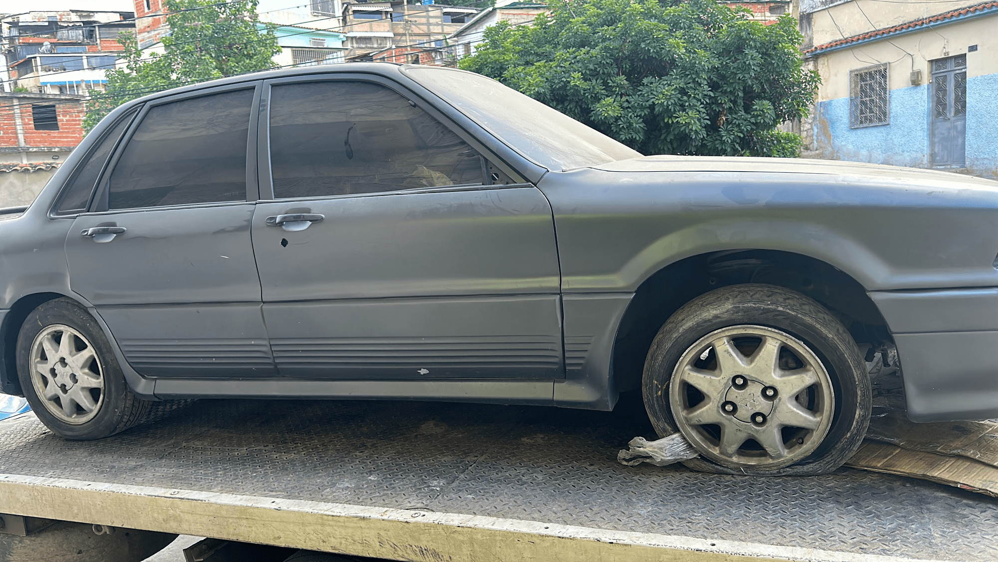

I'll start from the begining. I bought the car in June 2023 off one of my boss' friend. it cost me 250 (i have expended way, WAY more than that and is not ready :D) this is a picture the day I trailored it home
and this is when the POS got home

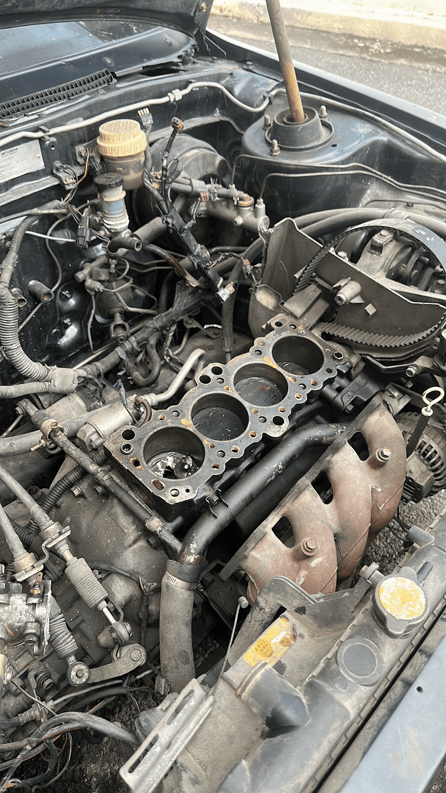

so, i was dissasembling the engine i bought off fb and it wasn't all bad, i was having my fun
i still had the engine with the see through piston on the car. (in retrospective, i should've taken than engine out, buying the one of the yard and send it)
so, i few days went by and i got my friends to take out the engine.

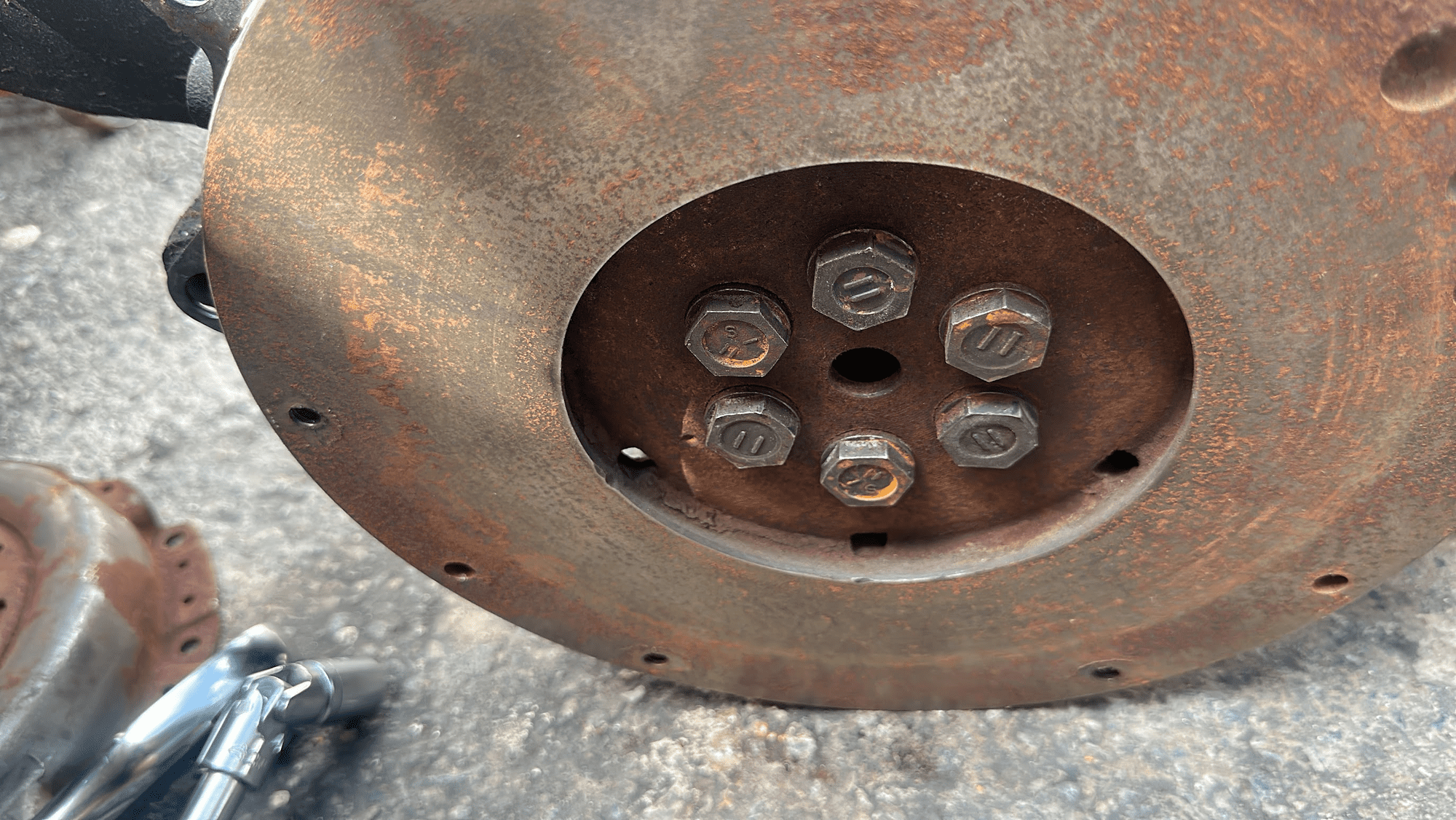

Man, I struggled to get everything i needed in here. The pistons are from a local company called PC pistons, I'm kinda happy with them but i think i would rather have used TIK or TOTO pistons. I know all those brands sound like gibberish to y'all but is what we can source out here. The best case scenario is to get some NPR pistons and rings but you can only find the counterfeit parts. So yea, i'm lucky enough to have some people up the states and they got me everything i needed and send it. Rn i'm looking for a flywheel bolt that i forgot to buy and dude, it has been rough. Either way that MFer will start no matter how. I'll try to post more, i have some videos up in my instagram, but now is the come back to the forum

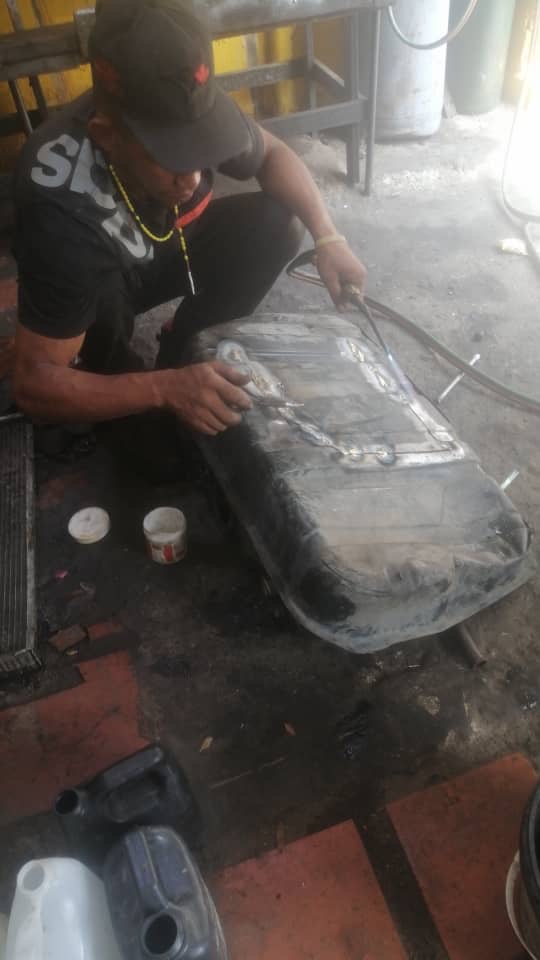

So then They welded the tank and painted it

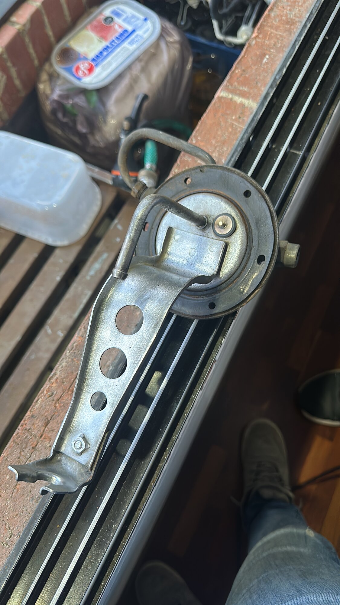

So as I said, I was not satisfied with the end result at all. But then again, I don't care no more LOL. After getting the tank i bought a new fuel pump hanger and a gas level sensor (I don't really know how to call it). The level sensor worked perfectly with my tank but the sending unit did not. It was a little too tall for the tank and it wouldn't close. Here are the old and new hanger. Fortunately the guy who sold me the sending unit is going to return me my money.
So next week I will be cleaning the old hanger with some nuclear level degreaser and the using my drill with a brush. If that don't work idk wtf imma do.

So some friend told me to put the sending unit in clorhydric acid and I did. It removed all the rust from it. Then I washed it with sodium bicarbonate and after that the parts that were not reached by the CA got cleaned with a brush. This is the end result. I'm actually quite happy :)
