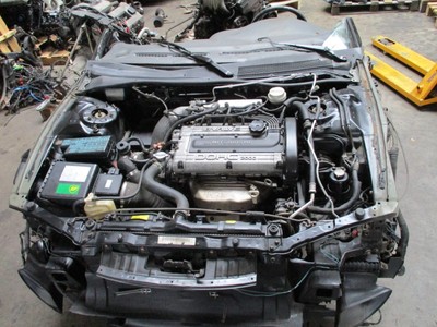

I did some research and I think that Al the eclipse GS sold in Europe after 1995 where also with a 4g63. I got a picture from a 1995 eclipse. Think is a 4g63 not 100% certain.
And if it is. Is it the 7 bolt version?
