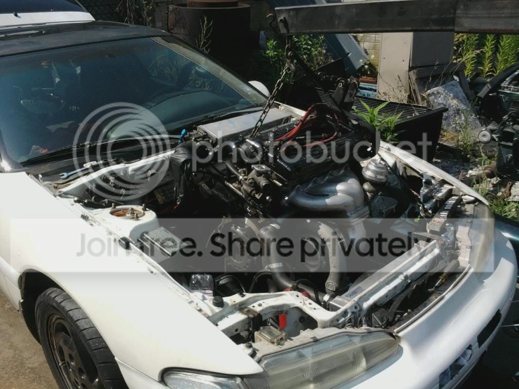

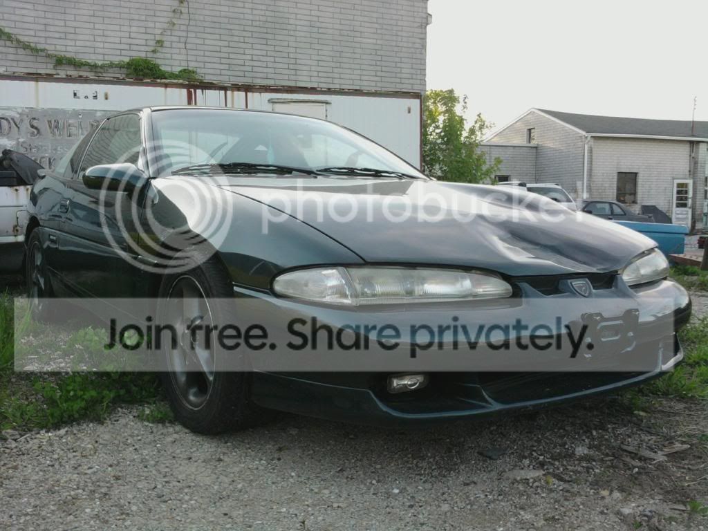

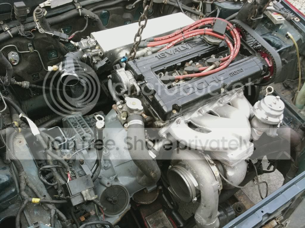

Well after Having some fun with the GT42/2.4 and sheering off gears every 6 months I decided to go auto. I picked up a really nice donar car running auto that just needed a hood. Drove it to the shop and started tearing it apart.
Motor out, sold to a friend. 100k ran perfect!

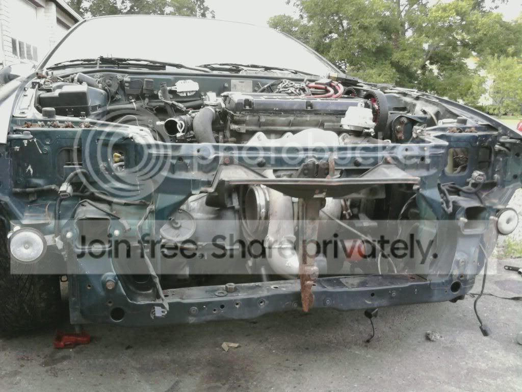

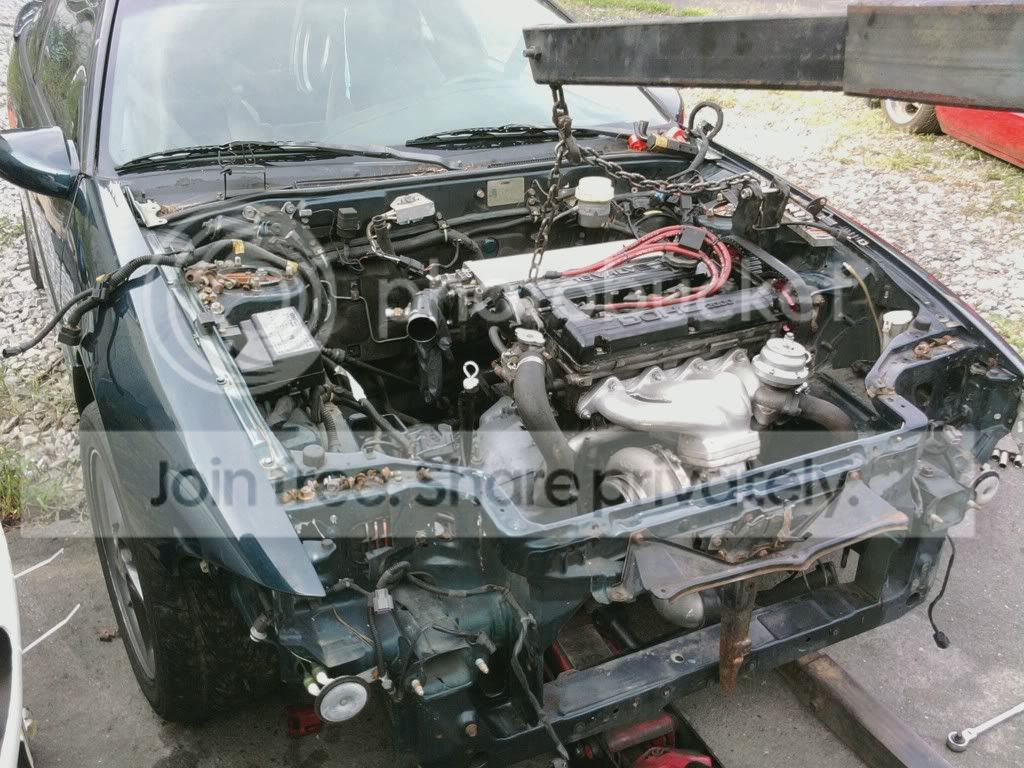

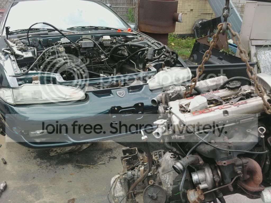

Time to take the old friend apart...it was very hard. Ive had this car for 8 years.

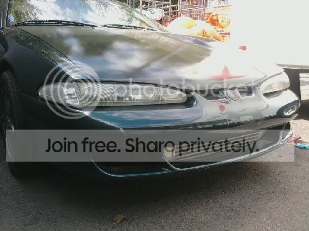

Into the New whip
The new body is really nice in and out, and it just changes things up a bit. I hope to get the car into the 9s on straight 93 pump. Im sure it will.

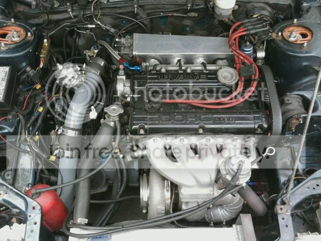

What manifold is that?
That kind of looks like a HKS mani
Bender Im not on the link forums It wasnt me.
jjrocks5 thats my goal. When it was 5spd I went 10.95@134 on 25psi on 93 with a 1.89 60 foot on crappy tires, never got a retry on the Hoosiers. On 30 it made 621 still on 93 on 25 it made 561. I found some little issues (boost leak, i blew a endtank open on the intercooler because of a leak etc.) Im willing to bet it will make 650+.
supravw its a "ON-GREEN" performance manifold. Its a copy of the old school HKS ones, but made with higher quality metal. Its a heavy bi***, but I like not worrying about cracking. Its full divided equal length t4, and has threaded holes for a t3 so if I ever wanted to switch I could do so without changing the manifold.

juanpac0--I sold the motor out of the green one, everything out of the white laser is going into the green car. If the rolling chassis dont sell then eventually ill be putting it back together. My daily driver is a 05 evo mr, but I wont sell out from dsms LOL.
