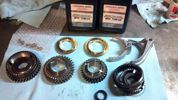

So I ordered some tranny refresh parts from JACKS. I hope this gives me close to a season of use.
I am replacing the evo 3 4th gear, I dont make the torque as Mark does but this gear has 2 years on it.
I am also replacing the 2nd gear synchro, if the car spins it has and will lock me out of 2nd, not a bad thing but I figure just to be safe. and also I will switch back to only 1/2 quart Redline shock proof light and the rest mitsu tranny fluid, JACKS is pretty sure the red line shock proof will cause synchros to fail. IDK I only stripped a used final drive late 2010.

All my new tranny parts showed up, and I picked up a used tranny with evo 3 stuff in side, it hurt the intermediate shaft and 4th gear so I have some extra parts and will buy a new intermediate shaft to fix this tranny for a back up this year.

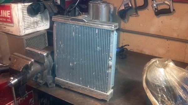

I am going to re make my heat exchanger tank and use my old radiator as my heat exchanger up front.
Here are the new tranny parts, I am going to run 2 quarts Mitsu MTF 75w 85 and the rest shock proof light gear oil.
