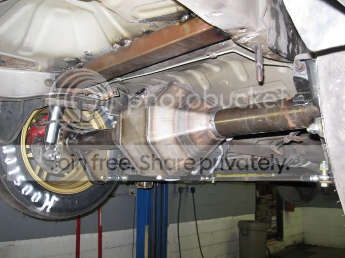

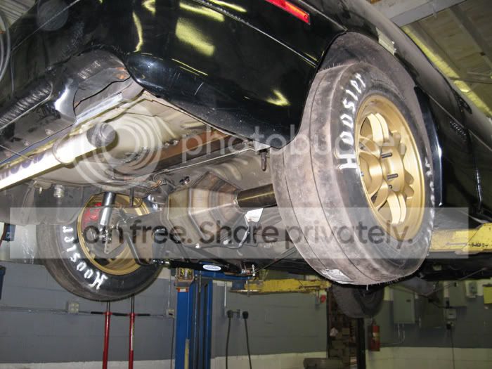

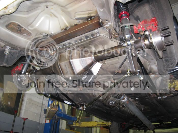

The build lives on. Let me get you guys up to speed. Ok, the cage was completed some time ago. The seat had to be modified to give me more head room. This required the floor to be modified and the E-brake moved to the other side of the Shifter. Nate tells me that I should have all the room I need. Then the issue of the rear end came up. Like most guys the only option I had was to buy those DSS rear axles for 2,000 and rebuild the rear. But guys still break those and I didn't feel like stock piling 4 bolt rears. I was walking around Nate's shop and was checking out a camaro that he was adding a ford 9 inch in. I think it was a four link setup. Just for fun, I asked Nate if he had ever installed a ford 9 inch in a DSM. He said no. I didn't press the issue because I didn't have the extra money in my budget to afford a custom rear anyway. Then Nate calls me and says he would like to try and install the solid rear. I told him I didn't have a lot of money so he would have to reuse the Megan coilovers I had already purchased and keep the factor rear brakes. Well this is what he sent me. By the way, this guy is not an amateur. His previous job was building Top Fuel dragster chassis from scratch. So the guy knows his stuff. So he sends me some pics. At first the car looks normal on the ground. Then you see it in the air and surprise no more IRS.
He is still working on some things. He is replacing some bars, but everything looks good so far. The Drive Shaft Shop will be making a custom rear drive shaft to mate to the ford 9. Things are coming together. I will have some more pics shortly. Let me know what you think.

How did he mount it to the floorpan? If there is a crossmember, I must have missed it. How much do the ladder bars allow the rear to articulate in this car?
This rear should be more than I need. It has a Strange pro center section with 35 spline axles.

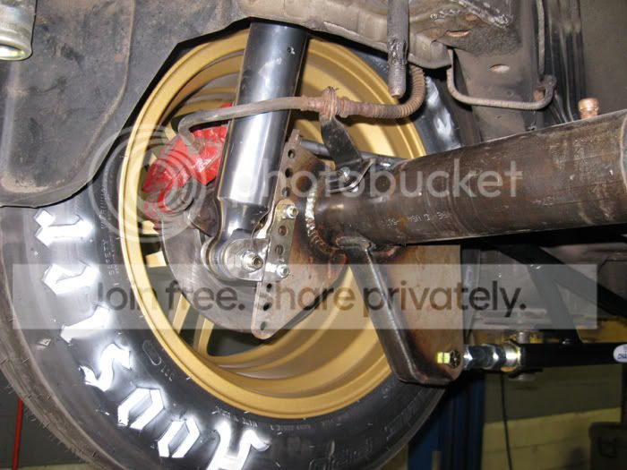

Can you post some better pictures of the ladder bar mounts? Why did he put them so far forward? I would have guessed they would have put them closer to where the fwd trailing arms go. I seem to remember the guy who has buschurs old RWD car having traction problems becuase the rear suspension wasn't done right, but I don't know how it was done. I have seen pictures of sheps car from like 06 and his ladder bars are mounted farther back than yours. I'm not hating, just trying to gather what is right and wrong, as I have one of these in the future. Whats your plans for the drive shaft? Are you just replacing the last piece with a custom one too hook to the 9"?
