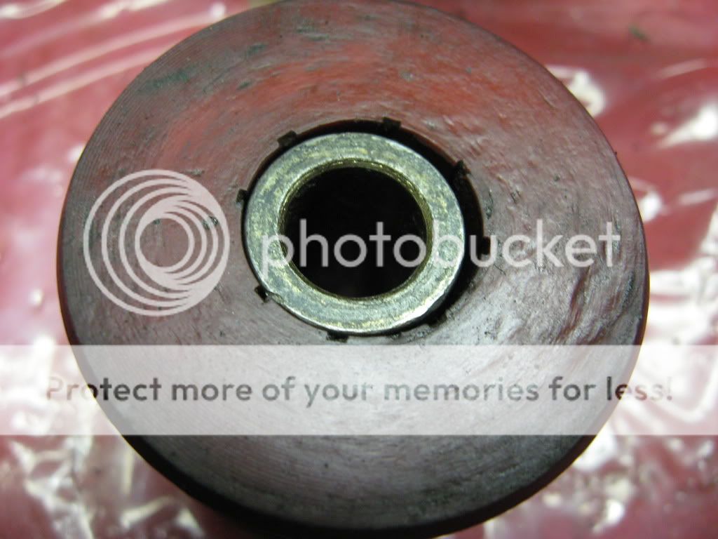

housegsx;bt12419 said:
I've seen this posted a couple times and don't want to deal with the problems. I may be selective in where I install the bushings.
That's my photo and it's the inboard bushing of the front lower lateral control arm. It's also worth noting that I run 275 wide race slicks (i.e. tons of lateral force). YMMV.
