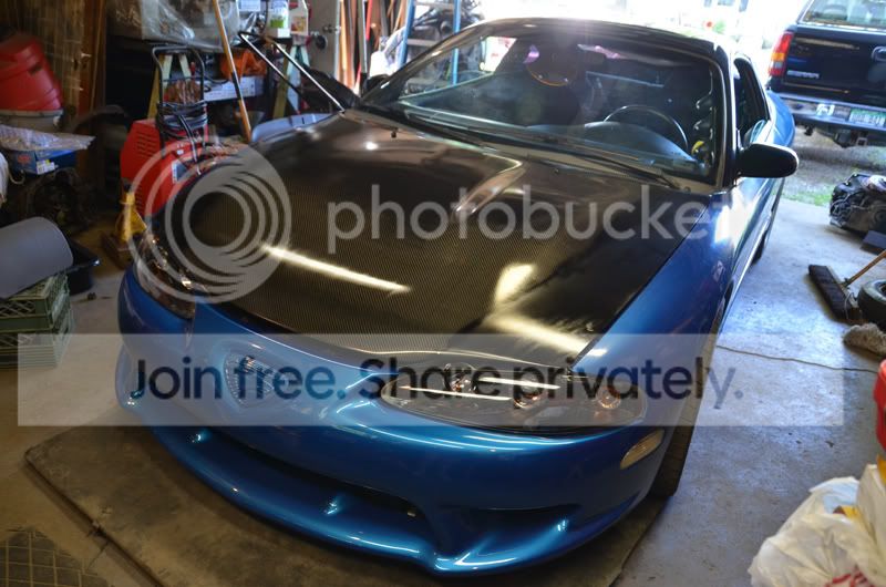

And now...The attempt to making an ugly, damaged CF hood less ugly... but still failed. She'll get a new hood next year..
It was a $25 hood... Bought it damaged. Had 2 big cracks on both sides and pieces missing along the top edge. Also had some cracks on the underside. I repaired them using epoxy, then carbon fiber fabric and resin. Sanded it down... but all I have is spraypaint and cannot for the life of me get it to spray evenly on a panel this large. Anyways, has this hood on the white car for a few years, as well. No re-cracking! It's just ugly. LOL

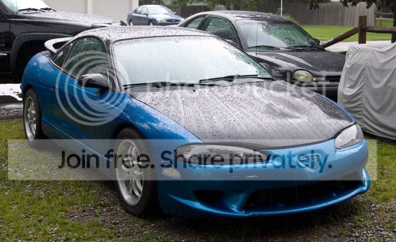

Pics from when it was on the white car:

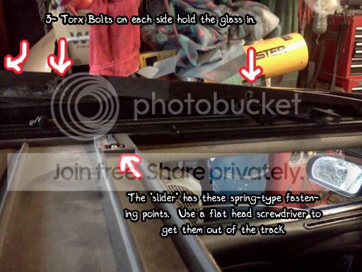

Just an FYI for those who may just be interested in sunroof glass or sunshade replacement. You do not have to remove the whole assembly.
